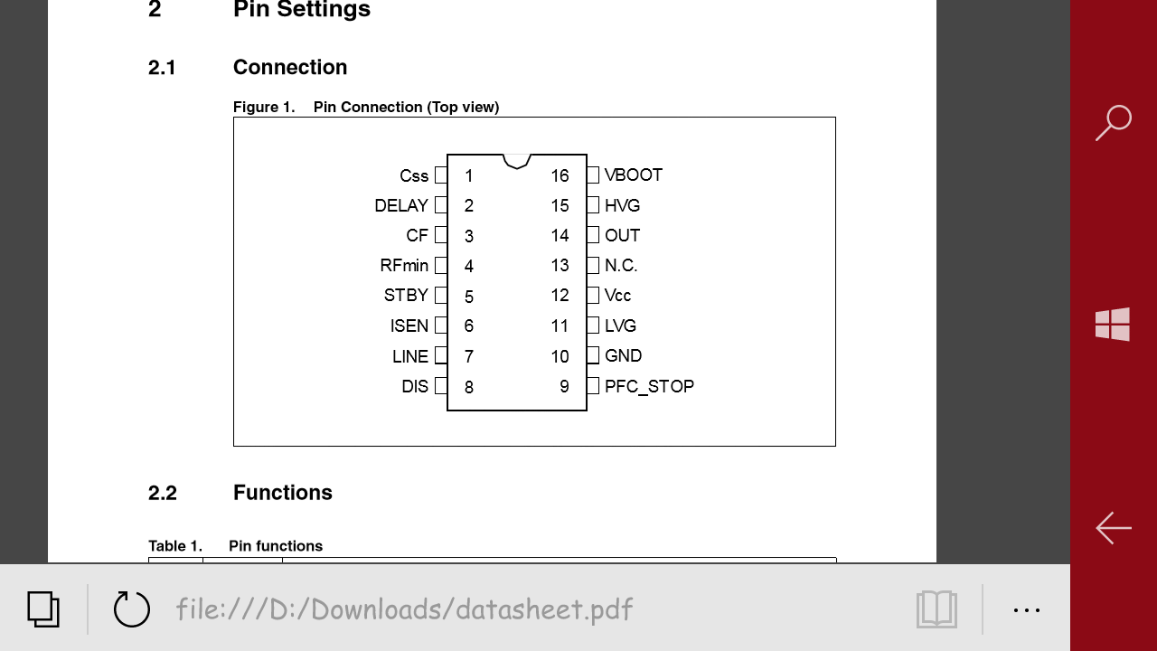

                                  #76
                                  Re: Rca led50b45rq
                                  Found the datasheet for L6599. In the attached picture, i need to check DC voltage been PIN 10 and 12, right? What would be the correct voltage if the IC is in good shape?

                                    #77
                                    Re: Rca led50b45rq
                                    Im still learning but it looks like its operating voltage is between 8v and 16v so take all voltages of the ic as im sure budm will advise you further then.

                                      #78
                                      Re: Rca led50b45rq
                                      See post #42
                                      • x_orange90_x
                                        • May 2015
                                        • 727
                                        #79
                                        Re: Rca led50b45rq
                                        Do i check with my black probe on PIN 10, or the EC1- leg?
                                        • dick_barton
                                          • Aug 2015
                                          • 6643
                                          • Wales
                                          #80
                                          Re: Rca led50b45rq
                                          The EC1 negative leg would probably be easier and less risk of shorting pins on the IC accidentally.
