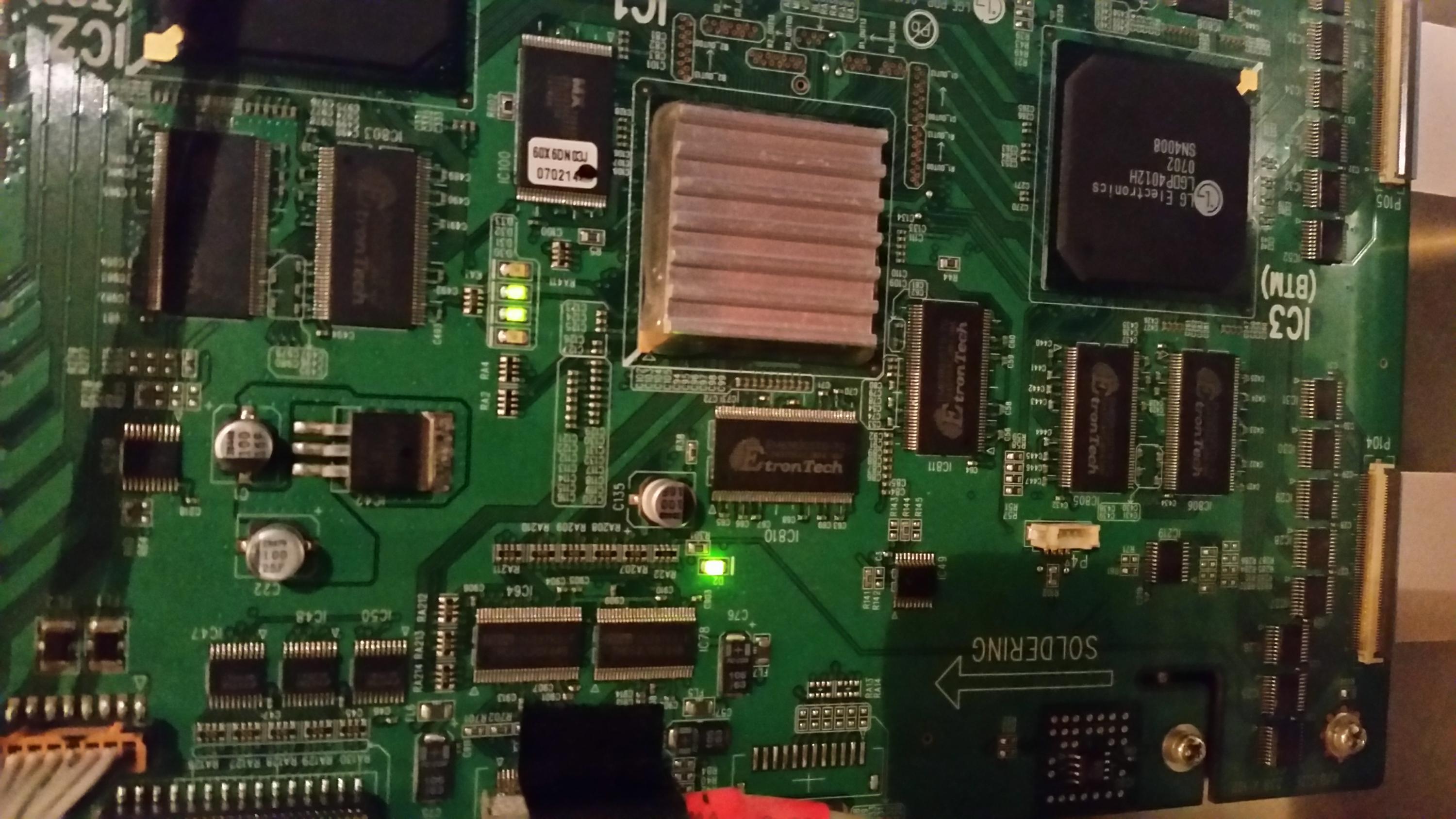

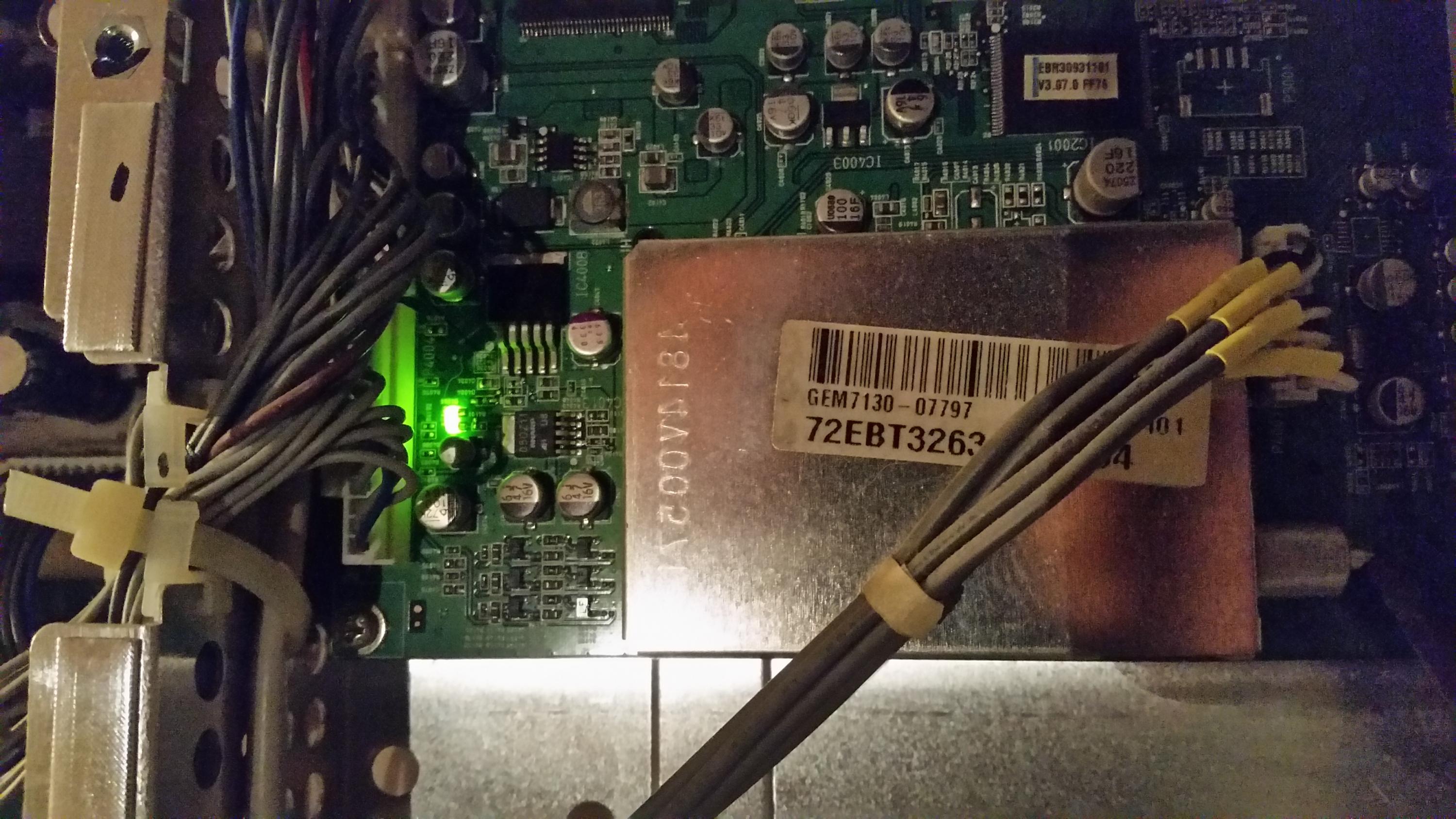

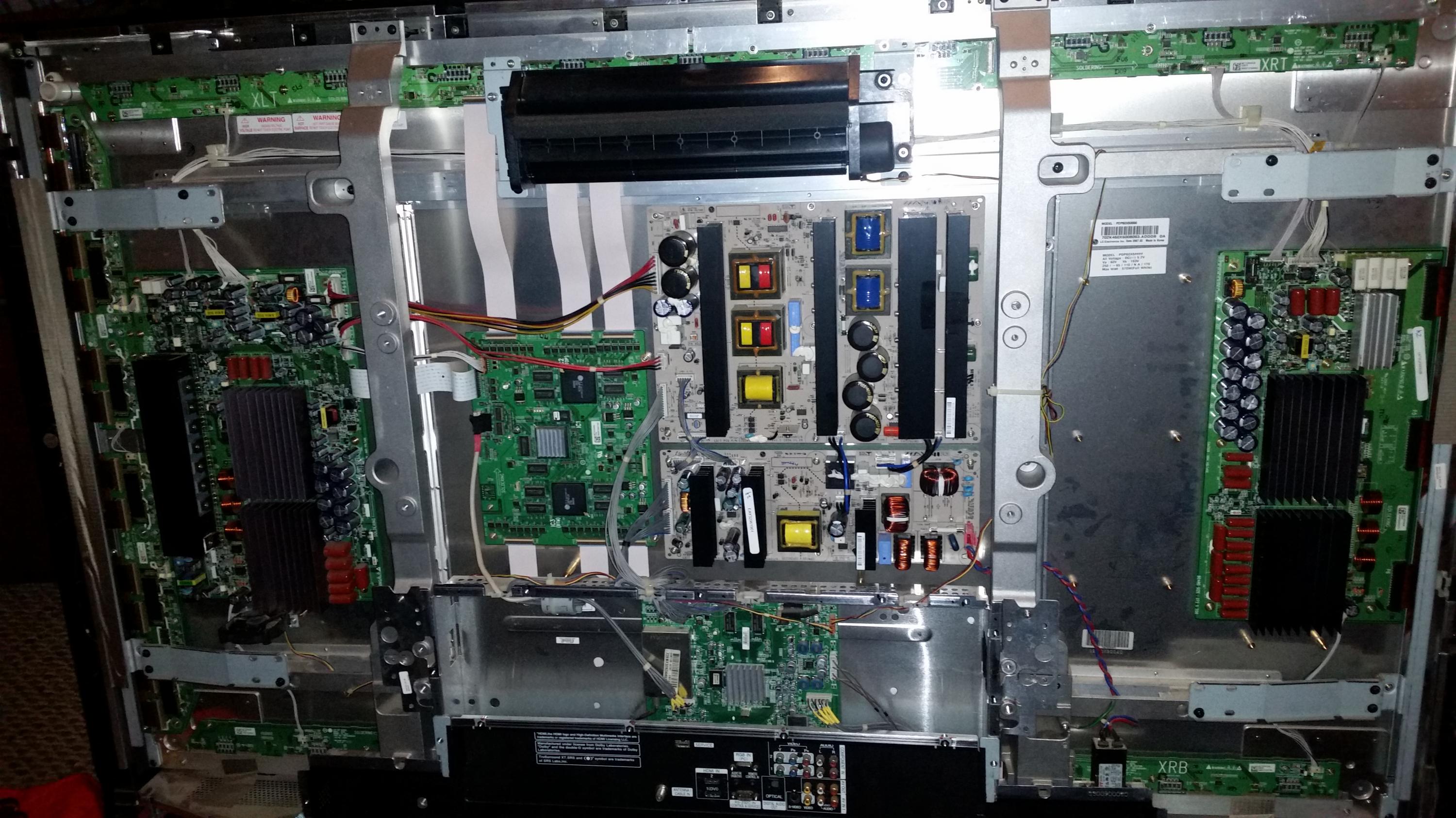

    Hello. When I plug my TV in i get two clicks, these boards light up with the green LED lights (SEE PICS BELOW), THEN two more clicks and nothing happens. It continues to cycle this way if i leave it plugged in. NO PIC/SOUND. I have replaced the ZSUS BOARD and the POWER MODULE BOARD. NO LUCK. Any help is greatly appreciated.

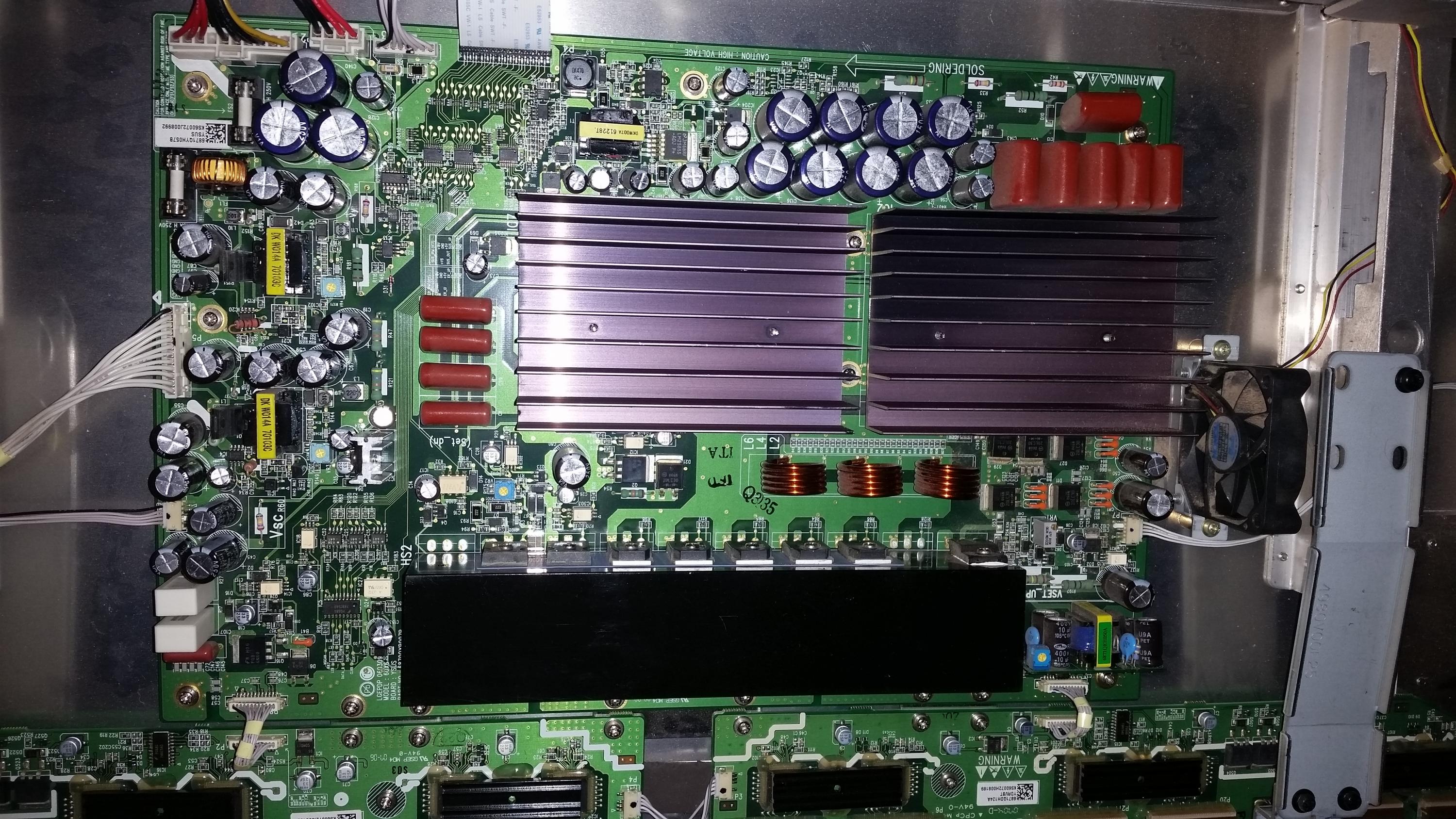

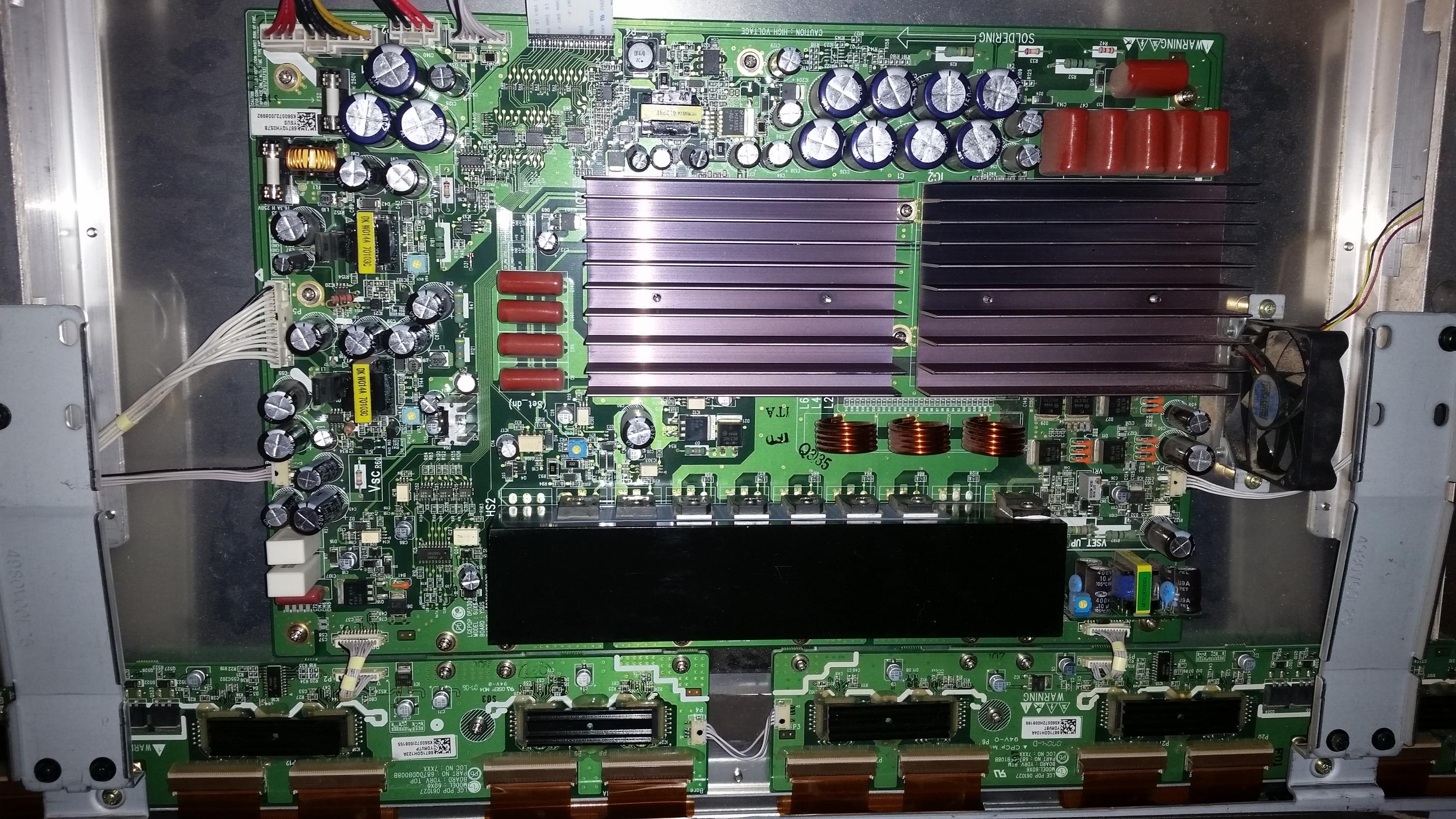

    Check the IPM's for shorts on Y-Main

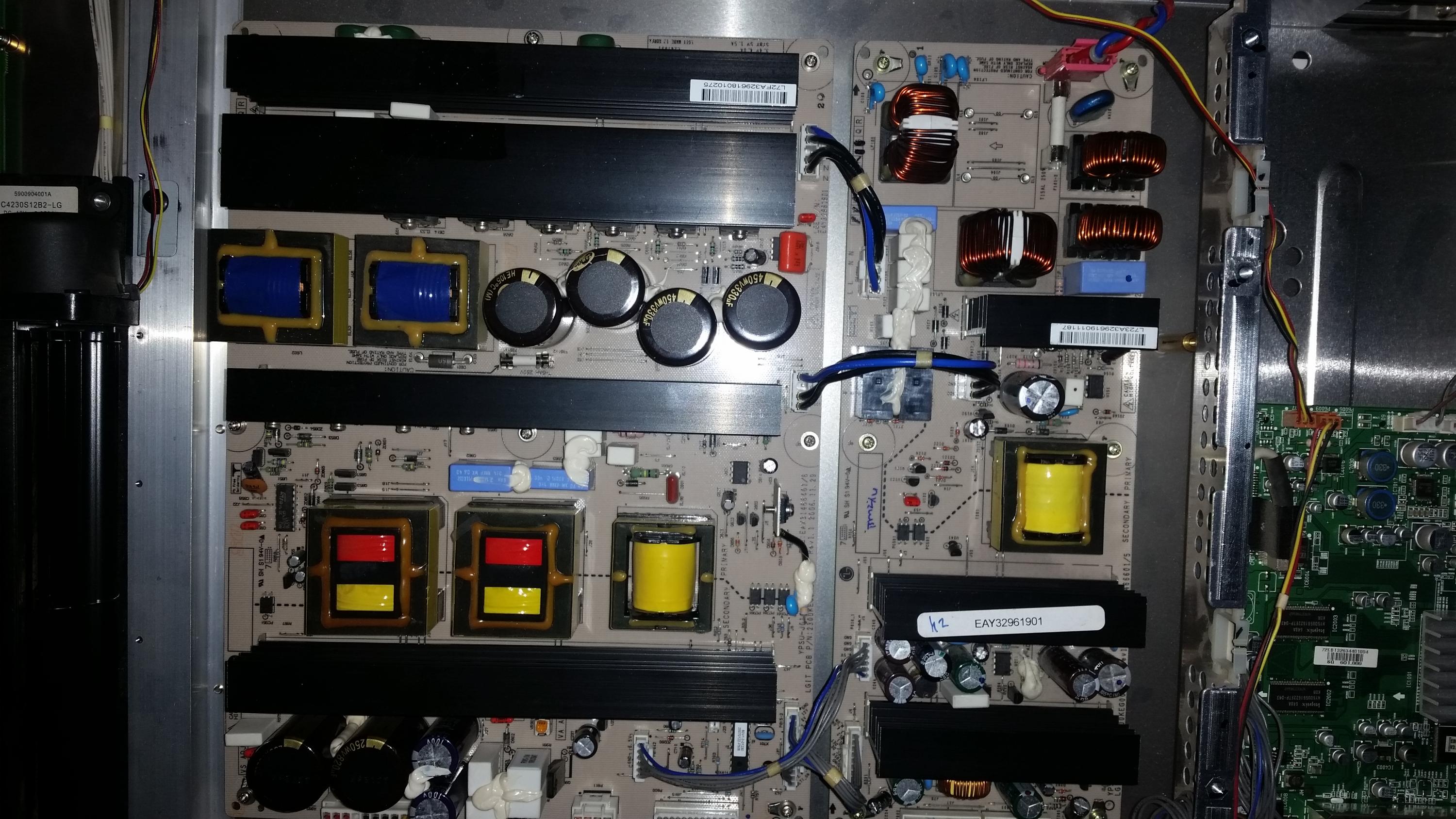

      Also check the back of the PSB for bad solder joints.

        Hello, i replaced the Ysus board and the Buffer boards. I still have the same symptoms. click on click off. repeatedly. Any other ideas? Thanks in advance.

          is the PSB the Power Supply Board? If so, I replaced that as well. No luck

                      Re: Plasma tv clicks on/off no power/picture lg 60pc1d
                      Look on youtube how to check 'LG IPM'
                      --Even if a slightly different model--the pin names/markings should be followed in accordance with the vid and yours...
