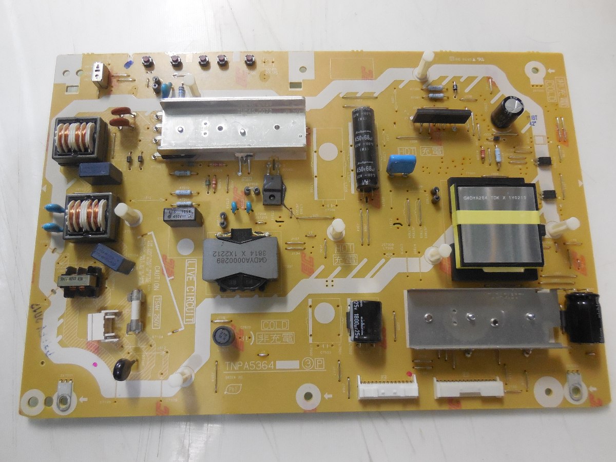

    hi i have a panasonic led 32 tx-32c300e that has no sign of life no power and no standby led,
    it has the following power supply board tnpa5364 ad 3p
    i am guessing that the power supply is broken but i need help with diagnosis.
    at TP7502 i have 0 v should be 5.7v
    i dont know how to follow the diagram to find the fault

    On some Panasonics they do not turn on the STBY LED when the TV is off. So the TV is off, the LED on front is off also.
    Based on what you are describing, either you have no STBY voltage on the power supply, or the main board isn't telling the power supply to turn on.

      start with your diagram from top left hot area

        i have no stanby power, i am not able to understand the diagram that is what i need help with

          This is a Vestel set ? Upload some images of the boards please.

                              On the up note this Tv is not Vestel hooray Do you get stby with mobo unhooked ?

                                check with DC how much volts you have on the long caps 68uf 450v. in the hot area

                                  Re: panasonic led 32- no standby power no led?
                                  350v
                                      Originally posted by simon.ribeiro
                                      350v
                                      take out the board and check after bad soldering
                                        no standby voltage with motherboard unhooked
                                        measured ar terminal 8 of P2
