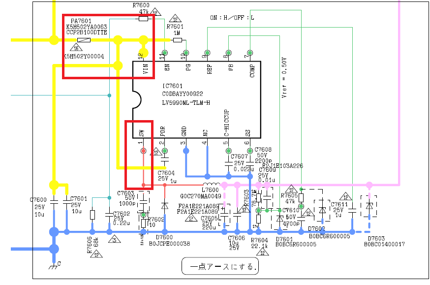

                Re: panasonic led 32- no standby power no led?
                Originally posted by simon.ribeiro View Post
                no standby voltage with motherboard unhooked
                measured ar terminal 8 of P2
                The diagram shows pin 8 as TV_SUB_ON at P2.
                STBY6V should be pins 1&2
                Looks like IC7601 generates 5.8V
                There's a fusible link PA7601, will be a tiny SMD link, worth checking that or see if 16V is reaching Pin 12.

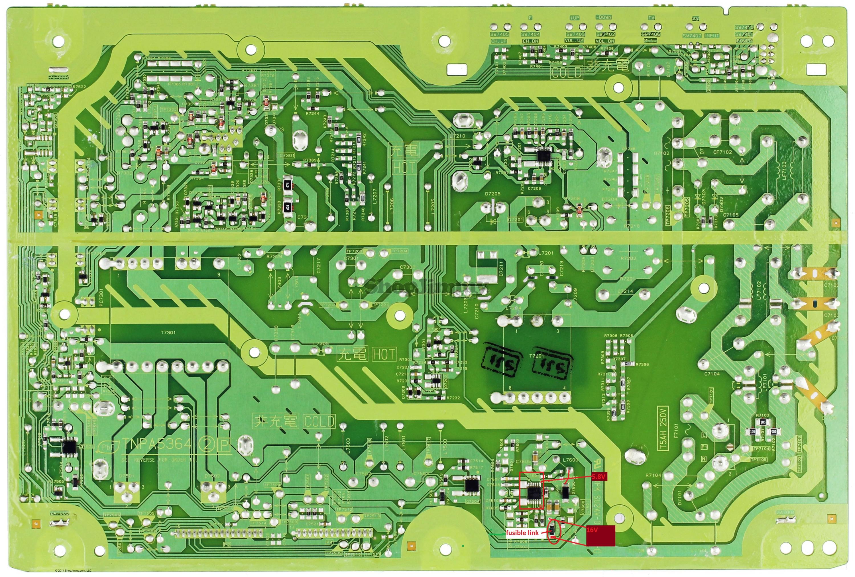

                    #29
                    marked the IC and fusible link

                          I have 0 volts terminmals 1+2
                          PA7601 is good
                          I have 12 v at pin12
                            #33
                            ok so,
                            C7301 Reads 345v dc, c7300 is not fitted to this board.
                            tp7501-0v
                            tp7502-0v

                            The PFC circuit is off, you just get rectified mains. = The power supply is off. There are no voltages on that main board in order for it to turn the PSU on.
                            I don't understand why you measured 5.5V only on TP 7506, as it should be the same on TP7505 and TP7504.
                            What are all the voltages measured on the pins of IC7601?
