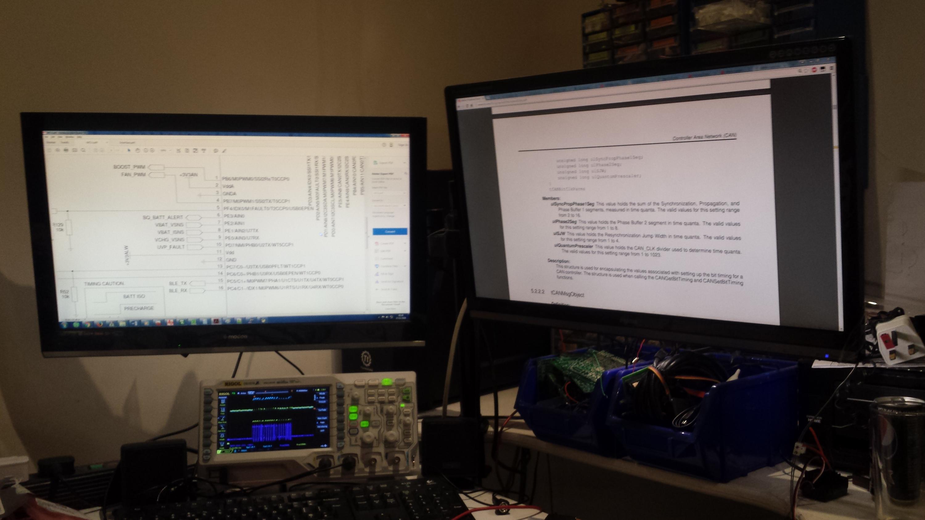

                    And weight? The total weight of my monitor set up is less than 40kg and can be mounted on a simple clamp bracket. I'd need to reinforce the floor to put in two 24" CRTs.
                    Flicker: my LCDs don't flicker at all (I've checked with a high speed camera), but CRT monitors flicker at 60Hz **regardless of phosphor persistence!** That's not too bad for a TV (plasma do the same, 600Hz but with 120Hz component) but it's completely unacceptable for a monitor which I'm in front of 8+ hours a work day.
