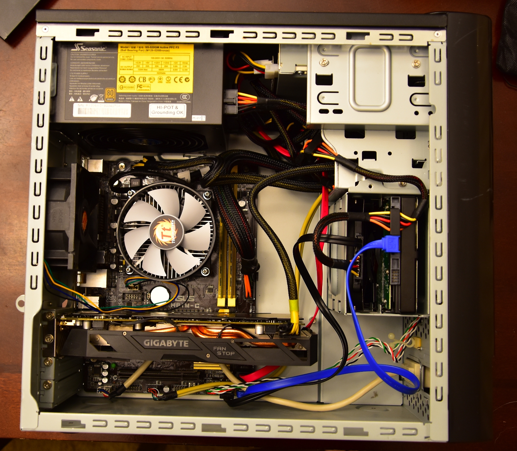

    After:
    Specs:
    Motherboard: ASUS H81M-C
    CPU: Intel I5-4690
    RAM: 8GB DDR3-1600 (2X4GB)
    GPU: AMD Radeon RX470
    PSU: SeaSonic M12-II 520W
    SDD: Timetec 256GB SSD
    HDD: 1TB Western Digital Green
    ODD: Lite-On DVD-ROM/CD-RW Combo
    OS: Windows 10 Pro

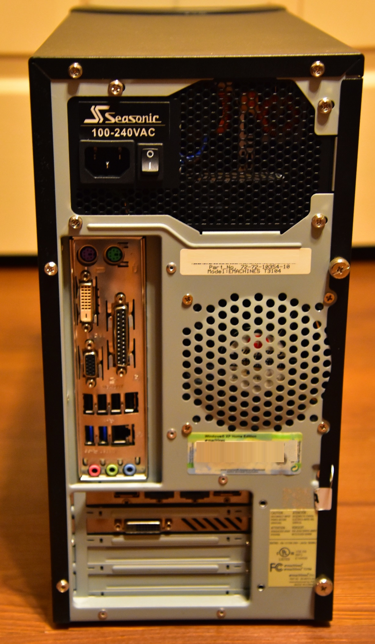

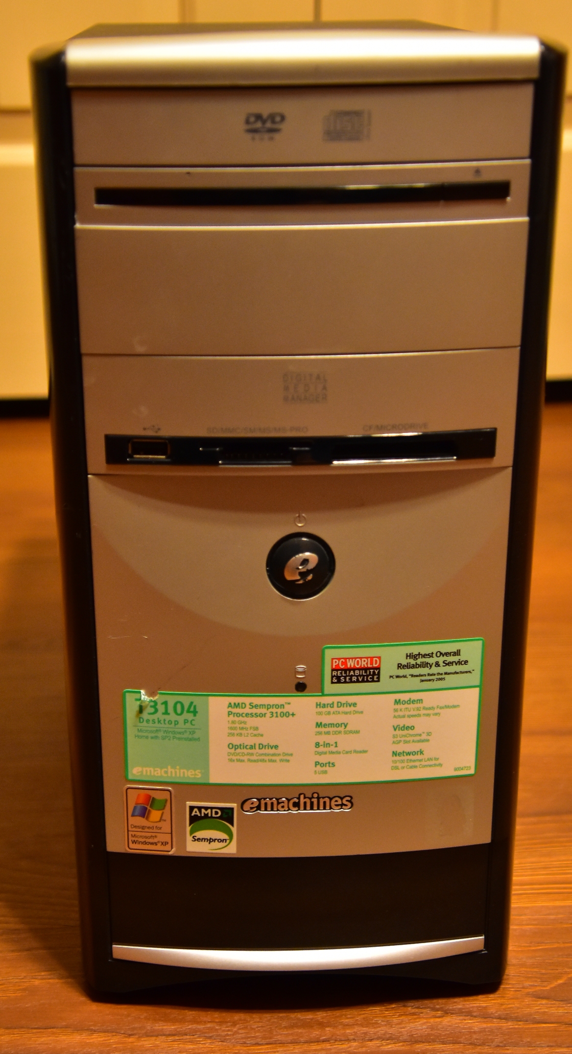

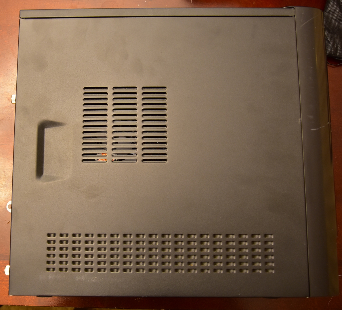

    At least from the front and sides it could still easily pass for an old Emachines, though the back has some giveaways with the PSU and dual-bay GPU:

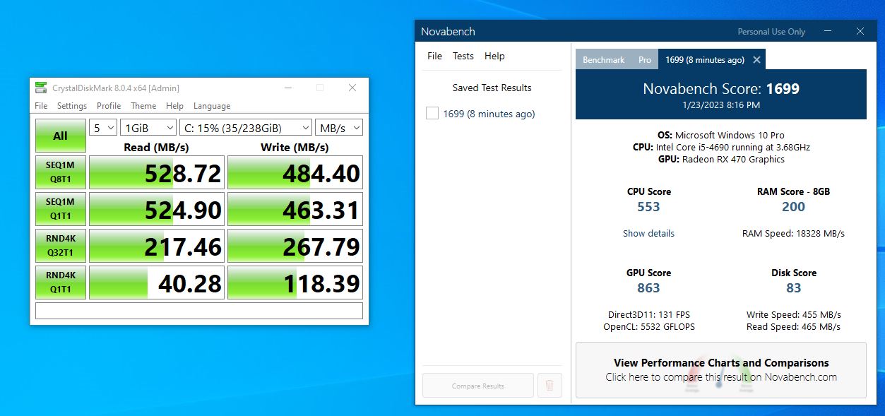

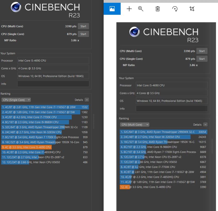

    Benchmarks:
    Overall, it is about on par with a modern mid-range laptop, but that is still a big improvement from the basically unusable (unless you want a low-end XP system for some reason) to relatively competent.

      With the RX470, it will even handle a few modern "e-sports" games too. Not maxed out, but probably 1080p with medium details, I'm guessing. Seems the benchmarks agree with that.

      I like the fact that you kept the original optical drive with the case. Those silver-colored curved drives are getting harder to find now and the case would definitely not looked as genuine with a newer drive. So I think this was a really nice touch that you left it there *and* make use of it too. I've seen way too many sleeper builds where people just left the original FDD and optical drives in the case just for looks, but disconnected.
