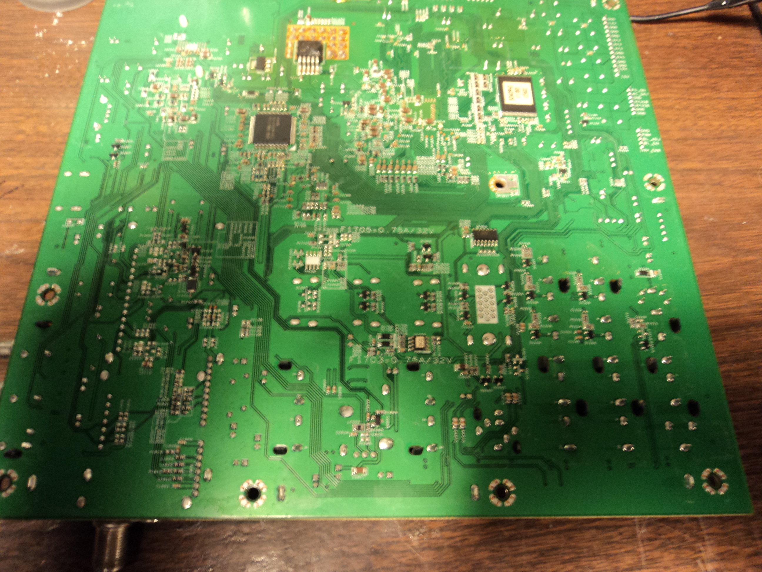

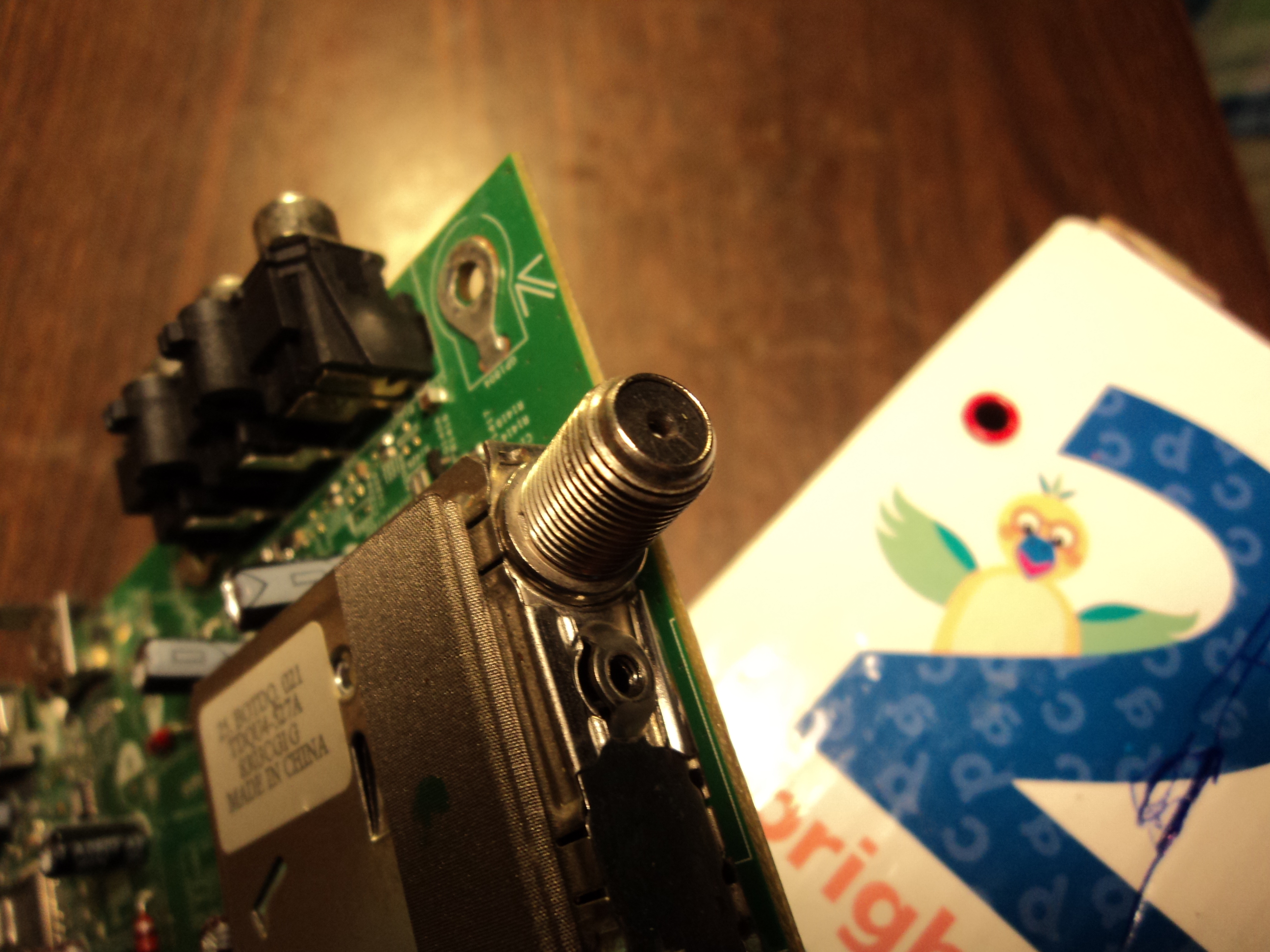

            Thanks there is no led blinking just a steady green led,i turn on tv power supply turns on with steady green led and black light on no pic or sound , it's pretty much what happens in this video,i took the main board out and i found out that the tuner coaxial cable input is twisted and the ground is almost all cut,but i don't think that is enough for this fault!check pic,i ordered Main board for 50 bucks and will check if i got lucky like some of the folks with same symptom.

              Hi guys i received from Jimmy parts today the A board for KDL-46S4100 - no picture and no sound but did get steady green light on and could power on and off,with back-light on, and installed and no luck same issue;how i know that this board is not faulty too?or should i look at other Board?thanks in advance.
