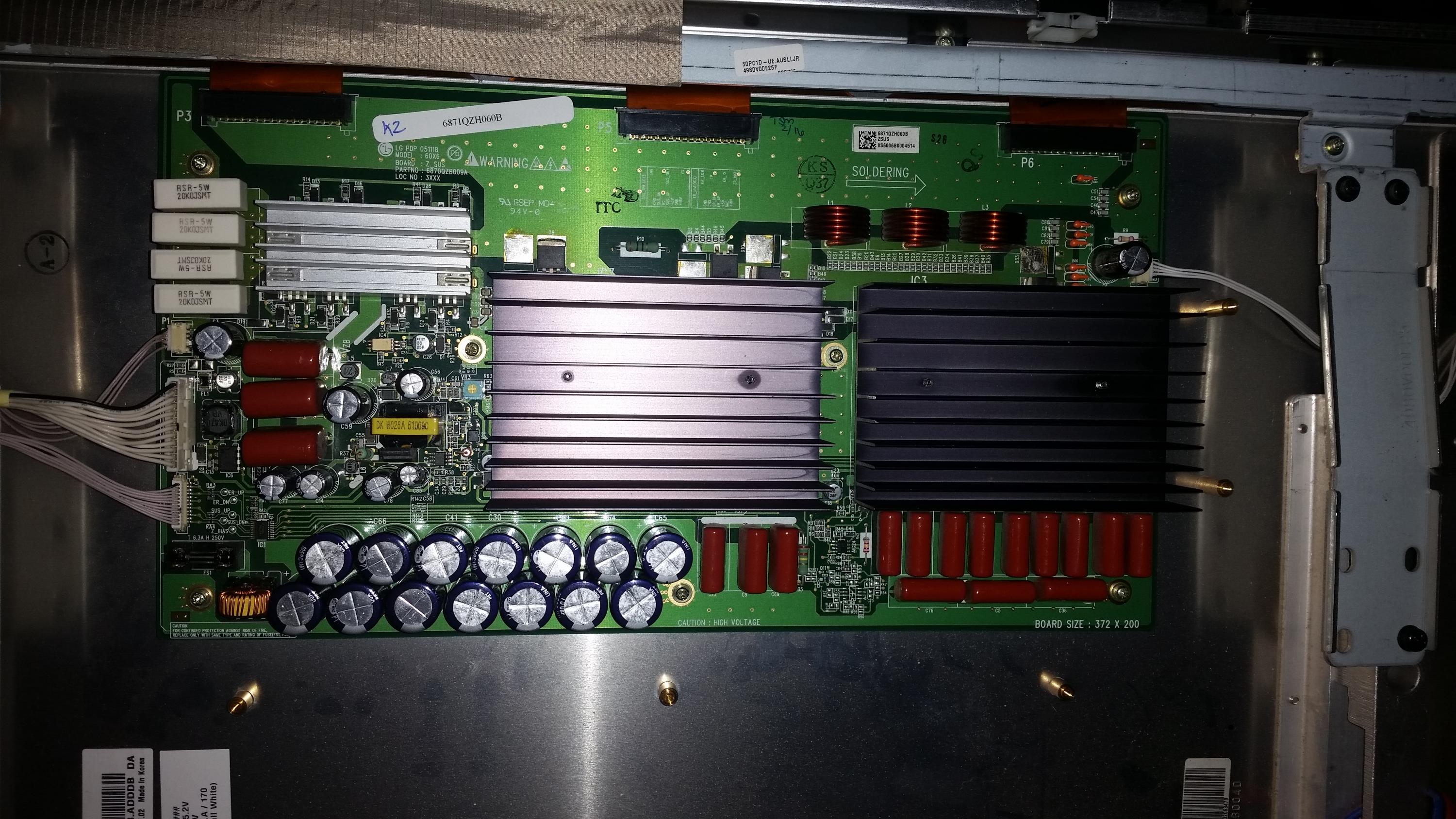

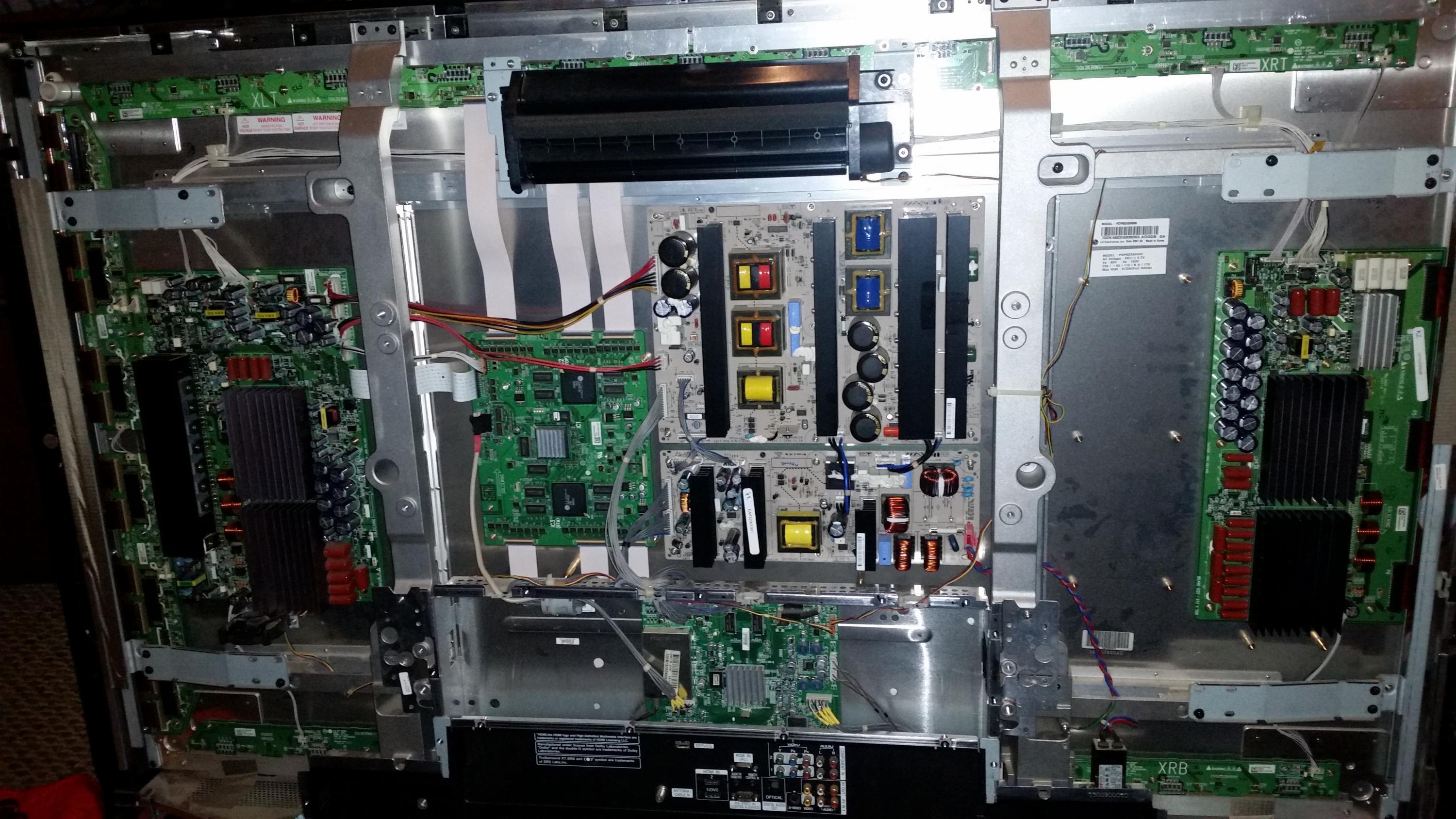

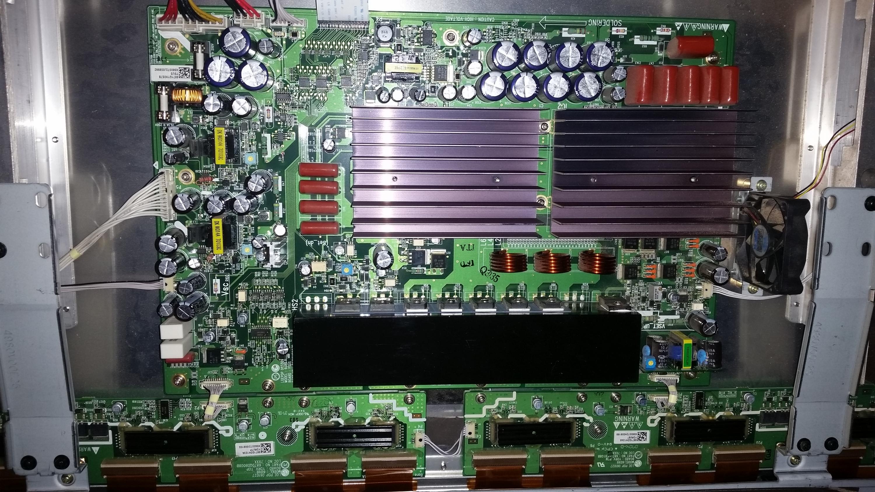

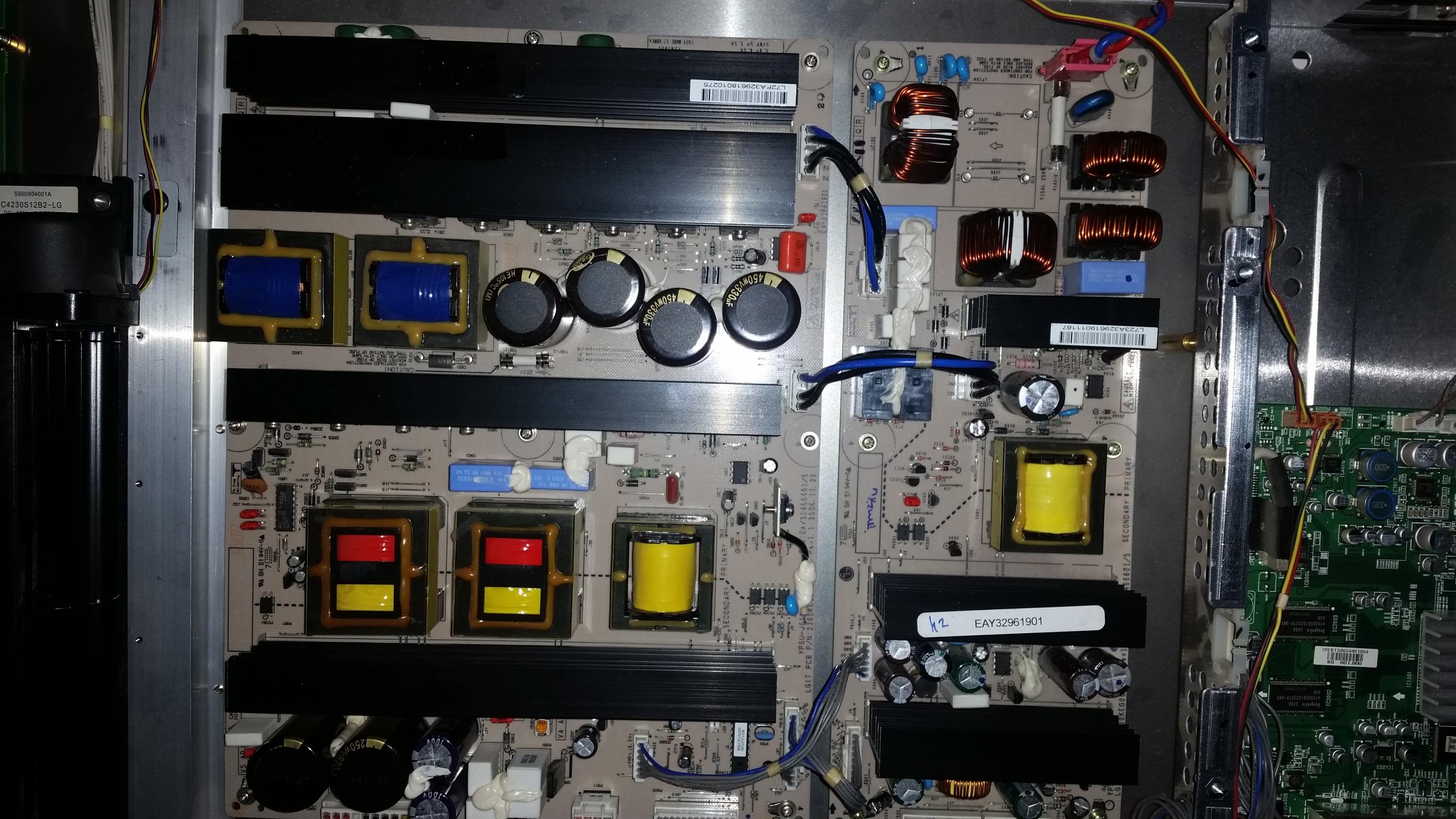

    OK so it started with the tv clicking on/off repeatedly and the tv never would turn on. I have read several forums/blogs and checked these items for possible problems;
    1. Power board- I replaced capacitors last year when the same issue occurred.
    I took the board to a local electronics repair shop and they checked it out to
    be good.
    2. I unplugged the ZSUS board and the clicking continued.
    3. I unplugged the YSUS board and the clicking continued.
    4. I took the ZSUS board to the same repair shop and they said it needed to
    be replaced.
    5. Bought a ZSUS board from Union Electronics Distributor. The board came
    with a blown fuse. I replaced the fuse and connected the board. Plugged in the TV and the same clicking on/off repeatedly occurred only this time I smelled a burning odor. I unplugged the TV. I plugged the TV back in to try again and I GOT NOTHING THIS TIME, NO CLICKING, JUST NOTHING.
    6. I called the repair shop and they suspected the new ZSUS board was bad.
    I returned it and ordered another ZSUS board AND A POWER BOARD.
    7. I received both boards and installed yesterday. AGAIN NOTHING....
    I have limited use with a multimeter....
    Please help with any suggestions and thanks in advance.....

    Re: Lg plasma lg60pc1d no power
    Posting pictures of the back of your tv showing the boards with clear pictures may help you more with fixing your problem
