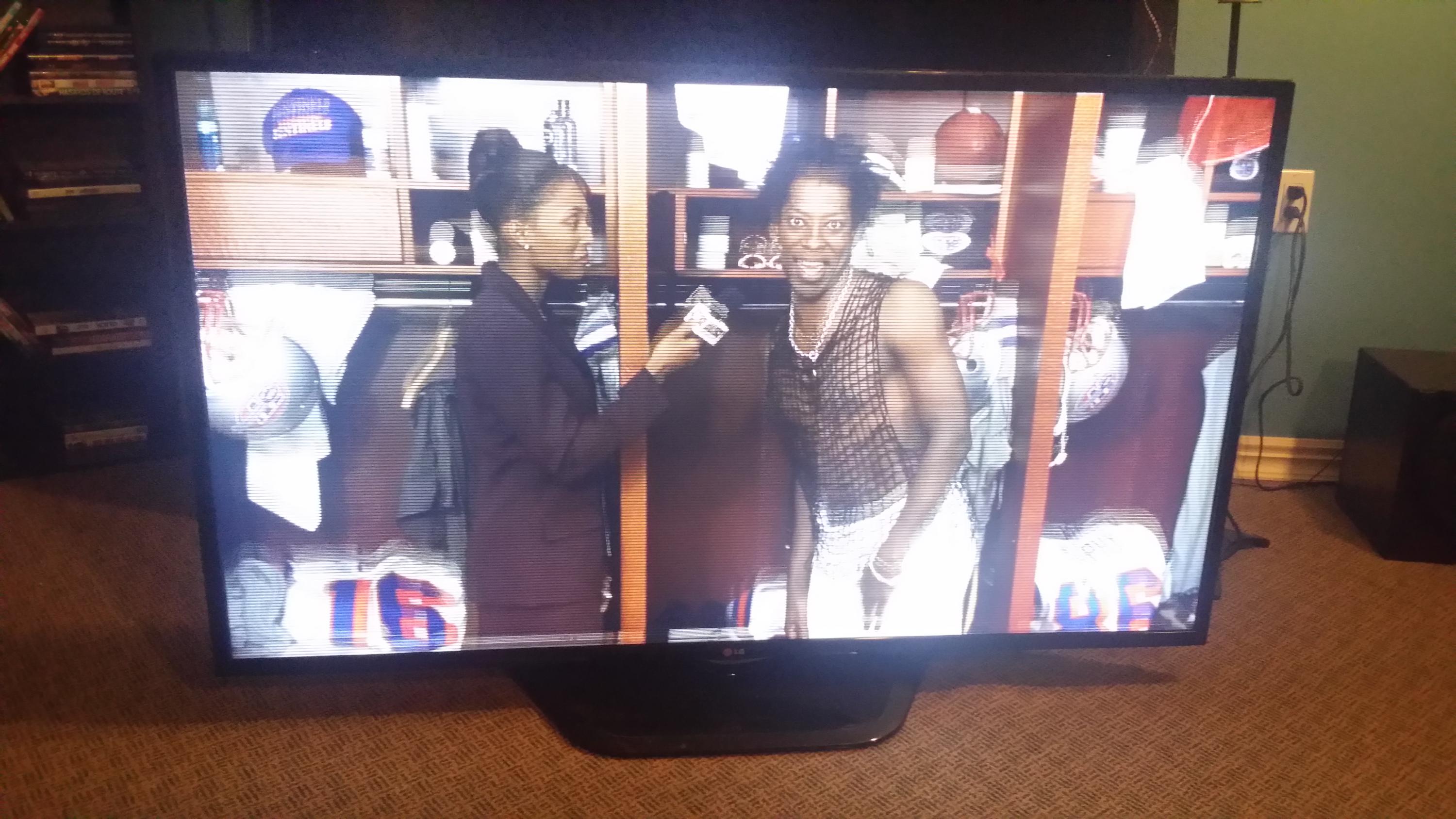

    LG 55LN5400 Jumping Picture
    I got this LG 55LN5400 with a jumping picture (See pictures)
    I already replaced the t-con board with one on eBay with no success
  • rikrikrik13
    • May 2013
    • 44
    Re: LG 55LN5400 Jumping Picture
    I also tried to disconnect one side of the t-con but It won't work (Should give half of the screen) at all (blank picture) if I disconnect any of the sides
    • Alastair E
      Chief Womble
      • Mar 2013
      • 1963
      • U.K.
      Prob the panel itself. Whenever Ive seen that double-image/lined sort of picture--the panel itself or the COF chips that are part of the panel has been duff.

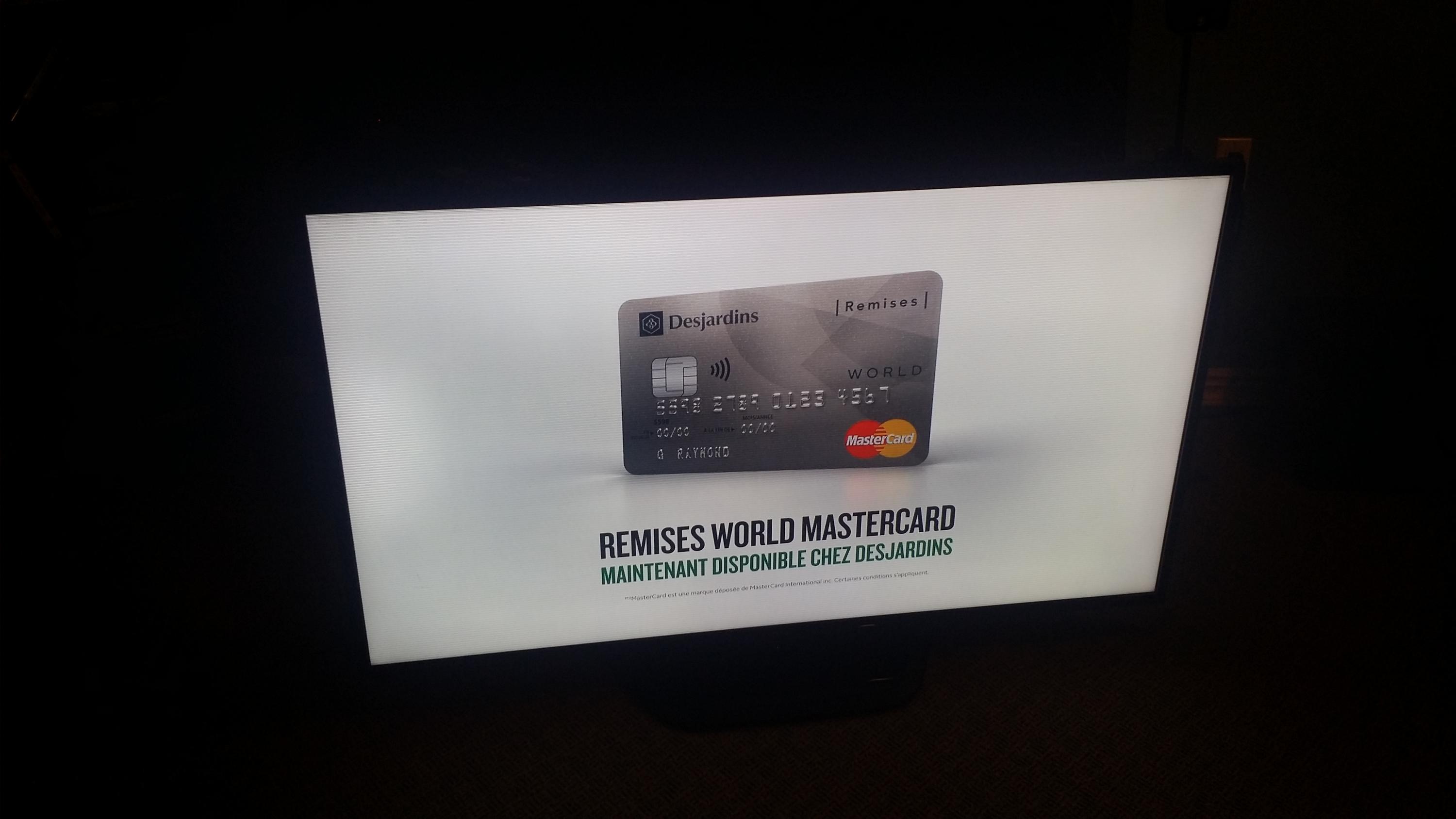

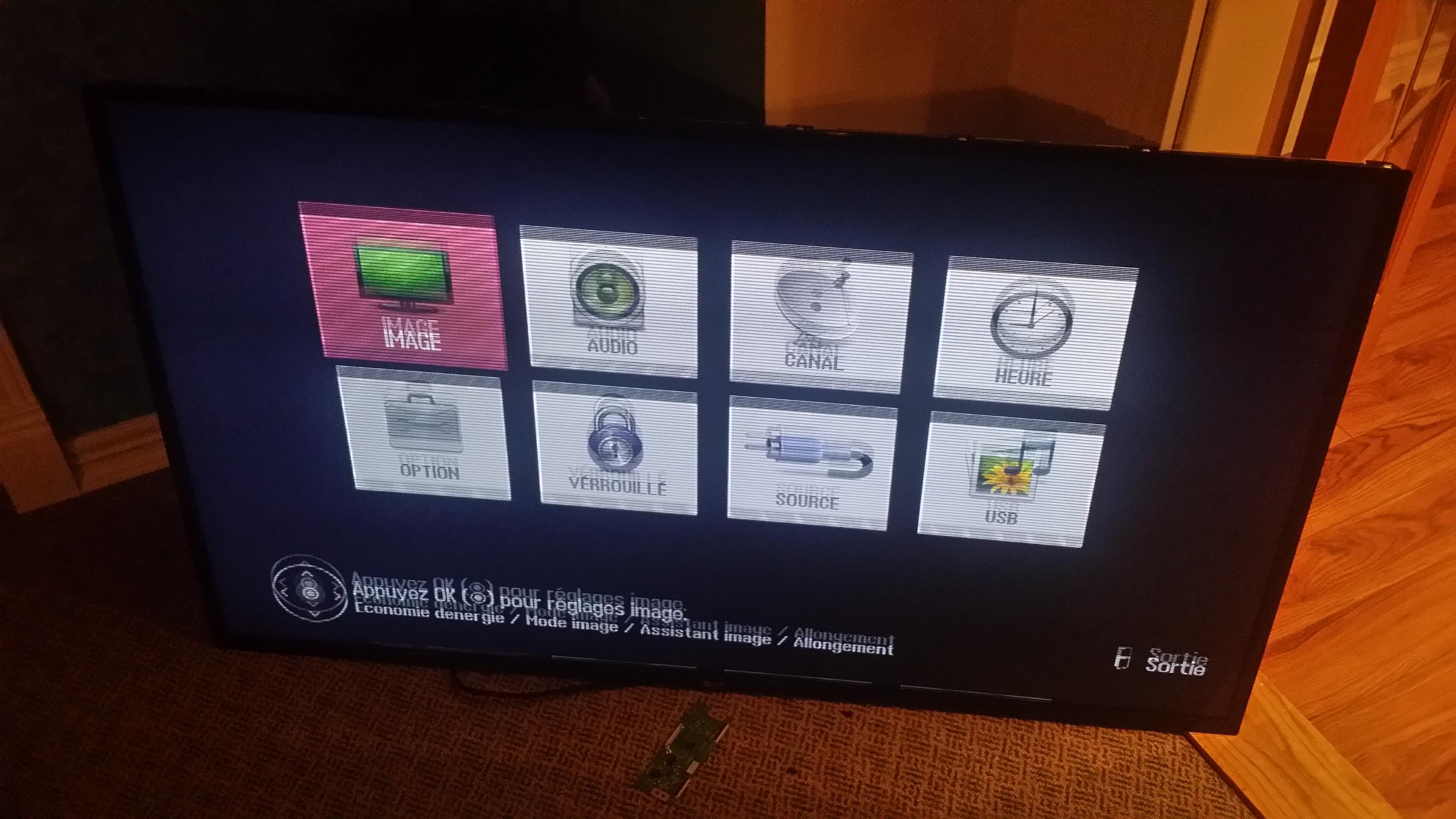

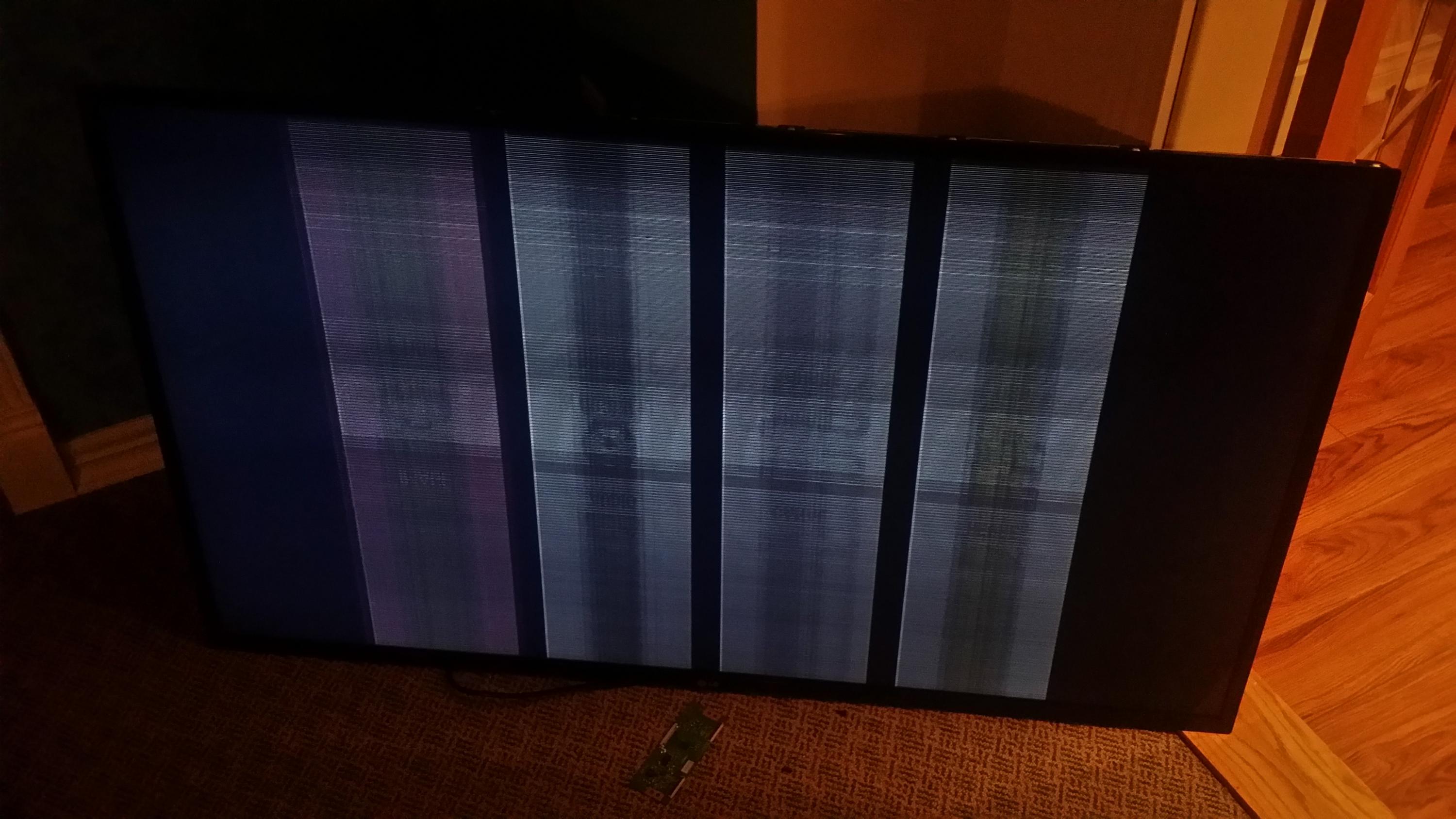

        Is it normal if I leave the tv working for a while, the image get better and better?
        its not jumping anymore, but the image is still not good :p
              30 minutes TV is running and now the picture is almost perfect ??
              • rikrikrik13
                • May 2013
                • 44
                I just did a software update, no change.
                Image still good after 45 minutes (you can still see some horizontale line everywhere but you really need to look)
                Screen seems to keep ghost image, after the update, the '' UPDATE '' message stayed on the screen for several minutes (ghost image)
                I think the panel is bad lol
