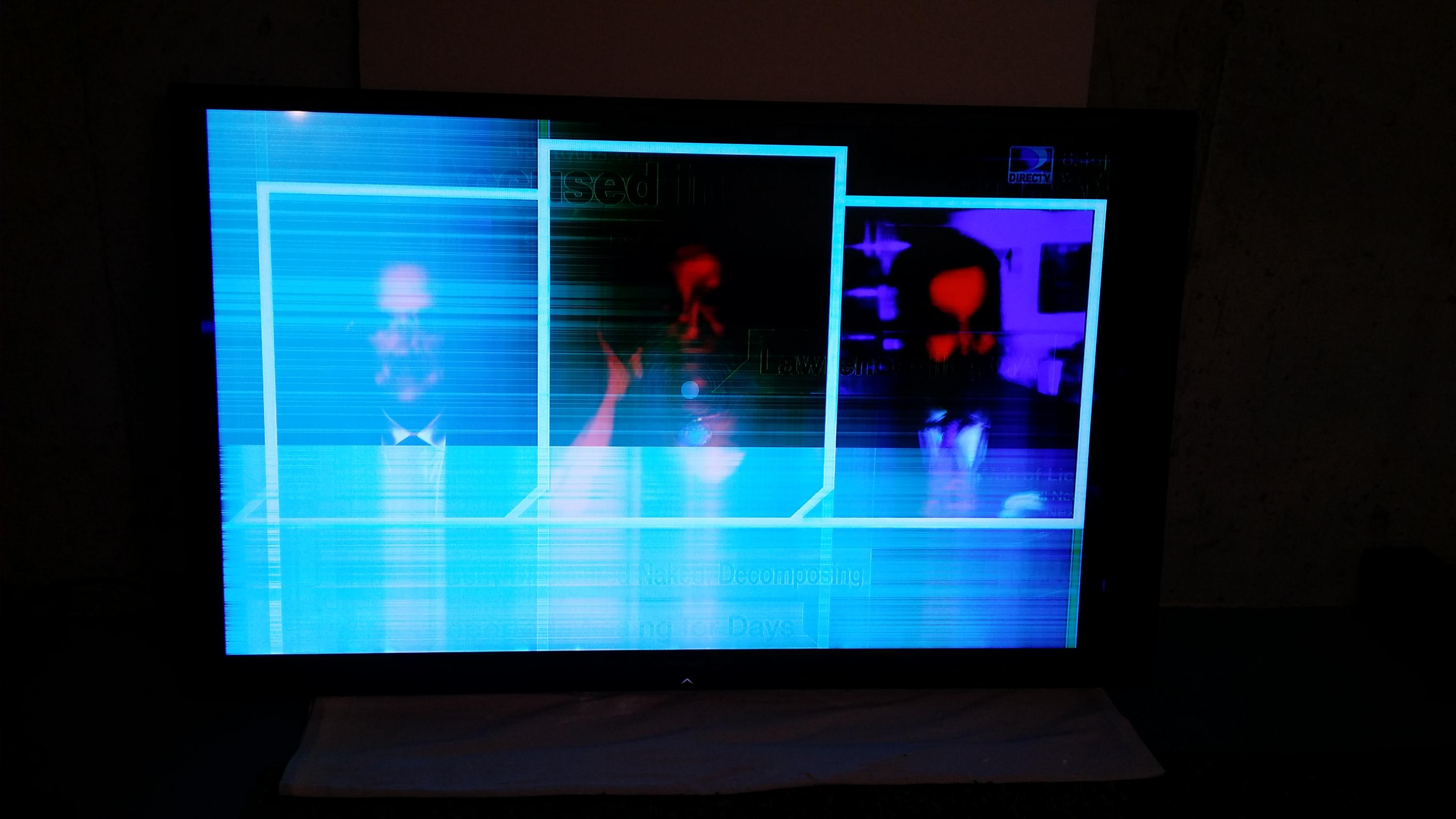

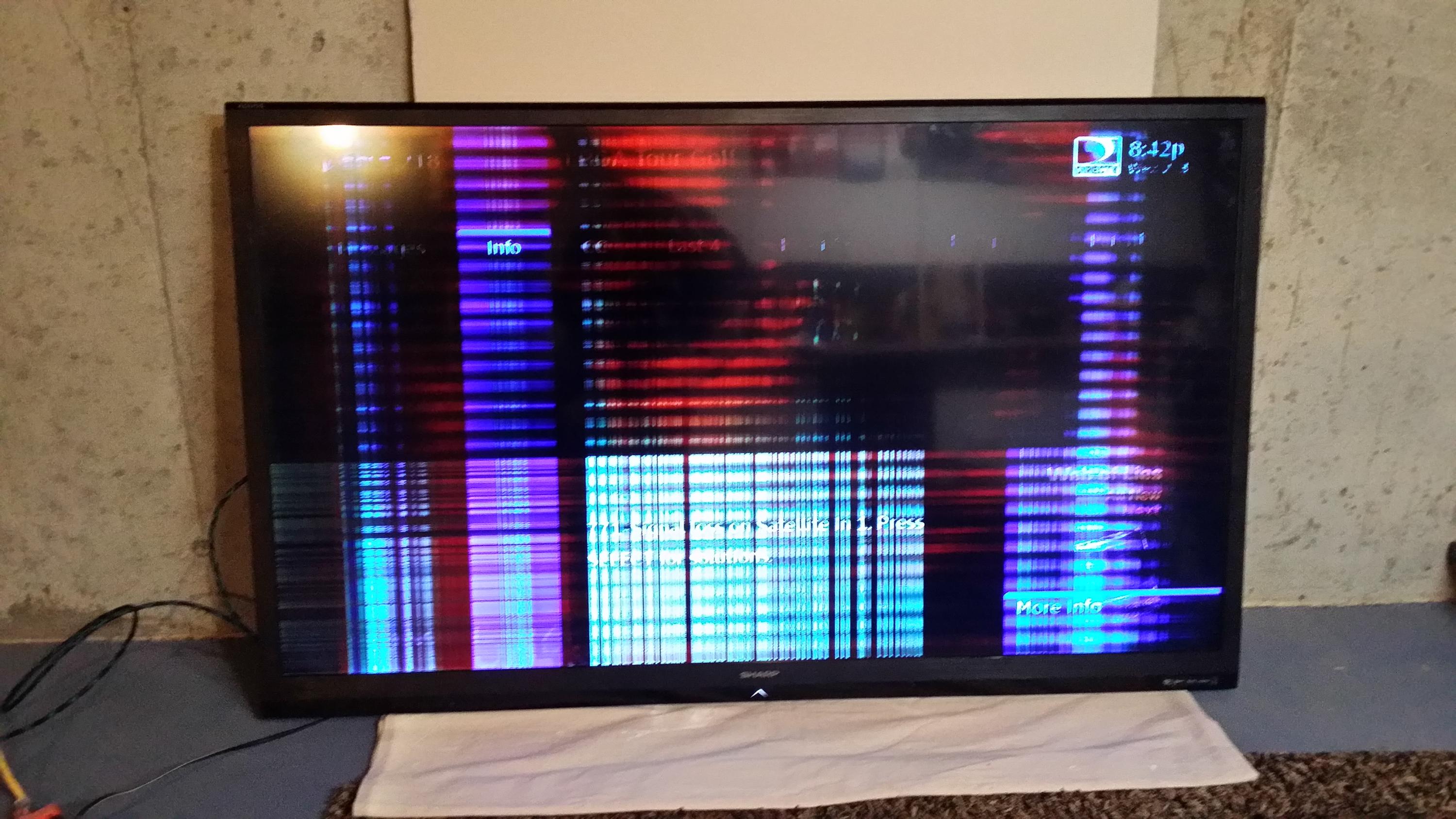

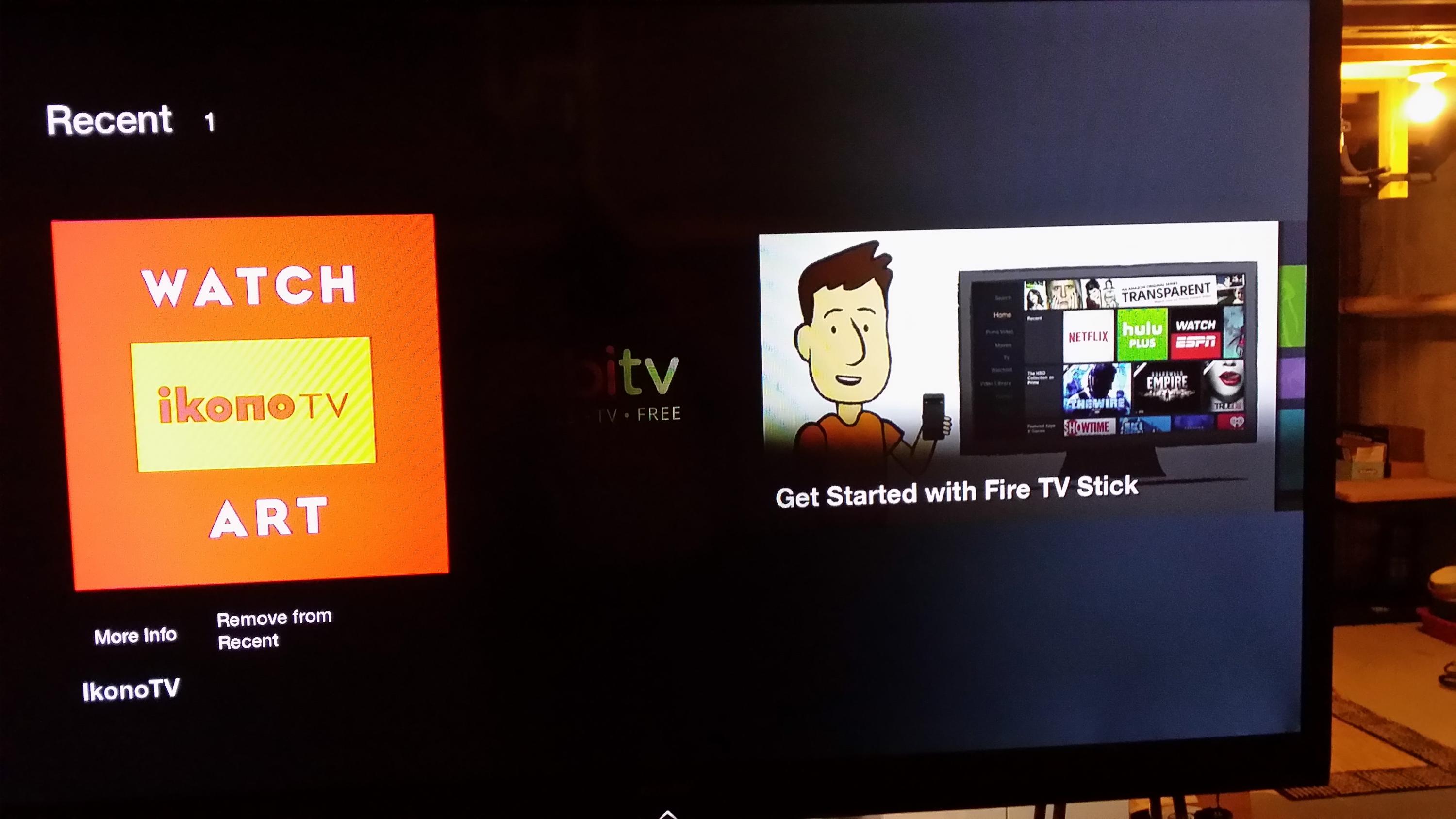

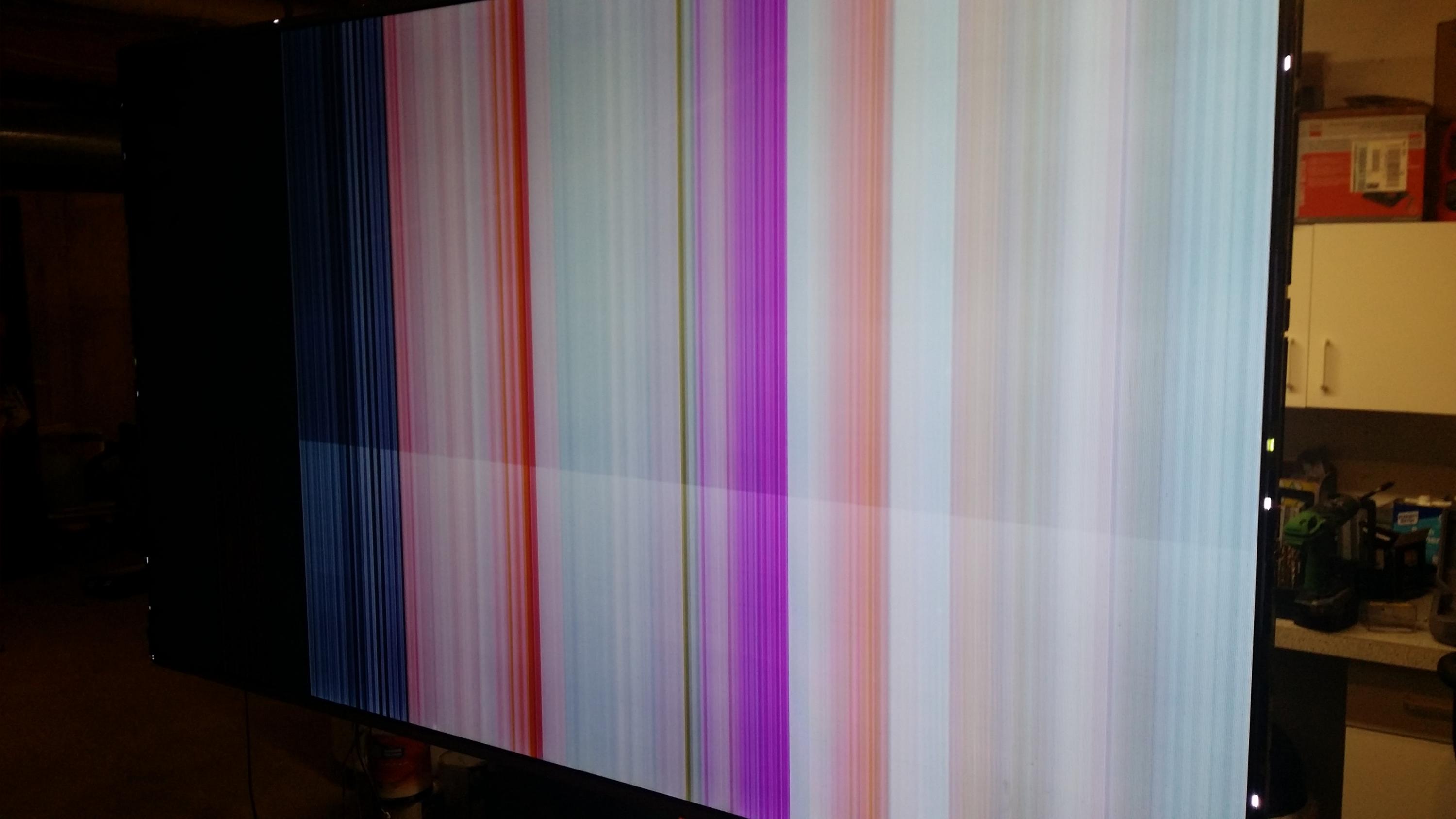

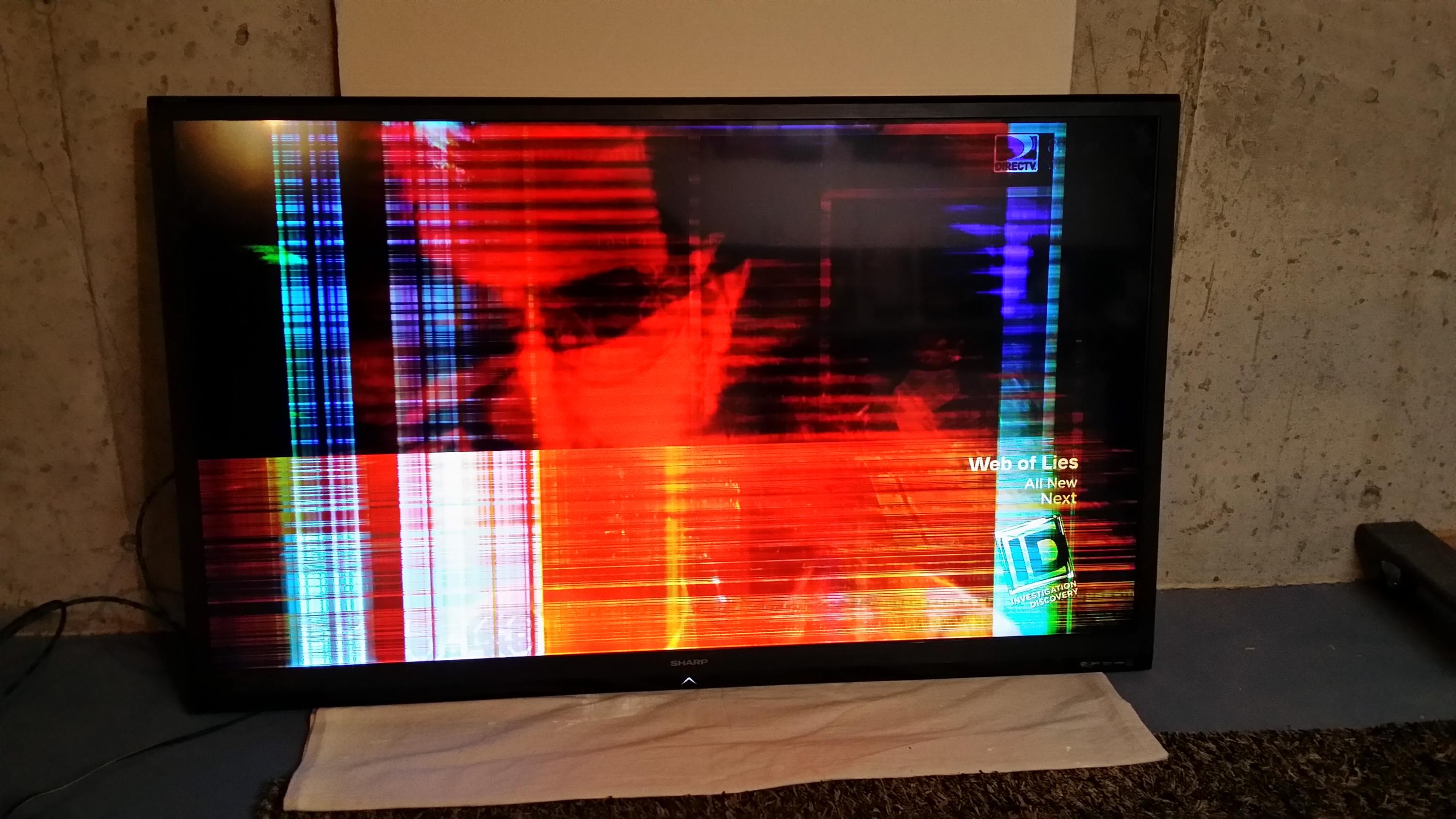

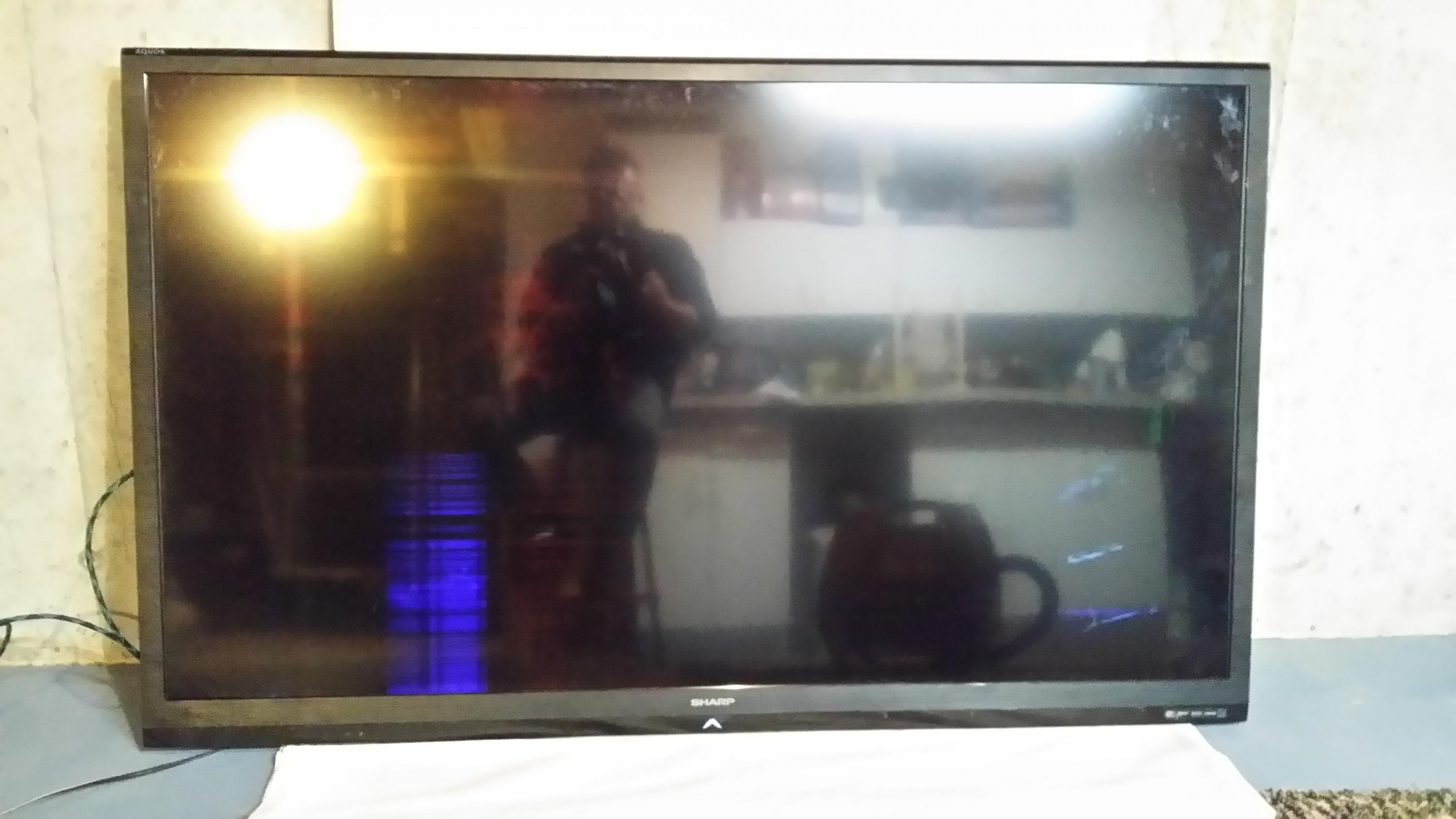

    I recently acquired this set, removed the back panel to check and see that all seems to look in order- nothing burnt or bulged or molested. When first turning on, the LED's only lit up around the left side even though the text displayed the input status on the upper right. With a Sony PS hooked, the text was bright lime green, crimson red, bold yellow and it sorta seemed less than standard def with what looked like 2 big ink blotches on the left side of the screen. I then removed and hooked up direct tv on HDMI 1 and got bright colors and lines everywhere and couldn't tell what channel I was on unless seeing the network call letters in the corner. The colors are over saturated especially red. The strange thing was changing to another channel, you could hear it was on another channel yet the screen image was the previous channel and took several seconds to fade to the current channel. When I turned off the cable box, the screen was still on fading out even after 20 seconds- I'm thinking something popped on the t-con- or maybe the main board?
    If anyone can give me their advice as where to start, that would be great-

    Looks like a failed panel to me. Have you checked the tab bonds?

      X2 on the panel fail. The sharp aquos that I saved displayed some similar traits at various times depending on how well it started up. Your best bet is to follow the "standard troubleshoot" and disconnect the corner flex cable on either lower corner of the display which disconnects the corresponding side drivers. Power up and look at the display. You will likely find your answer shortly there after (ie. one side or the other is bad... :-( ) Of course, the "save" can likely be performed.

        the best thing to do here would be to disconnect the bottom 1 inch ribbon one at a time on each side of the panel connecting the side boards to the bottom boards power of the TV and see which side looks good. Well go from there.
        I've seen the same symptom indicating a bad driver on one side of the panel sometimes it takes out the panel completely and the tcon, Sometimes you get a picture like what you see and others get a really rapid flashing picture with lines going through it. It all depends on how bad the driver has failed. But I guarantee you one side is bad

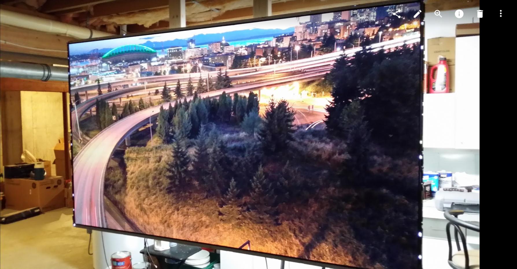

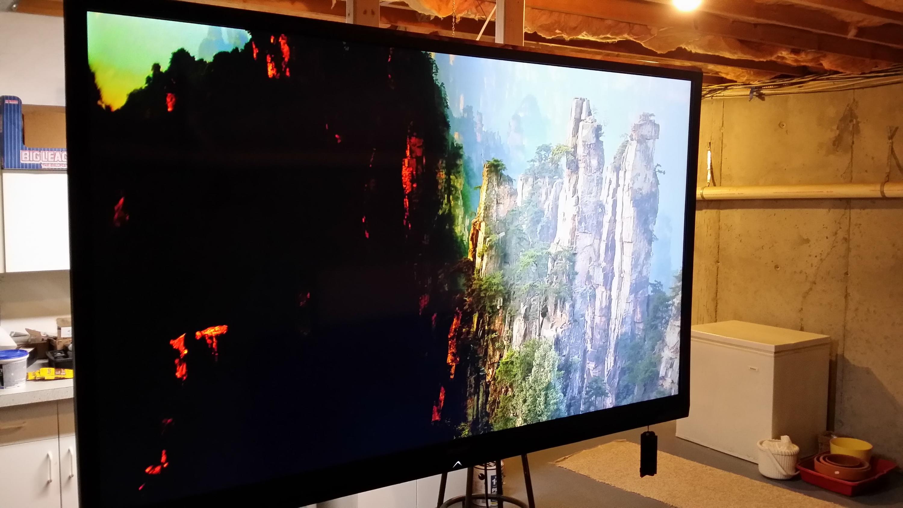

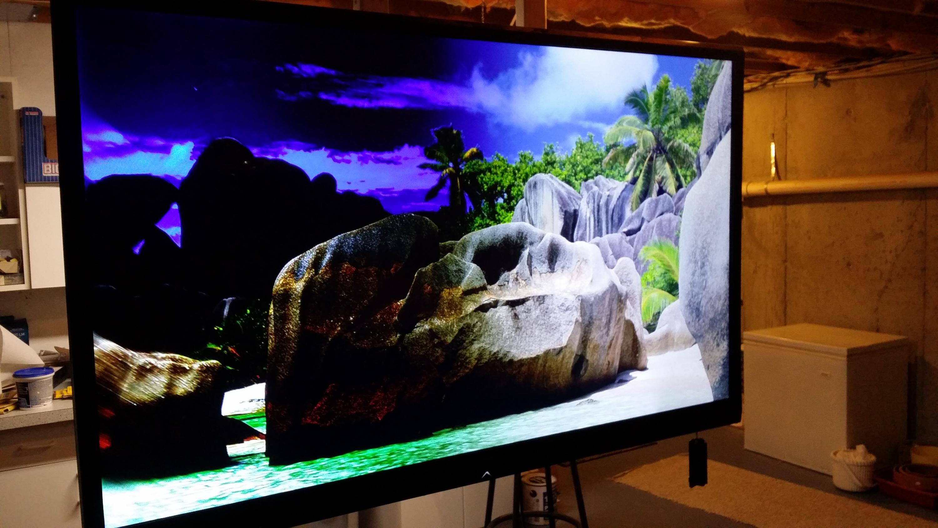

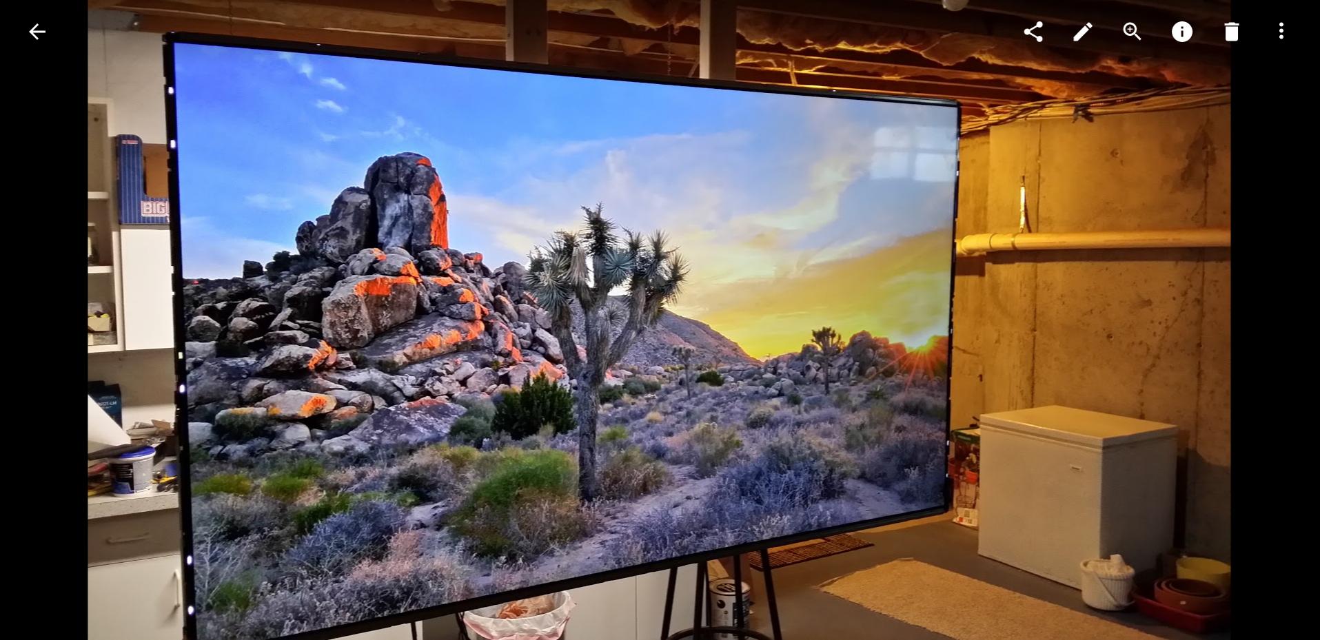

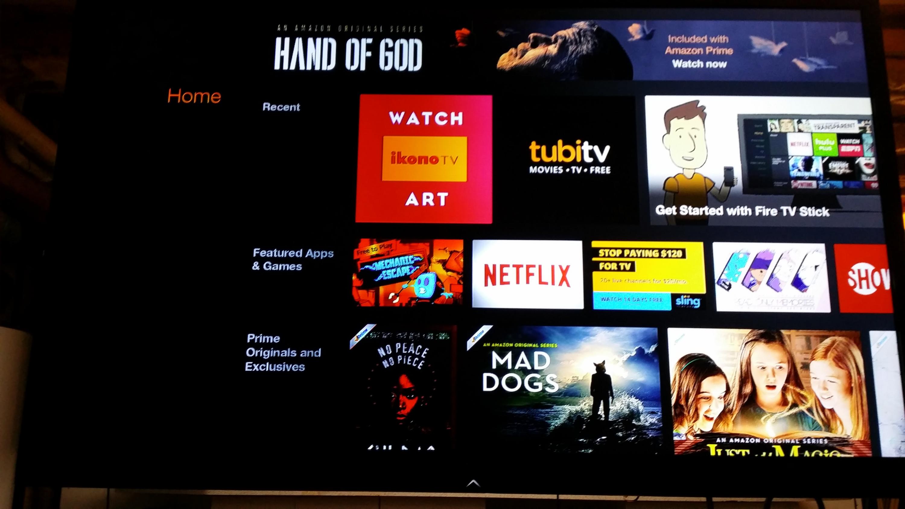

                  Well after finally getting this thing suspended from the rafters in the basement, I was able to work on it... so I checked all cables that I cleaned and turned out the LVDS into the t-con wasn't quite pinched in all the way so when powering on- all the edge LEDs initially came on and appeared to be normal. I had the fire stick plugged in this time and it shows what appears to be a big vertical black blotch in the background about a foot and a half wide on the left middle which sort of changes the red to orange in that area and to the left of that and the right side of the screen seem normal/ much brighter which appear to be the only issue. On to the corner tab test. After disconnecting the left side and powering on showed no difference at all but when disconnecting the right side and powering on showed nothing but vertical lines. I'm not sure what that means but if that's normal then I'm thinking t-con board issue?

                      Hey bud- I hadn't disconnected both at the same time- I unplugged, disconnected one side then powered on, powered off and repeated with other side. To my surprise- after cleaning all connection etc. with alcohol pads then reconnecting, I read other stuff online pointing towards the backlight inverter boards which seem to obviously be to me the boards directly underneath so I figured I'd clean those too and then come to find the left tab's bar wasn't locked down. Once locked down the picture is perfect.

                          OK... set fixed... great!

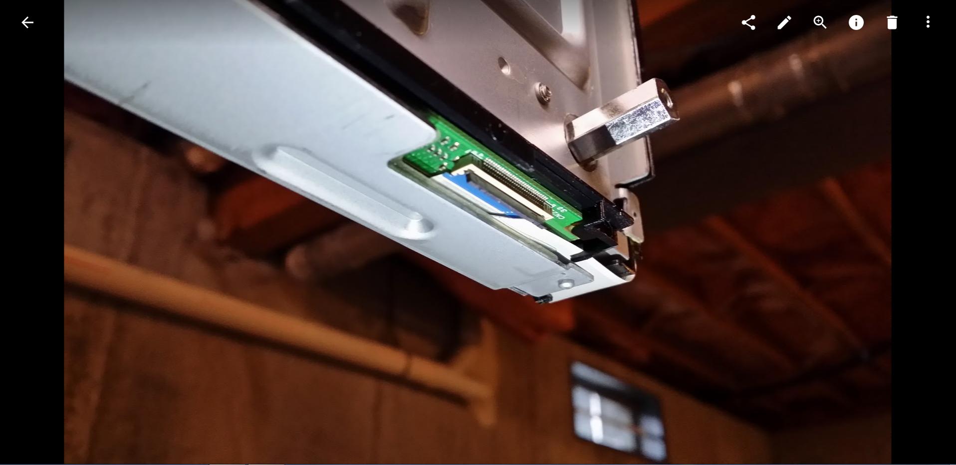

                            The culprit

                              Wow nice find!! Add that one to the list of possible scenarios that these panels have when malfunctioning..

                                Check put this video on the same problem I was having... of course it didn't work for me since the tab wasn't locked...
