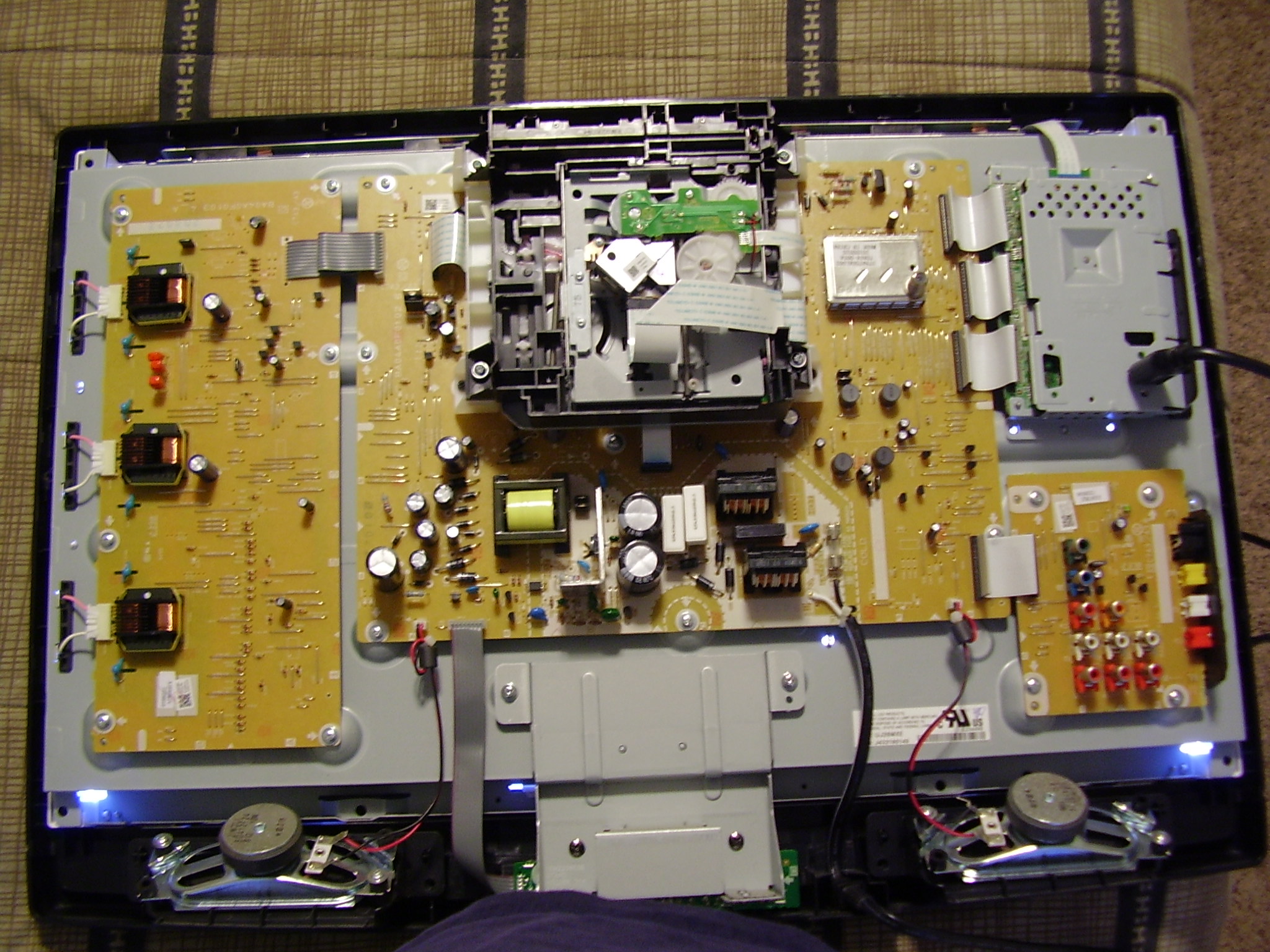

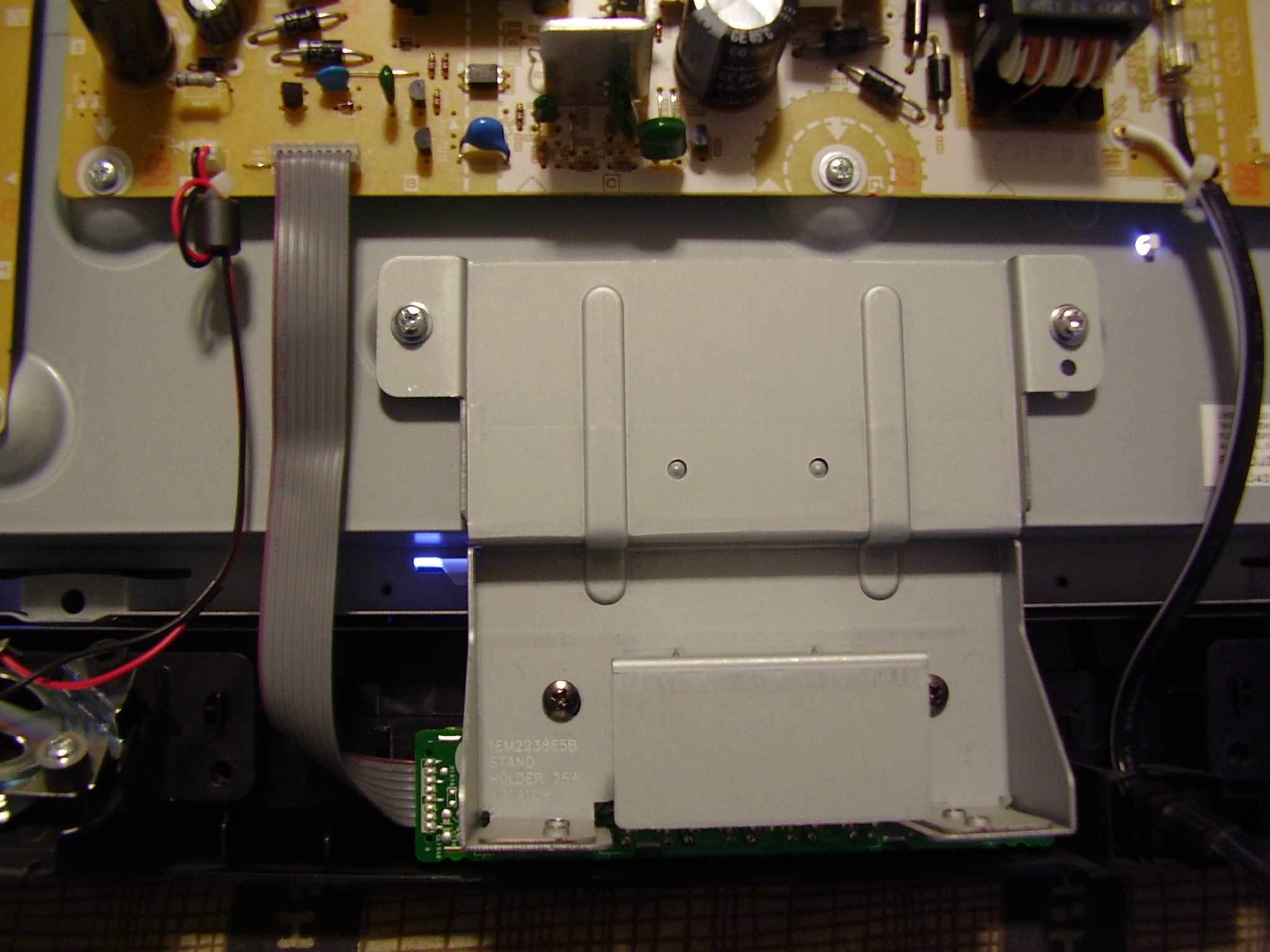

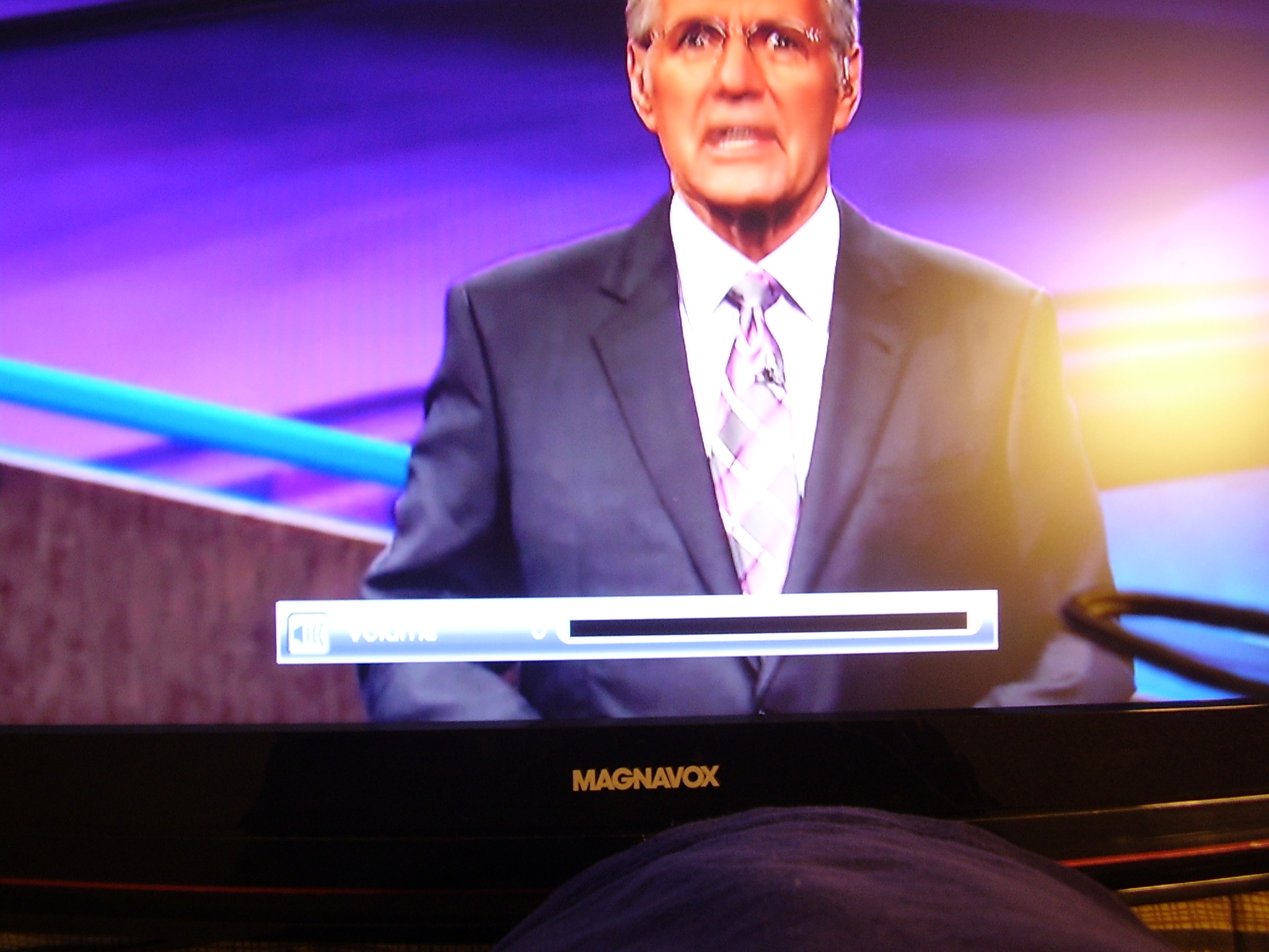

    Hello Everyone, Good to see this site up and running again. I have a Magnavox 26MD301B/F7 when I plug it in it comes on and the volume bar comes on the screen and turns itself down to zero. All buttons do not respond. The picture itself is fine but can't get volume to go up and stay up. Any ideas would be very helpful.

      i had this issue a few days ago it turnred out it was a faulty momentry switch which was stuck closed what type of switches does the button board use?

        They are push buttons, that is what it acts like but when I push the buttons they feel like they are free.

          mine felt good too but when tested with a multi meter it was showing a reading when it should of shown open circuit maybe worth taking readings on yours these are the ones in my set that was faulty

            Disconnect the cable going to the buttons and see if that corrects the problem, if it does then change the button or better yet all of them.

              Swap them out with some replaced buttons. I fix those on TVs all the time, it is a common failure.
              Some buttons are 2 pin, 4 pin, or 5 pin (grounded) but they are mostly standard and can be salvaged from the buttons from other tv's including CRT.

                Exactly what I did, and it's now working perfectly. Thanks a bunch guys!
