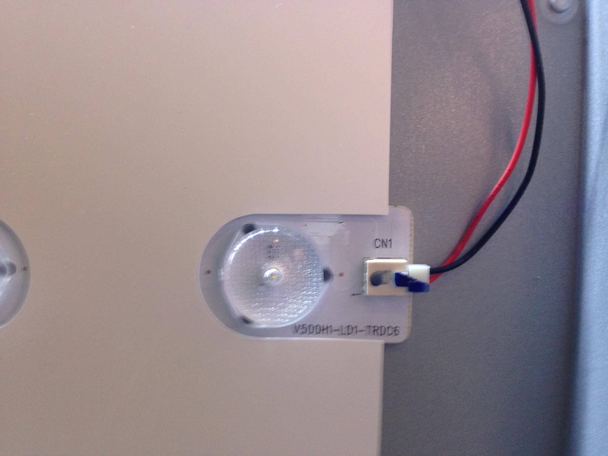

    I have a 50lbrq45 I have torn it down completley.
    First symptoms red standby light would change to blue no audio or video wouldn't turn off. After tearing it down checking voltages everywhere I baked the main board at 400 degrees for 9 mins. The did the flashlight test and found I had picture and audio but no backlight. One thing I noticed is I could turn the set off after I baked the board. I am not 100 percent baking the board did anything and maybe I turned off before the usual shutdown occurs. I only have pic and sound when I unplug the wire lead for the led,s otherwise they all flash and the unit shuts down. I individually plugged in each light strip and two seem to flash brighter then two others. I am at a dead end

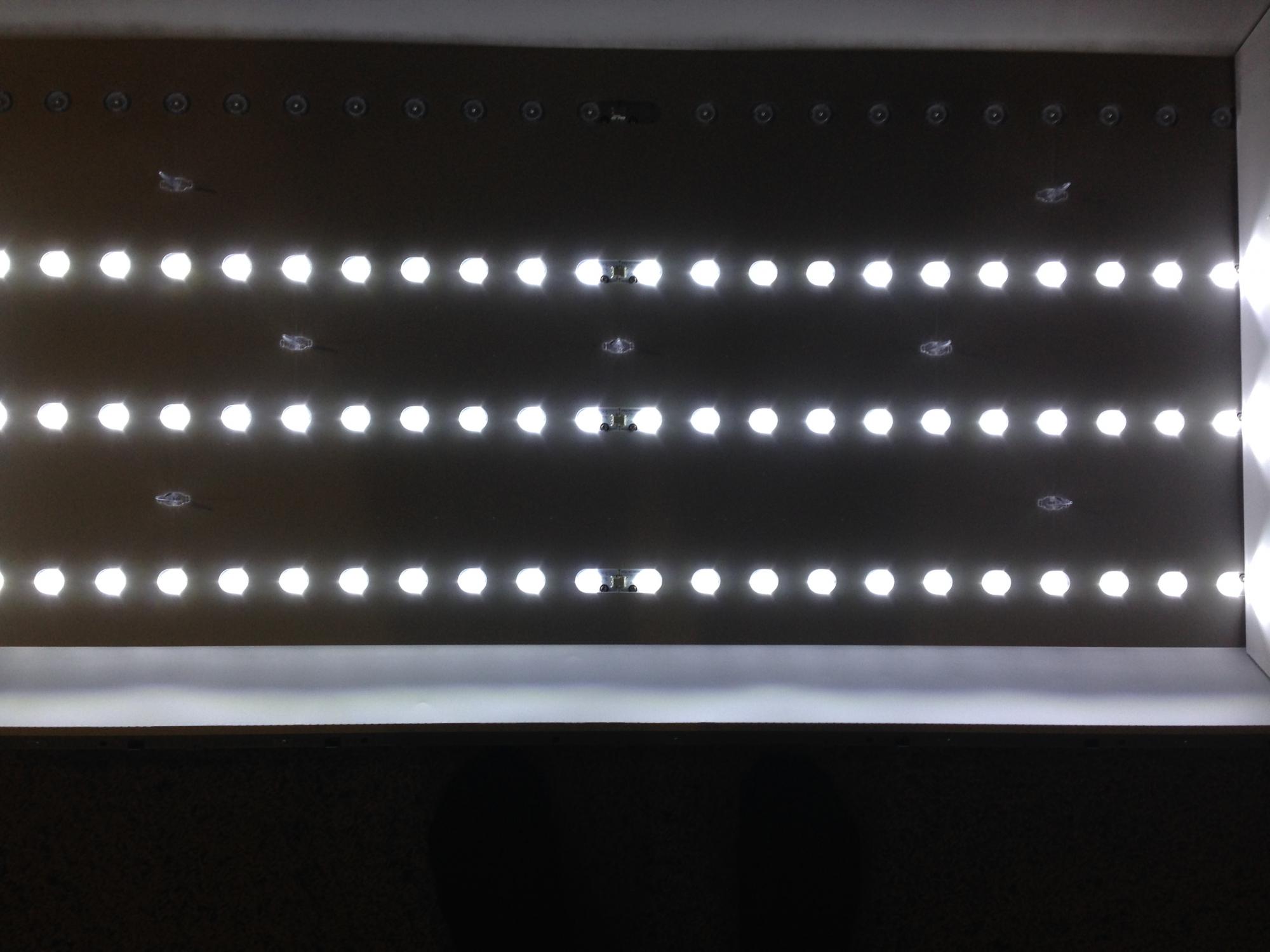

                I had one of these a few months ago with 2 bad LEDs on one strip. They were shorted (not open) and I found the problem by unplugging the dim wire from the power supply, which then made the backlights turn on (not sure if it was the same version as yours, so I don't know if that will work on yours), and then measuring the current each strip was drawing. The current on the bad strip was almost double what the rest were.

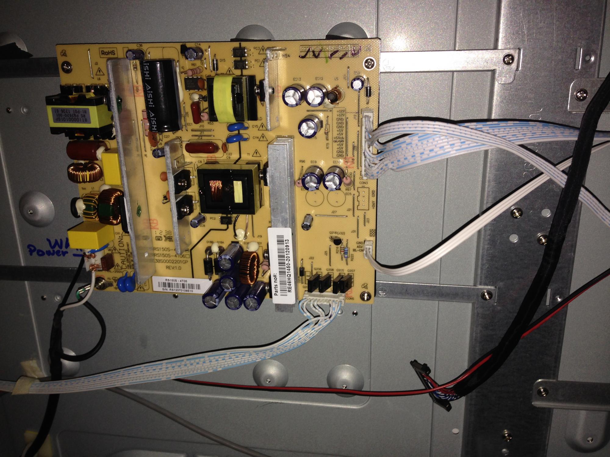

                    Just disconnect adj and see what happens. As for disconnecting individual led strips, it won't work like that. The LED drive controller is going to shut down for undercurrent and overcurrent. So, when it detects that no current is being drawn (because a strip is unplugged) it immediately shuts down. Pictures of your boards would help since we don't know which version you have.

                      Not sure where adj is?.
                      Here is p supply

                        You guys rock looks like I need a light strip.

                            That's the one I had. The 3 wire harness on the lower right. Pull the center wire out and the backlight should power on.

                              Remove the white reflective sheet so you can get to the strips. The ones which usually fail are where strip doesn't make contact with the metal. You can test them with a multimeter set to diode test mode.
