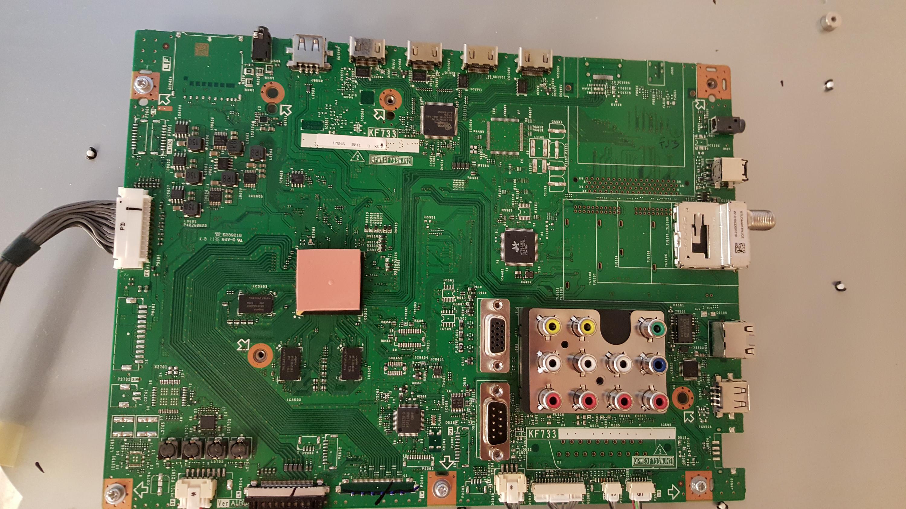

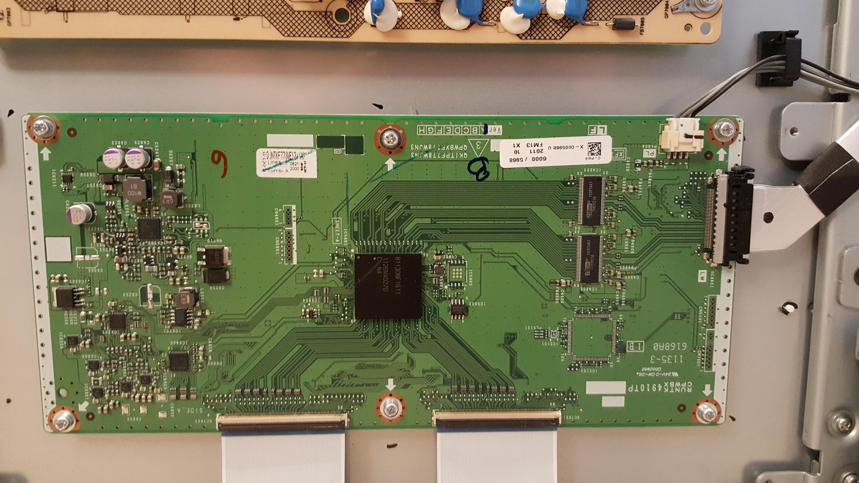

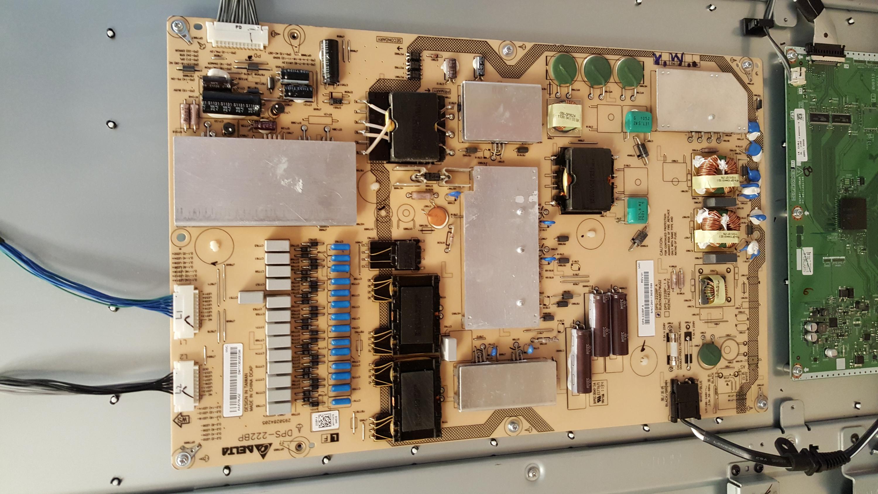

                                  Re: Sharp Aquos 70" LED LC-70LE632U does not power on
                                  We can help a lot more if you please post good clear pictures of the whole chassis, and then pictures of each board using the manage attachments button, which is found by clicking "go advanced" under quick reply.

                                      #58
                                      Ok here are the pics of my set.
