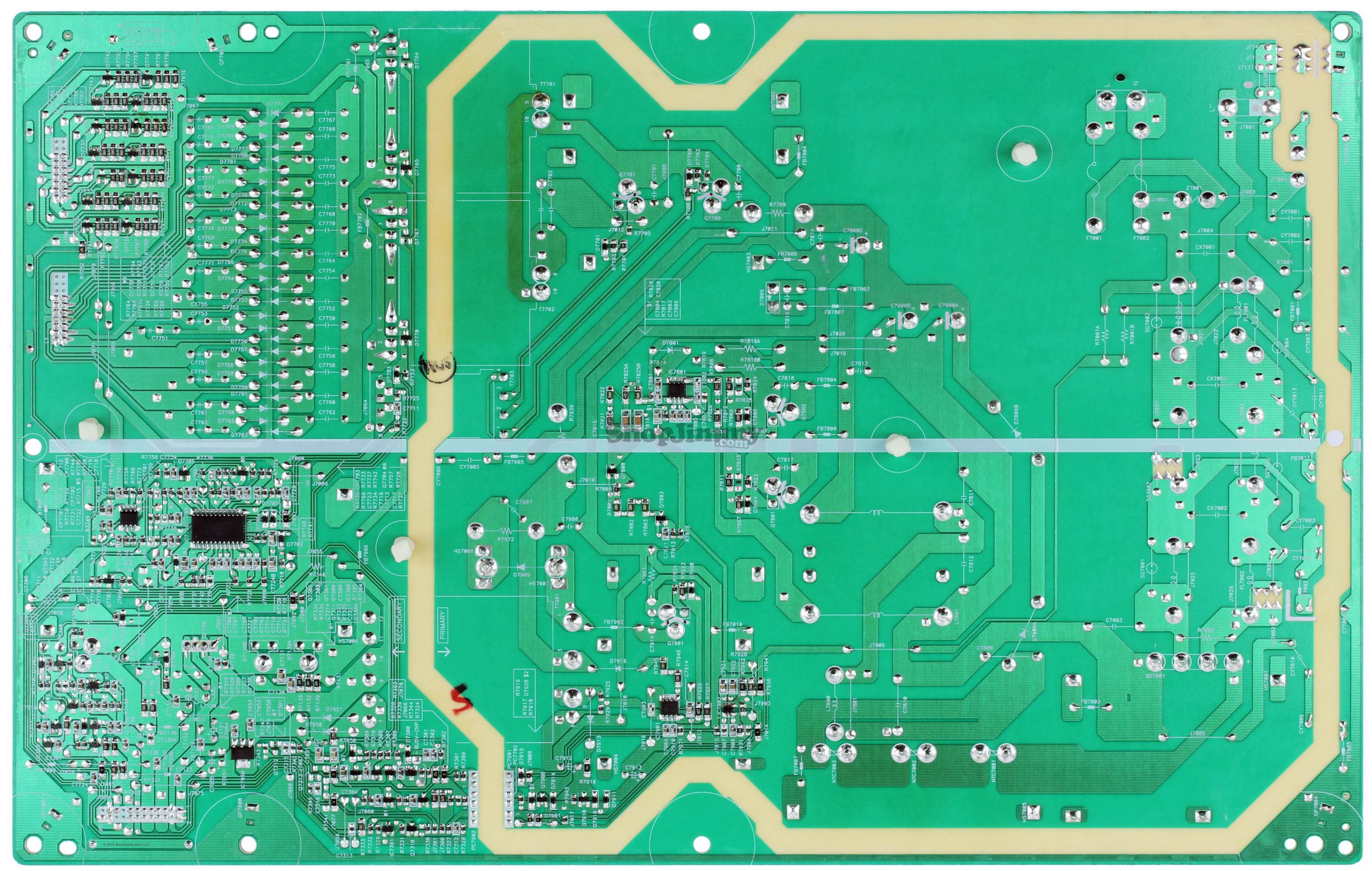

      Sharp RUNTKA857WJQZ (DPS-222BP, 2950284203) Power Supply Unit
      http://www.shopjimmy.com/sharp-runtk...pply-unit.htm#
      Pictures provided by shopjimmy.

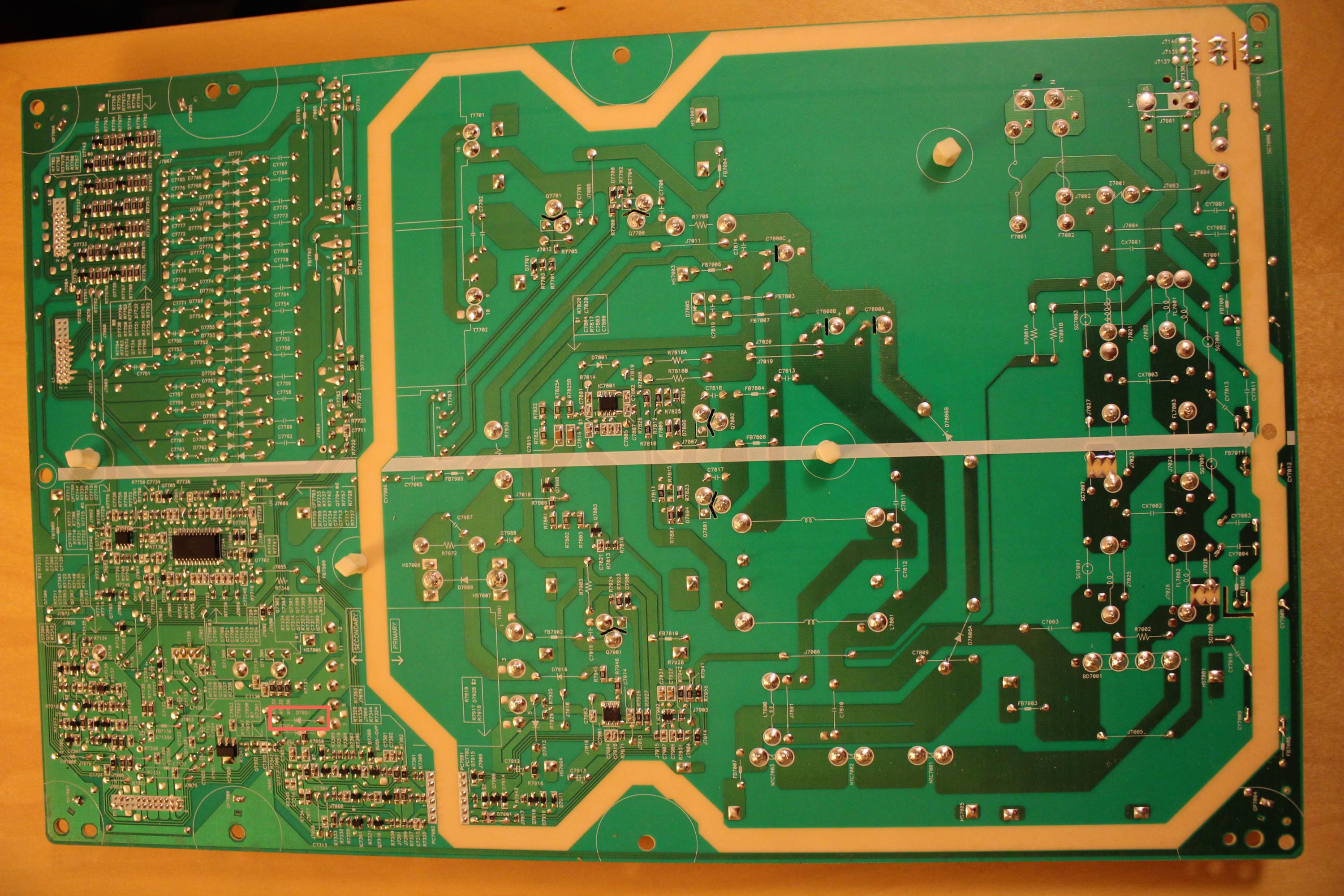

            While I desolder the diode and test it, here is a high resolution image of the back side of the power board with the diode D7951 marked in red in the lower left corner.

              I uploaded the pix from SJ on post 22.

                Desoldered one end of D7951 and it still measures 0.0 on the multimeter diode test. The following name is marked on the diode SB2100 (first row) and 050 (second row). Not sure of the letter 1 or I in "SB2100".

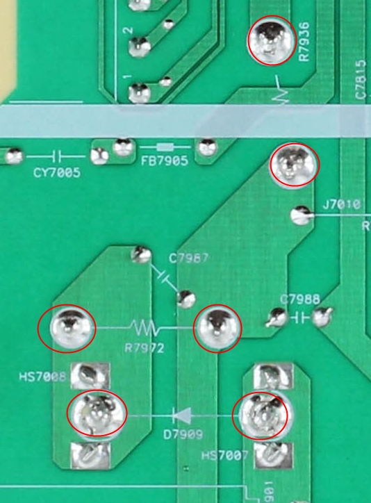

                            Can you please point to me the numbers marked on the board to know where these legs and rivets are located? Thanks.
                              #34
                              Re: Sharp Aquos 70" LED LC-70LE632U does not power on
                              Through hole rivets samples.
