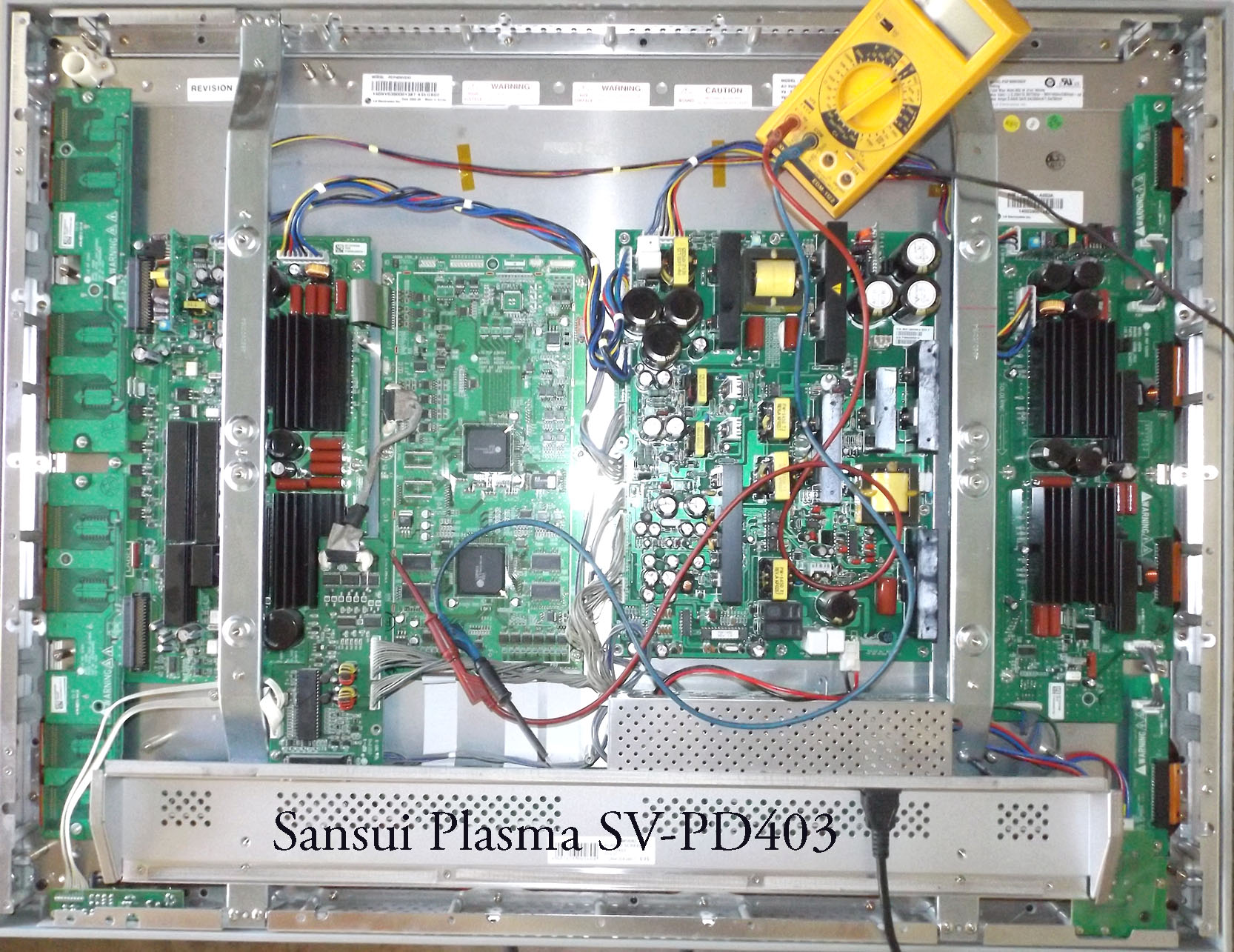

    Sansui SV-PD403
    Set does not turn on.
    When pressed, Standby light flashes blue some six or seven times and returns to yellow.
    Nothing else happens.
    Checked for dry joints, bad caps, plugs, visually there's nothing wrong.
    Can't find the diagram, also.
    Y and X boards look good.
    Tried to unplug some power plugs, nothing.

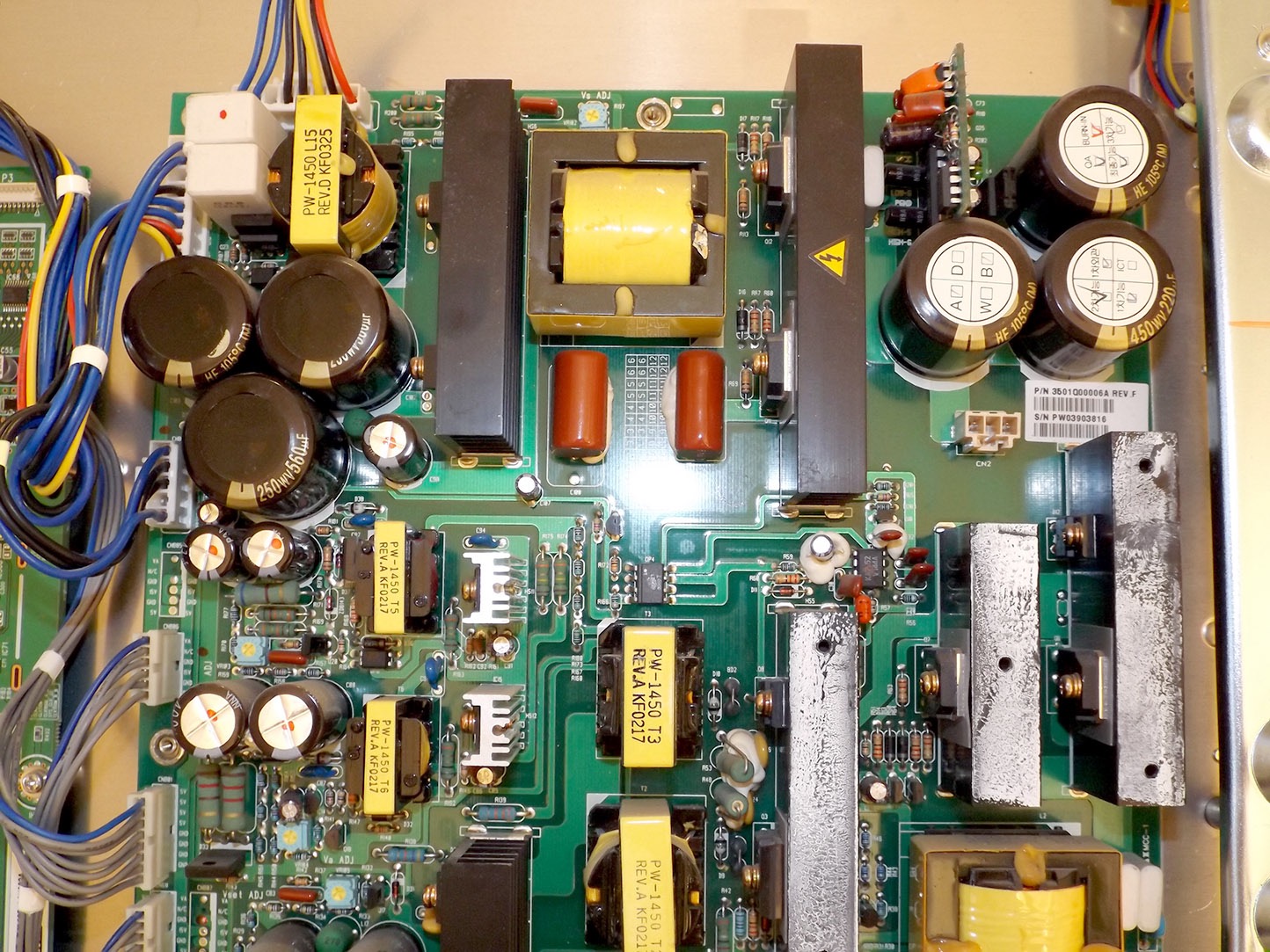

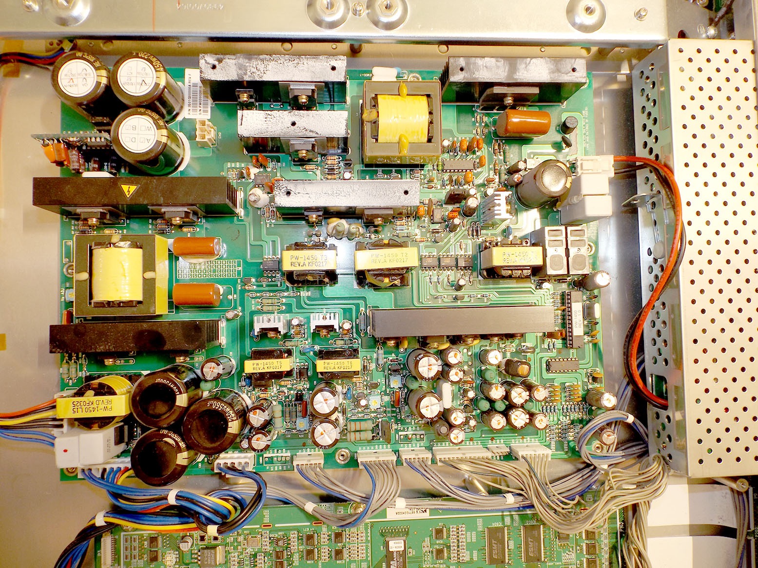

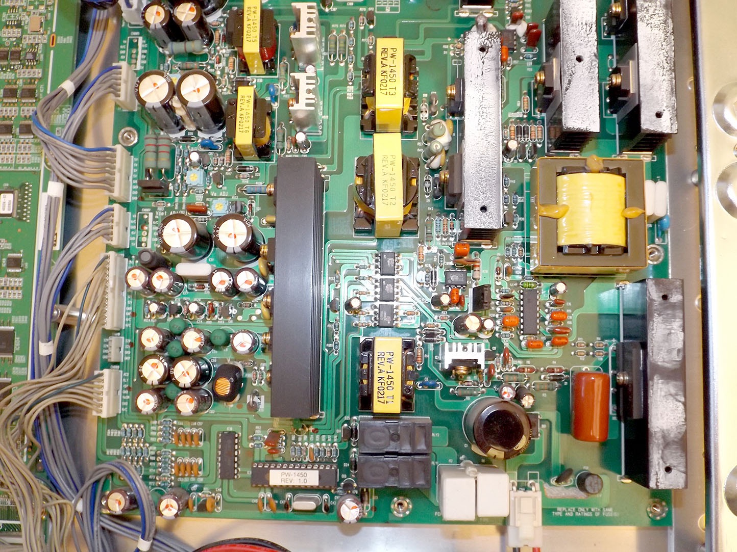

        Ok, need close up images of the Psu.
        • burntfingers
          • Jan 2011
          • 148
          Re: Sansui SV-PD403
          OK, here are three new pictures of Power Supply board - one taken on its length, the other two half of its height each.

            Re: Sansui SV-PD403
            Ok right do you get Vs & Va voltages when you try to turn the Tv on ?

              Re: Sansui SV-PD403
              They both read zero volts at switching on.
              I only get one of the 5 volts, nothing else.

                  Re: Sansui SV-PD403
                  I do, and already checked the high wattage ones, they are OK.
                  Didn't find any fuse ones, couldn't find any.
                  The power can only come on after the two relays are activated.
                  Could I bridge them to see if I get power?...
