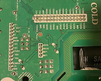

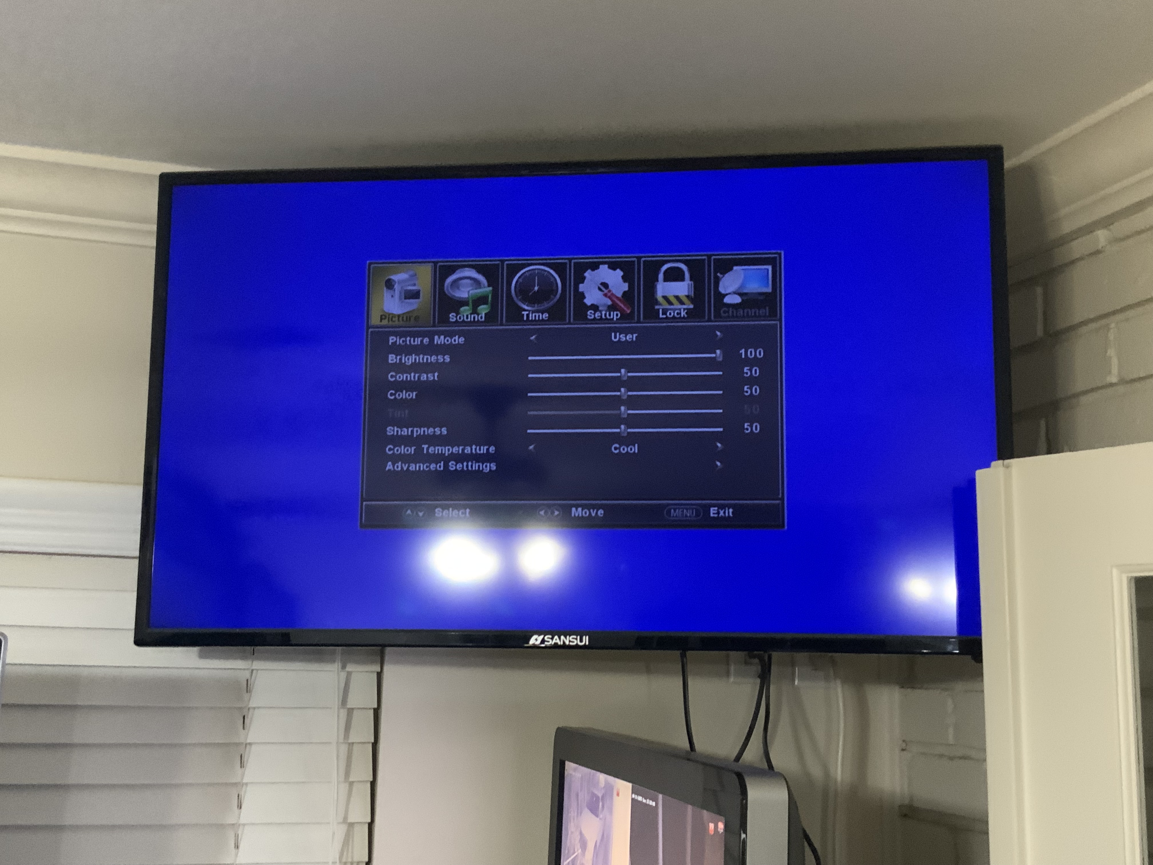

    I have a sansui that just started having a dim picture, adjusting backlight settings up or down have no effect on display. I went ahead and ordered some backlight strips for it but find it weird that changing the setting has no effect. Could it be power related. Where should I start? Thanks Michael Click image for larger version

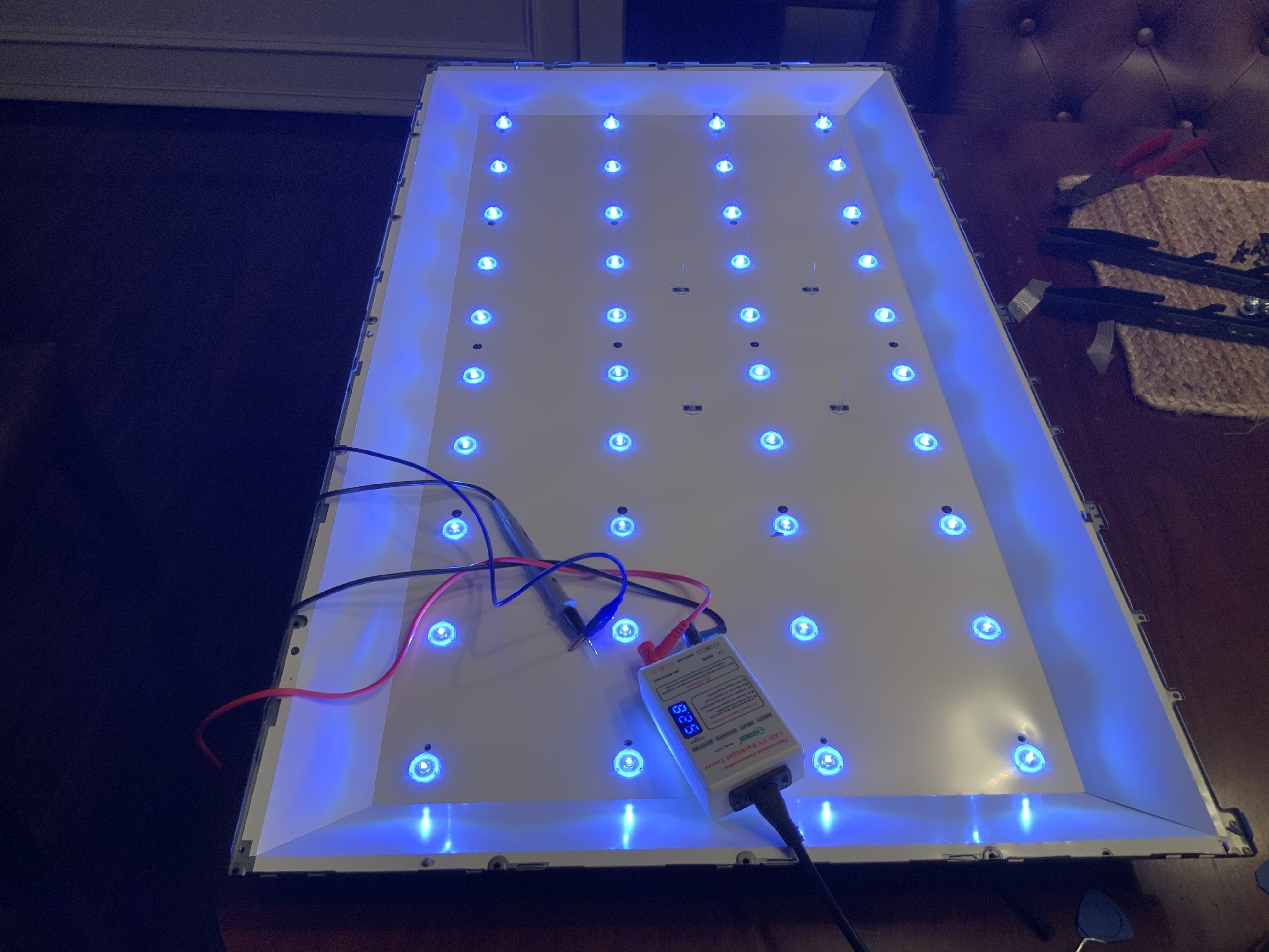

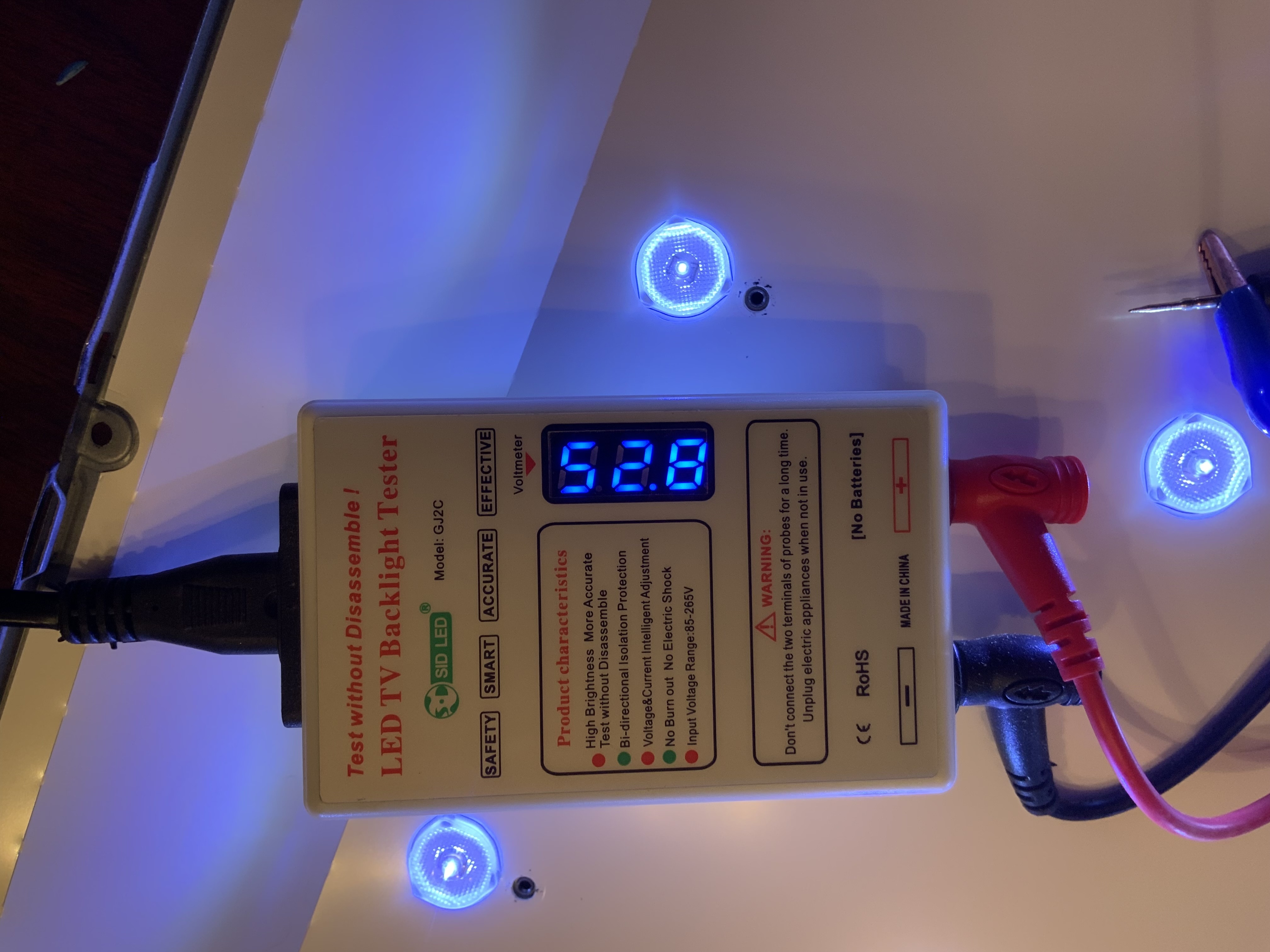

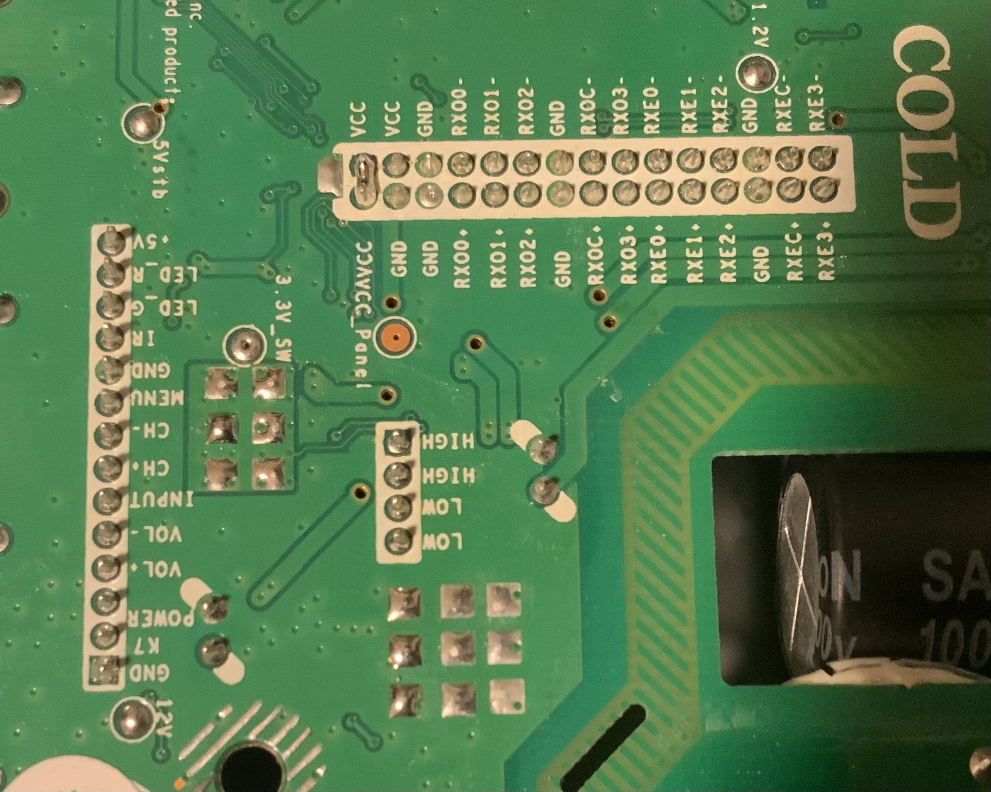

    Got it apart, no backlights out hooked backlight tester up and it’s only pulling 52.8 volts. ;there are some bulging caps on the board so gonna go ahead and replace all those. The board has very few voltages listed on it so not real sure what to check. Click image for larger version

      You bought leds for nothing, there was a cheaper way to do, test first the leds then eventually buy them, the caps havento be replaced, after only after you can continue diagnosing

          Please show yours PSU Bl circuit from topside and down side too , you seem have sync SMD R Value changed to higher
