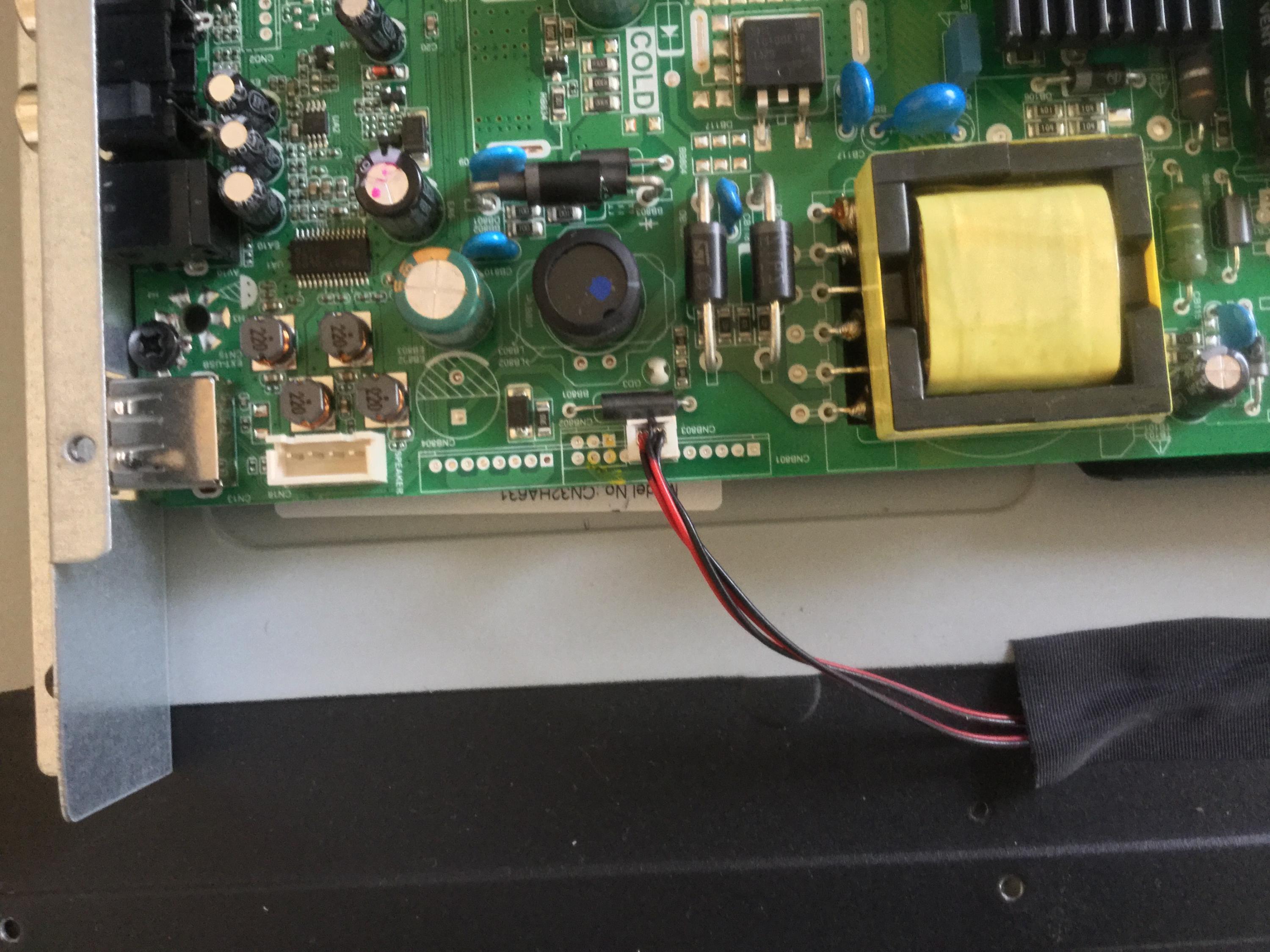

    Found the output to the led backlight.
    21.34 v is measured out from connector cnb803 to the backlight can someone confirm this the correct reading?
    Measures open on plug to the led backlight.

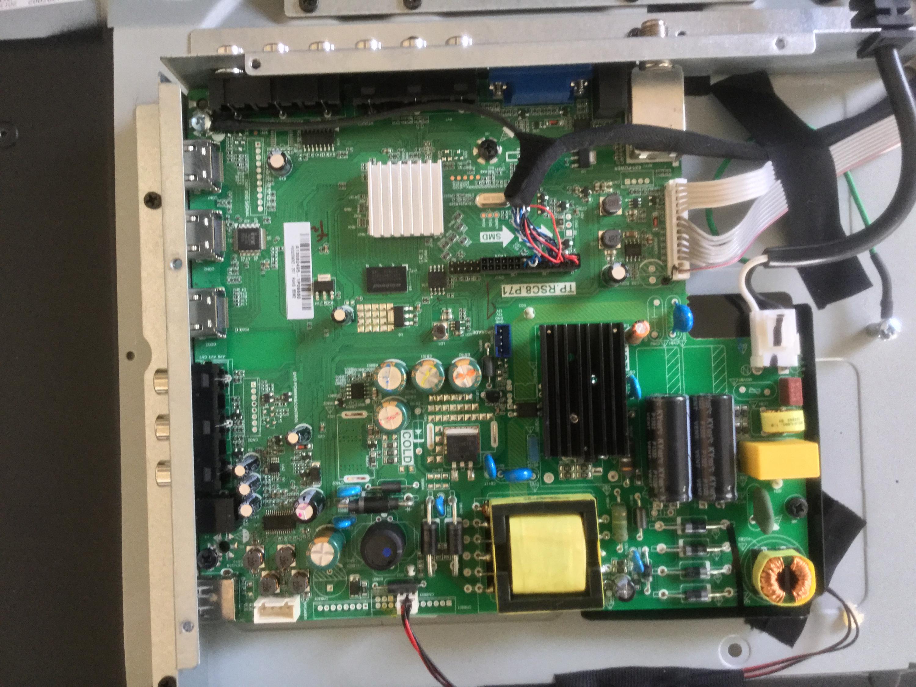

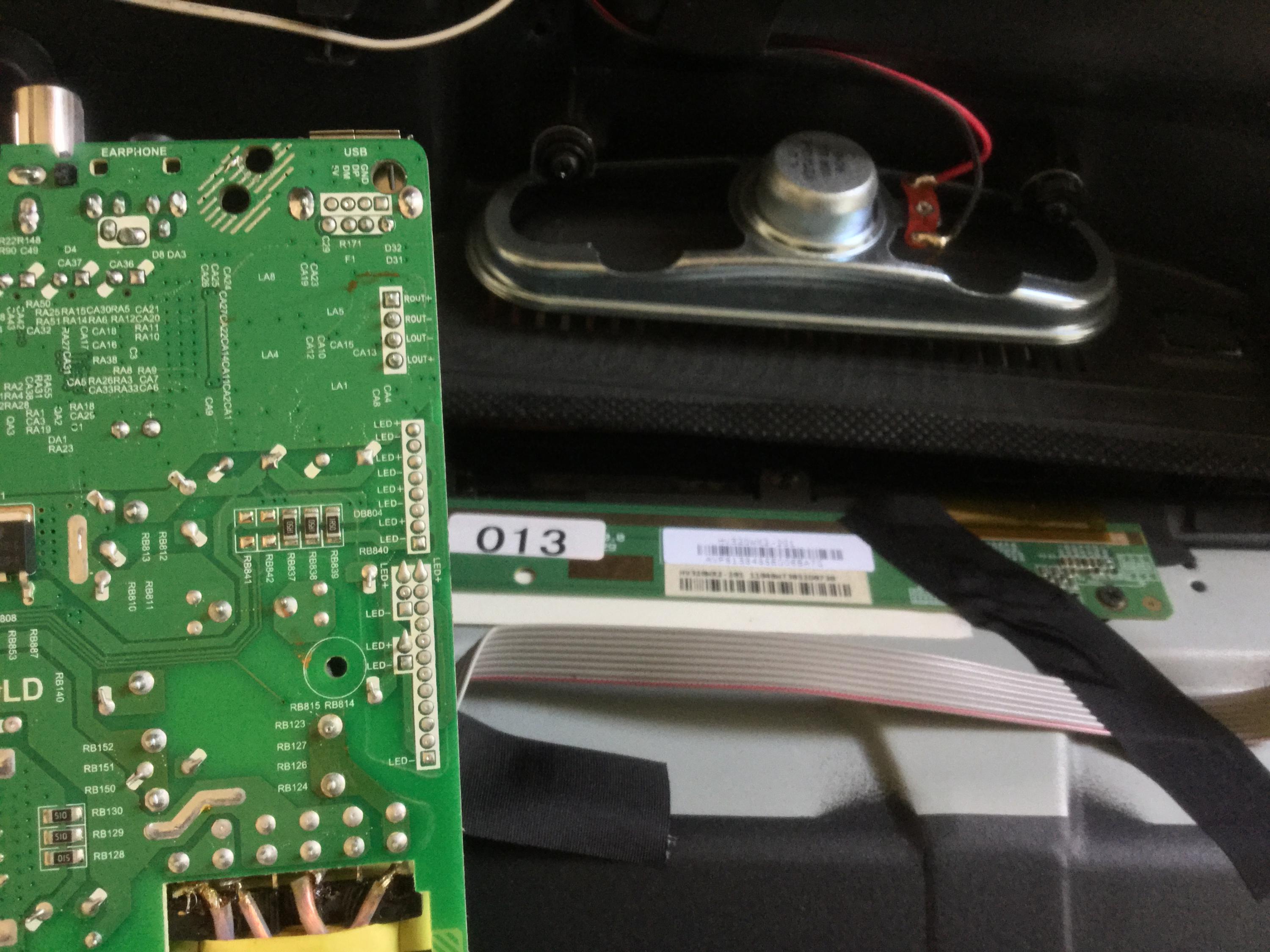

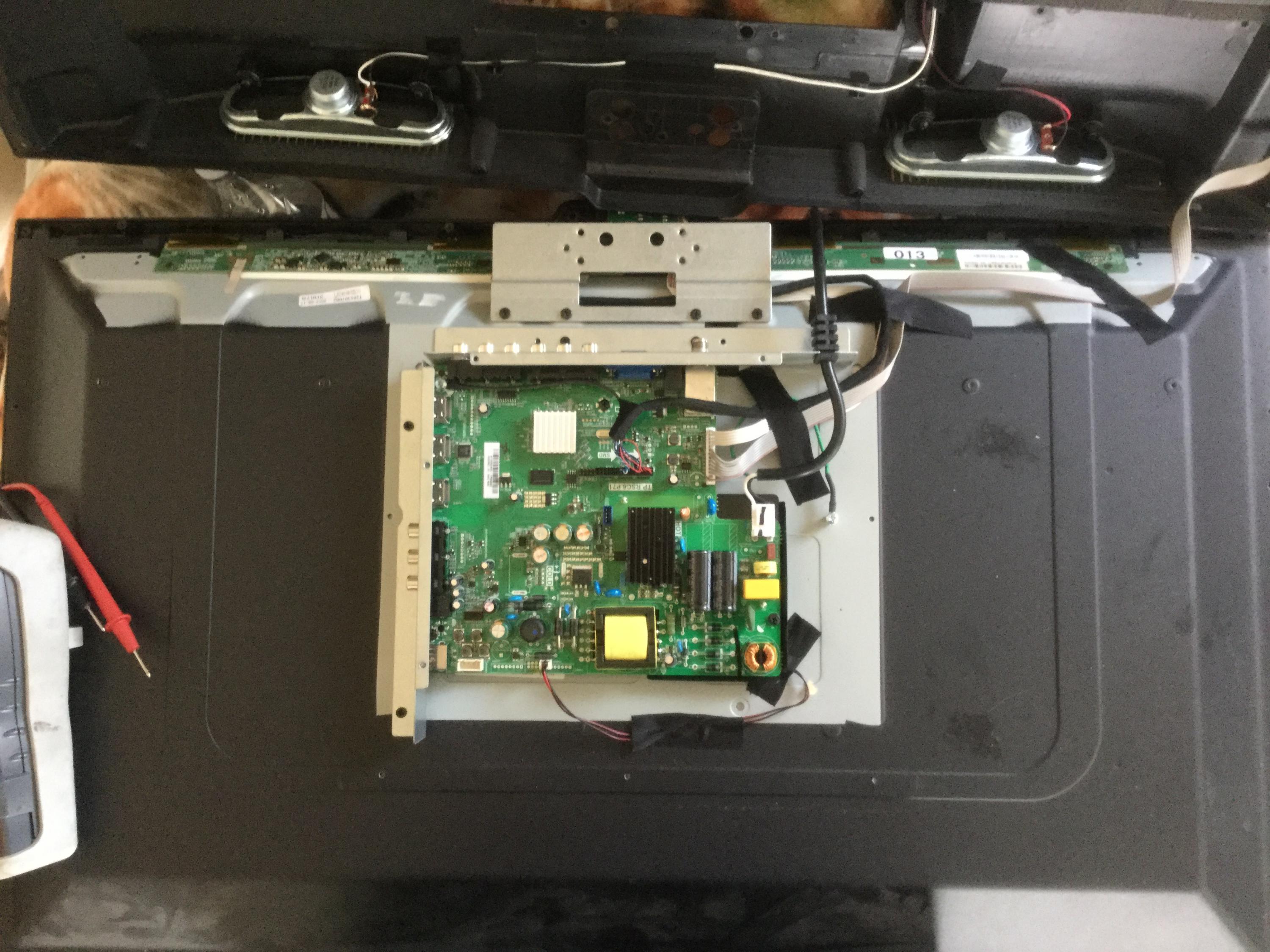

    Lets start by uploading the pictures of the whole back side of the TV so we can see how all the boards are connected together, then the close up pictures top and bottom side of the board around the LED connector.
    21.34 VDC is too low, I expect higher than that.

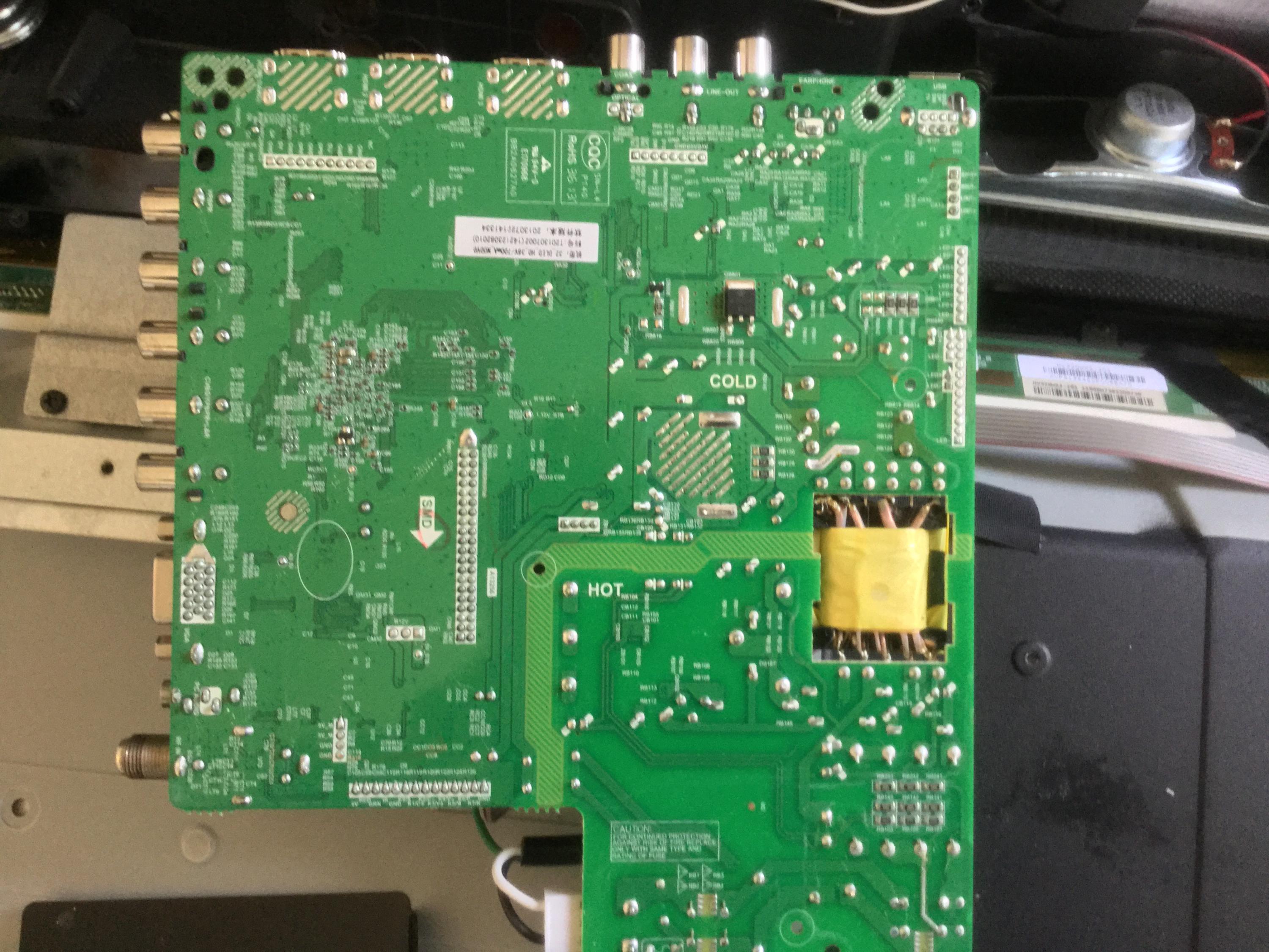

      Waiting for a reset for the back of board

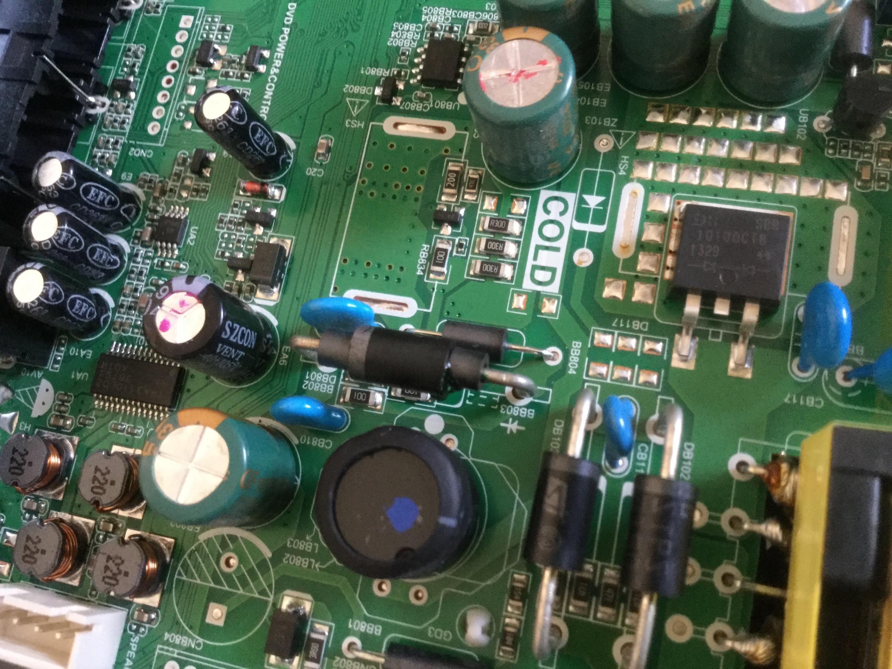

      However most likely will not work due to just notice a diode that may be bad
      See the pics
      update: added the back of board plus diode near connector in question reading without pulling from board I should have a reading in the kilo ohms
      8.53 M ohms with diode set reading of .262 V i'll need to at least replace that.
      either way I suspected at least 40 to 60 V for an output to the LED's
