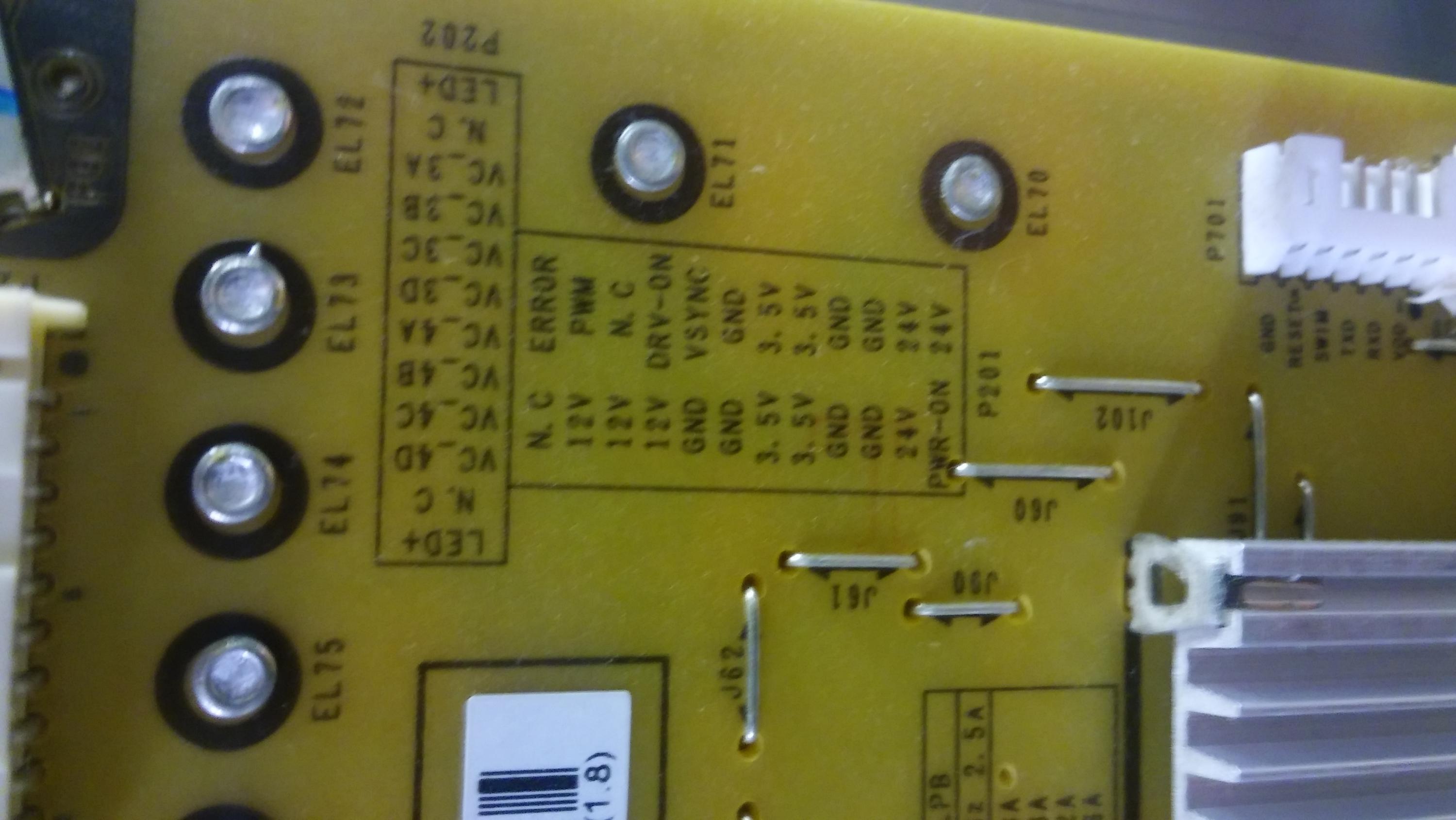

got this set when I power on backlight will come on then after a few sec. backlight shuts off but power is still on. I have all proper voltages but the last 24v where is says pwr on is only 3.5 so im not sure if its suppose to be 24 or not?

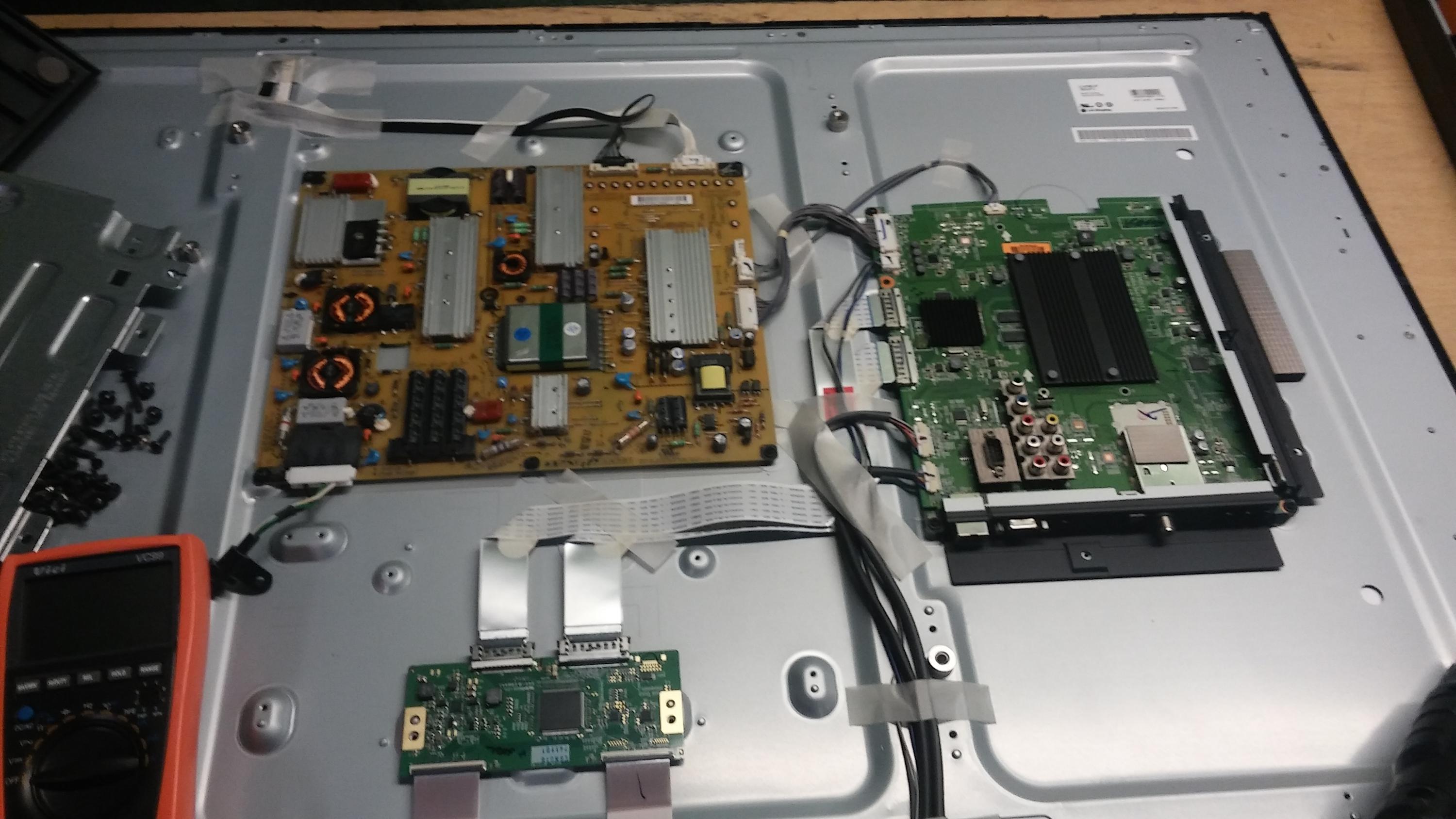

Please upload the pictures of the whole back side of the TVto show all the board and pictures of the whole power supply board top and bottom side.Never stop learning

'pwr on is only 3.5; That is the same as PS-ON, it is the control signal form the main board to turn on the rest of the power supplies, so 3.5VDC on the PWR-ON is correct.
P201 is 24 pins connector.Never stop learning

Can we see the pictures of the whole back side of the TV?Never stop learning
