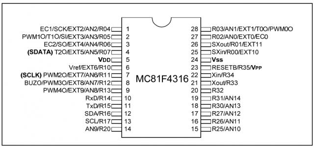

    PSU = p/n EAY60912401
    IC701 = MC81F4316
    IC701 markings:
    • V1.2A-D99D
      F4316MSF17
      KOREA

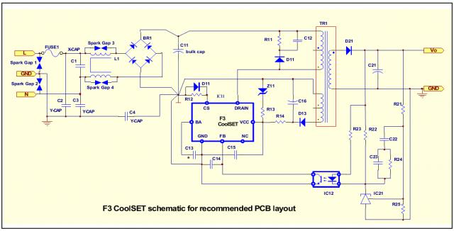

    ICE3BR1565JF, Infineon, FF CoolSET, TO-220-6, 68W/125W, 67kHz, 1.5ohm RDSon:
    *** could not find datasheet
    Infineon Solution for LED TV SMPS (shortform catalogue):
    https://cdn.badcaps-static.com/pdfs/...ed91163bc3.pdf
    ICE3BR0665JF, Infineon, FF CoolSET, TO-220-6, 110W/200W, 67kHz, 0.65ohm RDSon, 650V:
    https://cdn.badcaps-static.com/pdfs/...1a485dfec1.pdf
    ICE3BR1065JF, Infineon, FF CoolSET, TO-220-6, 80W/144W, 67kHz, 1.0ohm RDSon, 650V:
    ICE3BR2565JF, Infineon, FF CoolSET, TO-220-6, 55W/90W, 67kHz, 2.5ohm RDSon, 650V:
    AN-EVAL3BR2565JF, 40W 18V SMPS Evaluation Board with CoolSET-F3R ICE3BR2565JF:
    ENPC Workshop: Auxiliary Power Supply Solution --- CoolSET:
    https://cdn.badcaps-static.com/pdfs/...e3bff90cb7.pdf
    ICE3BR2565JF OR ICE3BR1565JF OR ICE3BR1065JF OR ICE3BR0665JF filetype:pdf

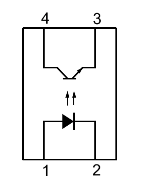

    PC-17K1, Kodenshi, photocoupler, 1 channel:

    MC81F4316, ABOV Semiconductor, 8-bit Single-chip Microcontroller, 28-pin, 16KB flash, 512B RAM, 2.2V - 5.5V @ 4.2MHz:
    MC81F4315, ABOV Semiconductor, 8-bit Single-chip Microcontroller, 28-pin, 16KB flash, 512B RAM, 2.2V - 5.5V @ 4.2MHz:

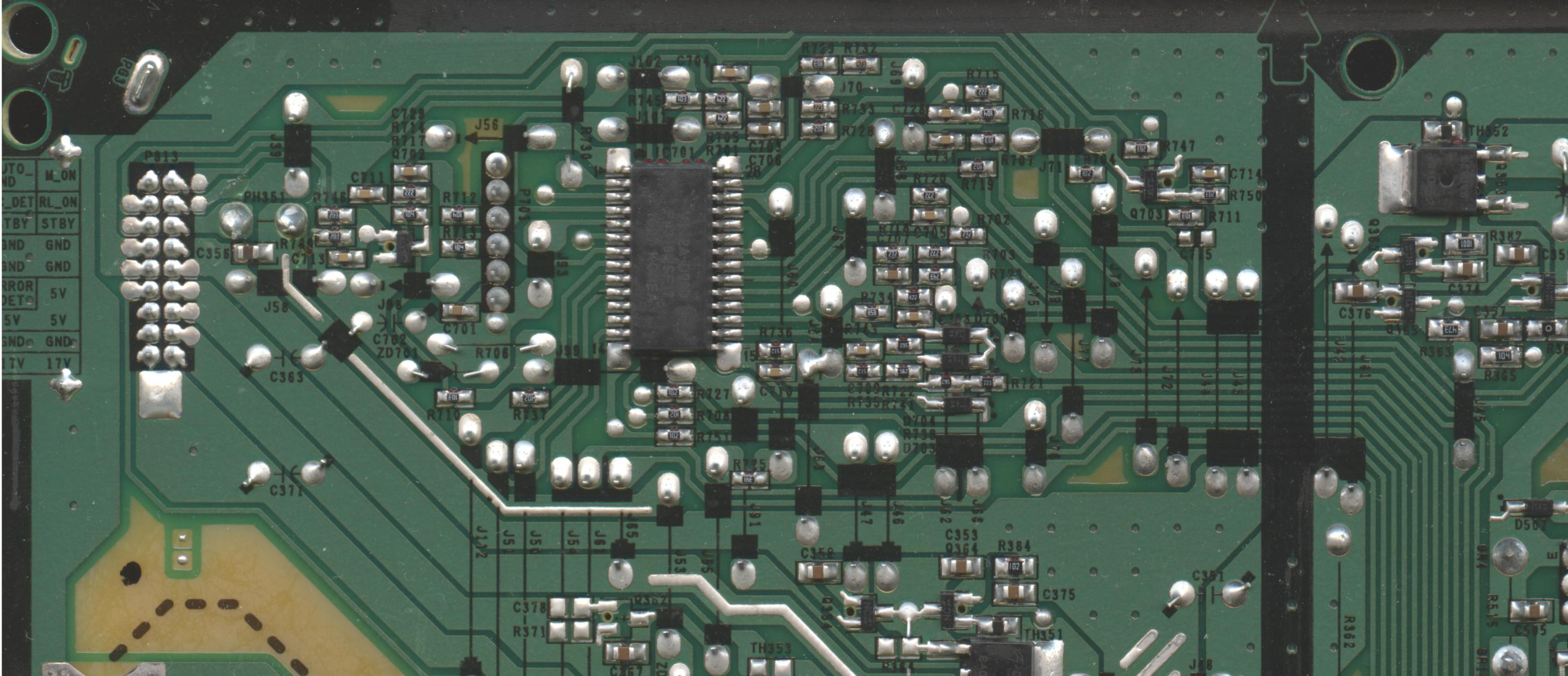

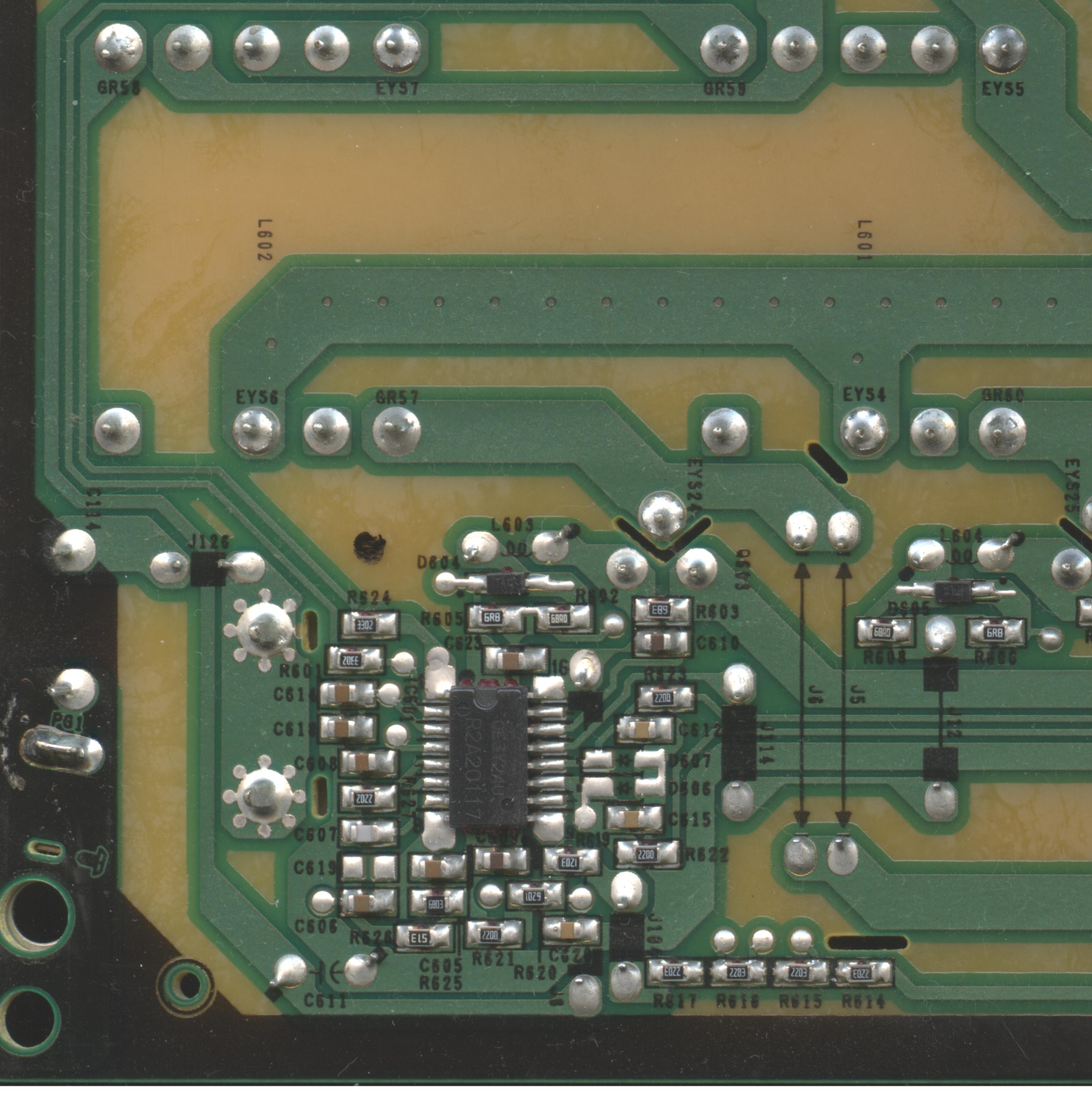

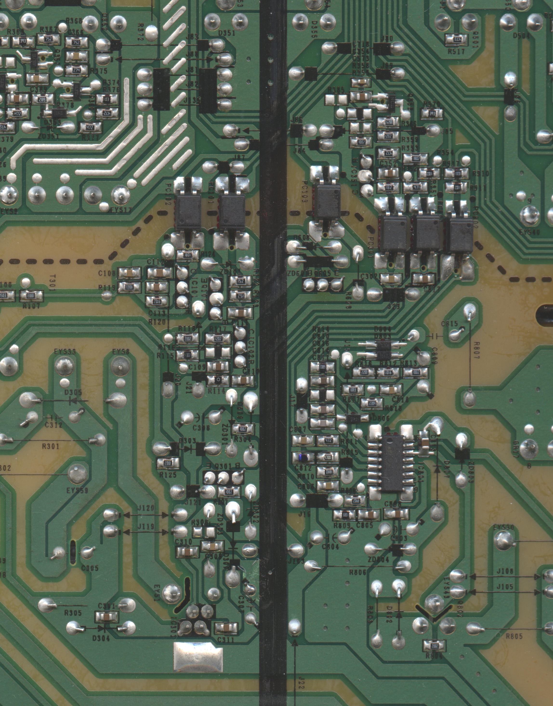

            Here are some hires scans of the rear of the PSU.

                  AC Detect circuit:
                  Code:
                          63V
                      D303  C308            D307
                          47uF R307
                     o-->|---+---+----+----+----------------->|----+------> VCC
                   from    |  |  |  |            |    IC301
                   auxiliary  |  |  .-.2K |            |+  ICE3BR1565JF
                   winding   |  |+ | |  |        C307 ===
                   of xfmr   z === | |  |        33uF /-\
                         A /-\ '-'  |         50V  |
                      ZD301 |  |  | |/ 2SC3198        |
                         |  |  +--| Q301         ===
                         |  |  | |>            BR-
                         |  |  |  | J121  ___
                         |  |  z  '-o--o--|___|-----.
                         |  |  A           |
                         |  |  |ZD302    R125   |
                         '---+----+       10K   o
                             |         J20 )     +5V
                             ===           o     ___
                             BR-           |      |
                                         +----.1   | 4
                                        .-. | |  |/ | PC-17K1
                                        | | | V -> |  |
                        240K 150K         1K8 | | | -  |> |
                       240K 150K 100K          '-' | |   | |
                        __  __  __          | '-|------|-' R729
                        | | | | | |         +----+2  3|  ___
                       .-..-..-..-..-. |         |  |PC102 +--|___|--> U701-28
                       | || || || || | |         |  |   |  10K   AC_detect
                       | || || || || | |      IC101 |  |   |      to CPU
                       '-''-''-''-''-' | R119   KIA431 |  |   |
                    D102  | | | | | | ___      \_|_  |   .-.
                    o-->|---' '--' '--' +-|___|--+---+--->/_\\ |   | |47K
                       R103 R105 R107 |    |  |   |  |   | |R732
                   Active   R104 R106  | 100K .-. |   |  |C112 '-'
                            C108 ---   | | ---  |  ---   |
                               |  91K '-' |C113 |  |   ===
                               |  R120 |  |   |  |   GND
                                        BR-
