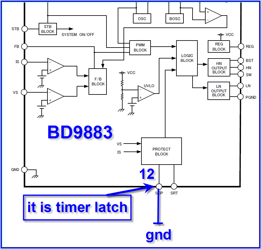

    TV on by main AC and then by Remote: front LED green. After about 5sec: complete shut down, LED becomes red. All repeats if disconnected and connected again to AC power.
    In this TV both SMPS and Inverter are on the same board (Power/Inverter UNIT):
    RUNTKA396WJQZ.
    I know by (some/humble) experience that fault might be in lamps. My question is: Is there a way to know for sure that that's the case and not a problem in Power/inverter unit, such as a defective HV transformer or inverter IC (BD9883) fault?
    NOTE: All three DC voltages are present: 60V, 13V and 9V.
    No bulged C's in power unit. If all 10 lamps are completely taken out would the inverter still work and should I find a HV (1700V) in secondaries or NO NO NO ...? I don't want to take the risk of buying/changing all lamps.
    Please HELP. Thanks...

    Re: SHARP LCD TV LC-3244E-BK: No Backlight
    jumper C7558 and see if display is ok. if still shut off, may be some components have over current
              I used wire to short c7558 and the display is ok now. Found minor black strip horizontal line. I believe that one of ccfl bulb going to be faulty. So probablybad ccfl bulb cause shut down display or protect short circuit scp of bd9883
                  HI
                  this backlight problem as a result of old lamp or broken lamp .
                  put pin 12 as in pic to ground if backlight is off there is a broken lamp or loosen connection you must open the back light to change the lamp .
