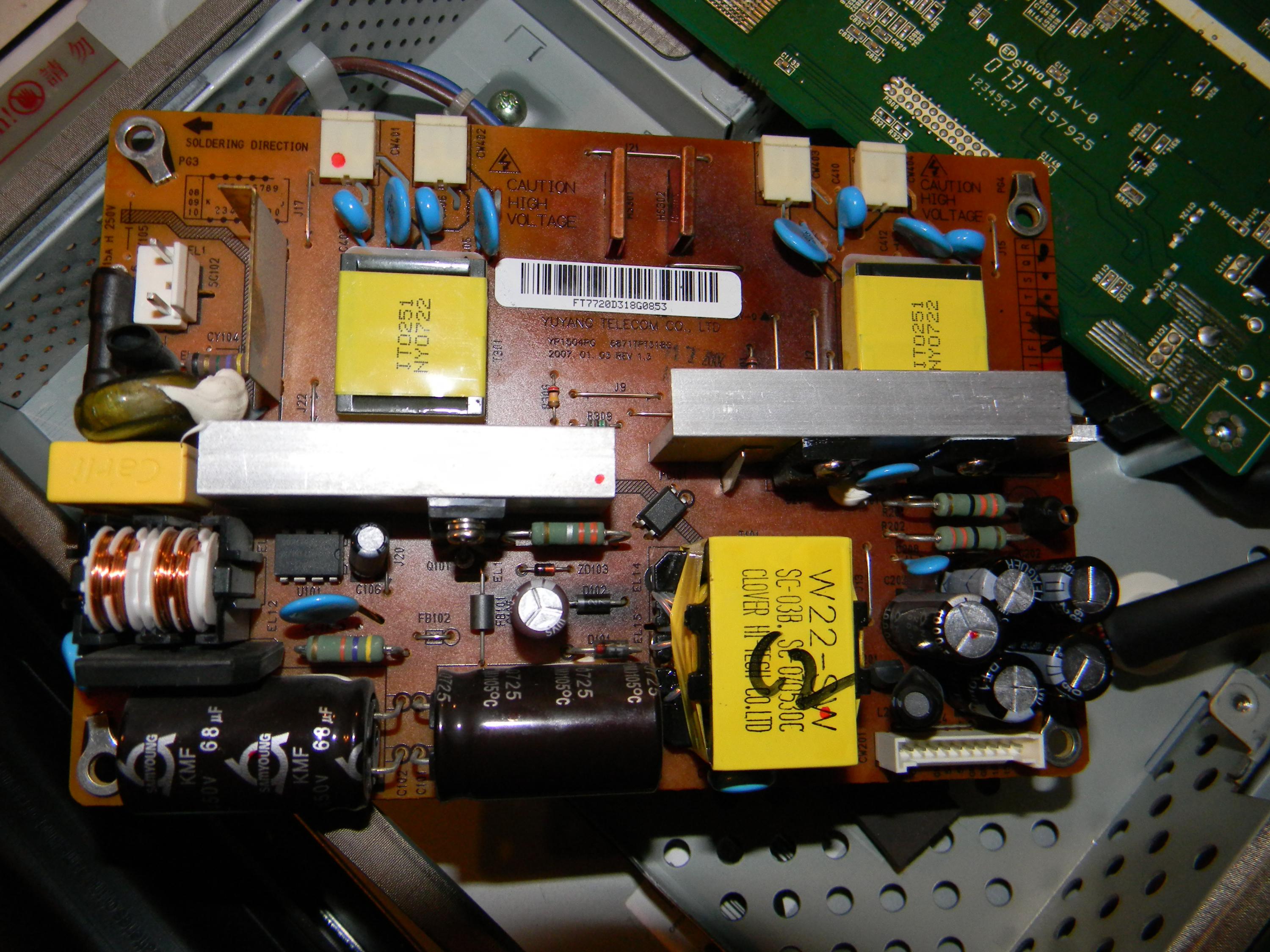

    Lg m228wa
    Changed caps but, fuse is fine but still doesn not take power in.
    Even the power led doesn't light up.
    Transformer?

    Can you please provide good clear pictures of the board and how they are all connected together so we can see what we are dealing with.
    What have you tested so far?
    I would assumed you have already tested the Main AC fuse, rectifiers, DCV between the two legs of the main filter cap in the primary side, etc.

      You measured the voltage 15V, 5V at CW201 ? Check R108, D202, D201, U303, U304.

        Re: Lg m228wa
        No power on CW201 at all.
        http://imgur.com/HmxfB4s.jpg
        Under D102 looks pretty burned.
        Is there any scematics for this board around?

          Check for cracked soldering, replace all caps C106, C105, C201, C202, C203, C204. Check ZD103, D102, D101. Replace in the last case U101, Q101.

            Re: Lg m228wa
            D102, D101 ok but R108 - From color code orange;orange;silver;gold it's Resistance Value:
            0.33 ohms, +/-5%, but multimeter shows 0.7ohms. could that be the problem?
              Re: Lg m228wa
              No, that is not the problem, you are reading the meter probes resistance + the value of the resistor.

                Re: Lg m228wa
                Put the multimeter probes in short to see their resistance value. Anyway check again.

                  Re: Lg m228wa
                  Thak you all for help.
                  U101 was bad.
