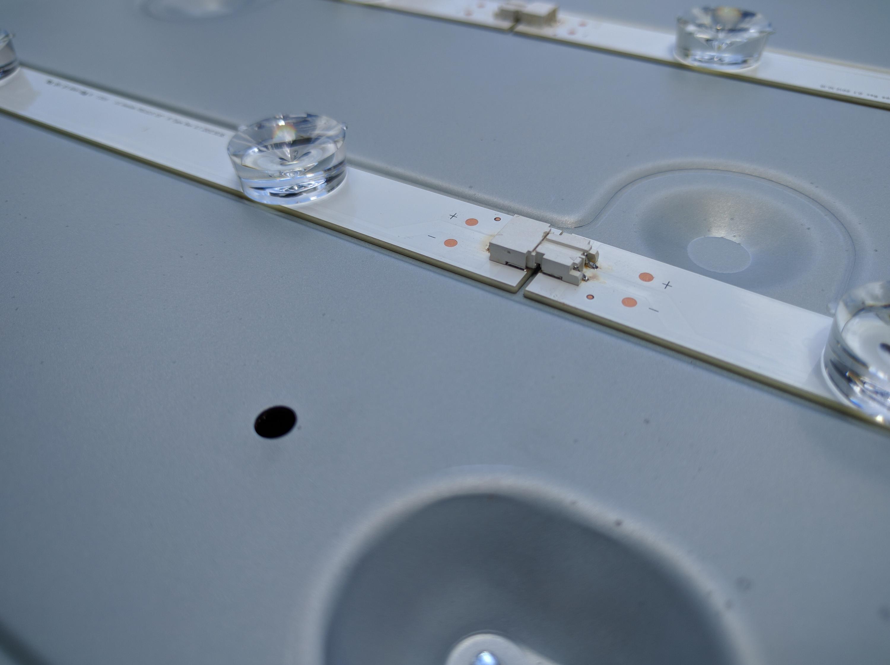

    OK so I took the TV apart and i'm down to the LED stripes panel, how can I test or find out which ones are bad?

            Ok so I decided to turn on the TV and all the LEDs light up fine? but still shuts down after a bit, how do I find out if there is an open circuit on which LED strip ??
            I thought if there was a bad led it will simply just not light up???
              Re: 55la6205 backlight issues
              Ok, right you see the little connectors between the Led strips seen them become flacky and corroded after time and they fail to make contact tripping the whole BL possibly worth removing the strips and adding some fresh solder to them.

                This is what I got:
                When the backlight is on and working, showing the LG logo floating across the screen the DCV are as follows from left to right connectors
                LED + 133.5
                LED - 32.9
                LED + 177.5
                LED - 43.1
                When the backlight randomly turns off the DCV are:
                LED + 84.4
                LED - 5.36
                LED + 84.4
                LED - 166.0 this readout goes up and down from 177 down to 166...

                    I look look at the LEDs trips in the pictures and I can see Seven strips (12 LEDs per strip), there are two LED driver circuits so one driver must be driving 3 strips (36 LEDs) and another one drives 4 strips (48 LEDs), so that may explain why one has higher Voltage than the other.
                    'when the backlight goes out the second + that is at 177 goes up to 200 now until it slowly goes down to 84V.' It should not go up unless the load is not connected, you do not see the Voltage rise on the one with 133.5V reading?

                      Just took the reading again the + with 177 is steady at that voltage when the backlight is on, I waited until it shutdown and it went up to 215V and started coming down slowly.
                      Unplugged waited 2 minutes did the same with the other + 135 steady and when the BL shutsdown there are no power surges or anything just starts to come down to 84V slowly......
                        #31
                        That means that LED strings connected to that 177V pin has gone open circuit(the Voltage will rise when the load is not present, or the return line that goes to the PWM Power MOSFET has stop conducting. I still think one or more of the LEDs have gone open circuit in the top four LED strips after they warm up.
                        You have already check and reseat the connectors for those 4 LED strips (the top four).
                        It looks like you can swap the LED strips to see if the Voltage will rise on the 133V driver.

                                hi, Guys, no I haven't checked the connectors on the strips, I will do it now and see if it anything changes.
                                  #36
                                  OK so i reseated the strips and connectors and now the TV wont turn on at all.
                                  All I get is a quick flash of some of the leds and that's it, so something happened when I reseated the connectors and moved the strips???

                                    I think you found the cause of the problem, there is/are bad connections/solder joints on the LEDs strips connectors/wire terminals that you will need to locate, clean, and re-solder.

                                        You need to tear the panel open and resolder the connectors that look like the ones in the picture. Over time with the heat the connector develops cracks and oxidizes.
