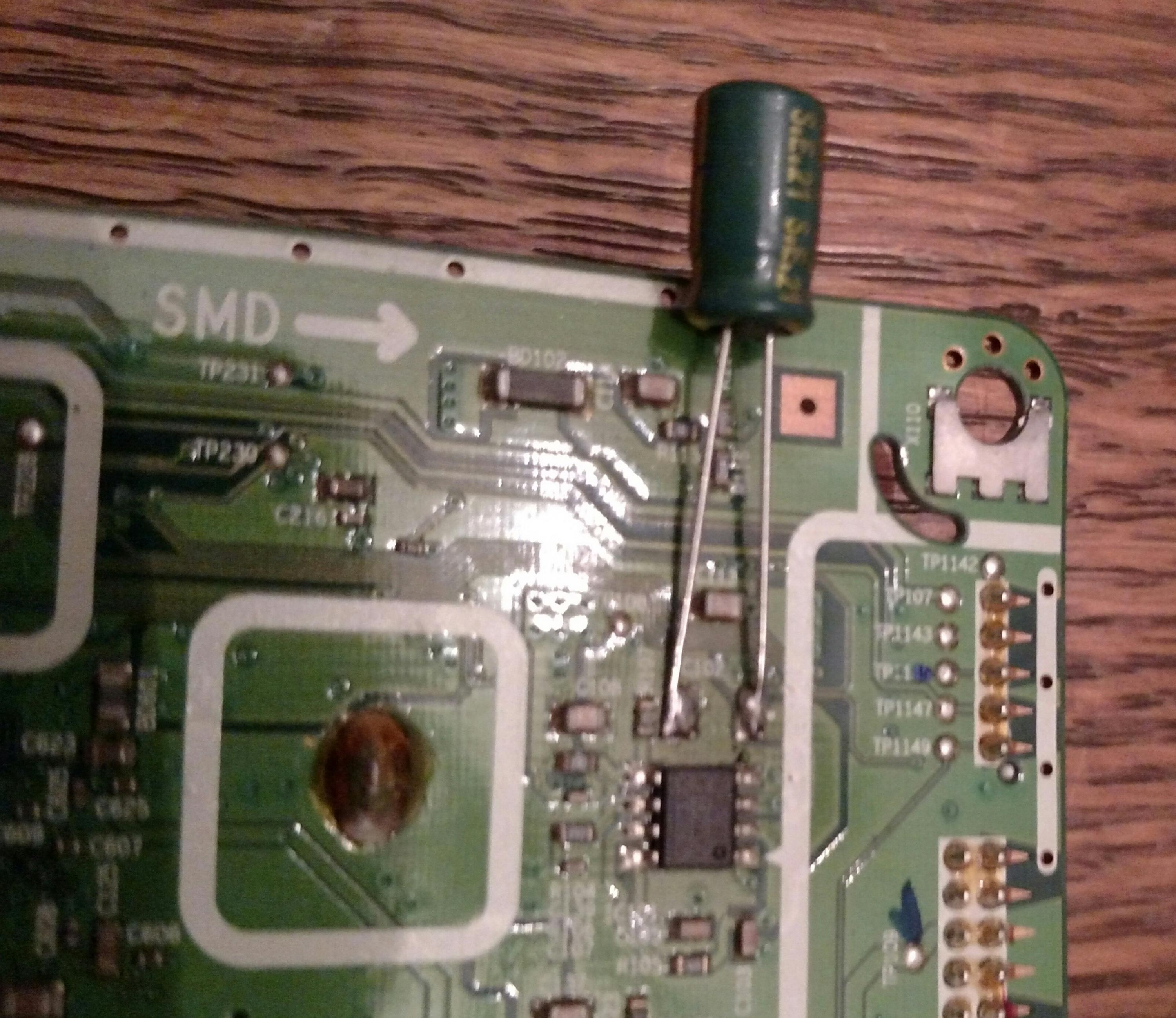

    samsung ln46a550
    The tv has a squeal first time turning it on and then resets 4 or 5 times. The pic is green and very distorted at this time as well. After the 4 or 5th time of resetting, all is good and will work until it gets turned off and cools down. I've read about replacing the 102 and 131 on the power board. The problem with that is this board is not that same one. my board is a bn4400202a. i have seen a replacement board, maybe that is where the 2 caps are. I've seen the board for sale online for around $65. I can't check the 6 caps on my power board because I don't have the right meter. Should I just replace the 6 caps and go?

    Pictures of boards ?
      Re: samsung ln46a550
      bn44-00202a is the power supply board.
      C102 is on the main board not the power supply board.
      https://www.badcaps.net/forum/showth...t=25810&page=7
      http://www.shopjimmy.com/samsung-bn9...a550p3fxza.htm
      You can try soldering 100uF 16V or 10V low ESR in parallel with C102 to see if that will solve the problem.

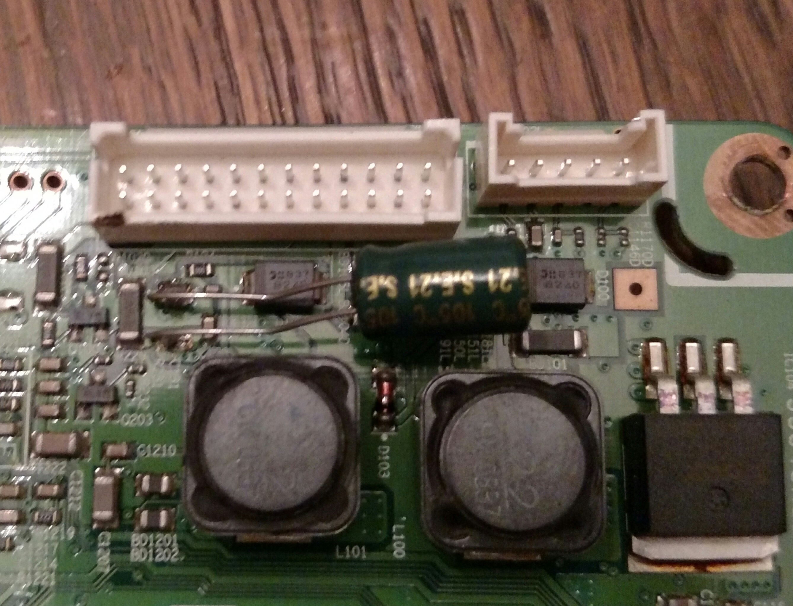

                You guys nailed it!!!! I replaced the 2 caps, 102 and 131 and PERFECT!!! Can't say thank you enough for all the knowledge you all have..... The soldering job is pretty rough, but all is good now..... Much appreciation to all. Dave.
                • widgeonwing
                  • Dec 2015
                  • 7
                  pic of fix
                      2nd chip replacement
