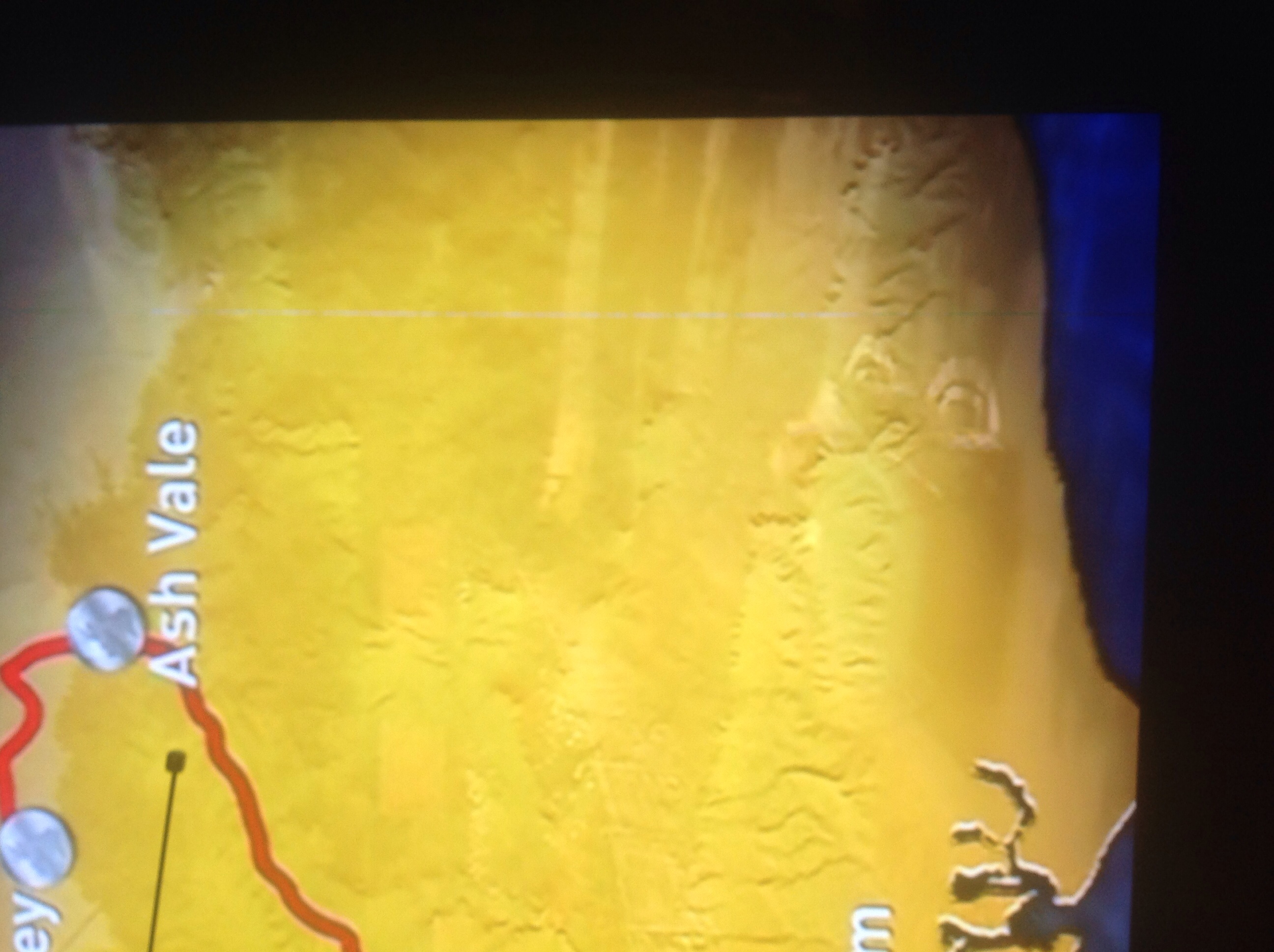

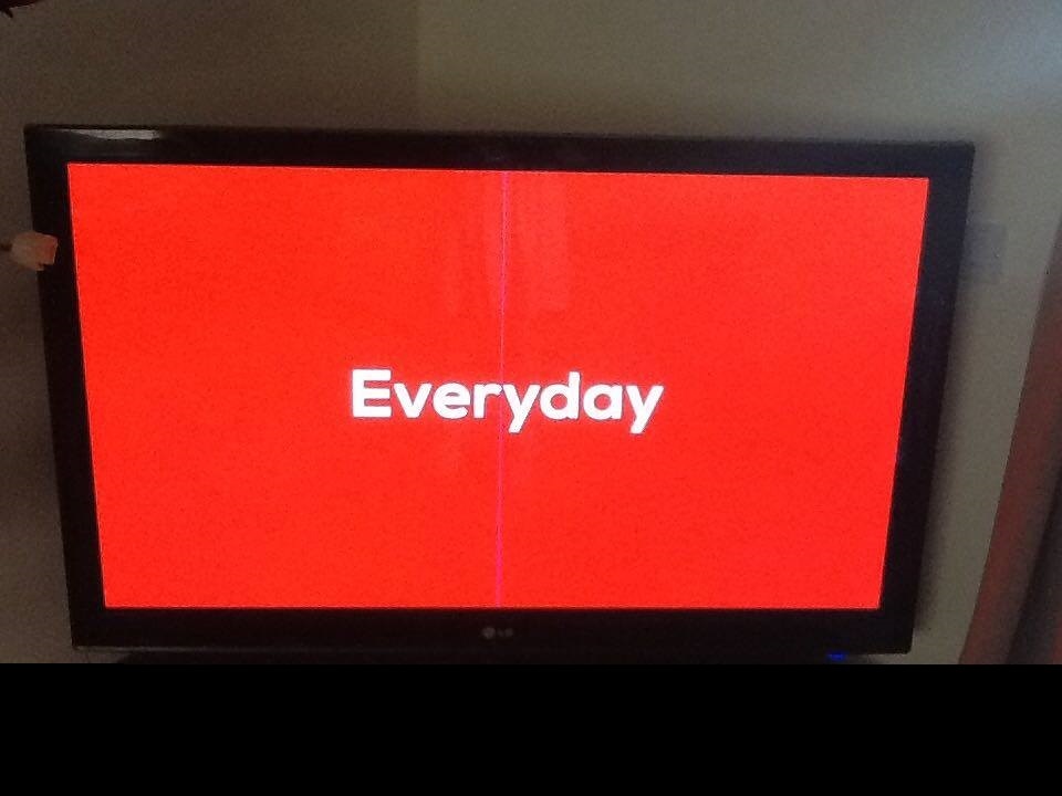

    Lgpq3000
    Hello
    screen failure again yellow line through the center of the tv ?

    Re: Lgpq3000
    Pretty much, try reseating the corresponding tab.
    But more than likely won't be saveable.

      Re: Lgpq3000
      I have the 50PG3000 in right now with panel failure, whole row of red sub pixels have failed
      Not fixable at all.
