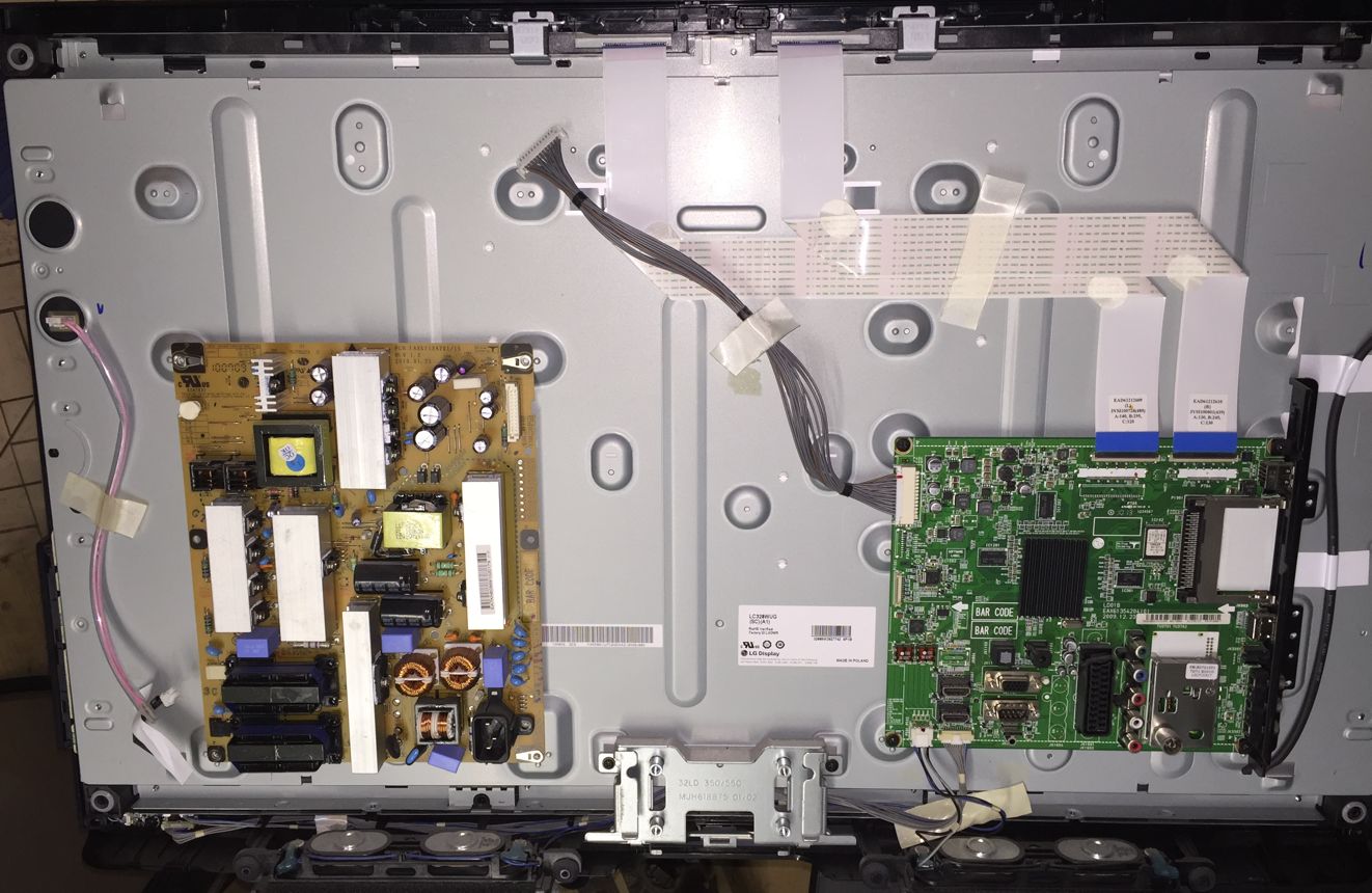

    Re: LG 32LD550 no backlight stay in stby
    Posting pictures of the back of your tv showing the boards with clear pictures may help you more with fixing your problem
      Yes of course here are the Pictures:
      Best regards

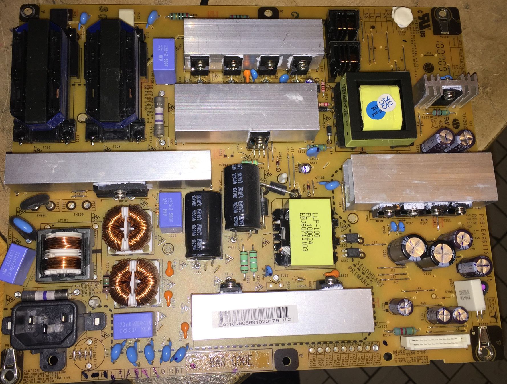

        Thers a repair kit for this PSU board might be worth checking the following capacitors
        http://www.ohmsupplies.co.uk/REPAIR-...EV12-LG42LD550

          Can you list all the output pins on the PSU by name and what voltage you measure on each of them, both when the TV is in standby and when you press the power button.
          maybe read this thread as seems same fault as yours
          https://www.badcaps.net/forum/showth...ght=LG+32LD550
            'Only the INVERTER ON/OFF Pin stay at 0V' Main board is not sending the BL-0N to turn on the backlights.
              Hi together.
              The caps are all checked, I solde them out (all) an checked the capacity an the ESR , all OK.
              Here are the voltages first in Standby an second "switched on"
              Error: 0 / 1,0
              P-Dim: 0 / 1,0
              A-Dim: 0 / 3,0
              Inv On/Off: 0 / 0
              3,5V: 3,5 / 3,5
              20V: 0 / 21,4
              12V: 0 / 12,6
              Power On: 0 / 3,2
              Many thanks
