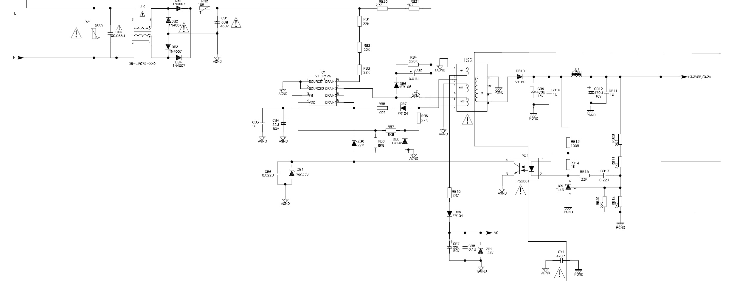

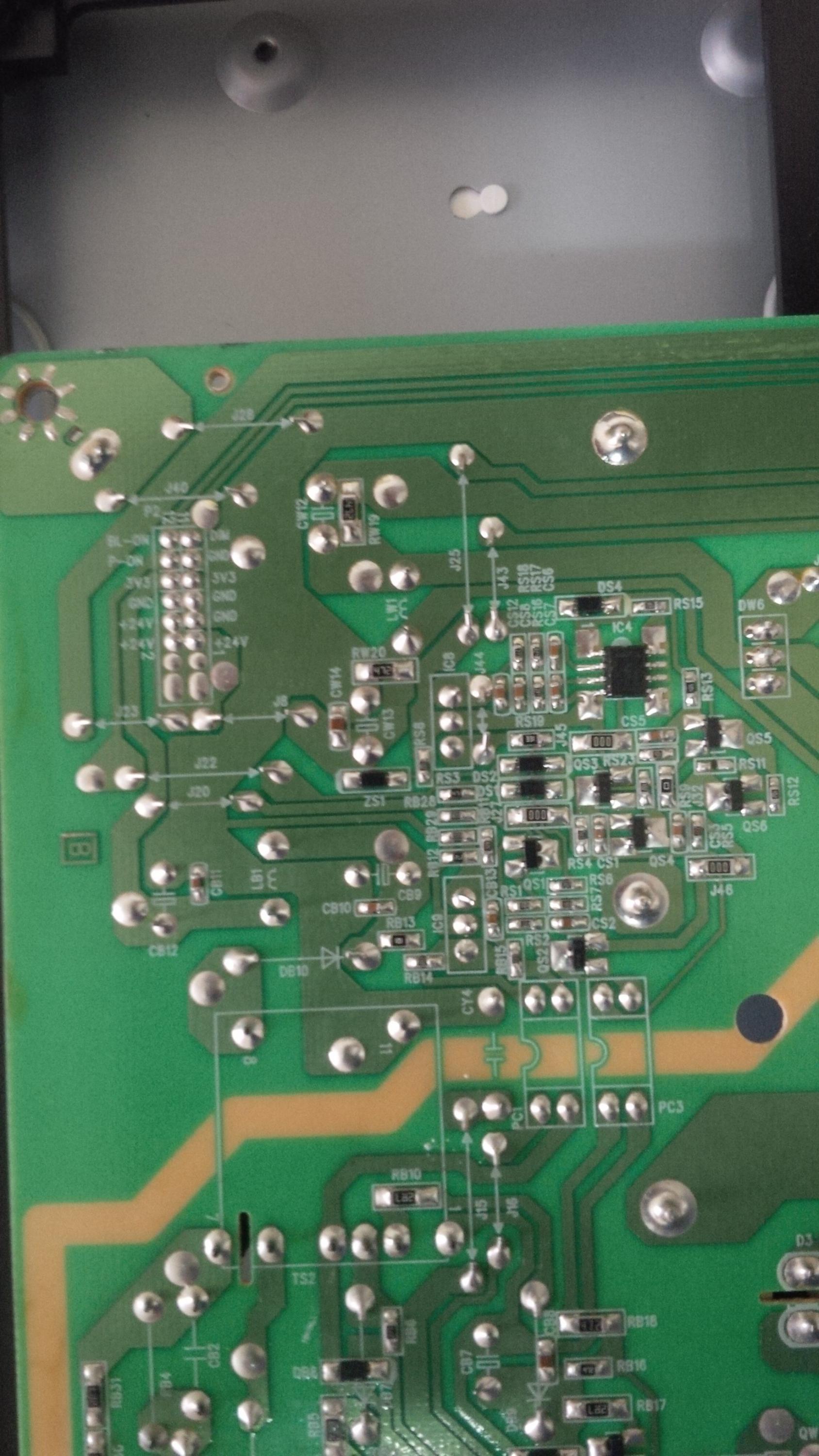

    I have a TCL 32" LCD on the bench. No standby 3.3v
    I do not have stable voltage on pin4 Vdd of IC1 VIPER12A (with respect to AGND)
    Schematic is attached, pictures of standby section now attached.

    ESR and the capacitance of C84 tested OK?
    D810 tested OK?
    ZB6 tested OK?
    DCV reading on C84?

      Thanks for the reply. I've taken the following measurements:
      CB4 - 21.14uF on meter I do not have ESR meter
      D810 tested OK?
      measures 1.078k (meter - to cathode) and 0.077M (meter + to cathode)
      ZB6 tested OK?
      measures 1M+ (rising on meter) (meter - to cathode), 0.676V in diode check mode and Open (meter + to cathode)
      I didn't remove ZB6 to test because it was surface mount. I desoldered pin 5 IC1 which hopefully isolated that side.
      DCV reading on C84?
      19.55VDC
