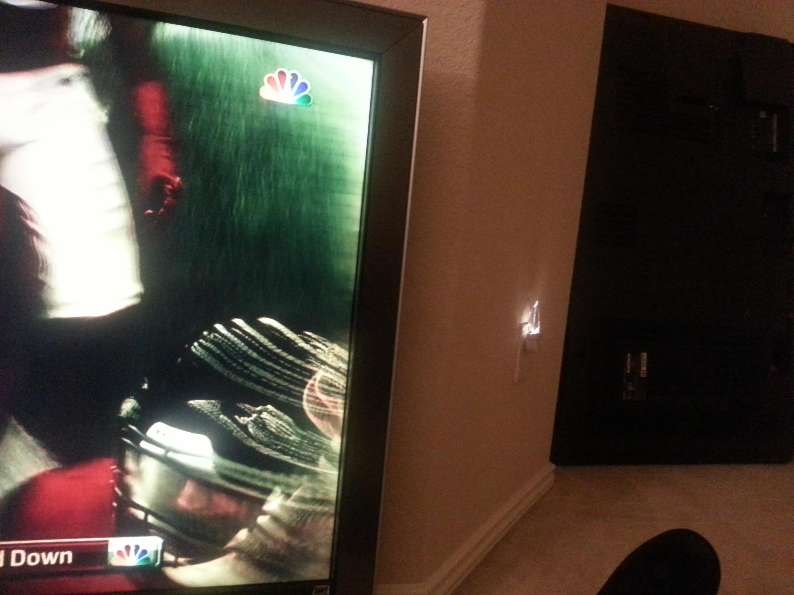

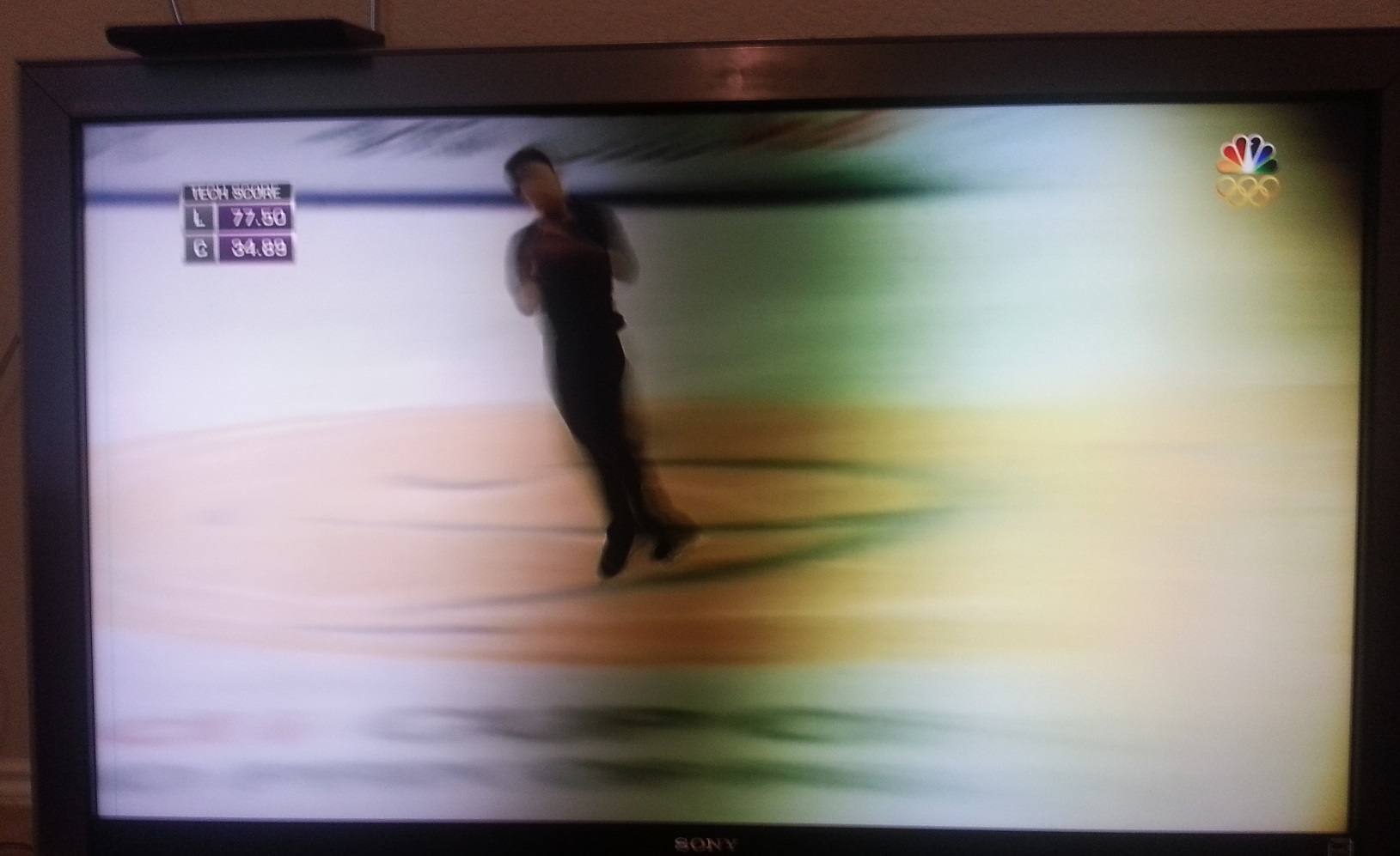

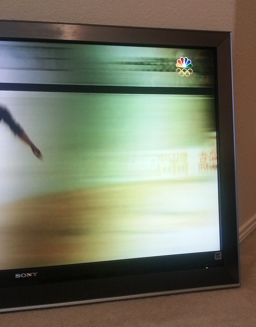

    I bought this TV to fix, suspecting a bad backlight tube. On closer inspection the entire right third of the picture is smeared and motion blurred. The dark band in the center is not vertical as I would expect from a dark backlight.
    Would you experienced troubleshooters suggest a possible cause and troubleshooting sequence?.

    That's a tab bonding issue. Furthest on the top right. You have to take the TV apart and take the plastic frame off around the screen. Remove the metal bezel surrounding the panel in on the top of the panel will be ribbon cables going into it flex the top right one and see if it disappears.

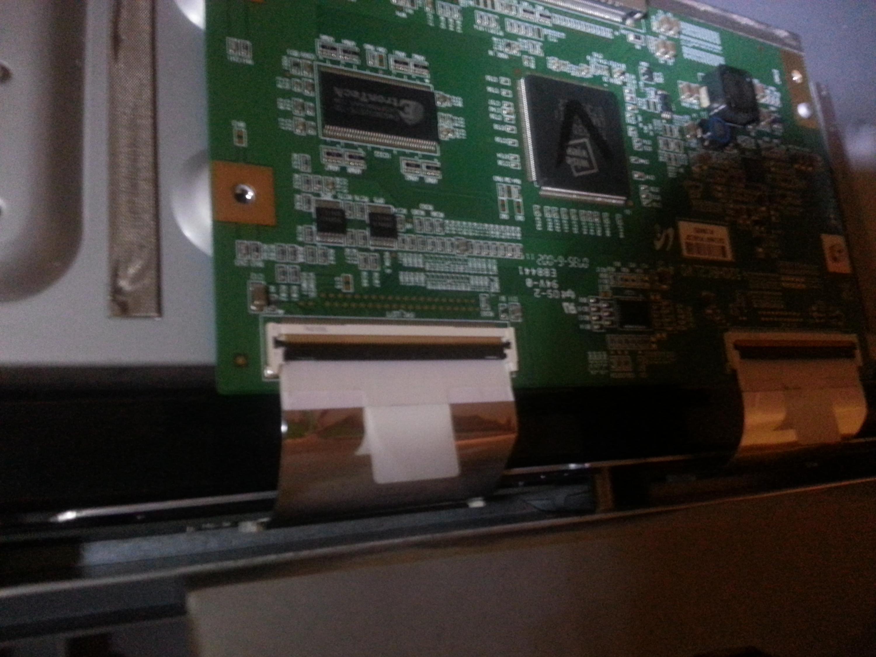

        I released both ribbons from the T-Con board, cleaned and swapped. No change. I'm not sure how to proceed. I can separate the bezel enough to see that the tab bonds are inside a metal cover around the panel, with no obvious way to access.
        If I remove the bezel, will I see tab bond connections from the front?

            The symptom did not react to pressure on the tab bonds.

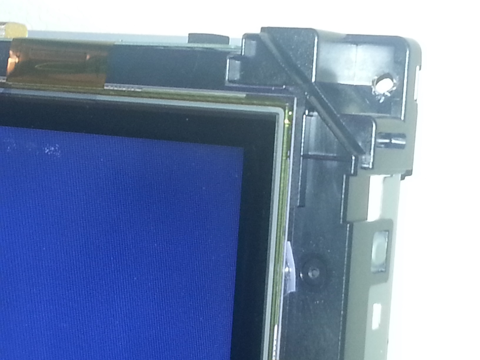

            I got a good picture by bending out one corner of the LCD panel ever so slightly. It stayed good for a few hours. The next time I powered the set on the symptom was back.
            So now the challenge is to keep the LCD "bent". I plan to shop for some heat-conductive pad I read about on this forum and try it.

              Here's a photo of an improvised plastic shim which maintains a little twist on the LCD panel. This seems to keep the picture good for several hours so far. I'm shopping for thermal transfer pad tomorrow. How thick should I aim for? It's sold in .5mm, 1.0mm and 1.5mm thicknesses.

                          • steves7839
                            • Nov 2014
                            • 200
                            Re: Sony KDL52W3000 right half blurs
                            Originally posted by SteveNielsen
                            Can you post some pics of the graphite-looking things?
                            Sure.

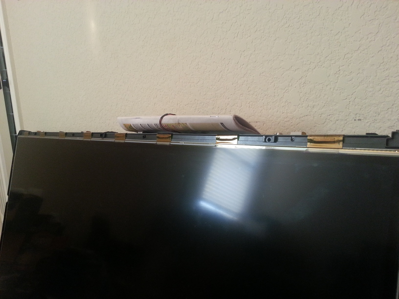

                            Pic 1 is the upper row of tab bonds between panel and interface PCB's.

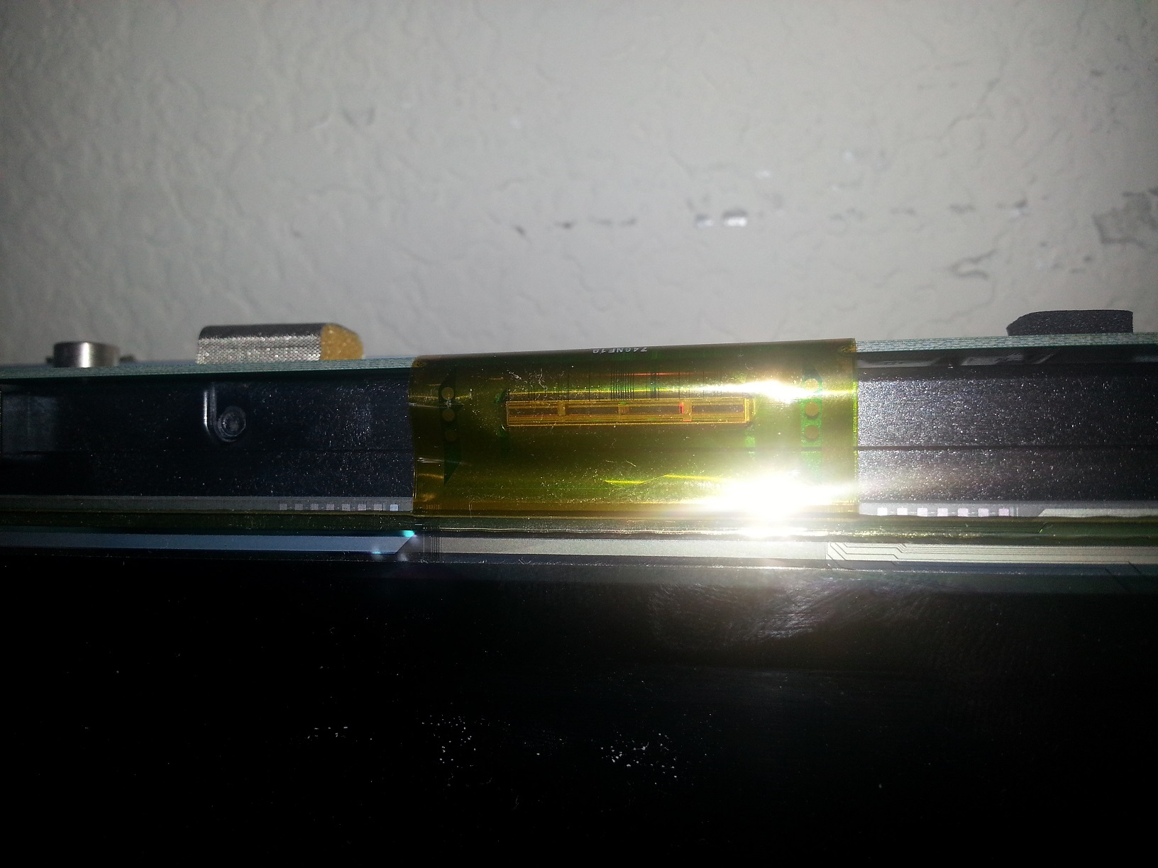

                            Pic 2 is the rightmost tab bond showing the "chip" matrix that gets hot. All tabs along this upper row get blistering hot; I found this the hard way.

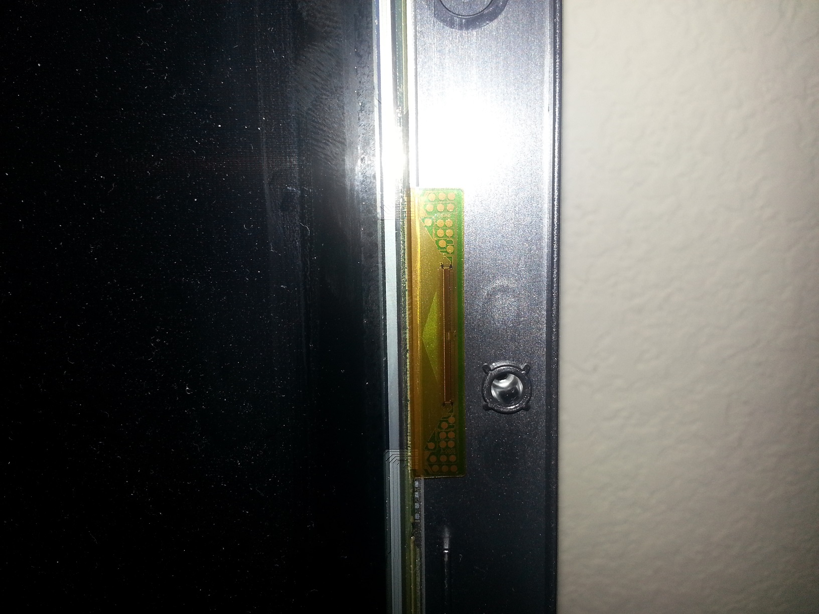

                            Pic 3 is one of the side tabs, an extension of the LCD panel. Each side tab contains a "flattened nail" structure described by poster saddle_au.
                            It appears that the metal guard around the tab bonds is positioned to remove some heat from these hot "chip" structures, but there's no heat transfer material to facilitate this.
