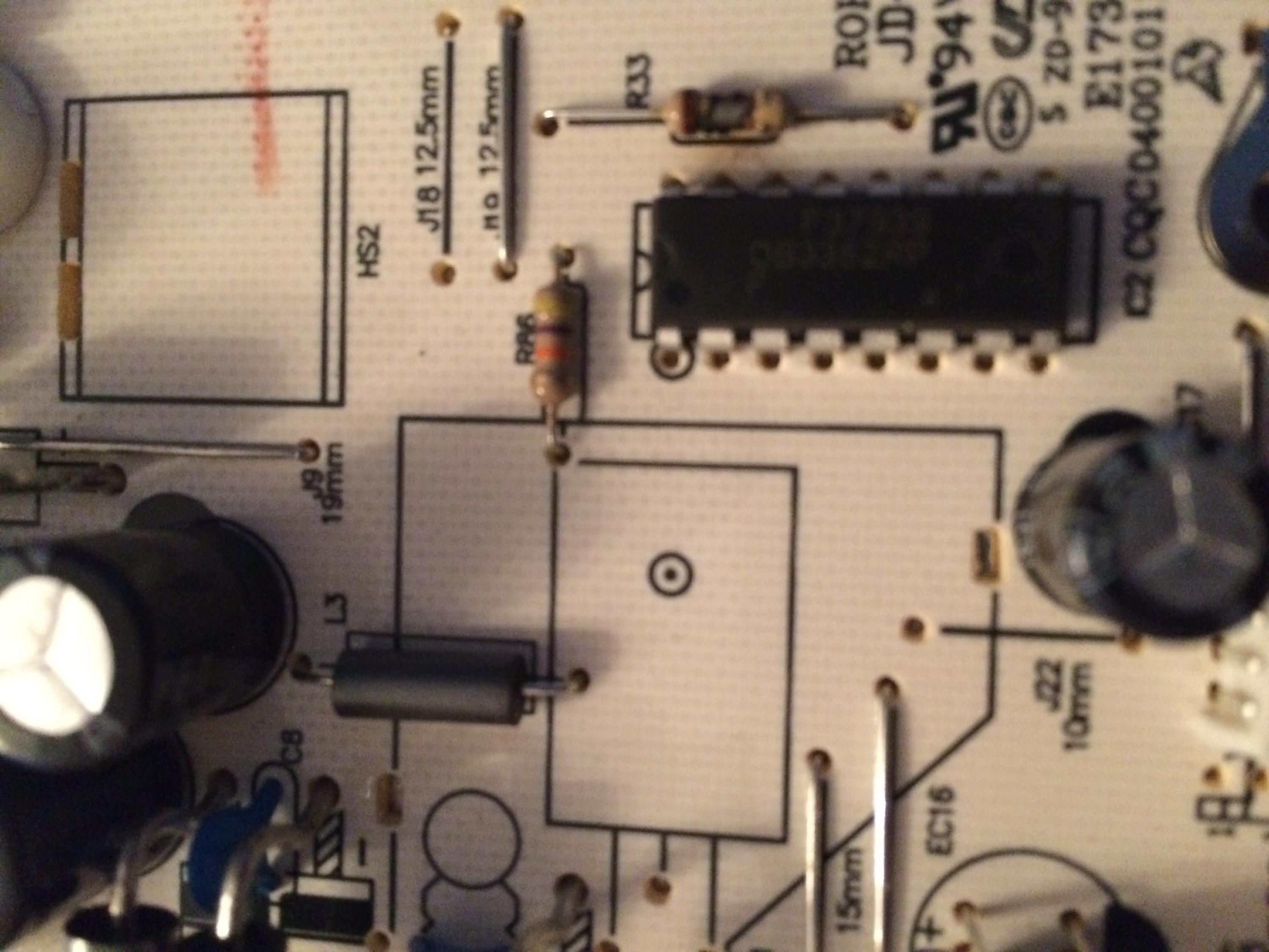

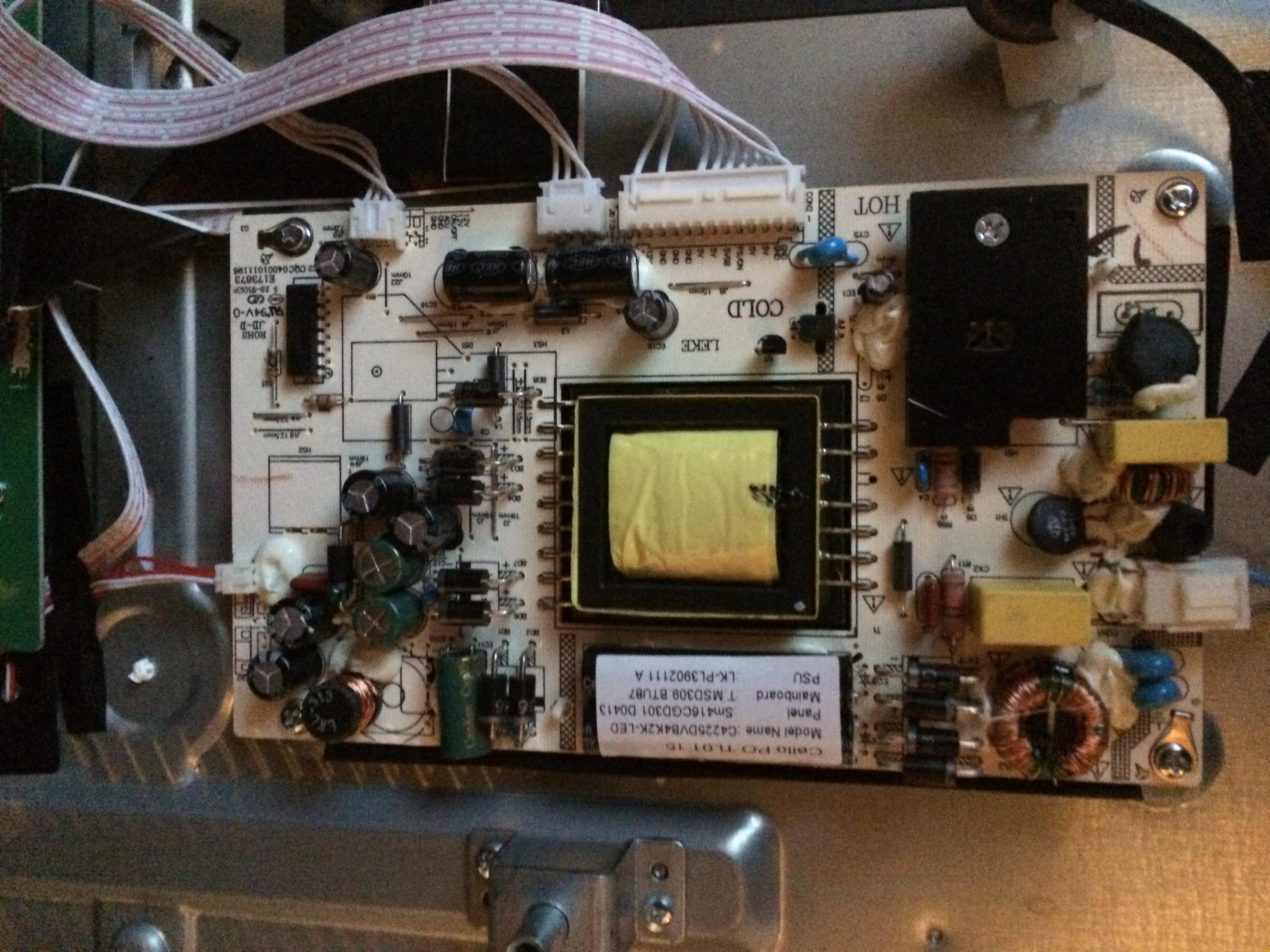

    Resistor replacement which one needed?
    Need help knowing what resistor i need to replace a blown one?

    Re: Resistor replacement which one needed?
    can you make the colors out? unsolder it maybe on the bottom side its still visible
      its cream in colour, i can see a gold stripe and it says r33 at the side
        what about the other stripes? there should be 4 or 5 in total
          What is the P/N of that IC next to that burnt out the resistor? That may be very low Ohms resistor for feeding the VCC of the IC.
          Can you look at the bottom side of the board to see which pin of the IC the resistor is connected to?
            If you take the resistor off the board you may be able to see the colours on the underside
            if it has just blown out on the top side.

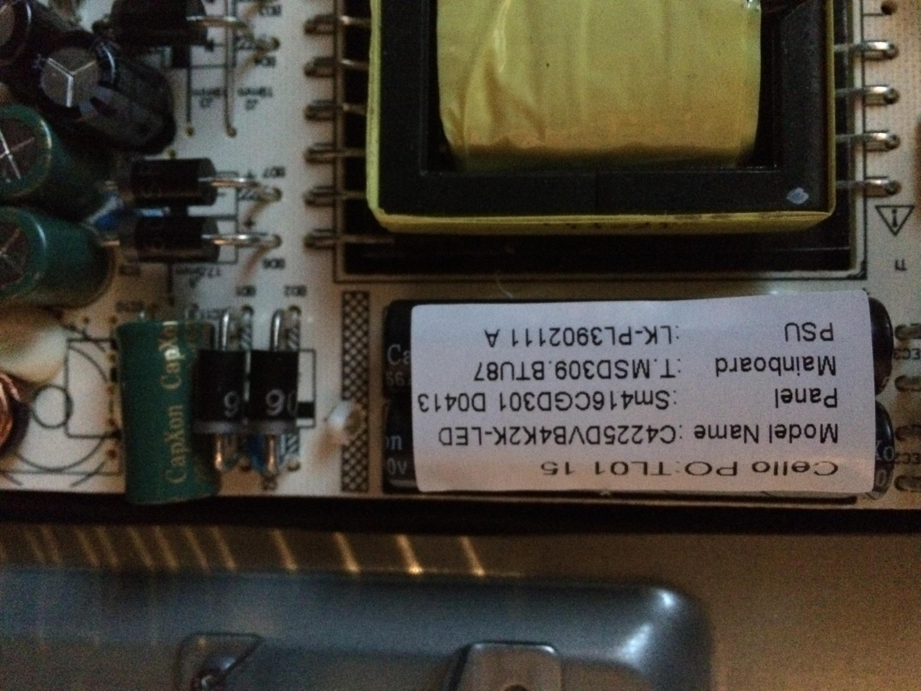

            EDIT if this is a 42 inch cello they are fairly new - is it not under gtee - or did you get it as a damaged return?
              damaged return
