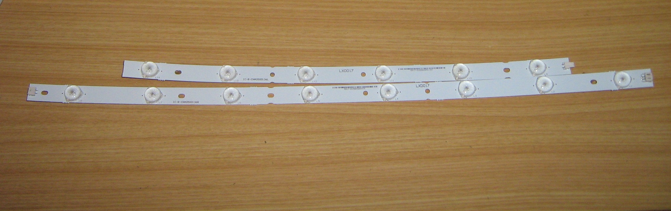

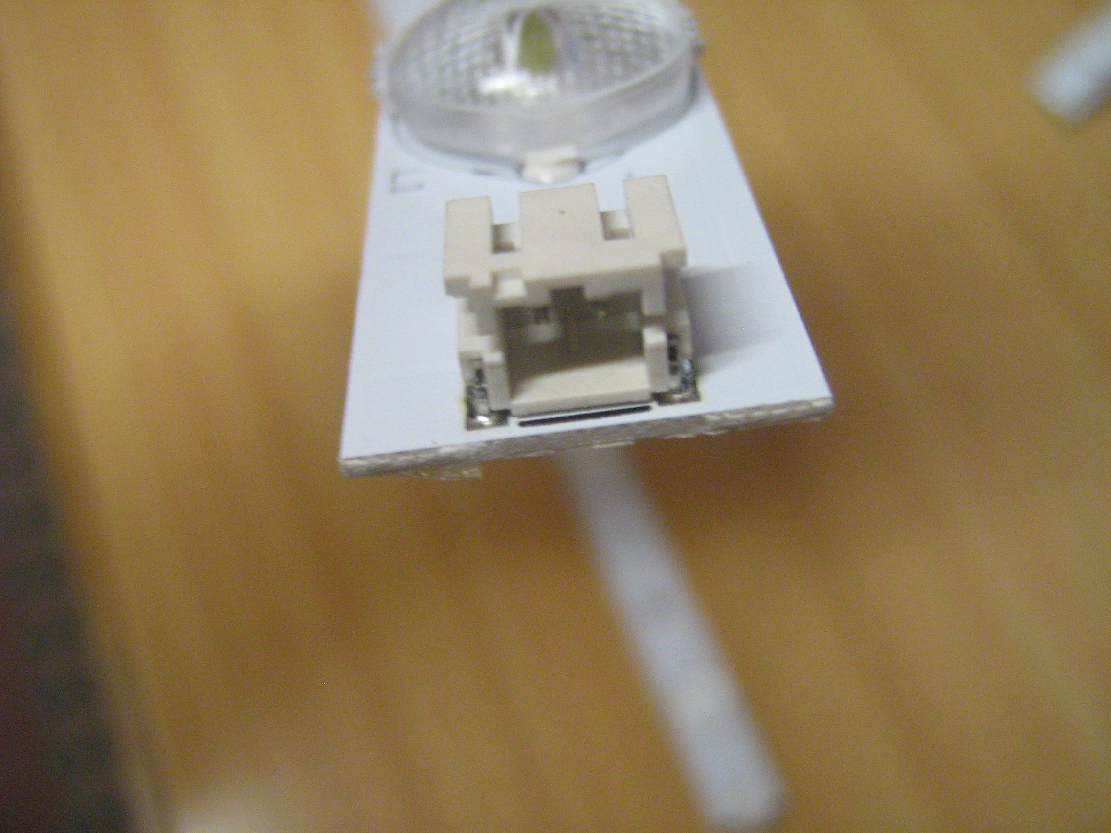

              • johnboy1313
                • Nov 2012
                • 1959
                Re: Panasonic TFTV5025FL failed LED string
                Post a picture of the string, the connector(s) on each end, and any part number identification that you can find.
                • dkneyle
                  • Dec 2013
                  • 445
                  Part number appears to be LXD017. There is a left and right interconnecting string. They are wired in series. I will be advertising on Flea-bay if anyone is looking for spares.
