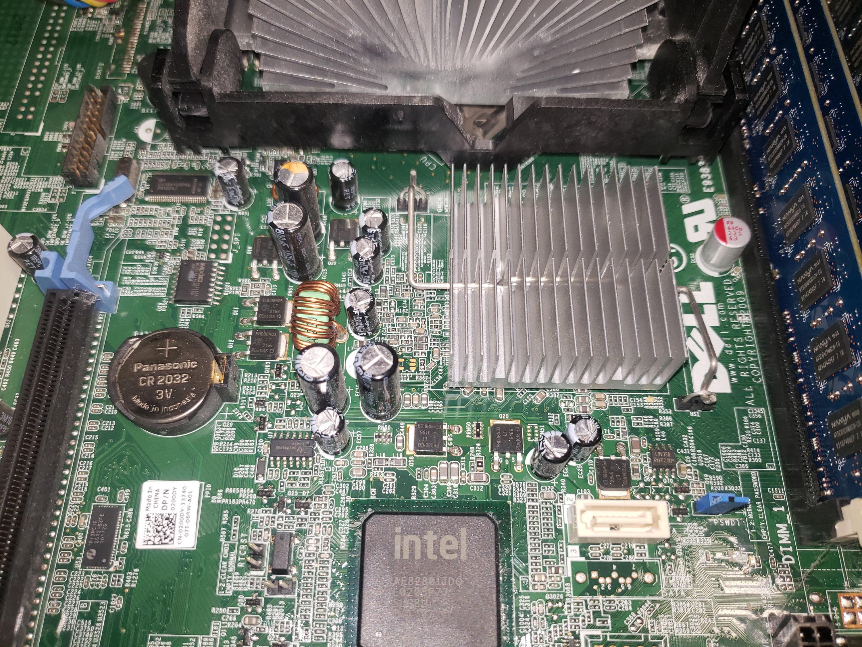

    This is the first time that I've seen an Panasonic cap fail that wasn't installed backwards (at least that I can remember).
    It's a 1800uF 6.3V part. It's from a Dell Optiplex 780 SFF from 2010. CPU is a Core 2 Duo E8500 3.16GHz. It was a point of sales machine at a car dealership and was NEVER off! It was on a UPS, and had 82,156 hours on it when I got it. It had never been cleaned, never had the thermal paste replaced. The thing literally just worked for 10 years. It's a cool machine because it's one of the highest end Core 2 Duo CPUs with DDR3 RAM
    I got the machine in August 2020. I took it apart and saw that the board had 9 KZG caps on the board, none looked bulged. I took apart the PSU (total PITA, by the way) and saw a bulged CapXon. After taking apart the power supply, I discovered that there was only the one 2200uF 16V CapXon GF for all of the 12V rail filtering. I'm guessing after that bulged, the 12V ripple was really high. I replaced all of the KZG on the board and did a full recap on the PSU (including the primary cap!) and replaced the thermal paste on the CPU and Northbridge heatsink. I instantly started using the machine as a Plex media player in August 2020. I set it up to run 24/7.
    The original GPU fan on the ATi video card failed in December 2020 and I replaced it. At that point, the cap was still good.
    I shut down the computer to move in June 2021 and I noticed that the cap was failed. So at the minimum, it still ran for 85,0000 hours in a small low airflow case directly in line of CPU exhaust heat. Not bad! The same size/series caps next to it tested perfectly in spec. I was worried at first that the PSU didn't like my recap and was outputting high ripple but it makes more sense that it just had a long stressful life.

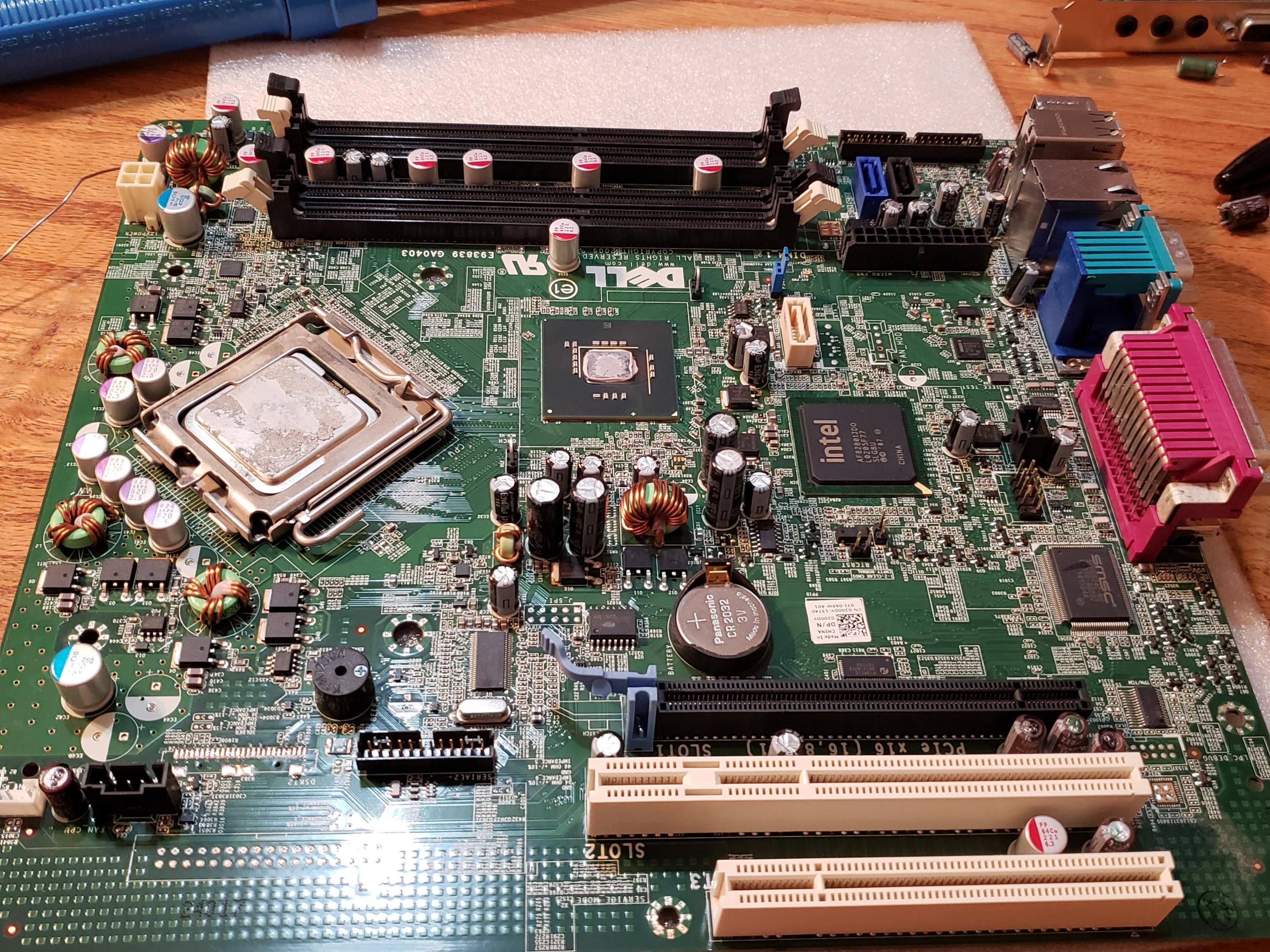

    Here is a picture after I recapped it so you can have a good idea of where the cap was:

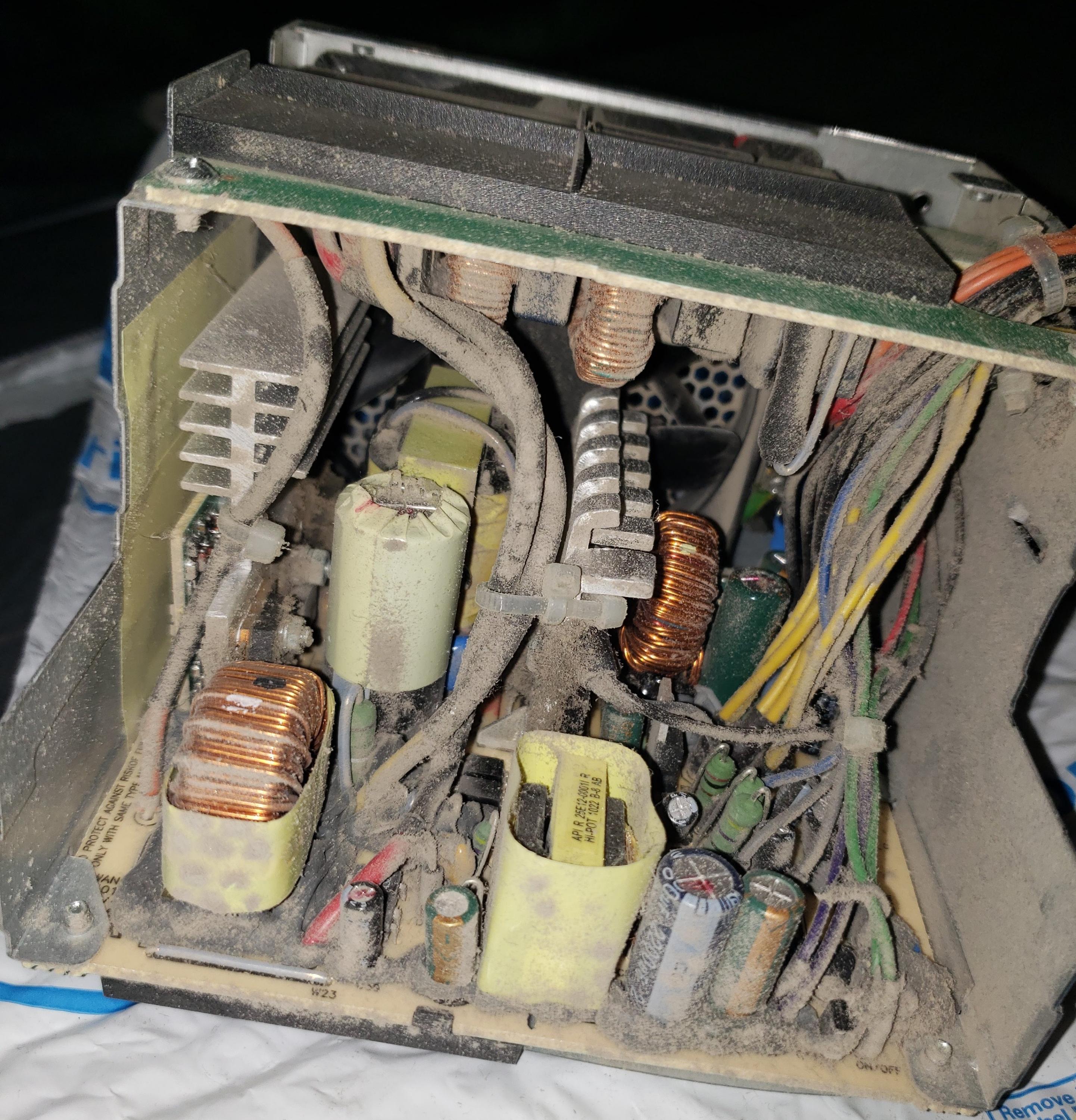

    Here you can see the PSU before it was recapped or cleaned. You can see that failed CapXon in there:

      The FL was near the HSF outflow side, about the hottest location in any SFF - no surprise that it failed. However, all the Rubycons (MBZ?) near it seem to be fine - as expected.

          Even all of the small caps? I replaced the 1800uF 6.3V Panasonic FL with 2200uF 6.3V Rubycon ZLQ.

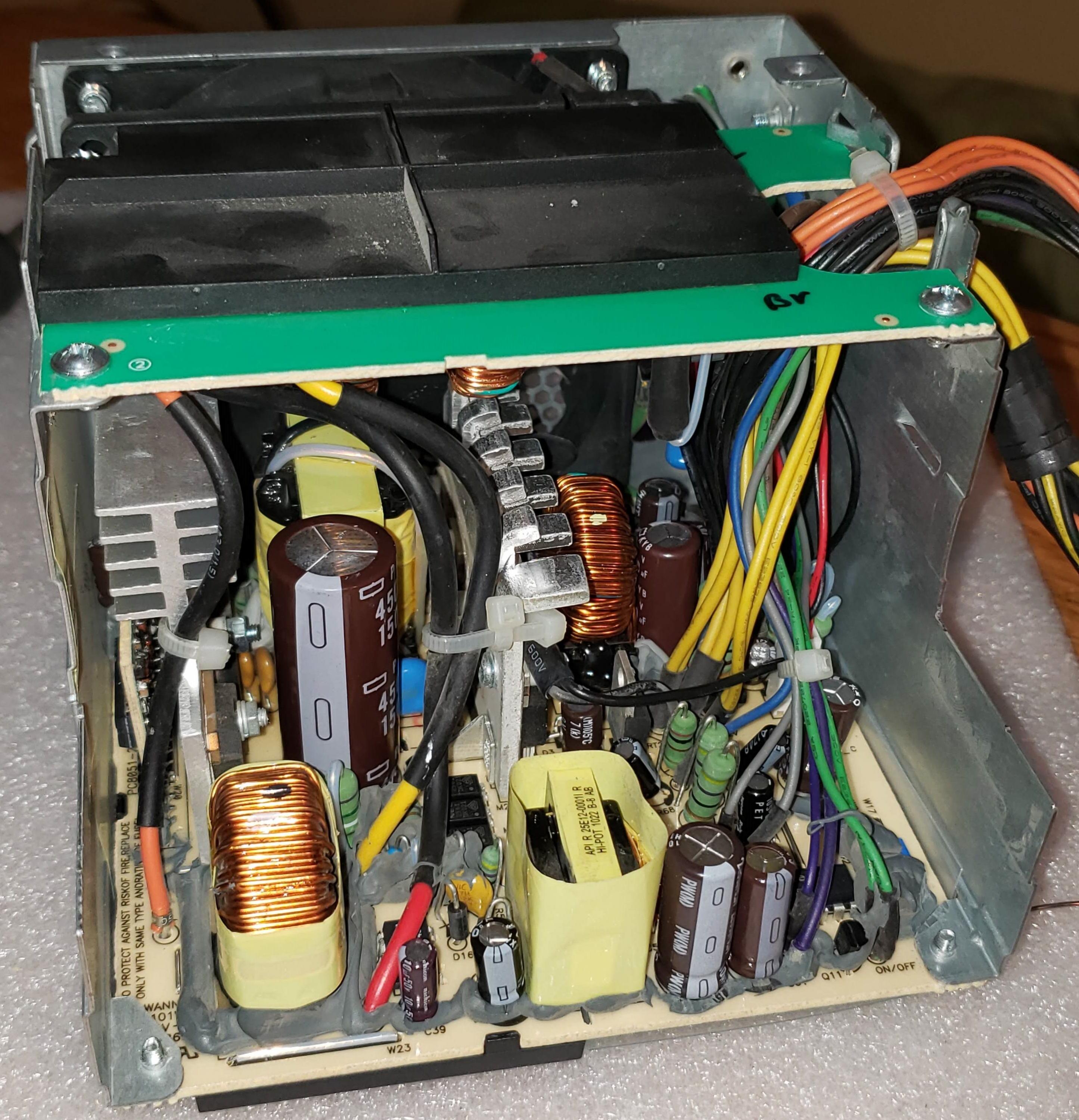

              I replaced all the KZG with polymer at least. I think it will last a long time. If I need to replace some more caps on the board later, that's fine. I just don't want to have to work on that PSU ever again... lol

                Here is the PSU all cleaned and recapped

                  Wow, you can hardly tell it is the same PSU as in the earlier pictures! Nice work!

                      I've actually seen many Dell toasters roast Panasonic caps ranging from the GX270 all the way up to GX755 era stuff and newer. Not as common as other brands frequented by Dell (Rubycon, Nichicon, and UCC)...but its certainly happened plenty.
                          Thank you! Yes, it's much happier now
