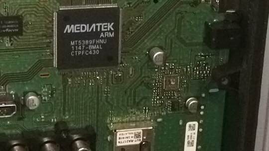

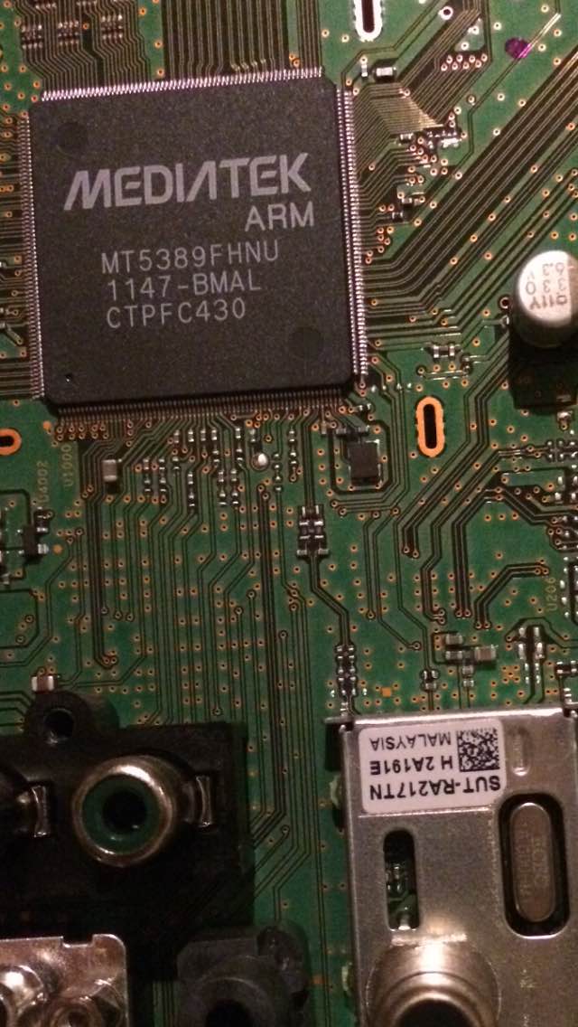

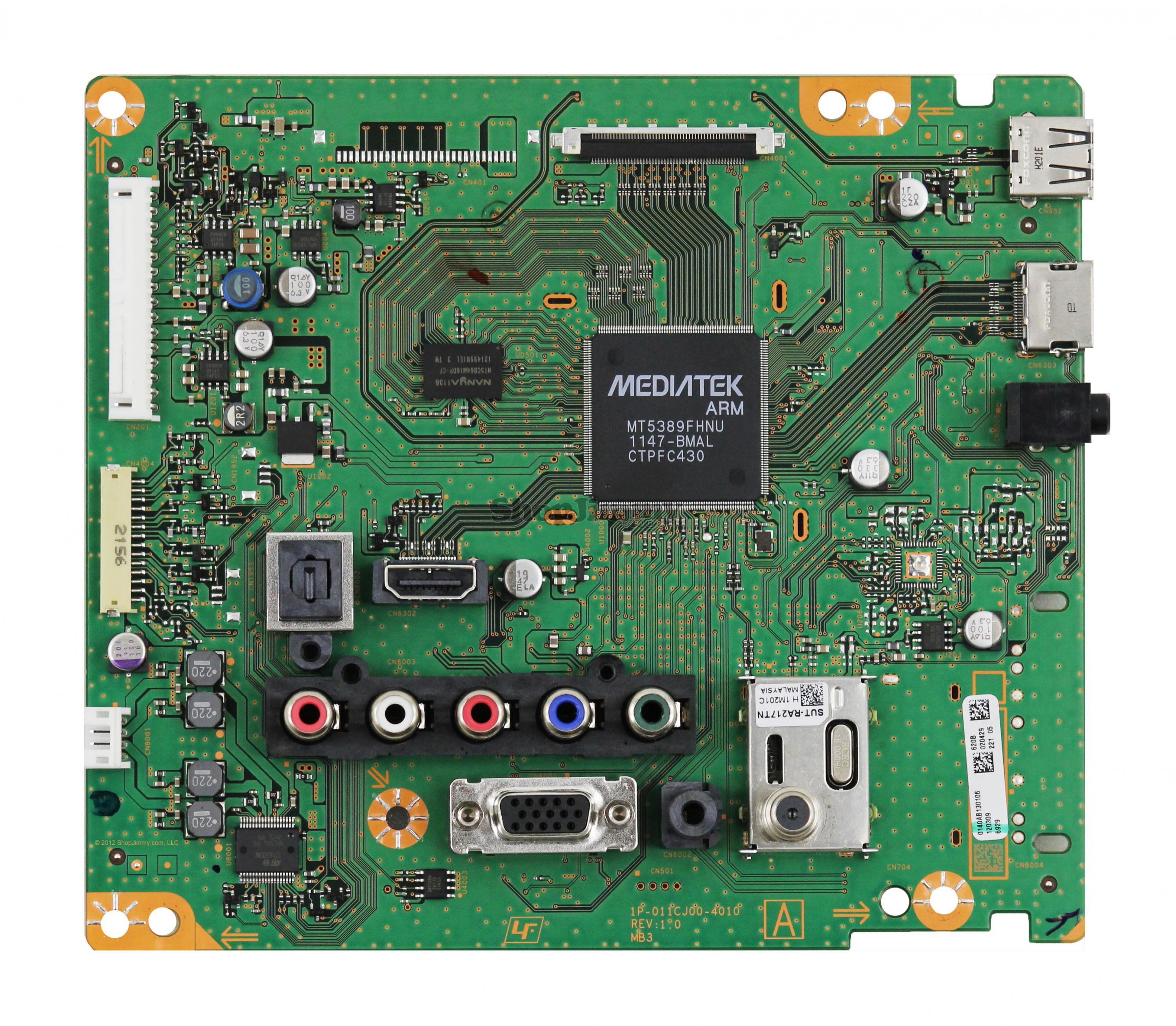

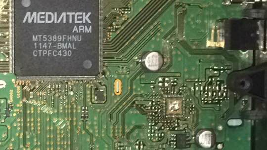

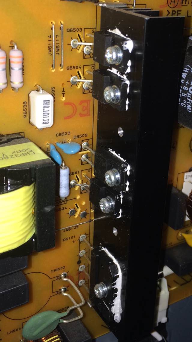

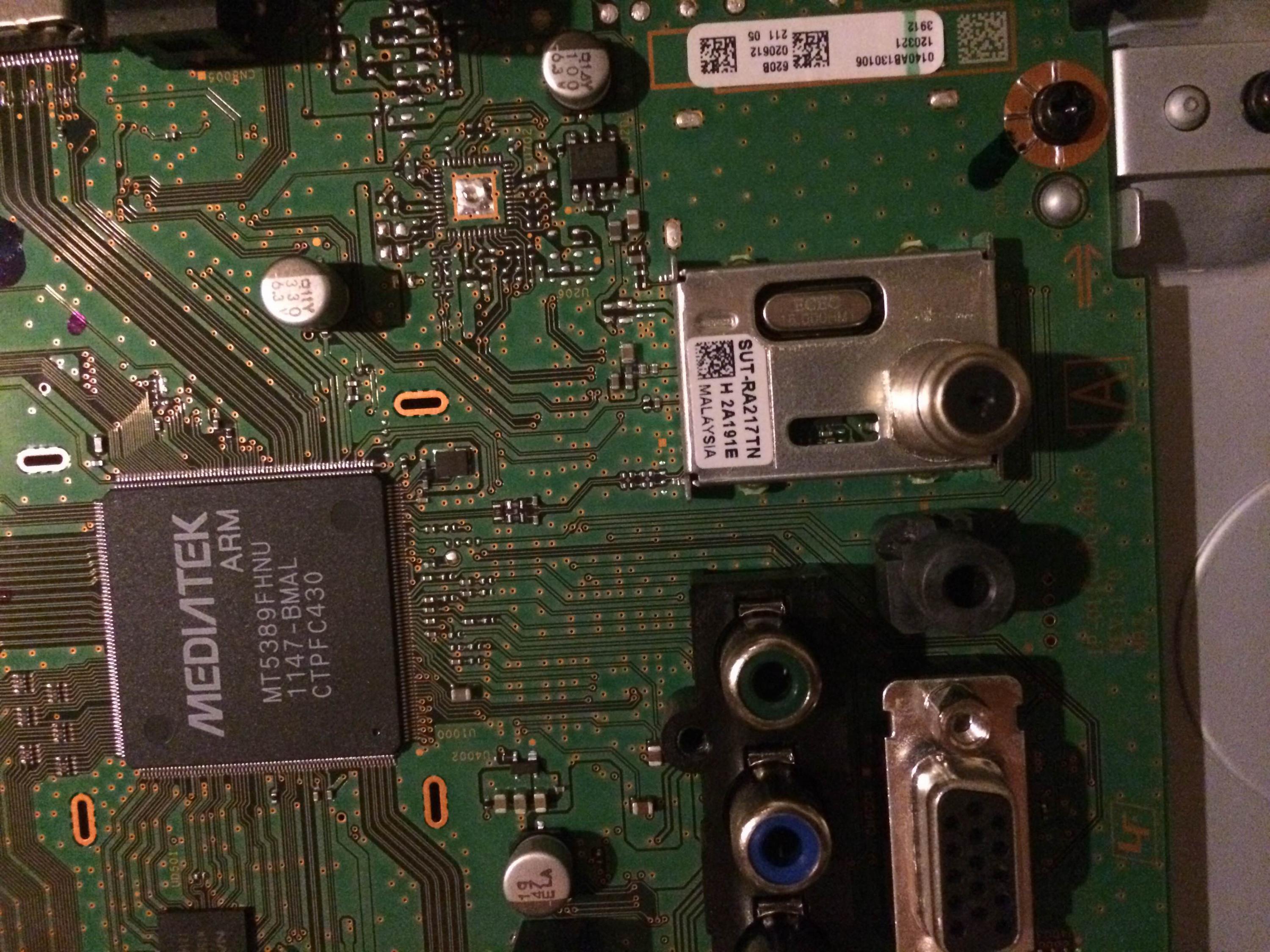

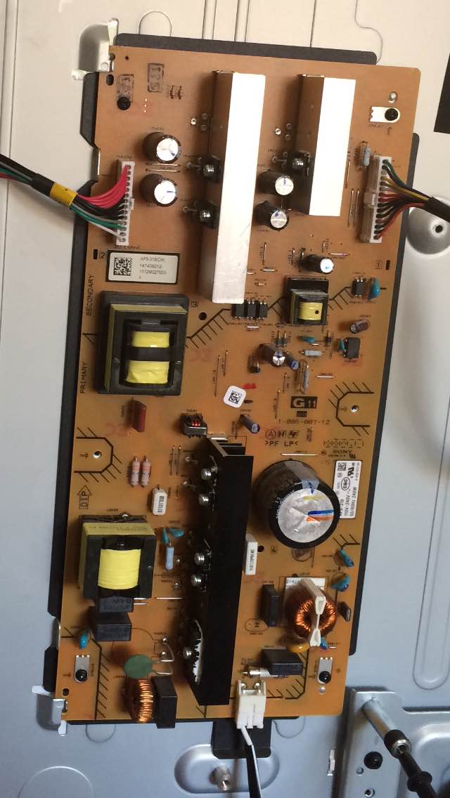

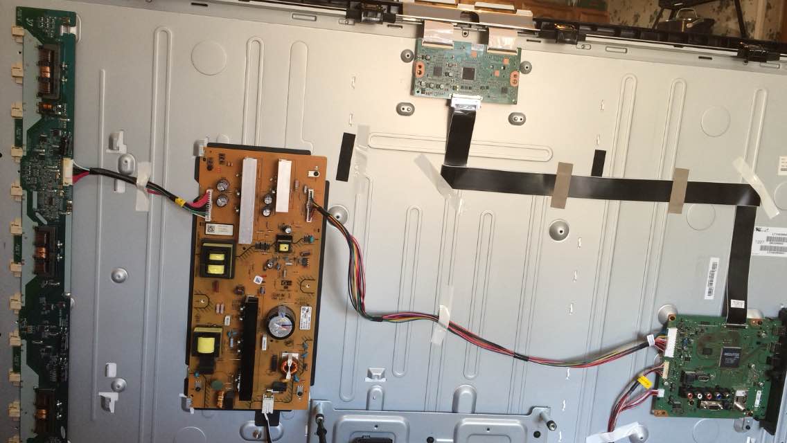

Ok first of let me say Thanks for taking the time to even read this, But this tv has got me beffudled. I have no red light no action when I press the power button or the remote, No backlight in dark room, nuttin. I tried unhooking the ir sensor and turning on (easy and cheap fix tried first) heres how the power board tests out
t-con on =0
T-con = Vcc 12v=.15
NC
Dimmer = 3.21
BL on= .15
BL err= 1.63
Reg 12v = 12.5
Reg 12v = 12.5
Reg 12v gnd= 0
Reg 12v gnd= 0
Audio 12v gnd = 0
audio 12 v = 12.5
power on = 3.3
acc off det = 3.04
stby 3.3 = 3.3

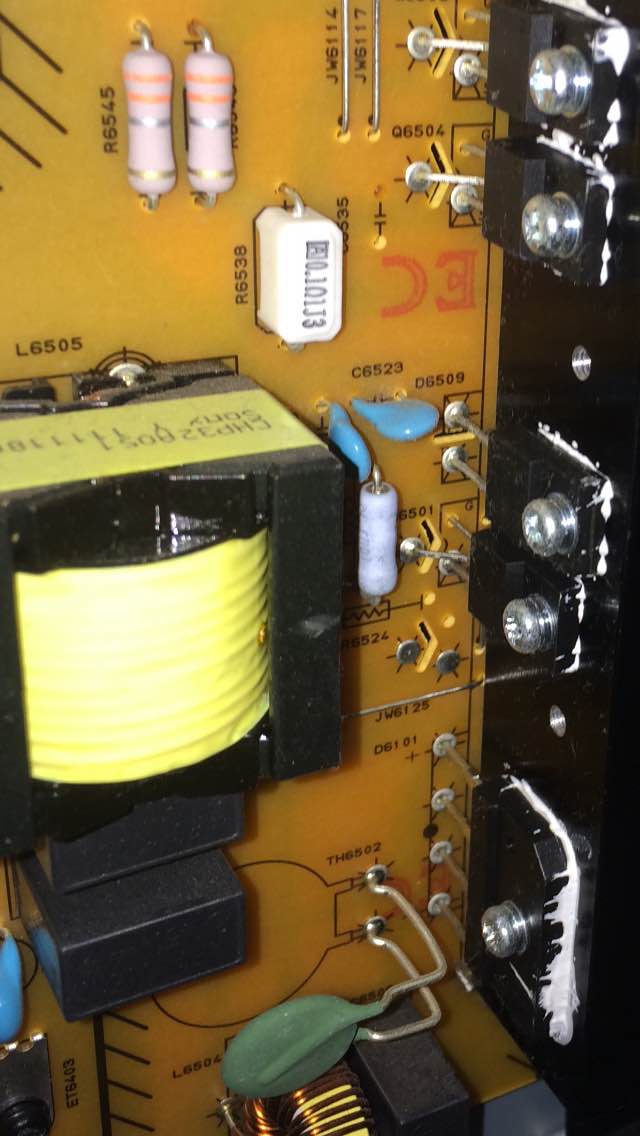

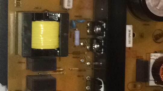

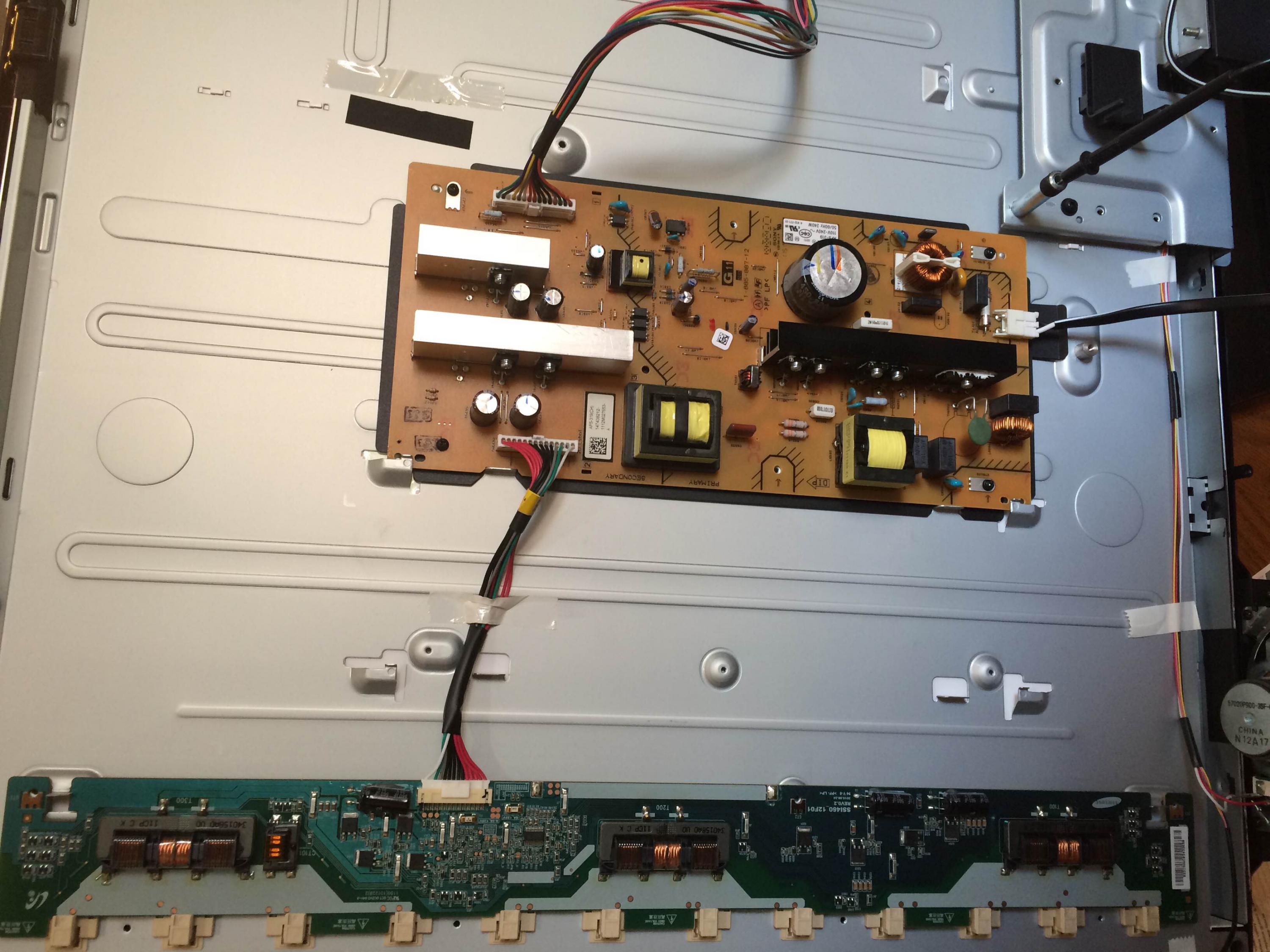

And the other side of the power board going to the inverter on that plug I get these voltages
Unreg 24v = 25.1
Unreg 24v = 25.1
Unreg 24v = 25.1
Unreg 24v = 25.1
Unreg 24v = 25.1
Gnd = 0
Gnd = 0
Gnd = 0
Gnd = 0
Gnd = 0
BL error = 1.63
BL On = .16
NC
Dimmer = 3.2

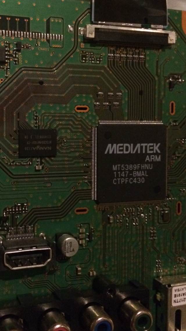

I also have it tested where it plug going out of main board to ir board and keypad(channel up down ) board , let me know if you want these .
