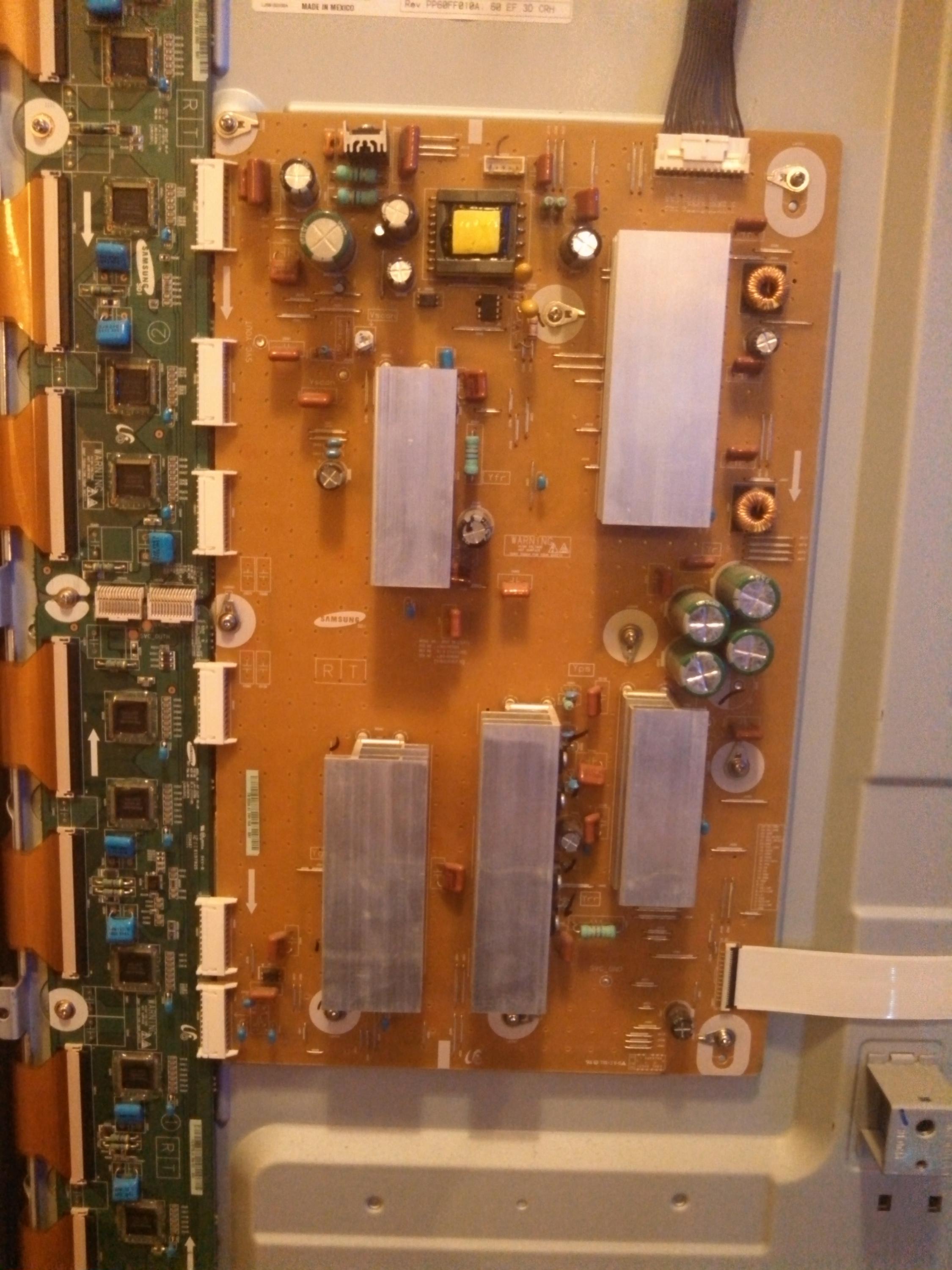

      My Y main dont have a spot for the C 5162. My tv was made in 2012. I see in pics here where it should be. But no spot on my board for it. Any help would be great
            post a picture of your board

              #66
              Re: Samsung PN60E550D1F no audio no image only red LED
              I dont know how to post pictures. I will have to look into that. But it looks like all the y boards posted on here.

                #67
                Ok here's my y board

                  #68
                  thats odd your board doesnt have a location for the blue cap
                  maybe its a different revision
                  have you tried spraying freeze spray on the ic chip at U5014?
                  or putting the board in the freezer for a couple of minutes and reconnecting it
                  i read in other posts that it will help to isolate the problem to the ysus

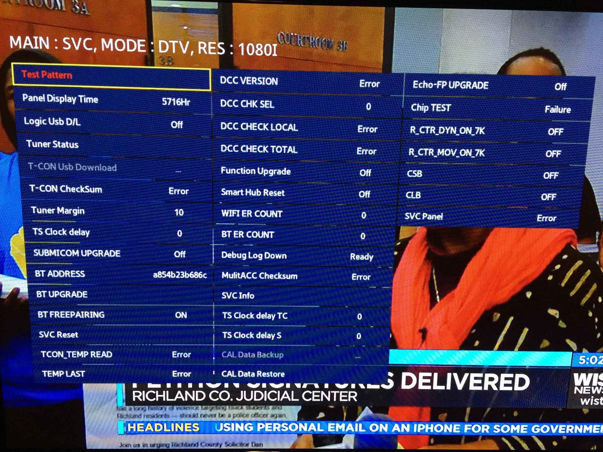

                        #71
                        I have a Pn60e550d1fxza that is exhibiting similar problems but not all the time.
                        If I disconnect power for awhile, then reconnect, I am able to get picture for various amounts of time, but the amount of time seems to get shorter.
                        My nameplate V numbers are:
                        Vs = 211
                        Va = 57
                        Vsc = -198
                        Ve = 98
                        When the TV is working correctly, I get the same values except Vs is slightly higher at 212.
                        When the picture is lost (still have sound), I have the green LED flashing 5 sec on and 2 sec off.
                        The V values are:
                        Vs = 10v
                        Va = 0v
                        Vsc = -0v
                        Ve = 11v
                        This values are nearly exactly as indicated in the original post.
                        I have read the entire thread. I haven't pulled cables off to check voltages in various conditions, but the initial feedback was to swap out the Y Sus.
                        The owner in this thread attempted a repair but still had the problem.
                        I am inclined to just go ahead and swap out the Y trio and maybe even the X.
                        I am wondering what the outcome of this problem was since it seems exactly like my case.

                          #72
                          I should also add that while I did have picture I was able to get into factory mode and took a picture of the SVC menu. The picture is attached. Any insights to what the errors may mean on several fields?
