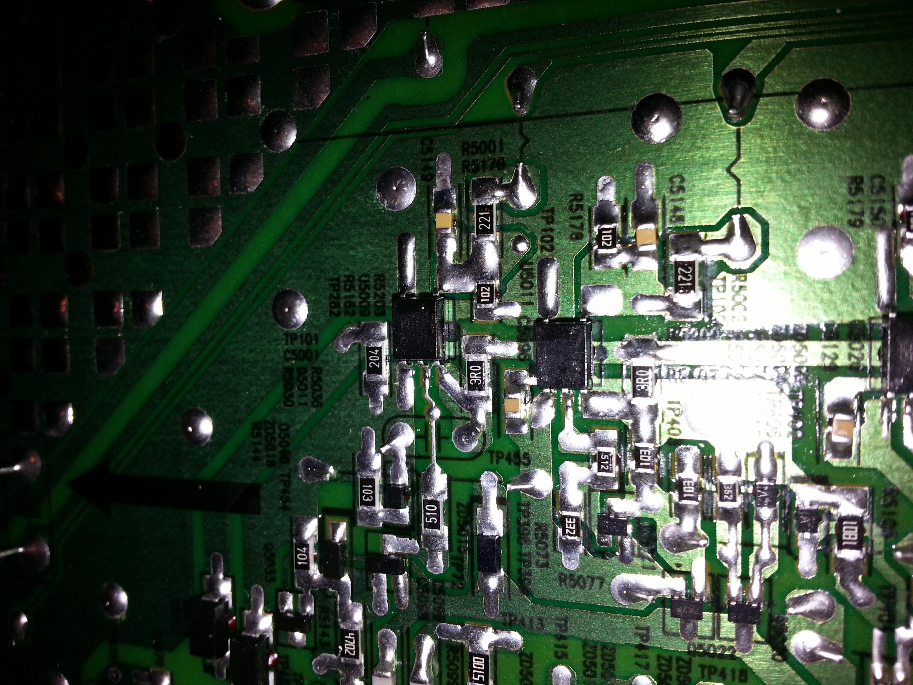

            So I received the xmain and the repair kit for the ysus
            I dont think i will be able to replace some of the components
            They are really freaking small
            Any suggestions?

              Ok so I replaced everything that was in the repair kit on the ysus board
              I installed the ysus and the xmain board from shopjimmy
              I powered it on and nothing!
              No picture no sound
              Please help

                            What is the voltage on your y-sustain board VSC?
                              #54
                              Re: Samsung PN60E550D1F no audio no image only red LED
                              after i replaced the repaired ysus and xmain from shop jimmy i believe the vsc was -45.3v
                              i will check again when i get home today
                              i do know it is below spec
                                #55
                                VSC should be -198 according to the label from your picture from TV. If only -45 then your Y-sustain still has problem. Try disconnecting both buffer boards from Y-sustain and verify VSC again.
                                  #56
                                  i did disconnect the buffer boards and that is the voltage i tested
                                    #57
                                    Vsc is -12.65v with buffer boards disconnected
                                      #58
                                      Your Y sustain board is still bad. You may have more bad parts then what the repair kit provided.
                                        #59
                                        what components can i test to figure out what i need to replace?
                                          #60
                                          I believe shop jimmy provided parts that based on their experience goes bad. You may ask their tech. support and they may provide you some feedback. Compare the parts with one you already replaced and see if new parts are still OK or they shorted. You may have bad panels and it may short your sustain board after repair.
