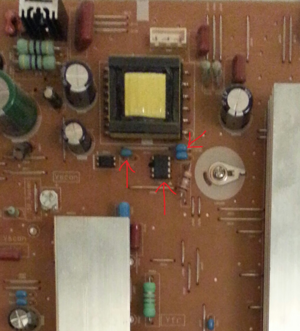

    Samsung PN60E550D1F no audio no image only red LED
    my friend asked me to look at his tv
    he said that he would have to power it on and off several times to get it to work properly
    then he couldnt get an image just sound
    now that I have the set it has no image or sound just the red standby LED
    when i power it on with the remote the red LED blinks 5 times and goes away
    i notice the green LED blinking on the logic board

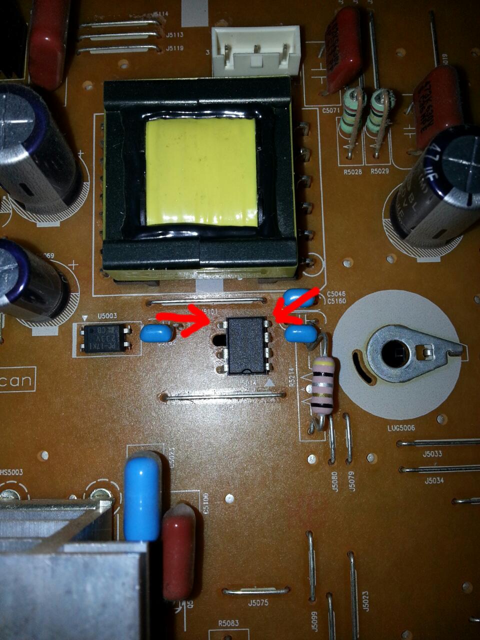

    i read 2 posts on here that the main board or the ICE3BR0665J on the ymain may be suspect

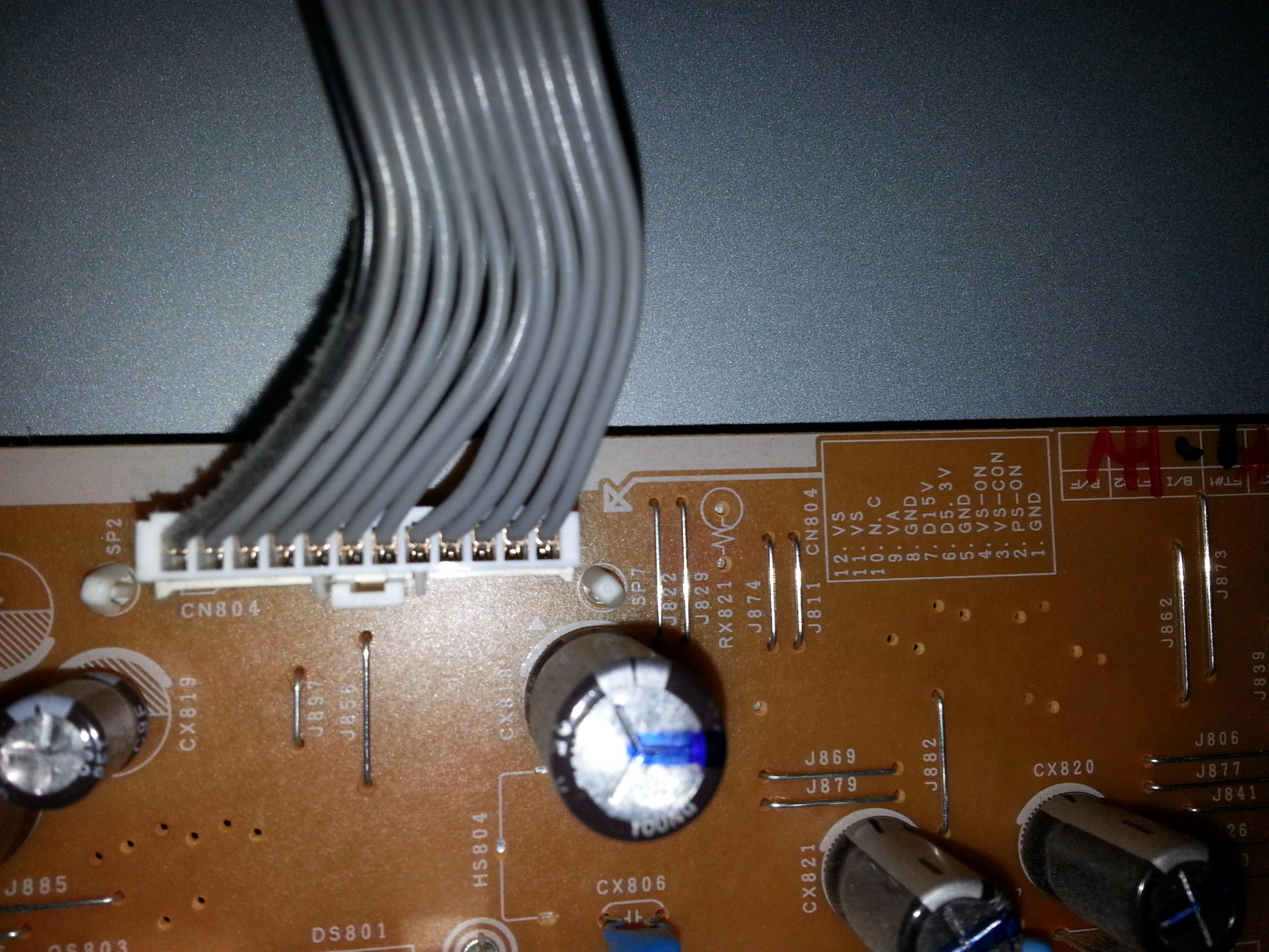

    i tested connector 804 on the PSU
    1. GND
    2. 0.123v
    3. 0.006v
    4. 0.001v
    5. gnd
    6. -0.003v
    7. 15.32v
    8. gnd
    9. 0.007v
    10. 0.001v
    11. 10.45v
    12. 10.45v

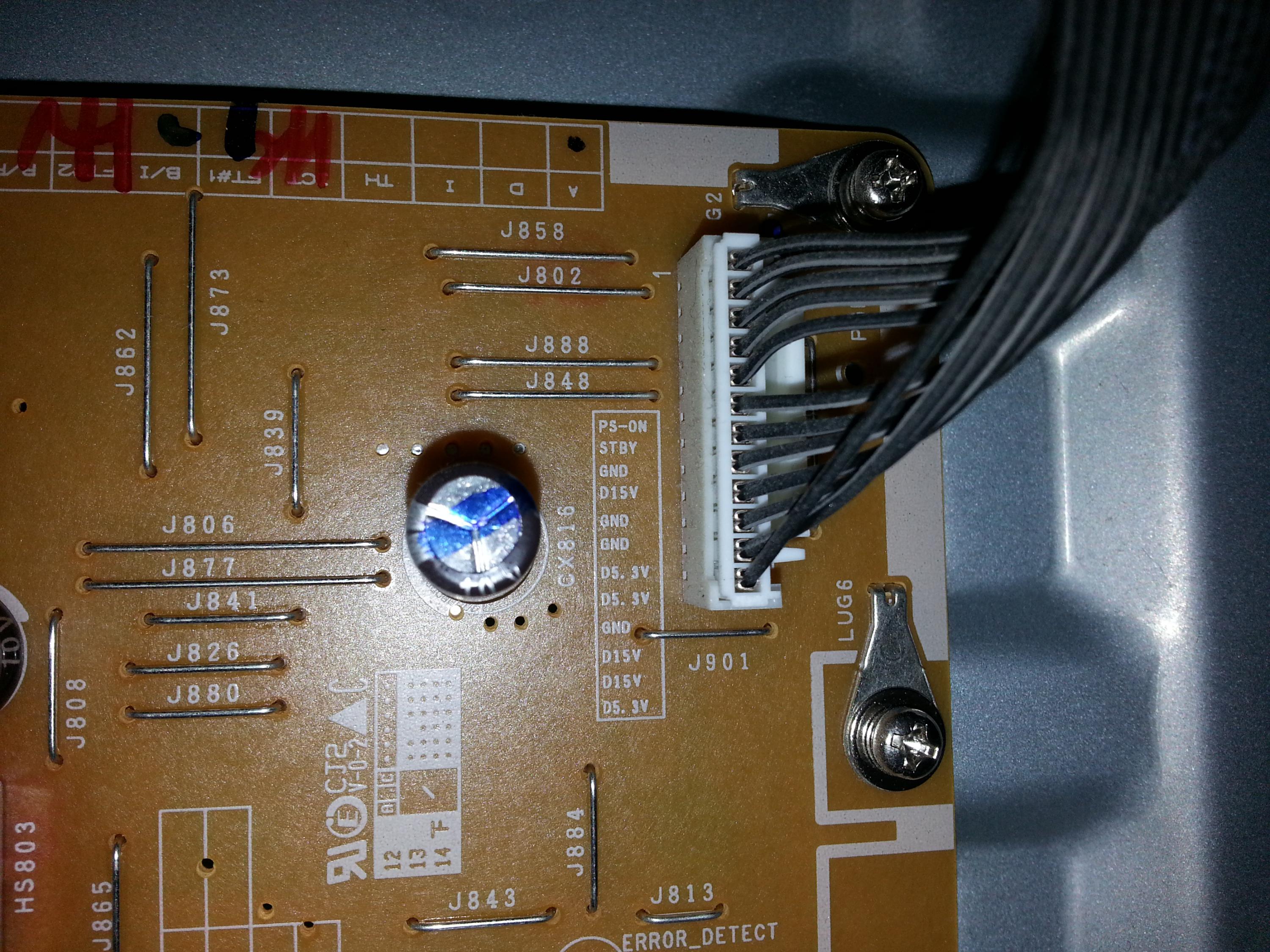

    connector 801 on PSU
    1. 0.123v
    2. 5.23v
    3. gnd
    4. 15.31v
    5. gnd
    6. gnd
    7. 5.18v
    8. 5.18v
    9. gnd
    10. 15.32v
    11. 15.32v
    12 5.18v

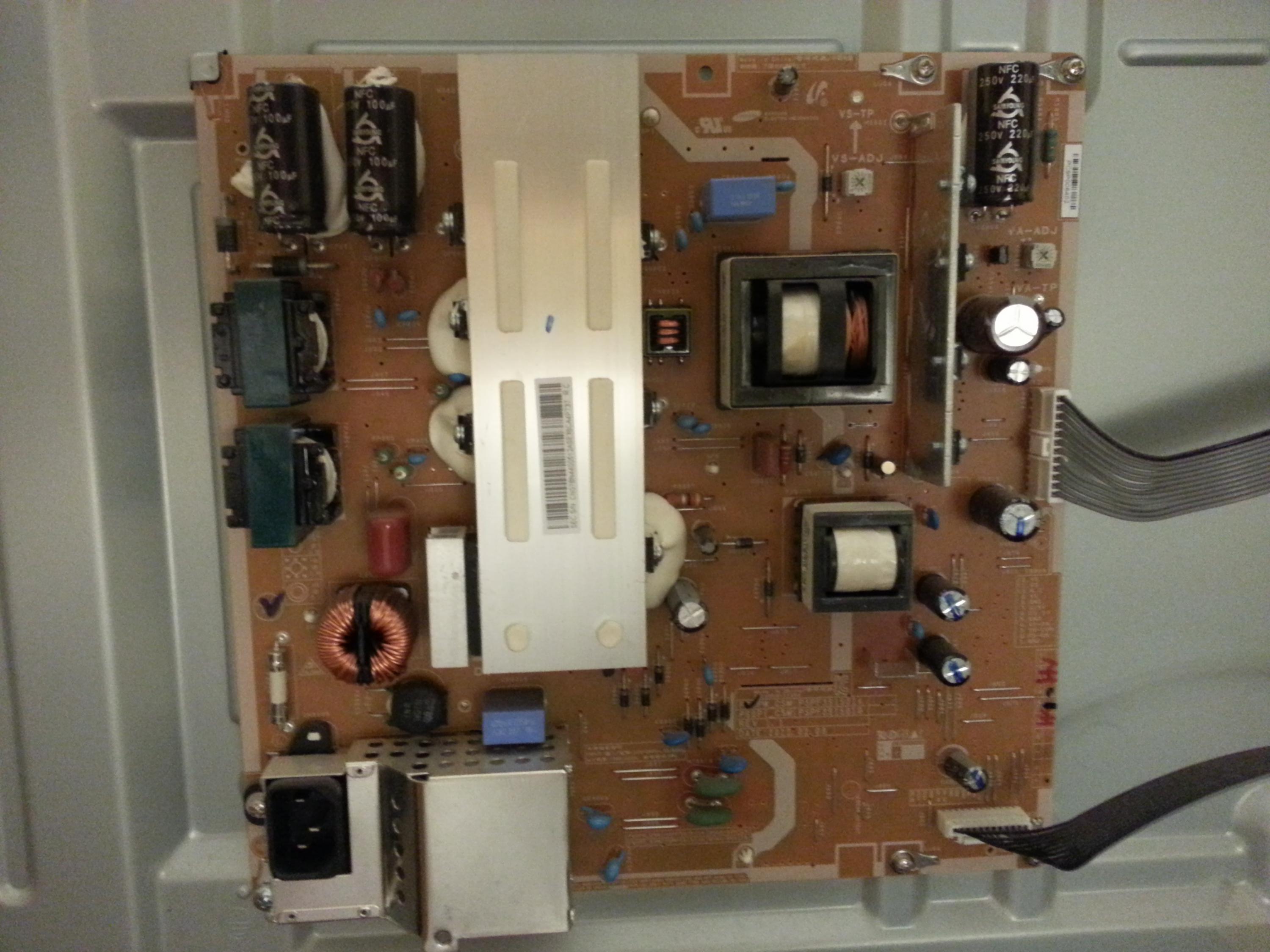

    Pics of the connectors

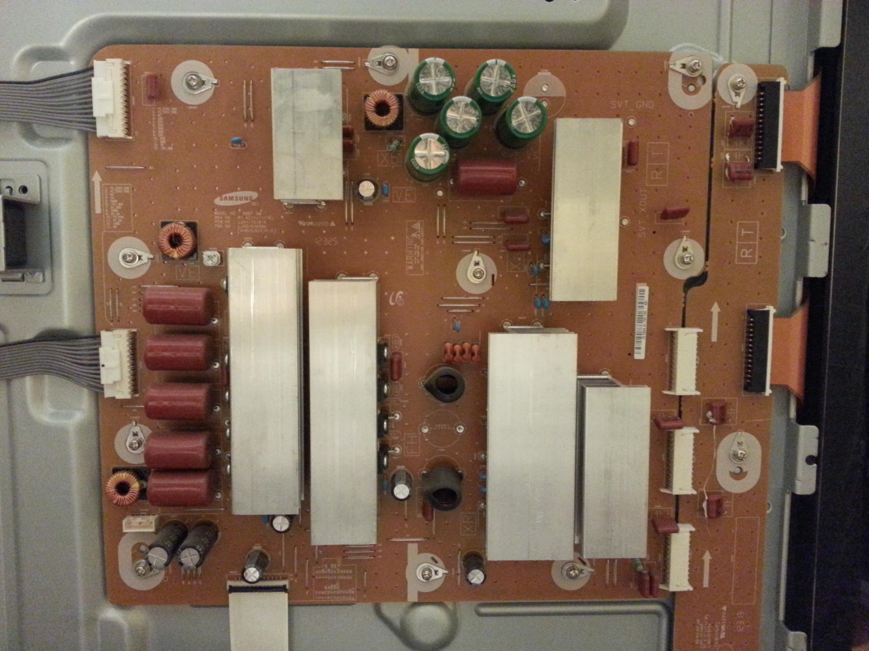

          Re: Samsung PN60E550D1F no audio no image only red LED
          Check Vscan with buffer removed
          • jose6326
            • May 2013
            • 707
            Remove Both upper and lower y buffers?
            • jose6326
              • May 2013
              • 707
              I removed both buffers
              Vscan is -63.4v
              Vs is 210.9v
              Va is 56.8v
              Voltage readings are constant

                  • Hamie
                    • Apr 2014
                    • 1383
                    You have a problem with your y-sustain.
                    Buffers might be ok, best to check the ICs for low resistance to ground.

                      • jose6326
                        • May 2013
                        • 707
                        i read on another post that the IC and blue caps may be the cause
                        sorry for the poor pic quality

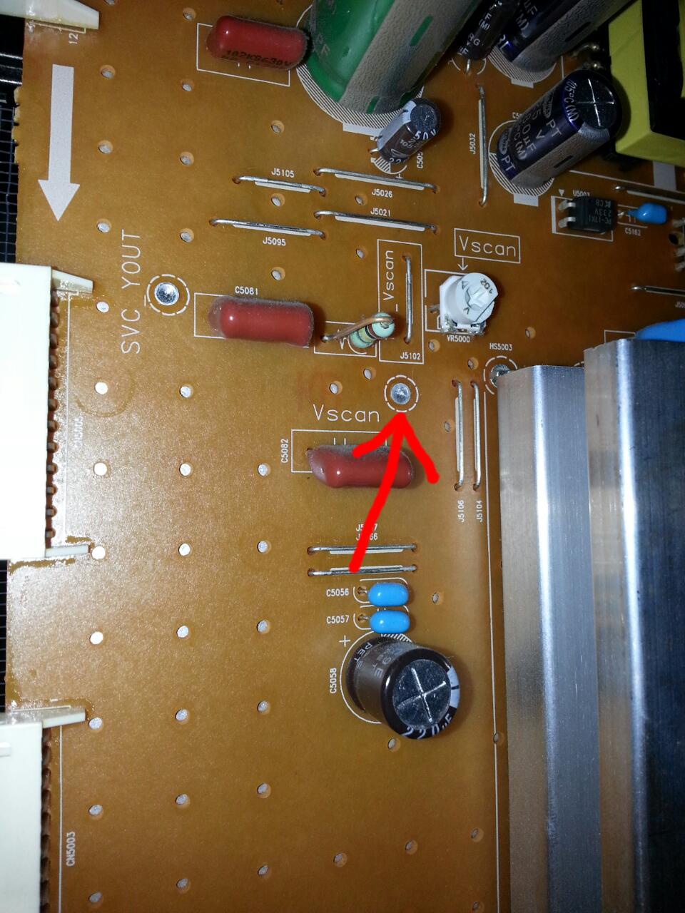

                          Vscan should be closer to -200V
                          unless that is the HIGH scan voltage which may be 150V above -Vscan (approx -50V)
                          Try checking between floating ground and scan outputs of the buffer board, the floating ground is on the connector with many pins connected together, and the HIGH scan output has a few pins joined to each other (basically where you'd check on an older buffer board for a short)
                          • jose6326
                            • May 2013
                            • 707
                            I tested vscan where I markes it in the picture
                            Is that the correct test point?
                            • jose6326
                              • May 2013
                              • 707
                              I have a new ICE3BR0665J and I decided to test it on the ohms setting and compare it to the one on the ymain
                              The top 2 legs on the new IC read 0.1 ohms
                              The one on the ymain read OFL
                              Does this mean it is shorted?
                                  Try checking between SVC YOUT and Vscan should read approx 150V
                                  • jose6326
                                    • May 2013
                                    • 707
                                    I get -46.8v when I place the leads on chassis ground and positive lead on the svc_yout test point
                                    • jose6326
                                      • May 2013
                                      • 707
                                      did i test this correctly?
                                      • jose6326
                                        • May 2013
                                        • 707
                                        So I replaced the ic chip with a new one and I replaced the 3 blue caps near the ic with some other exact blue caps from another board I had
                                        I connected everything back powered it on and nothing
                                        No image on the screen
                                        I tested the voltages with logic board connected and same results vs and va dropped.
                                        Vsc was at 0.002 with and without logic board connected
                                        I removed the buffer boards and disconnected the logic board va and vs went back to spec but vsc went -63.4v
                                        What else can I do
