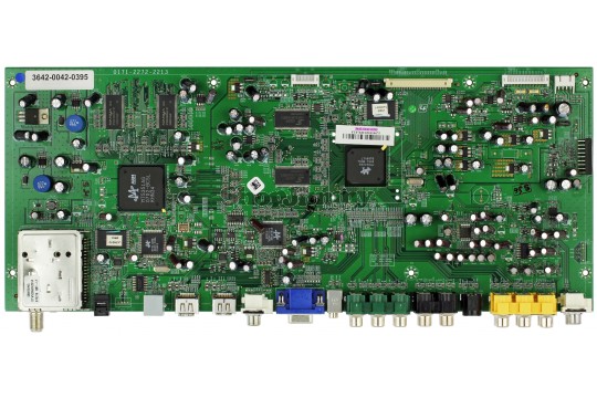

    Picked up this set today. It will power on. No picture or sound. And it will not turn off. I think mainboard. I have all voltage 24v,12v 5vsb 5vps-on 3vbl but no dimming. Pictures will come later.

      replace u9 on the board and recheck the voltage on all of them. Normally just that voltage reg goes out from what I seen.

        Input is 5V and no output? it is dead if that is the case or shorted load (you can check the resistance on output pin against GND).

          Will do that tomorrow. I found u18 shorted. Replaced it and still the same.

            Shorted at the Input pin or output pin? It may be shorted out MLCC.

              I replaced u8, u9, and u18. Still same results.What is the MLCC?
                Re: vizio l42hdtv10a
                So when you removed the regulators, did you check the resistance between the solder pads where the regulators were against GND to see of the shorts went away?
                MLCC: Multi Layer Ceramic Capacitor.
                  yes i did check and the short didn't go away.
                    So it is not the Regulator IC. So was it the input in or the output pin that shows shorted circuit?
                    I would remove the MLCC on the pin that shows shorts circuit.

                        Ok replace the main board. Still the same. There is no bl_on voltage or no dim light voltage. I got 4.4dvc on the ps-on. What you guys think?
                          Where did you get this board from? Those signals are generated by the main board.
                          • fixerupper75
                            • Oct 2014
                            • 125
                            • us
                            Electroparts off of ebay. I think I've made a rookie mistake the board number doesn't match. Orginal 3642-0062-0150 new 3420-0012-0150. ugh.
