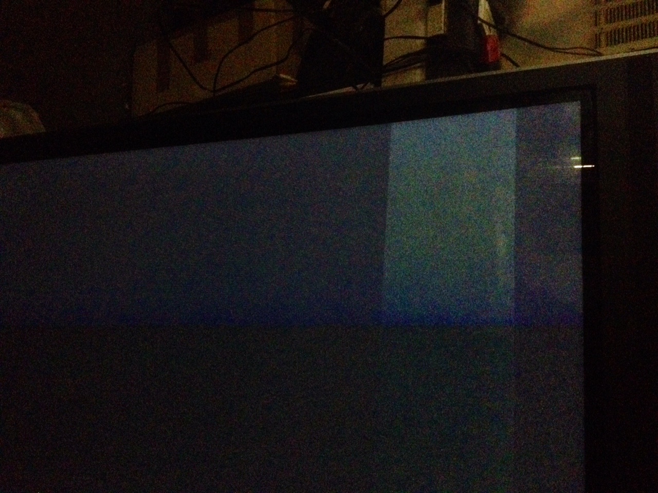

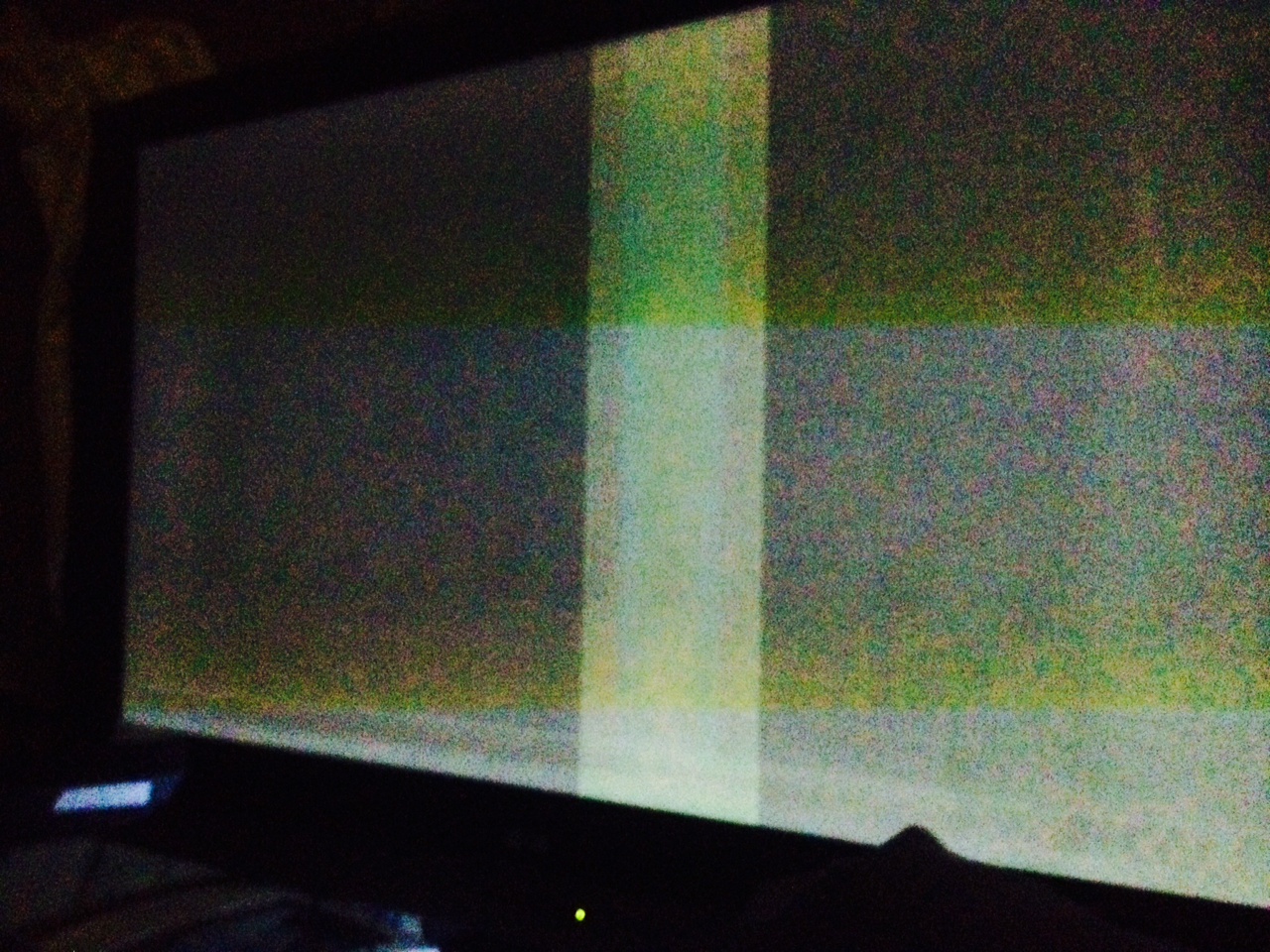

    I've got a LG50PC3D that would not power up due to the caps on the power supply. I recapped the power supply, the TV turns on and stays on but the screen flashes white/gray repetitively, sometimes you can see vertical bars. "please see attachments"
    Any help and advice is greatly appreciated!

    Do you hear any ticking noises coming off the y or Z sustain boards associated with the flickering? Looks like a blown IPM module or a shorted mosfet on the upper or lower buffer board.
    Feel all four heat syncs on the y and Z. There are two on each. One of them cold still?

      Looks to me like a Zsus issue as the pixels are slightly lit but arnt being discharged properly. Checked fuses on Ysus and Zsus ?

          I got the mosfets shorted in the upper buffer with the same symptom
            Re: LG 50PC3D Screen Problem "Pictures Included"
            Y-buffer FETs shorted IMHO

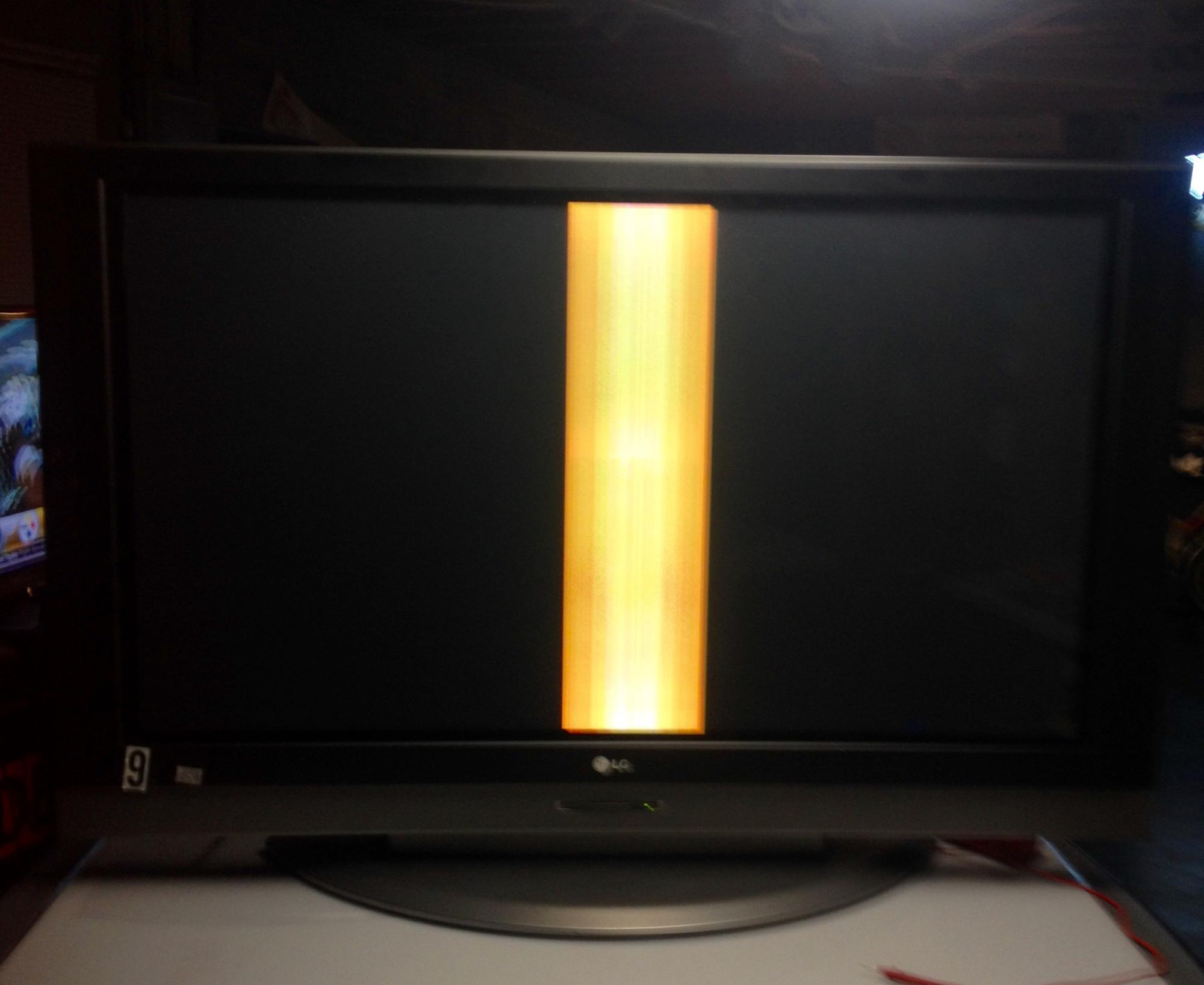

              Re: LG 50PC3D Screen Problem "Pictures Included" Updated!
              Okay so I replaced the Y-sus main, and found 3fets shorted on the lower buffer. Replaced those and hooked everything back up and now I have a color vertical bar that moves across the screen left to right. Any ideas to what's causing this now?
