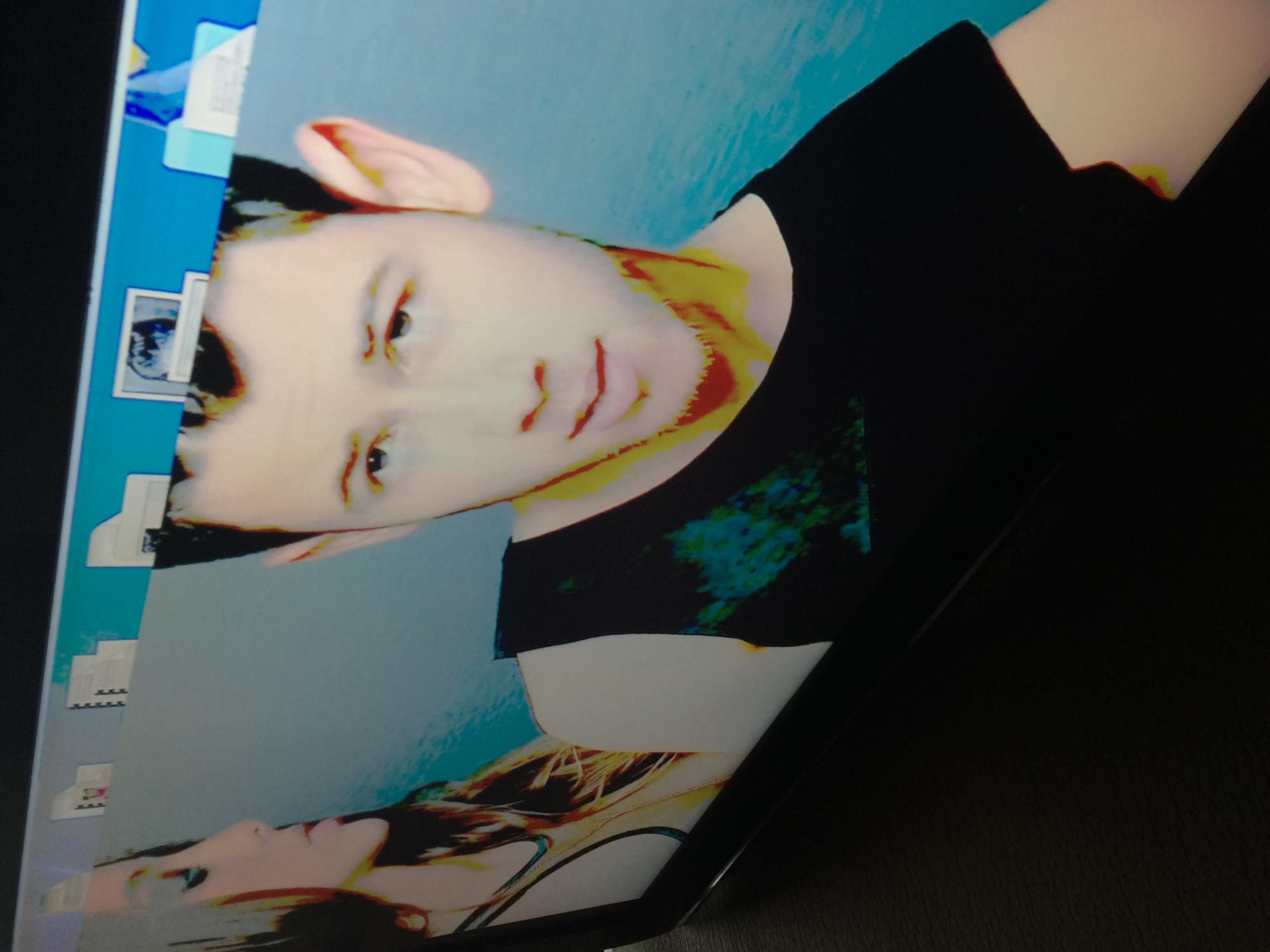

    Hi, I need help in fixing my tv which has solarized image. Can you tell me where is the problem? In the t-con board or main board or power board?

    This is a tcon board problem could be the as15 gamma ic. But before you buy a new board try reseting the lvds cable. Could just be a dirty connection.

      And i see one capacitor swollen little bit. Does this also have effect on solarization? Can you tell me where is this cable located at please?

        Re: Solarized image on samsung LN40B5307PN
        Between the main board and the tcon.
          A bad capacitor wont cause that symptom I would say failed As15 ic.
            yep i agree with that, as15f
