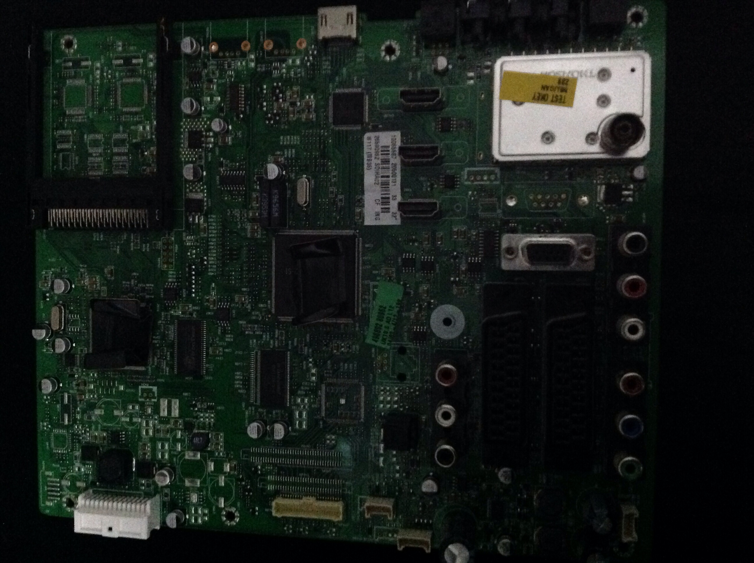

    Hello all, I have here a 32" Lowry Tv rebadged Vestel junker. The failure here is that the standby led comes on red (standby) then goes blue (on) then shuts down back to red, what is happening is the Psu is going into over load because the mainboard is shorted. I had one of these 17MB35-4 with the same failure and never fixed it. The whole 3.3 volt section is almost completely shorted to ground very little ohms, this is abnormal. Here is what I found:
    U121 Reg shorted in circuit however tests fine out of circuit.
    U132 Reg shorted in circuit however tests fine out of circuit.
    C308
    C293
    C290
    C284 Ceramic capacitors all show shorted in circuit however test fine out of circuit.
    All fuses are good, which isnt good because it means that the fuse has failed to protect the circuit hence Psu going into shitdown.
    I cant seem to fond what part the voltage stops at as it shuts down too fast. Any help or ideas on what to test are greatly appreciated. Thank you.

          Tom, the 3.3v rail going to the mainboard is shorted to ground 5v is fine. I am 90% sure its not the Psu that caused this.
            Re: 17MB35-4 3.3V Shorted Help ?
            OK, didn't realise it was a ground short. If 3.3V is shorted to ground then it is probably a bad CPU or other component like HDMI receiver shorted. Not an easy fix.
            You can try powering 3.3V using an external PSU and seeing what gets hot but otherwise you're probably going to need a new main board.
            Maybe you'll find a shorted MLCC. I had one of the 17MB62 boards with about 5 ohms between 3.3V and ground, I believe it was power surge damage on HDMI input but may also have been a random CPU failure.

                Quite certain that the Hdmi processor is at fault now, not only is there super low ohmage it almost looks like there is a blister in the centre of it :L Hmm going to look into this more tomorrow. Already had enough of Hdmi chips today after fixing a Panasonic with a Hdmi processor related issue earlier. Will update you tomorrow on what I find.

                      Also that Hdmi chip is not the lowest point of resistance there is a ceramic cap checking lower however out of circuit it checks fine, but sort of happy I can nearly rule that Hdmi processor as not being the issue. Stj do you remember the part number of that cap cheers ?
                      • ReeceyBurger123
                        Never Give Up !
                        • May 2014
                        • 7325
                        • Britain
                        Here is an image of this board, I know its crappy contrasts however just sent if you could highlight or tell me where that bad MLCC was cheers.
                          • 31183
                          that's a different layout, but it would be in the psu section lower-left in your foto.
                          strangely yours seems to be missing most of the parts!
                          i will tell you how i foud it.
                          i made a list of all the caps on the 3v3 rail,
                          then i hooked my meter to the 3v3 and gnd set to continuity with the beeper on.
                          then i just lifted and put back each part with the air-station till the meter stopped beeping.
                          and that's why it takes forever!

                                  Well wouldn't you know it would be the last thing I checked, the flipping Hdmi processor is at fault, didn't even need an external psu to determine that this thing was getting very very hot, it burnt my finger haha. I removed the processor off the Pcb and the tv now behaves normally. The Psu completes its self test and the short on the 3.3v rail has gone, upon pressing the power button the standby light goes blue but after about 10 seconds the tv shuts down this is because the Cpu is detecting that the Hdmi chip is not present.
