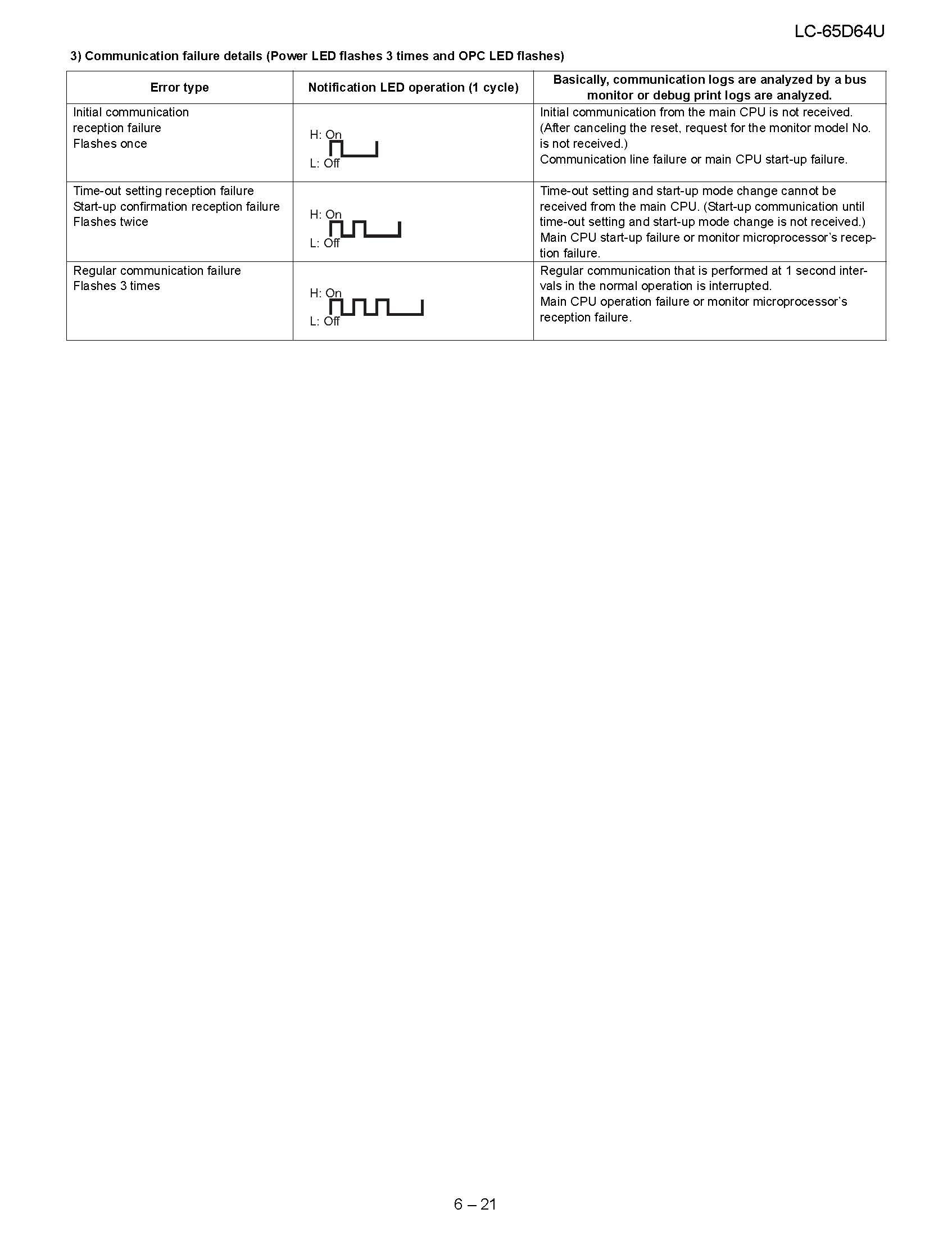

      Hello Budm, thank you for writing back to me so quickly. I read the links you sent. I guess Service Manuel says this is my problem;
      Communication failure details (Power LED flashes 3 times and OPC LED flashes)
      --just not sure if this is the same as what is happening, which is; "Power & LED flashes together once, then Power flashes twice quickly thereafter. Then does this again & again"?????
      If above is correct, Service Manuel says my problem is;
      Regular communication that is performed at 1 second intervals
      in the normal operation is interrupted.
      Main CPU operation failure or monitor microprocessor's
      reception failure.
      But really don't understand what this means???
      There are not many Boards inside this TV. Is there a way the codes I mentioned; "Power & LED flashes together once, then Power flashes twice quickly thereafter. Then does this again & again" can tell me which Board to change????
      Was hoping for any easy answer

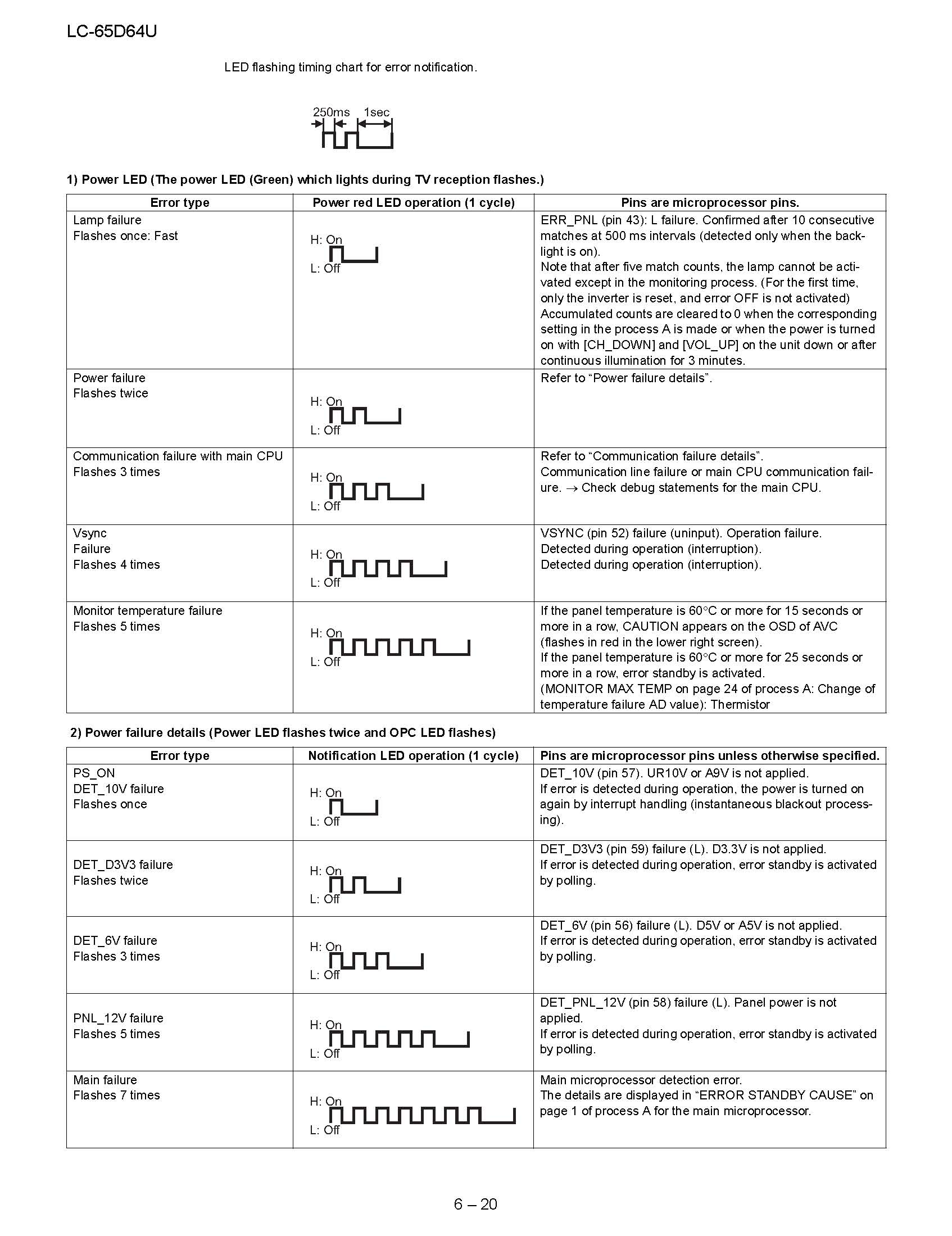

              This is exactly what is happening;
              "Power & LED flashes together once, then Power flashes twice right after. It does this again & again"
              Anyway to know what the correct code is from this??????

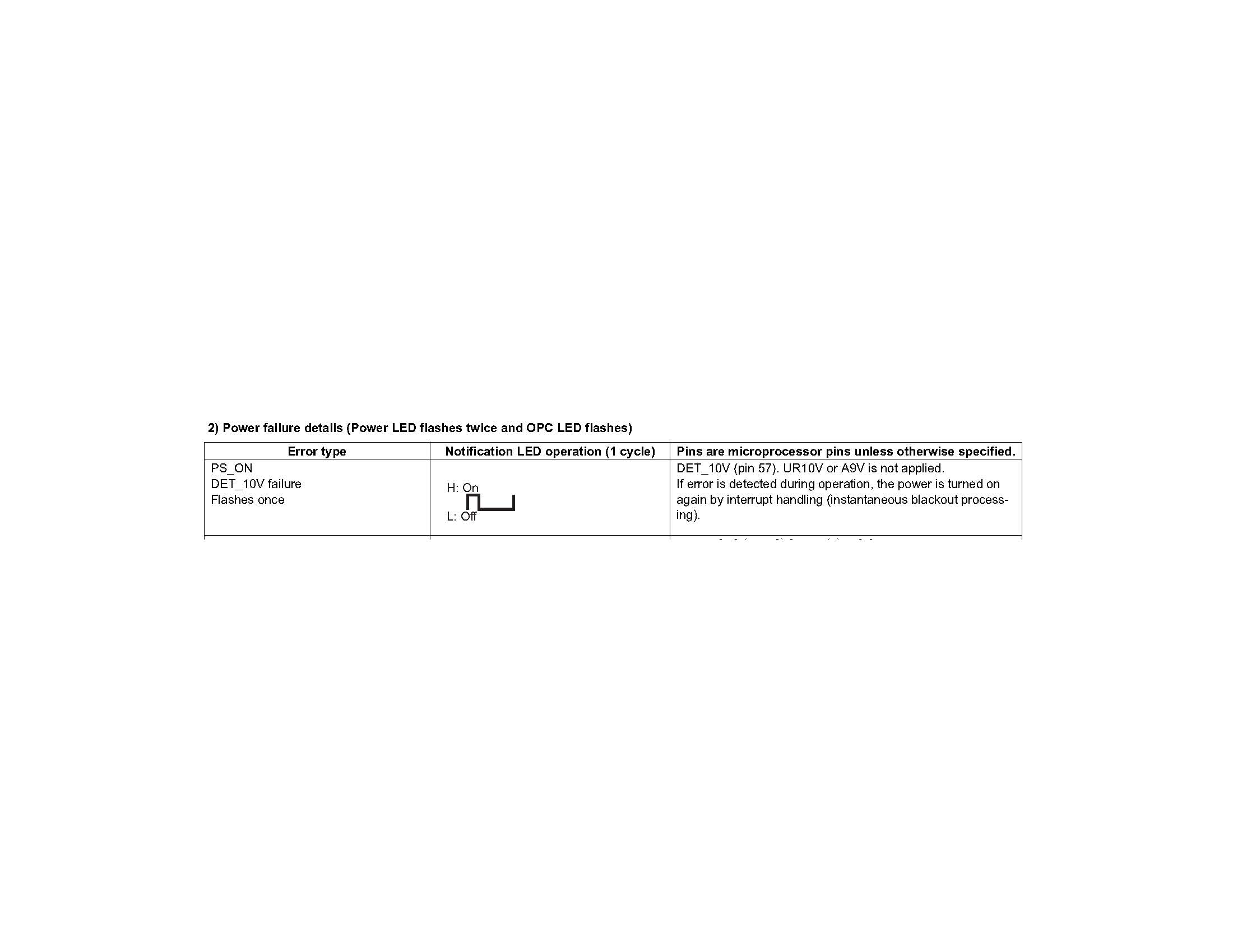

                Do you mean the POWER LED and the OPC LED, right?
                So you have POWER LED flashes twice and the OPC flashes once.
                Power LED flashes TWICE, that will be the #2) Power failure details (Power LED flashes twice and OPC LED flashes), then the Column below is tell you the OPC flash's codes.
                • Jim34652
                  • Oct 2015
                  • 11
                  Re: Sharp Aquos 65" one-two blink code??
                  Green Power & Green OPC light flash once together.
                  Then, right after that, Green Power light only flashes 2 more times.
                  Does this sequence over & over again.
                    So that will be the POWER LED flashes 2 times + OPC 1 time.
                    PS-ON, DET_10V FAILURE.
                    PS-ON is generated by the main board.
                    10V is generated by the power supply board.
                    That is why you need DMM to test the Voltages and signals
