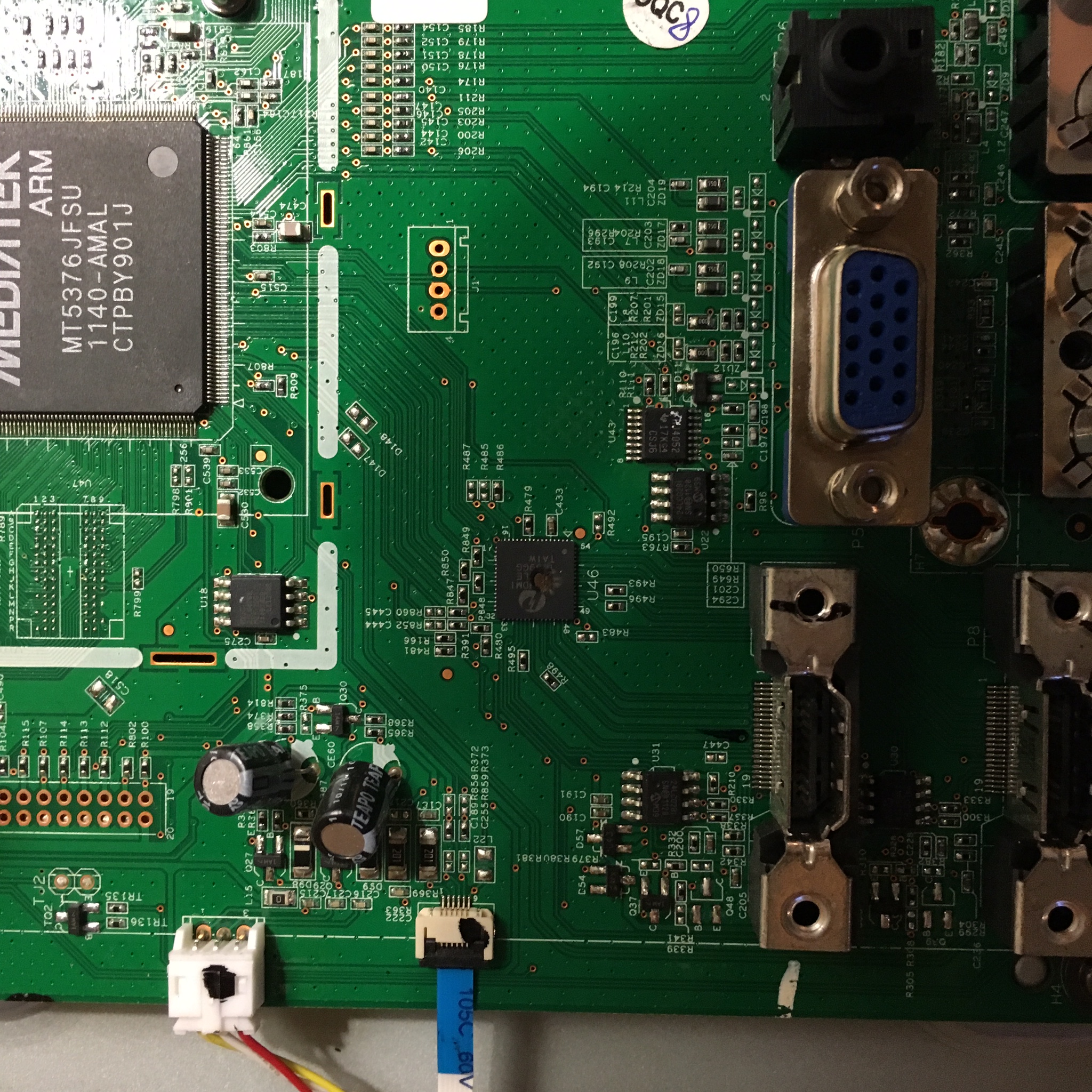

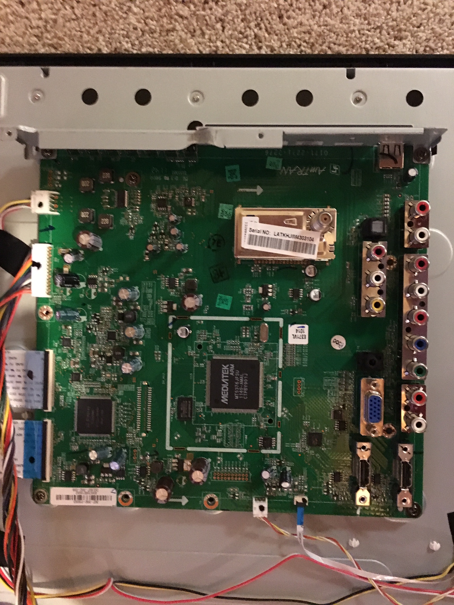

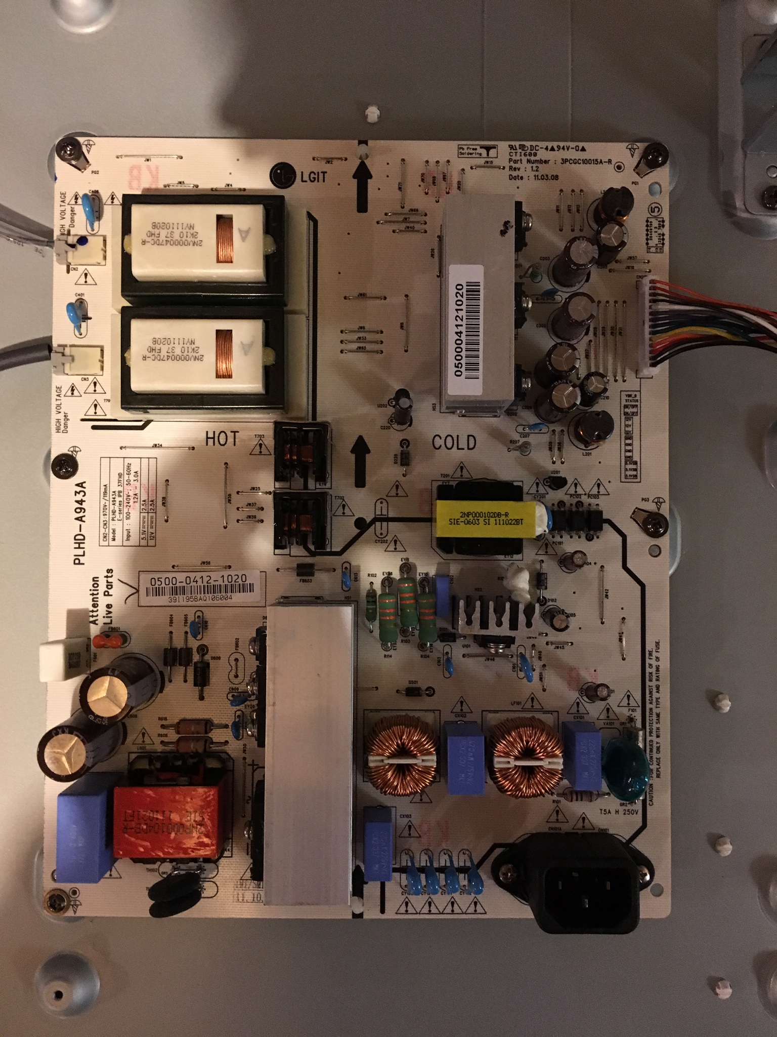

    I picked up a vizio e371vl (also a e422vl) off of craigslist for free. Owner suspected they had died from a lightning strike. That is all I know of their history. Working on the 371 first. Plugged in it is completely dead, no standby light, vizio logo does not light up any color. Back pulled off. I am a novice when it comes to TV's. Most of my experience deals with PC's and PC monitors. Visual inspection does not show anything obvious, caps look good, no burn marks. I checked the volts at the plug on the power board. The 5volts all look good when plugged in, the 12v and the on/off all stay at zero, even when power button is pushed. I assume and this could be totally wrong that I am looking at something on the main board? Pics fo boards and my meter below. Will this meter be sufficient or do I need to invest in something better?

    If you do have 5VSTBY to run the main board but the main board does not send any command signals to turn on the rest of the power supply, the the main board will be the first place to check. You are going to need good digital meter to test the Voltages, especially the LDO regulator ICs.
      Re: Vizio e371vl dead after suspected lightning
      Test the main board first. Sounds like it doesn't return PSON signal to the PSU. After that you can force the PSU on to see if it is o.k. Yeah, I do think too that you do need a better meter than that.

            Here is a better photo of the main board, p/n 3637-0652-0150(6C):
            http://cdn2.bigcommerce.com/n-d57o0b....1280.1280.jpg
            The LG 42LV4400 TV uses the same MediaTek MT5376 SoC. The service manual has circuit diagrams (with pinouts) and a partial datasheet.

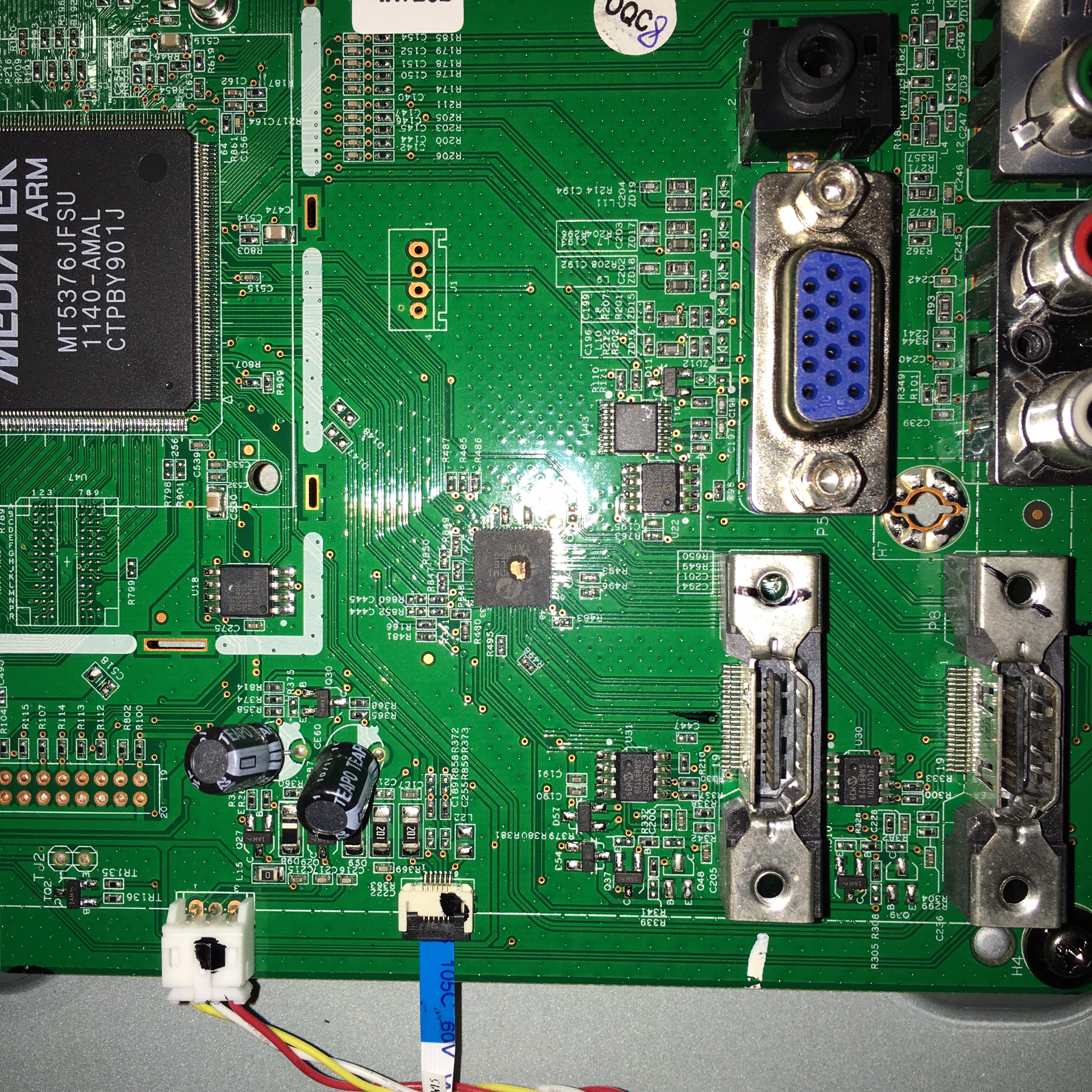

                            So I did some testing with my new meter. F1 is shorted. All of the LDO regulators are 0V at all posts. But worse is U46 appears to have fried.
                              The surge came through the HDMI ports, I bet the cable/Sat box was probably damaged too.
                              You will need a new main board.

                                    Looks like the same thing happened on the 422 except no fuses were blown. Just a chip out of the similar chip next to the had I ports, I do also have voltage at the on off on the power board but everything acts dead
