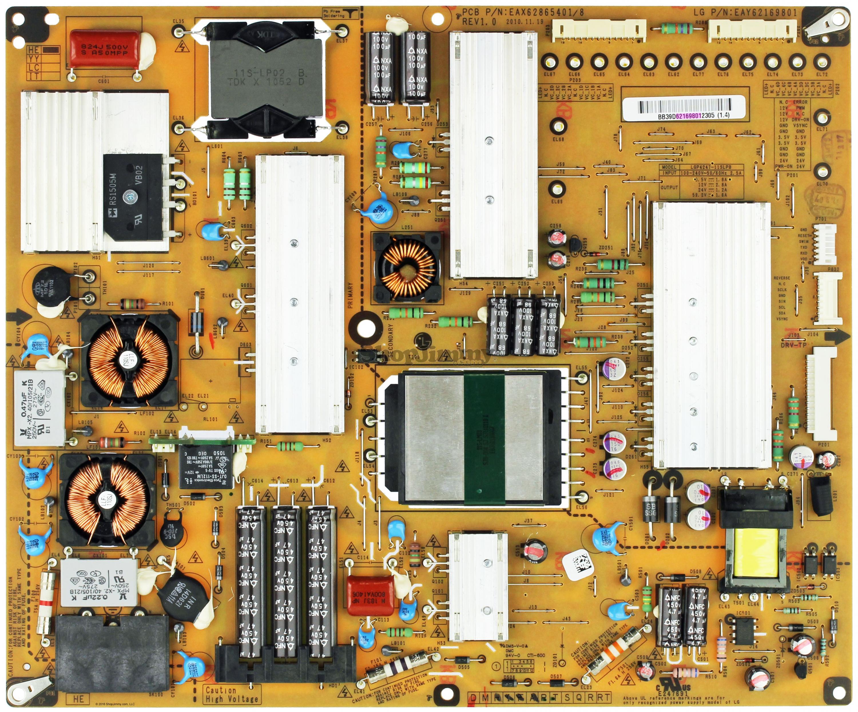

              I'd like to resurrect this thread too. I have the 42LW450U that has not picture. I found out that the MOFSET Q601 is dead. I would like to order two new ones (I'll replace Q602 while I am there).
              I never ordered MOFSETs before.
              What I can read on them is
              18NM60N
              GK2AR V6
              CHN 039
              apparently from ST Micro from the logo.
              Someone could tell me where I can buy this by unit? Thanks... and keep all feeding the badcaps community!

                  BTW, What is the P/N of the IC that the GATE of the failed MOSFET connected too? When that MOSFET went out it could have taken out the Gate driver circuit inside the IC with it so your newly installed MOSFET can be damaged.

                    Thanks Peter... I studied mechanics so my knowledge in electronics is limited. But I want to learn.
                    So my question might be silly but there are 4 different MOFSETs on the link that you provided. How do I know which one is the one I am looking for? Will the 4 of them do the job?

                      Re: LG 42LW450U mainboard MICOM SoC_Reset holding processor in reset?
                      Hi Budm,
                      As mentioned in my previous post, I have a limited knowledge in electronics but I am willing to learn. So thank you both for your help. I will put in pictures of the board so maybe you can tell me if I am wrong.
                      As far as I can see, there is only one IC near the MOFSETs. One of it's branch is going to a strange MOFSET that has only two branches, not three, and this MOFSET seems to feed the triger (middle) branch of the MOFSET.
                      Hopefully my explanations make sense.
                      If that IC needs to be changed, that will be a soldering challenge because it's quite small.
                      I'll post the pictures in a minute.
                      • TLFonderie
                        • Feb 2017
                        • 11
                        • Europe
                        Here are the pictures
                        I put a red square around the faulty MOFSET on the last picture

                              Pictures are low res so I cannot even read the P/N of the PCBA.
                              That section where the MOSFET is si the PFC section.
                              • TLFonderie
                                • Feb 2017
                                • 11
                                • Europe
                                Sorry about the low resolution, the pics have been resized when I added them into my badcaps account. The PCB part numbers are PCB P/N EAX62865401/8 (rev 1.0 2010.11.19) LG P/N EAY62169801
                                Funny enough it has two part numbers...
                                  EAX???? (printed directly on the board) is the PCB (Blank circuit board without parts installed)
                                  EAY??? (on the barcode sticker) is the PCB Assembly which is the PCB stuff with the required parts to make PCB Assembly for particular model, countries, ECT.
                                  http://www.shopjimmy.com/lg-eay62169...upply-unit.htm
                                  LG EAY62169801 (EAX62865401/8) Power Supply.
                                  Pictures provided by shojimmy.
                                  Please see if this is the same as your board.
                                  BTW, those two MOSFETs are for the PFC Voltage booster circuit, they are bascially connected in parallel, the one device with two leg is the diode for the PFC.
                                  The SMD IC close to the MOSFETs is the PFC Controller IC, P/N?
                                  So when you say the MOSFET is dead what exactly do you mean? It has very very low resistance between S and D pin? If it is shorted or has very low resistance the main AC fuse should have blown too.
                                  The more details as what TV/Board not doing the better.

                                    Actually, both EAX??? and EAY??? are printed on board. I have another number on the sticker, which BB2HD62169811056 (1.4)
                                    I also found another part number printed on the card, which is LGP4247-11SLPB
                                    Unfortunately as I am located in Europe, I do not have access to shopjimmy, the access is prohibited for some reason.
                                    Anyway, I detached the MOFSETs and tested them... and I was wrong, both seem to work (tested with my tester on "Diode" mode).
                                    So I plugged the 220V input cable and measured the output lines of the card. The led feeding lines are all at 5.1V. The motherboard feeding line has 3.5V where indicate, but has 0V on the 12V lines (PWM, N.C., DRY-ON) and the 24V lines as well (24V, PWR-ON).
                                    One weird thing is that when I put my multimeter in alternative voltage position and I put only my minus wire on the ground of the card (on one of the screws), I get a 12V reading without having the positive wire touching any component...
                                      Your led voltage (118 vdc) comes from D206, filtered by C212 & C213 and feeds one lead of the led's. The return lines are controlled by the led driver sub board
