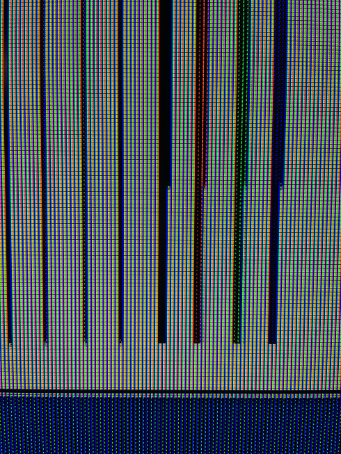

Jim kooks like you have a problem with the right side. Is that picture with the small cable detached? Because I don't see any horizontal lines in the picture showing a defective ribbon tab. You're absolutely sure that there is a panel problem? You tried different t-con boards to no avail before you put this one in and disconnected that driver cable?Hi I have same issue with this 70 inch tv. went ahead and ordered Tcon board replaced it disconnected right side white tab and turned it on. here are the pictures......One thing before I did all this had no picture but did have sound I don't know if its because I had nothing but internet but I had no sound?Did I leave the soldering iron on?Comment

It appears that he disconnected the corner cable as you think, "fearing" that it might have originally taken out the tcon card BUT it appears that the panel isn't in trouble (tab drivers) and that the "unpowered" drivers are now loading down that side.... maybe.Comment

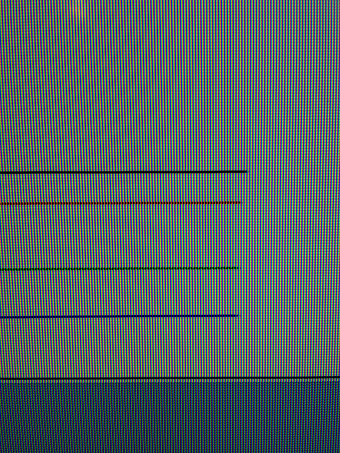

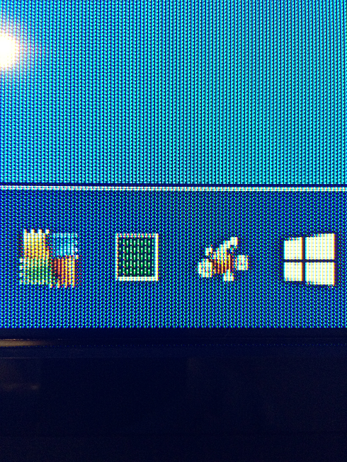

I just got through removing the side tab drivers and replacing the MOSFET on the t-con board for this TV I've had lying around for the last 6 months. I used a 771-2N7002F from Mouser since I had 12 of them in my pile of parts from another project. Seems to be working, but I have some distortion on the lower left quarter of the screen. The left side of the screen had the bad drivers. Also the last picture shows some distortion on the icons in the notification area. Anyone have any idea of what might be going on or is this normal for this TV?Comment
Re: e701i-a3 no picture but backlights
I've turned off all the extra image processing things in the settings and stripped it down as much as possible. The pictures that I posted in the previous post are my results. Looks like ghosting. LCD panels can't have convergence problems can they? Don't want to jump to any conclusions or waste anyone's time with it. Everything seems to be working fine otherwise.

It looks as if you're having a definite vertical distortion problem. First thing I would do is try another input or a source besides a computer. VGA cables are known for having problems with shielding and I have seen distortion issues with those cables before. Can you use some other source like a DVD player or at least turn on the menu and take a picture of that? Is also a slight possibility that you might want to clean the area where you stripped the cables off with some denatured rubbing alcohol and also clean the two ribbon cables going from the tcon board to the panel alsoDid I leave the soldering iron on?Comment
I'm using HDMI and I did switch to a different HDMI port, but I didn't try the VGA output. I think you're probably right about needing to clean the area I removed the cables from.
Those lines in these pictures, the smallest line is 1 pixel wide and the wider line is 2 pixels wide on the end and 3 pixels wide on the rest. The first picture is the bottom left, the next one is the middle on the right side, and the last one is part of the menu. The menu looks pretty normal, but I'll have to look at the other Vizio I had to see how it looks. I'll get a picture tomorrow to compare it. Next thing I'll try is the VGA output.
I do have another mainboard to try in it, but when I had it in it before putting everything back together it seemed like it had a lot of artifacts or something going on with it. The one that's in there right now turns out to be for an E601i-A3. Also I'll take it back apart and clean the cables as you suggested. Thanks for the help. I'll get back with you on what I find.

The third picture of the menu looks normal. I dunno could be just a piece of junk still stuck to the panelDid I leave the soldering iron on?Comment
