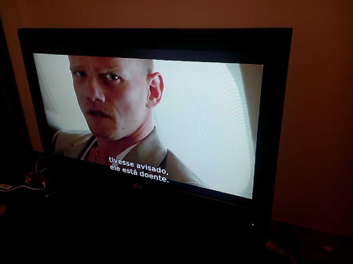

    LG 32LCR - Half screen blurry
    Hello to you all. Im facing this problema at may own lcd. I am suspecting it's an issue on the V320B1-L01. What's your opinion?
    Best regards

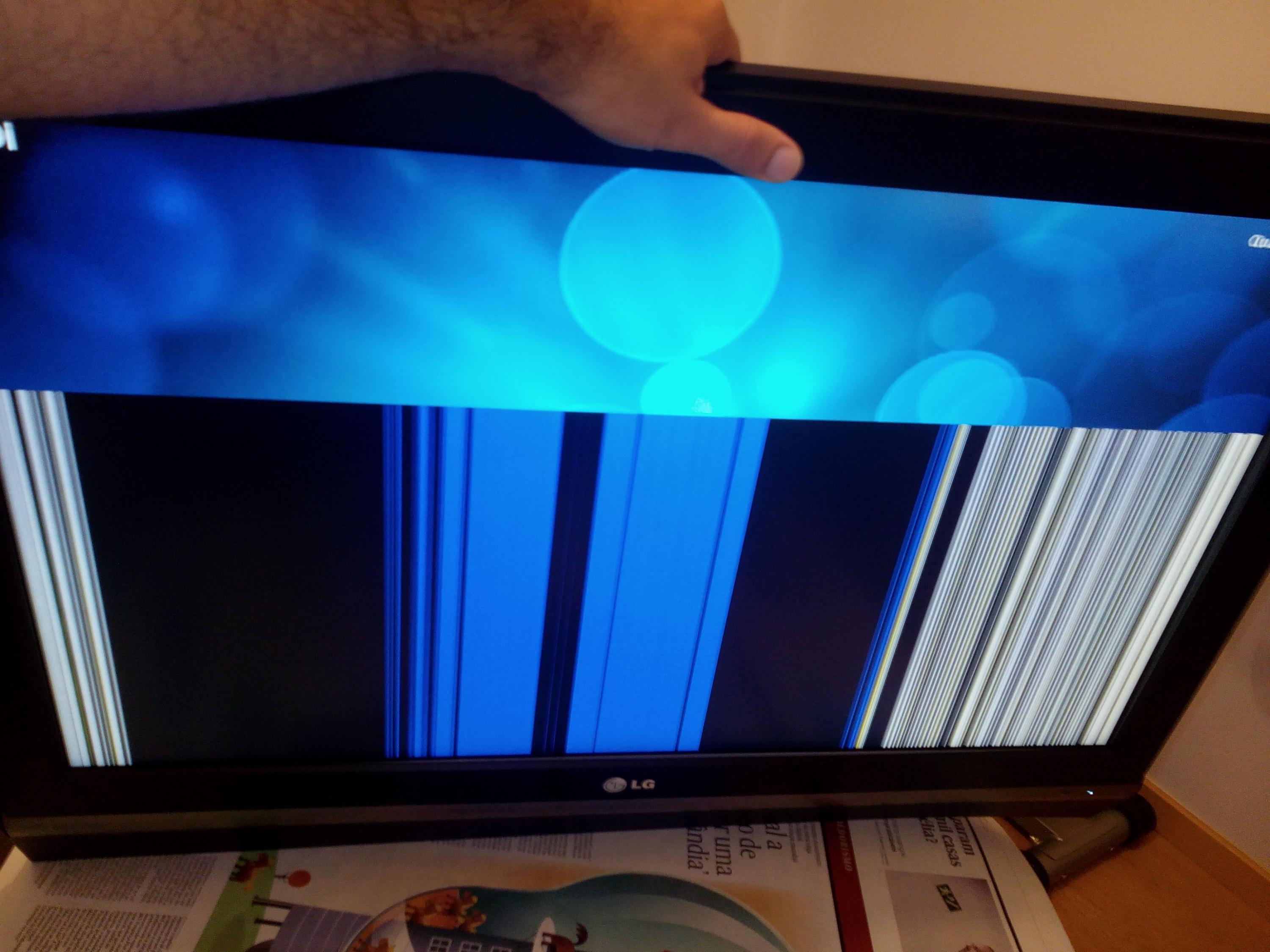

    Re: LG 32LCR - Half screen blurry
    if you remove two top ribbon cables from the top of the left of the screen what shows on the screen then? replace the top two ribbon cables and remove the right two and see whats on the screen.

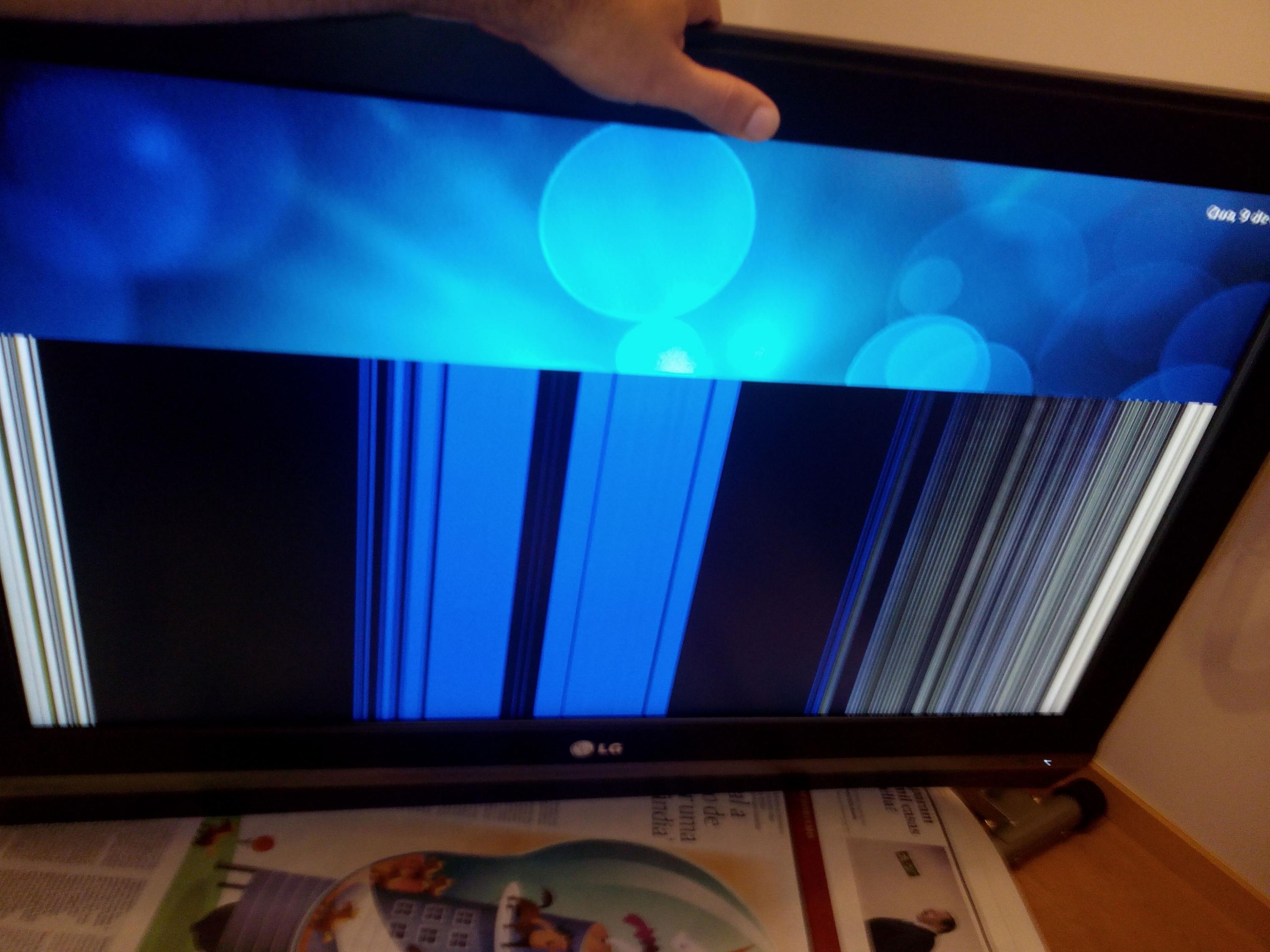

        Re: LG 32LC2R - Half screen blurry
        So I did take the two on the left, and the left side was bright white and on the other side image was ok. Then, I did the opposite, and no image was shown, just a bright screen
        I think I can get some pictures, but this is very dificult to hold, since its toooo heavy
        So, what do you think?
          Bad Tab bond or Tab bond driver, or scrap panel.
            'So I did take the two on the left, and the left side was bright white and on the other side image was ok.' That sounds like bad panel if one half looks OK.

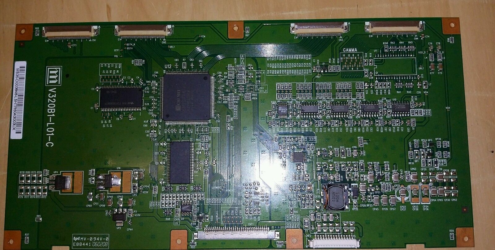

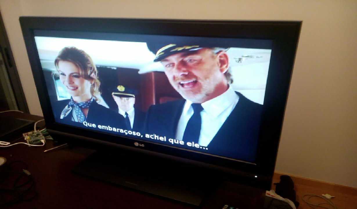

                Dear contributors, against all odds, I did decide to buy and replace TCON BOARD, and guess what!!!!
                That was it!
