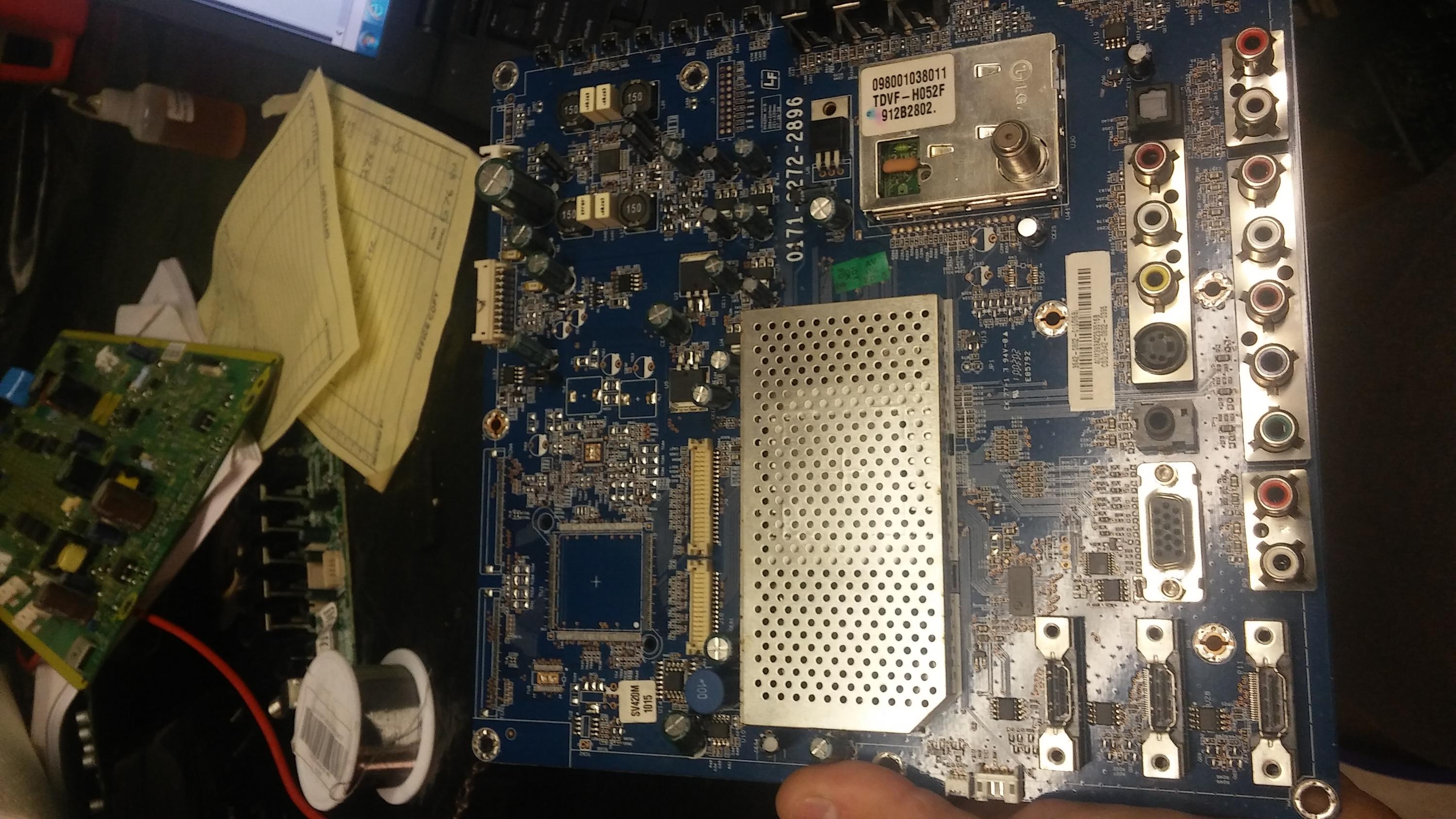

what chip controls hdmi in Vizio 3642-0802-0150 Main Board
  • mattstolte
    • Dec 2013
    • 612
    • usa
    trying to find out what chip controls the hdmi so I can change it, everything else works fine just no hdmi ports

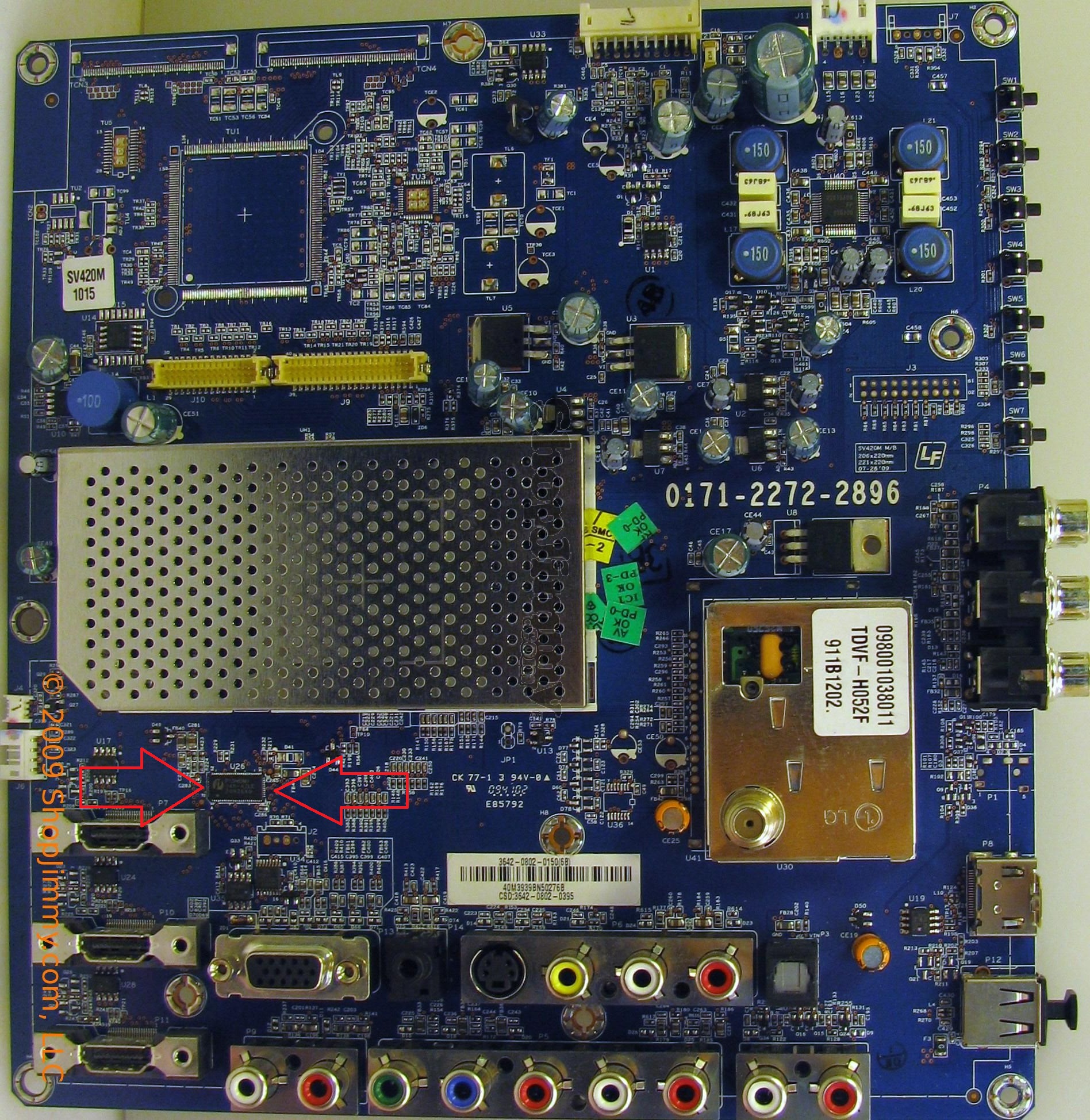

    here is a link to a better picture at shop jimmy
    http://www.shopjimmy.com/vizio-3642-...main-board.htm
    Re: what chip controls hdmi in Vizio 3642-0802-0150 Main Board
    There are 3 8-pin SMD ICs next to each HDMI port, get the P/N and look up the spec sheet.
    There is no pictures of the bottom side of the board to see what are mounted on the bottom side.
      THE 3 SOIC8 IC chip Serial I2 C Bus EEPROM
      U26 ( PI3HDMI245-AZLE) not sure on the part number but check your board
        so all I need to change is u26?
          PI3HDMI245-AZLE: Multiplexer Switch ICs 4:1 HDMI Switch w/High ESD
          http://www.mouser.com/ProductDetail/...uXNKt6sXKxY%3d
                Ok recommendations for best removal and installation of chip PI3HDMI245-AZLE (u26), heat or chip quik?
                • mmartell
                  • Oct 2013
                  • 3189
                  Check the data sheet to see if there is a ground pad under the chip or chipquick will do you no good.
                  I would use heat anyway.
                  • ecking767
                    • Oct 2009
                    • 492
                    Hot air work station and liquid flux, yes there is a metal plate on the bottom of the chip. A little chip quik will help for the pins only.
