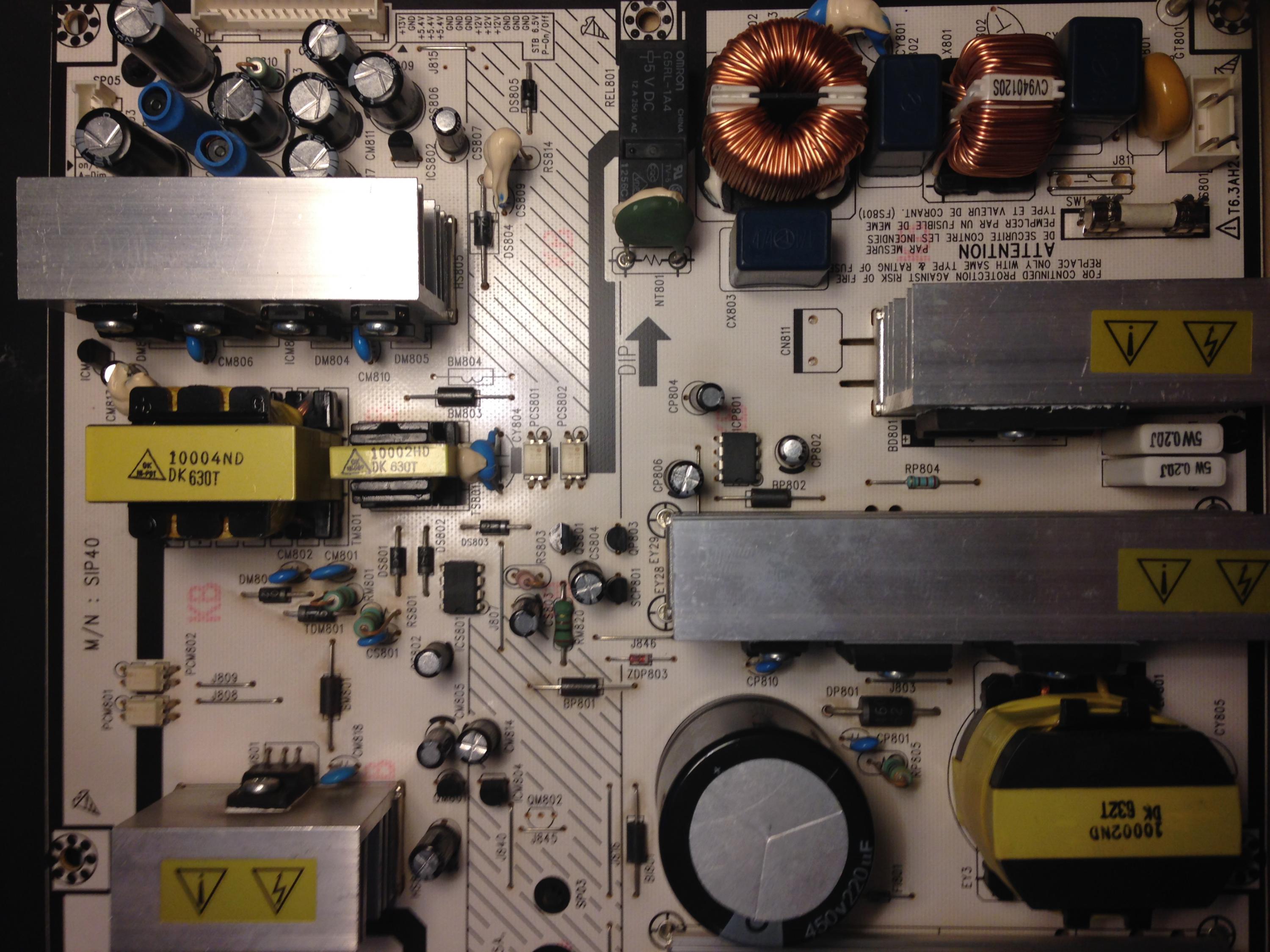

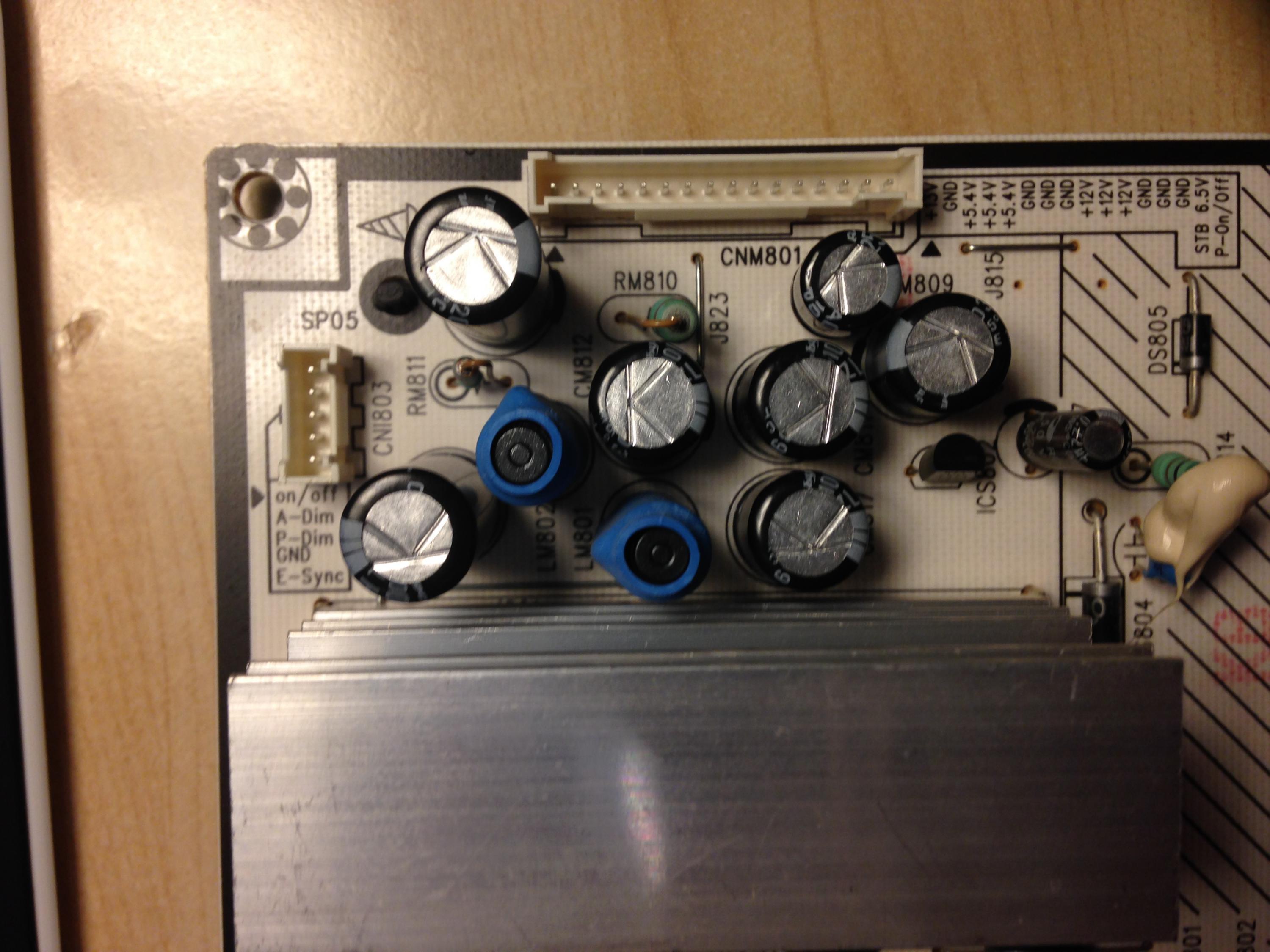

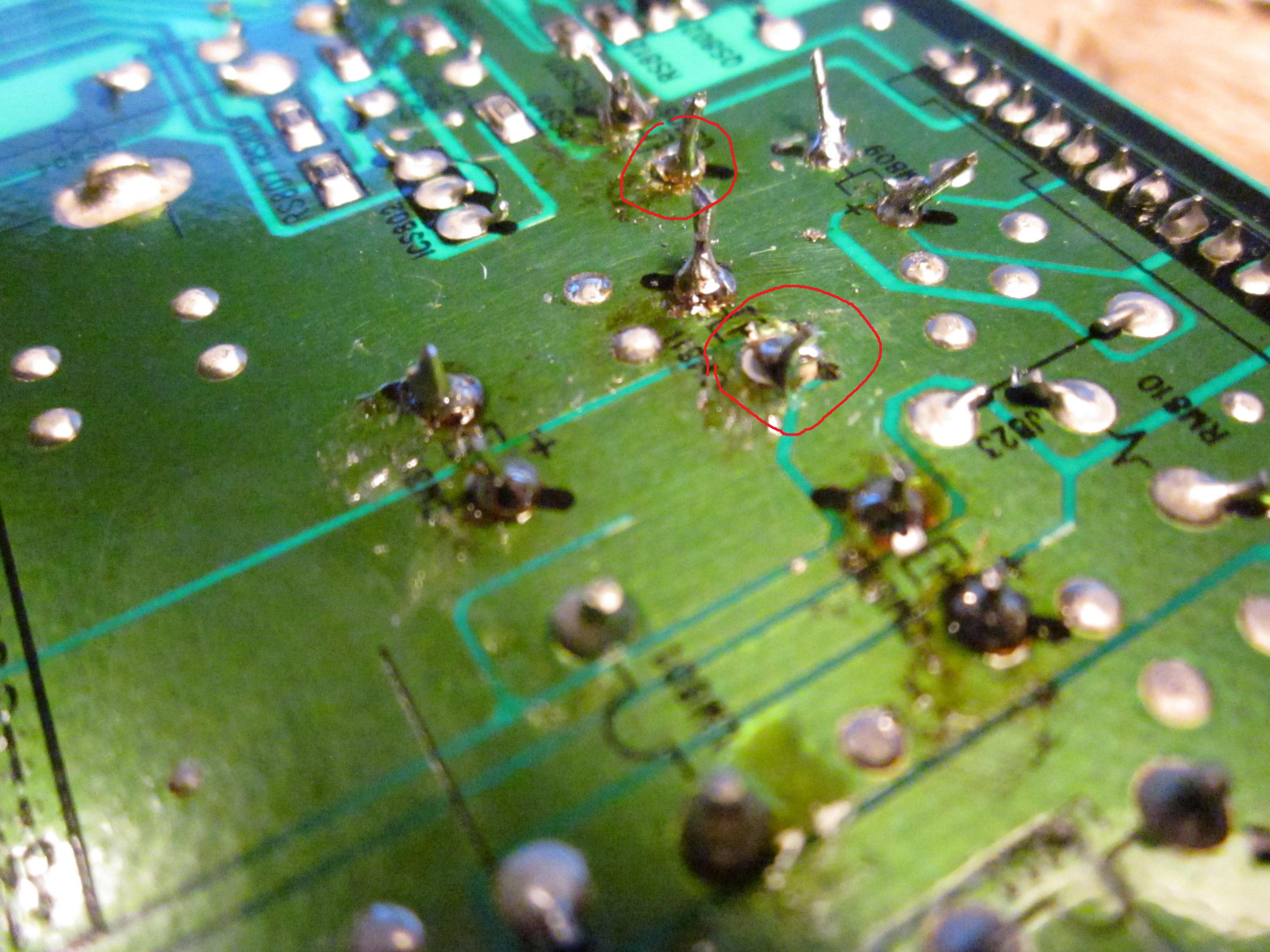

    Hi all, I have replaced the 7 recommended capacitors on the PSU as recommended, but still having the picture go out after the TV runs for a while. It gets pretty warm.
    The picture will not come back on unless I reseat all the connectors on the PSU board. Then once it gets warm, it cuts off again.
    Any ideas?

    Re: Samsung LCD LN-S4051D, replaced caps, same issue
    What mainboard is it ?

      cold solder joint?

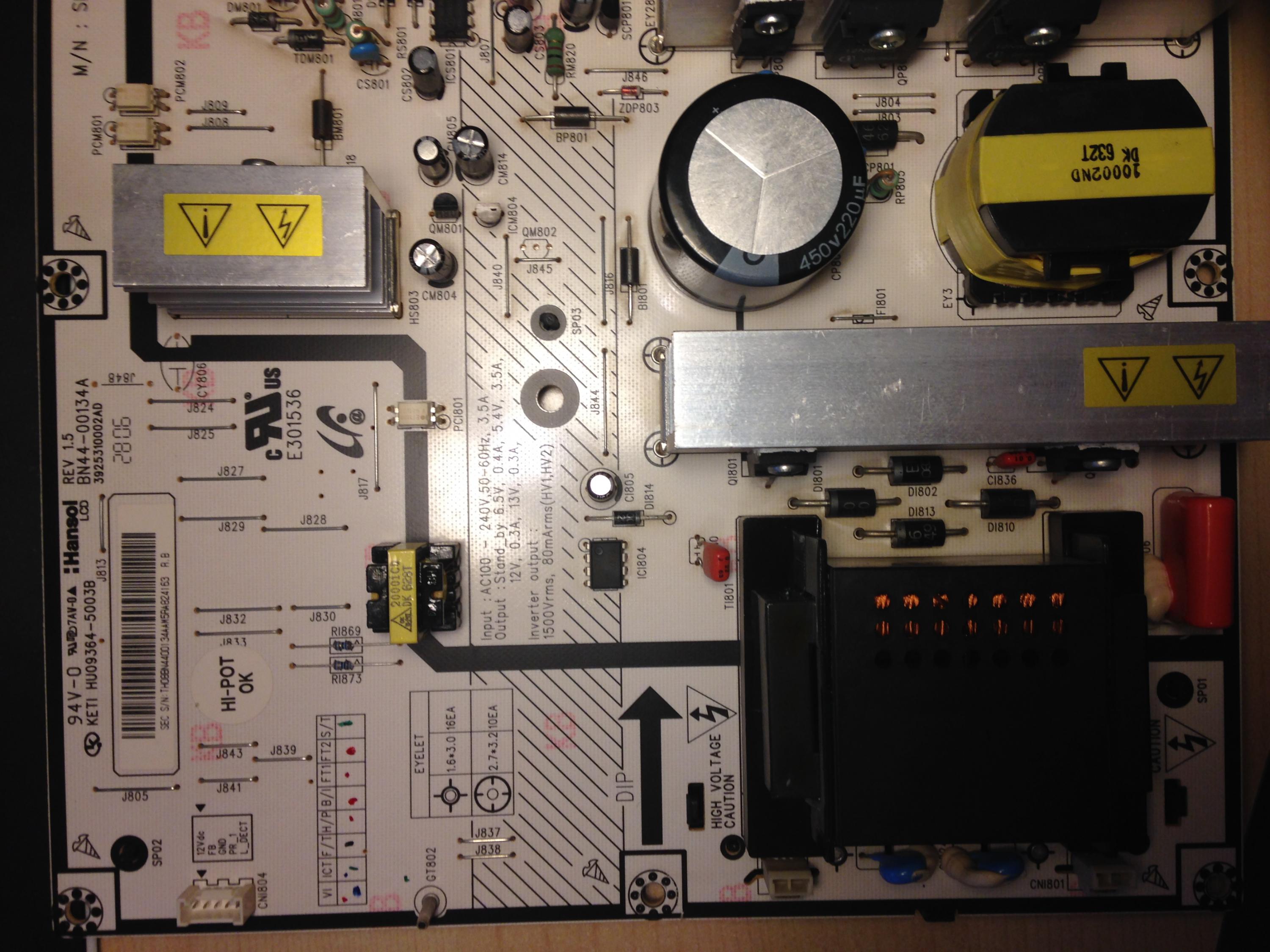

        The main board is a BN41-00679D. 6/26/2006.
        Some of the capacitors had been replaced before as part of the warranty. I think when I unsoldered this time, the solder pad lifted up on 2 of them. Dead in the water?

          pictures?

              Is this your main board?

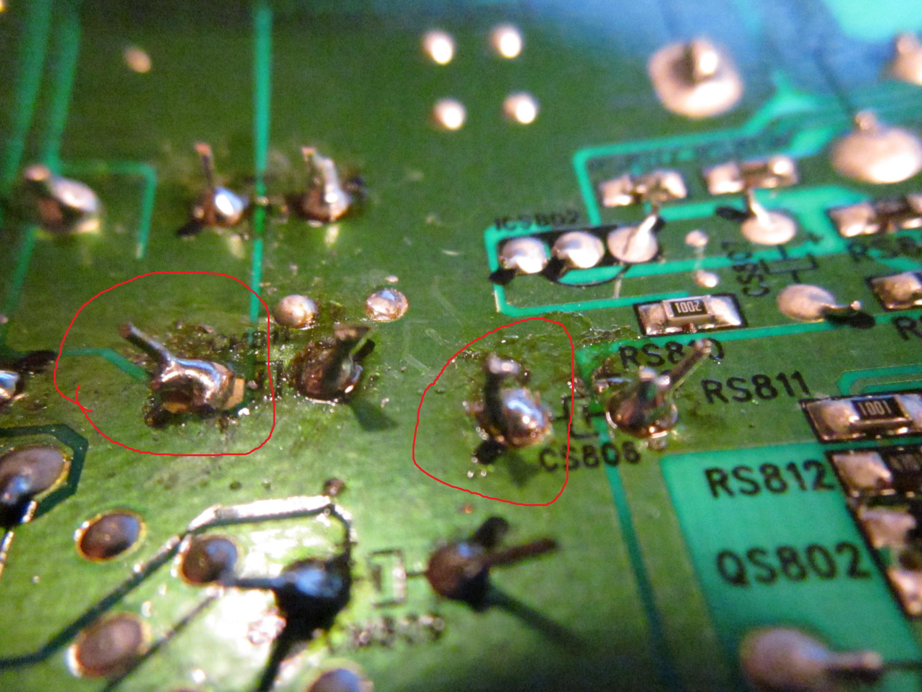

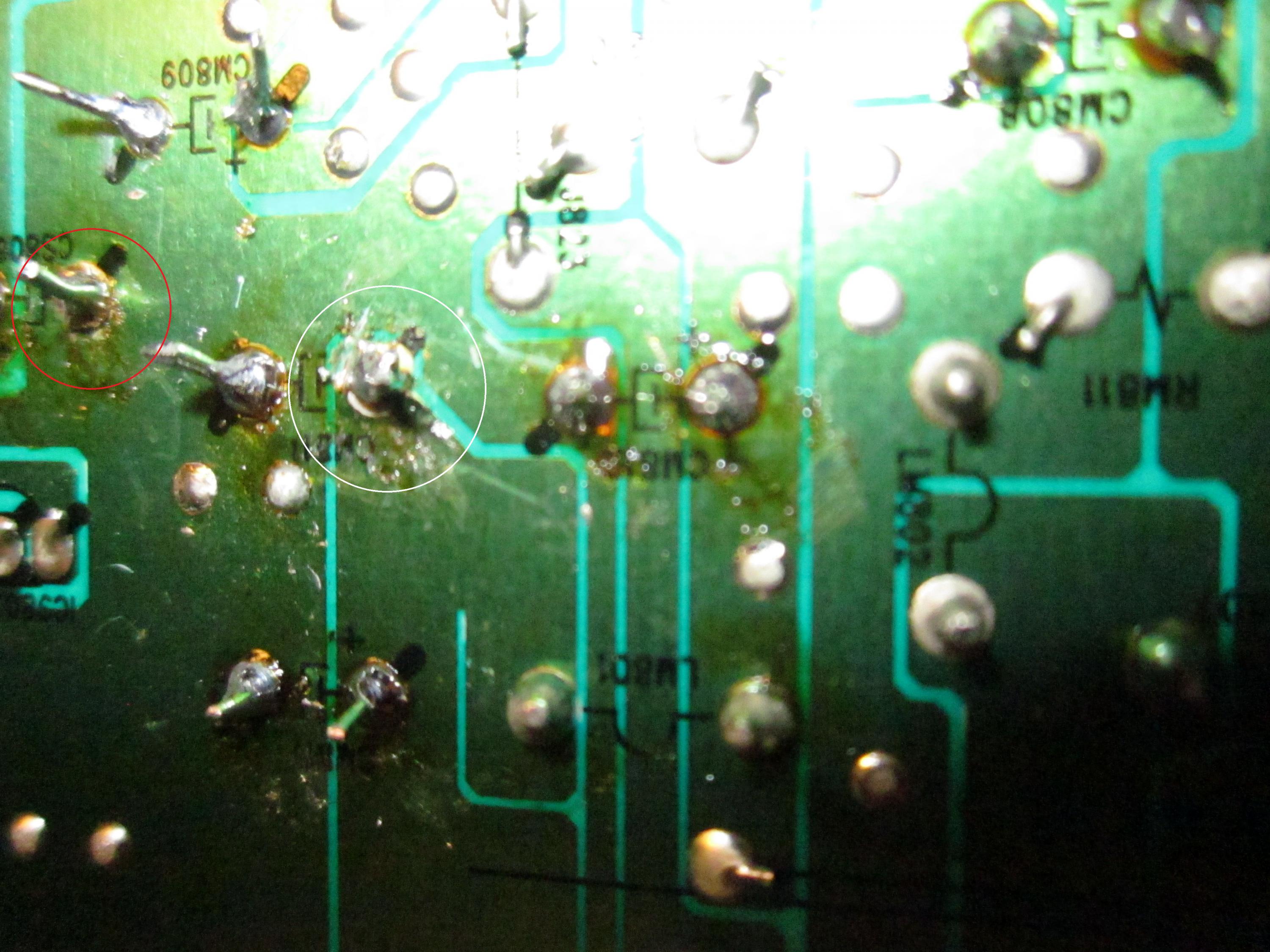

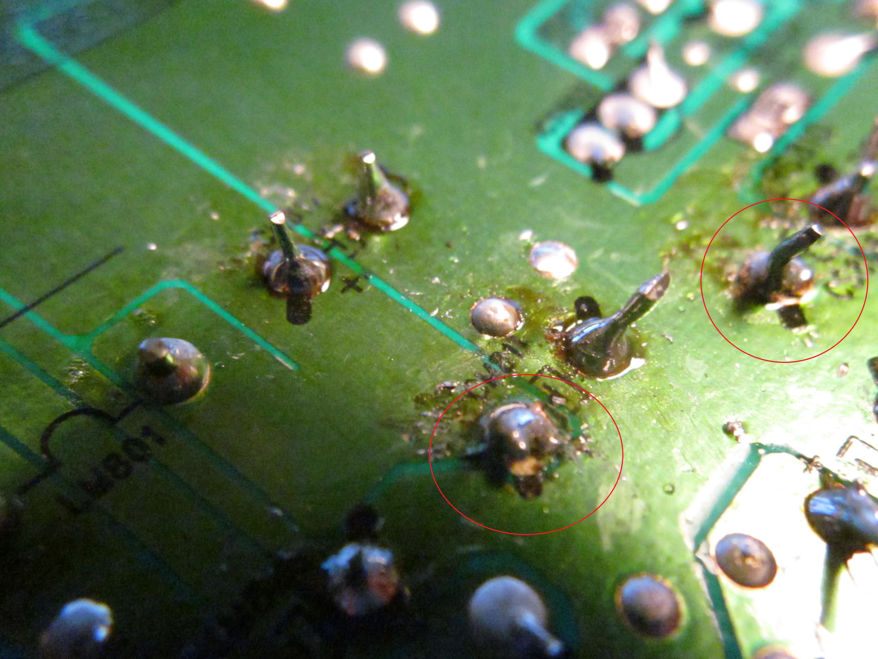

                Hard to get good pics, but here are a few. I obviously need to get better and solder/desoldering, just wonder if this one is toast.
                Originally posted by Terryfictv
                Solder connects on ICM801 regulator
                The solder connects look ok on ICM801

                  Yes, that's it.
                    Ooyyyyyyy! But that can be repaired easily, at least for someone who knows how.
                      Yeah... pfffvt. Welp, any direction? I saw this thread that shows someone exposing the copper, tinning it and using a patch...
                        Yep, you got the idea! You also can use a small piece of wire, to the exposed copper and one turn around the leg of the cap. maybe google something like pcb repair or trace / pad repair... something along that line.
                        What happened to you was / is your soldering iron ran out of heat, it isn't big enough wattage wise.
                            Ok, I will give it a shot. So I was using a desolderer, with the bulb that sucks up the solder. The soldering iron I have is a 15/30w, usually use it on 30.
                                yeah... I figured.
                                I should grab a higher watt iron than my 30 you think? And/or should I avoid using the desolderer?
