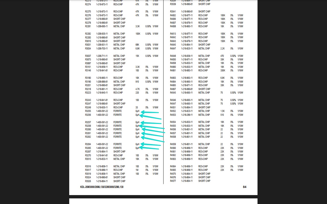

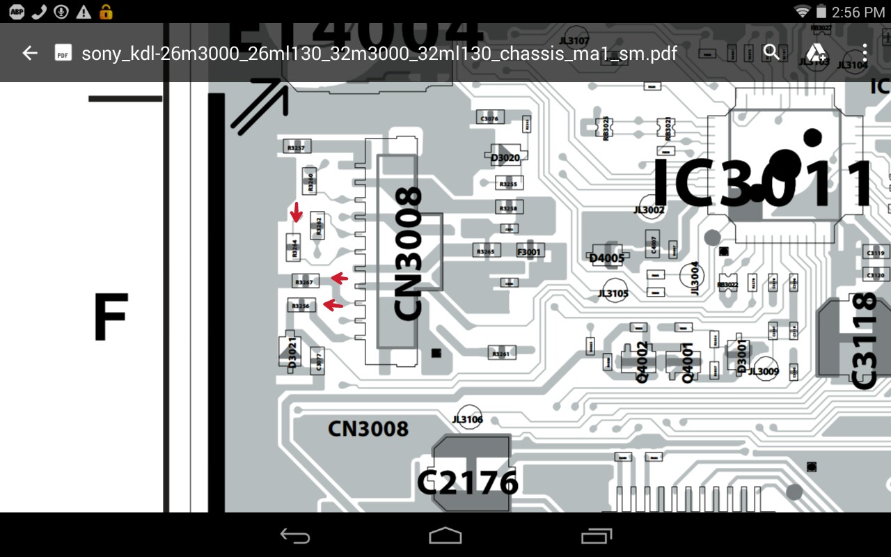

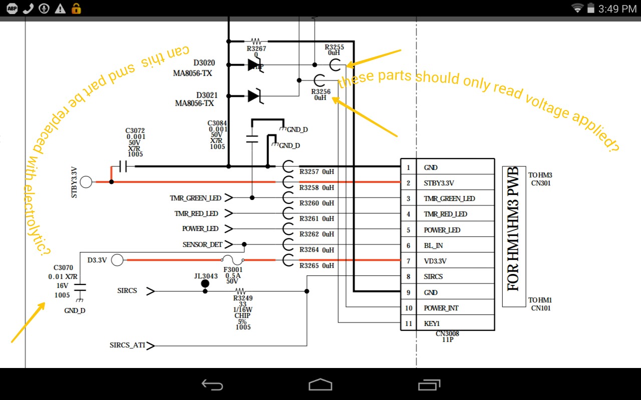

Same problem as before where as I can turn set on and change channels manually but get no action with the remote. The parts list shows what the ratings are for the resistors used arrows point to them also included is a diagram showing where things connect I guess you call it a pinout not sure anyway just wondering if the resistors can be replaced with a simple jumper wire? They're all 0 (micro Henry) as i have been told. Other ideas are needed asap if more images are need I now know how to use this Android tablet so just ask I need help please
Sony bravia kdl26ml130 no remote signals pics this time

Are those two resistors (it is more likely supposed to be ferrite bead small value inductor), as long as it shows as <1 Ohms it is OK. So do they show as open circuit? I doubt that they are bad due to very small current flow through them.
The 0.01uF cap, is it bad? you can use 0.01uF CERAMIC CAP.
How about the diagram for the KEY pads connected to that connector?Last edited by budm; 09-09-2015, 11:39 AM.Never stop learning

The first image on the bottom part of the connector has three connect points for the manual key pad I believe it's ground the power initiate and key 1 pins 9,10,11 about the 0.01 uf it reads 3.3v if I understand right.Are those two resistors (it is more likely supposed to be ferrite bead small value inductor), as long as it shows as <1 Ohms it is OK. So do they show as open circuit? I doubt that they are bad due to very small current flow through them.
How about the diagram for the KEY pads connected to trust connector?Comment

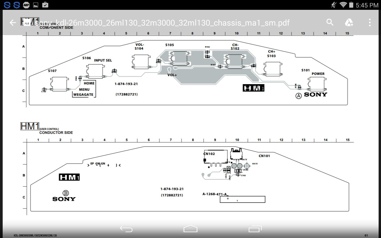

There should be a diagram for the HMI board (control panel).
http://www.shopjimmy.com/sony-a-1268...-hm1-board.htmNever stop learning

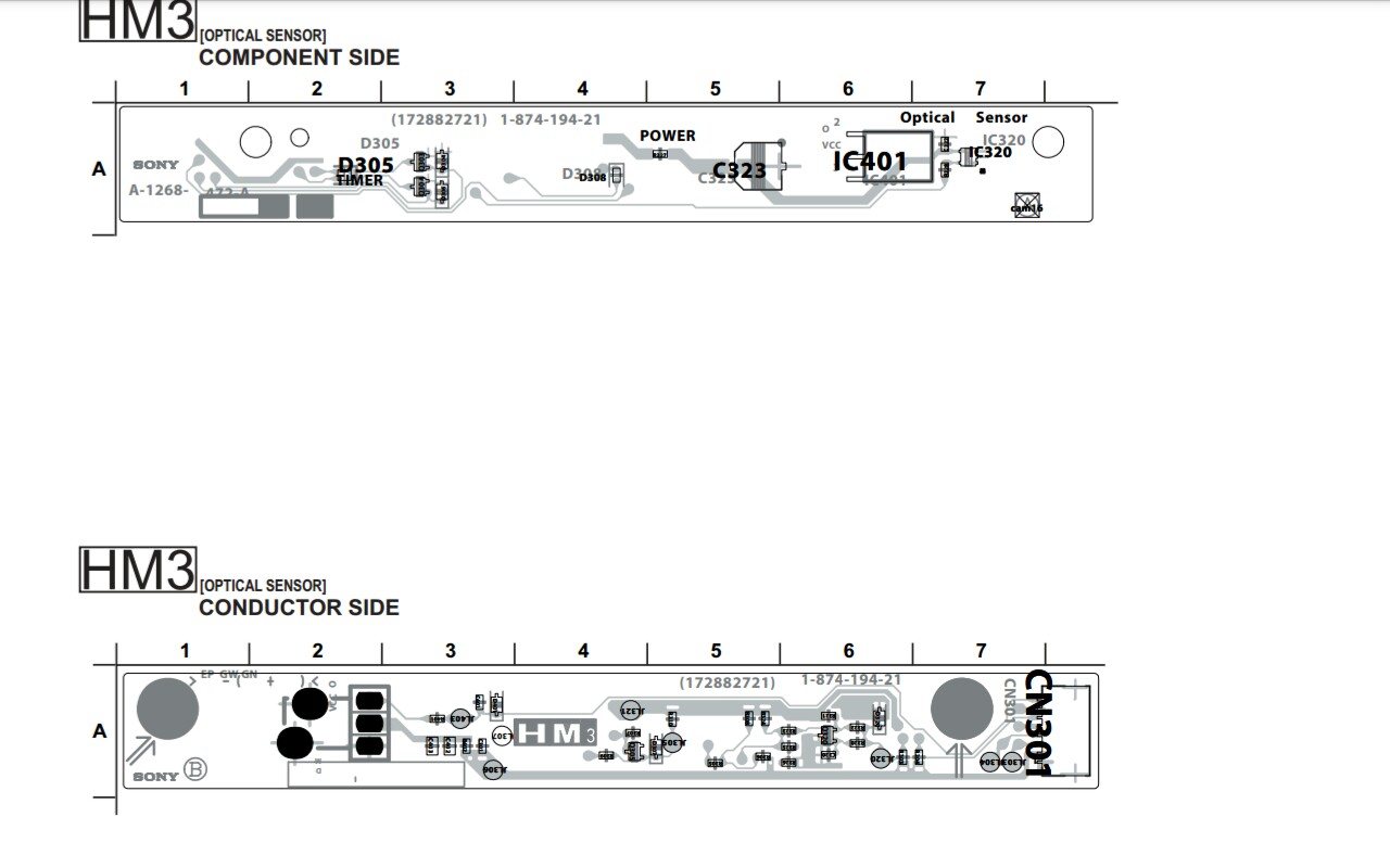

BTW, there is the Remote IR board that you need to check, the HMI board is the button board which you said it function but not the remote function.
http://www.shopjimmy.com/sony-a-1268...-hm3-board.htmLast edited by budm; 09-10-2015, 11:12 AM.Never stop learning

Budm here you go this is all I haveThere should be a diagram for the HMI board (control panel).
http://www.shopjimmy.com/sony-a-1268...-hm1-board.htmAttached Filesif you find these attachements useful please consider making a small donation to the site
Re: Sony bravia kdl26ml130 no remote signals pics this time
OK thanks, please report the DCV reading of all 8 pins of the HM3 IR board.Never stop learning

Looking at the conductor side CN301 from upper to lower of connector
-3.3
-0.13
-0.13
-3.3
-0.00
-0.00
-3.3
-0.00

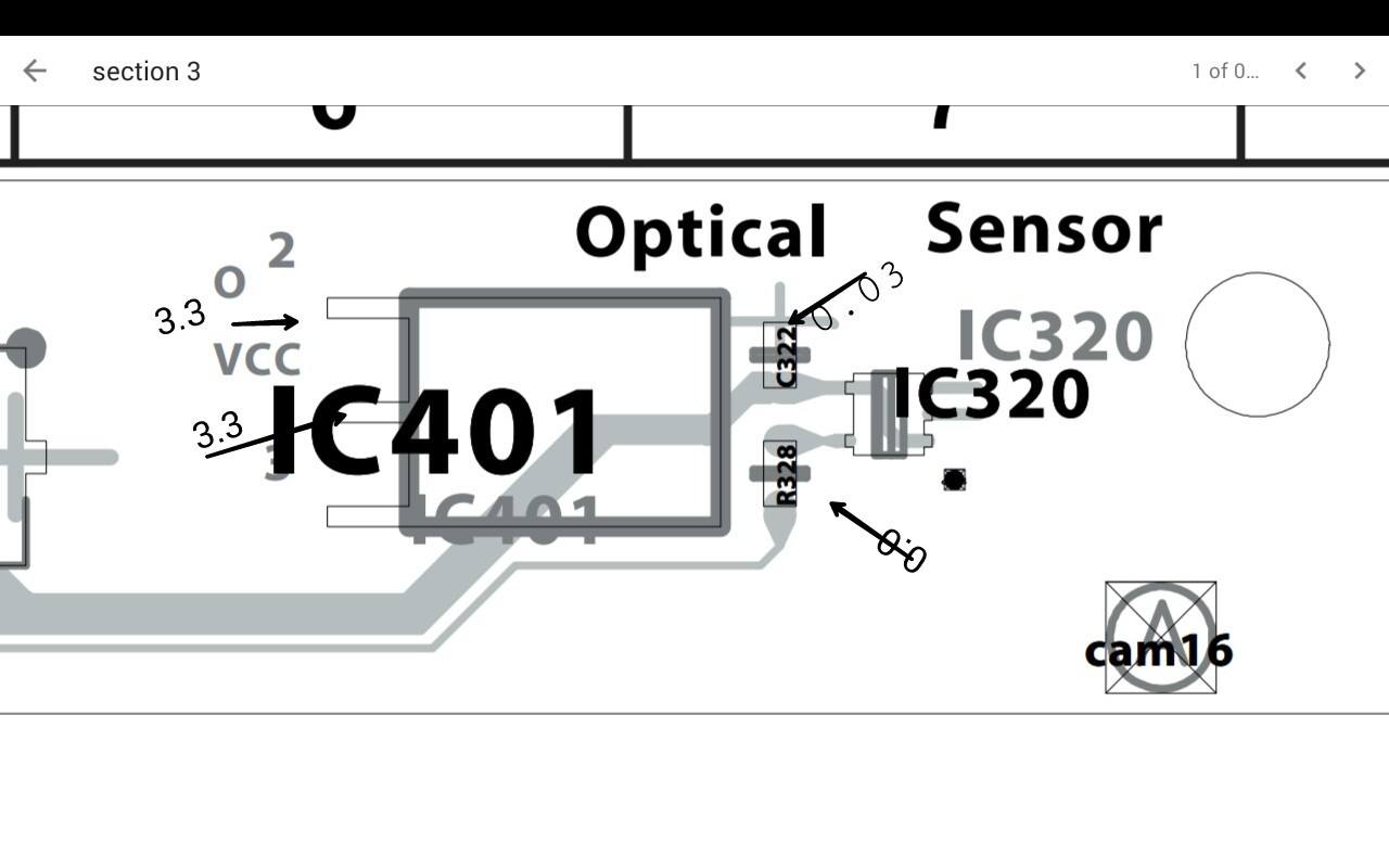

On the conductor side I get 0.00 at C320 and i'm thinking it should read the 3.3 ?Last edited by manstoblame; 09-12-2015, 01:58 PM.Comment

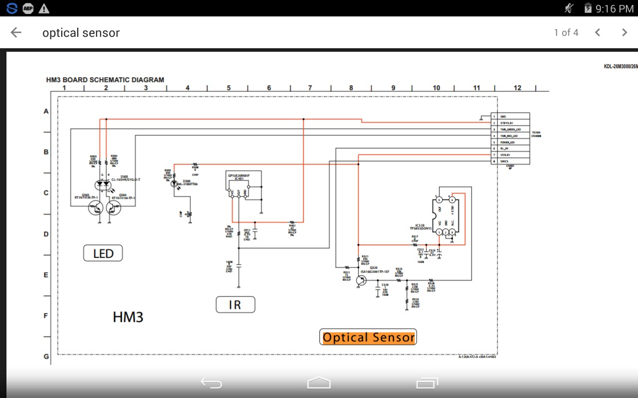

I try enlarging the image to see where this cap C320 is. Is that the cap in the OPTICAL SENSOR section where it is connected to the Q320? That section has nothing to do with the remote function. The OPTICAL SEMSOR is for automatic adjustment of the backlights in relationship to the ambient room lights.
The remote function is int he IR section, IC401 is the IR sensor that receives the signal from the remote control. It should have 3.3vdc at the VCC pin of that IR receiver. The output signal that goes to the main board is on pin 8.Never stop learning

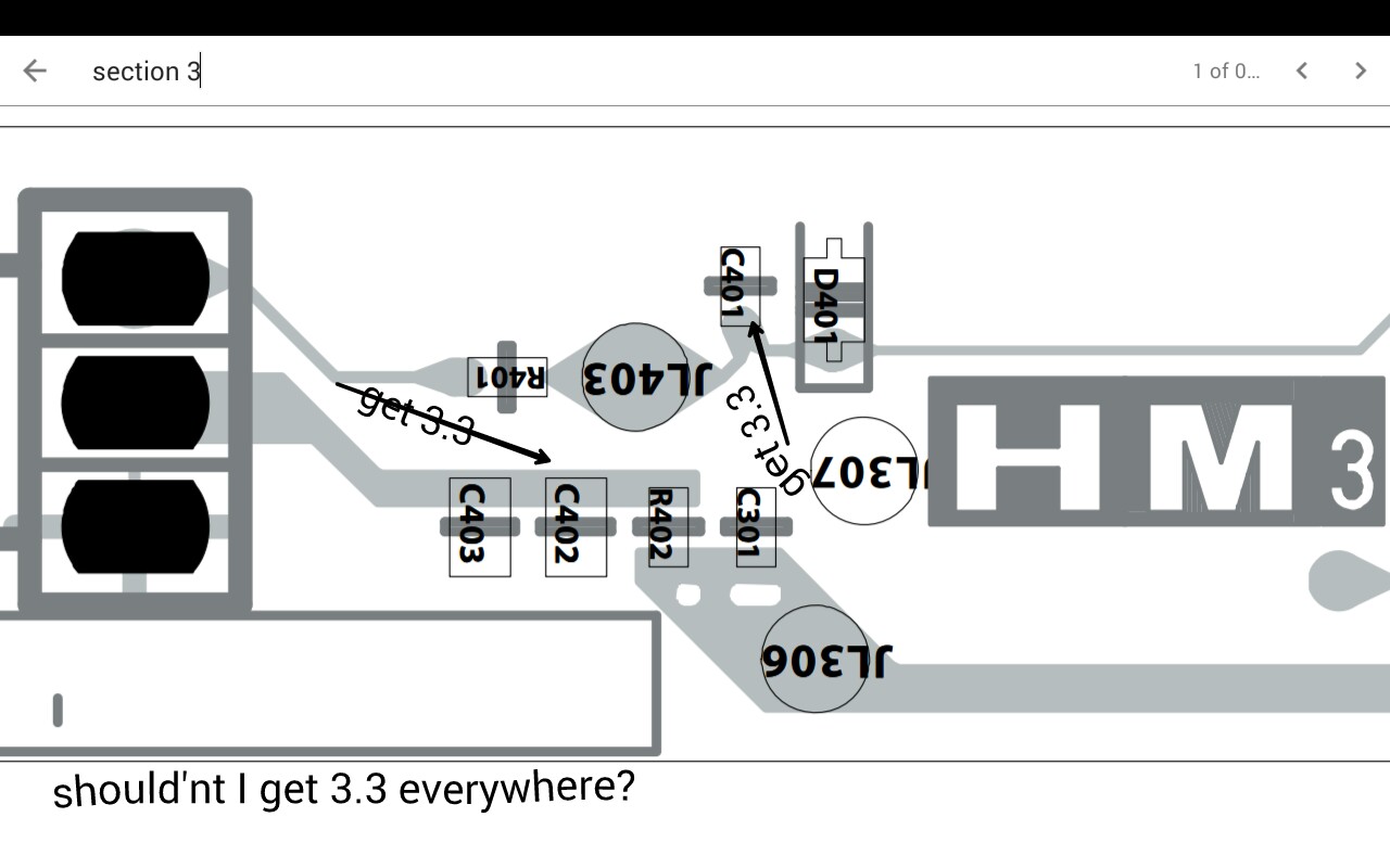

if you have a oscilloscope, you can hook up the probe to the out put pin of the IR or on Pin 8 of the connector and check for pulses to see if it receives IR. On the conductor side of the HM3 board, IC 401 is mounted on the other side on the left (see your picture), the middle pin, there are 2 chip caps, see if they are shorted to GND or not.Comment

tested those and they measured 3.3 note that all caps and beads are not being used on this particular set just the ones I inquire about others are for different models so as not to confuse anyone my fault for not mentioning it earlierif you have a oscilloscope, you can hook up the probe to the out put pin of the IR or on Pin 8 of the connector and check for pulses to see if it receives IR. On the conductor side of the HM3 board, IC 401 is mounted on the other side on the left (see your picture), the middle pin, there are 2 chip caps, see if they are shorted to GND or not.Attached Filesif you find these attachements useful please consider making a small donation to the site
