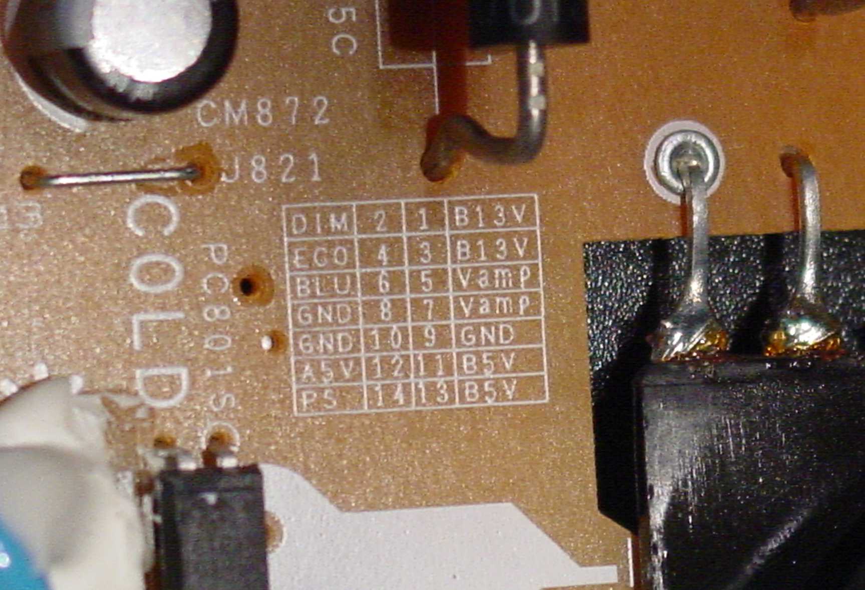

    I picked this 32" LCD up and all it will do is flash the red light 5 times and nothing else. Occasionally, I will hear a chirp or click through the speaker - but that's only happened a few times. The caps look good and I've tested most (but only on the board). I've measured the voltages. Note pin #4 starts at about 2.5 but very slowly starts sinking.
    pin - label - reading
    1 B13V 12.86
    2 DIM 4.71
    3 B13v 12.86
    4 ECO 2.5
    5 Vamp 12.86
    6 BLU 4.71
    7 Vamp 12.86
    8 GND -.3
    9 GND -.3
    10 GND -.4
    11 B5V 5.25
    12 A5V 5.25
    13 B5V 5.24
    14 PS 3.28
    Any help would be appreciated!

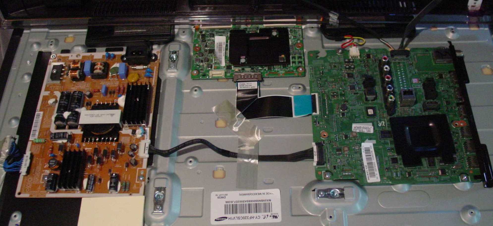

    PSU Bd is good. I believe you do have a Main Bd problem. Although I'm a bit unsure of that Pin 6-BLU voltage.
    Performed POWER BD 'self test' as follows:
    1. Disconnect CNL802-jack to Back Light Unit.
    2. Disconnect CNM803-jack to Main BD.
    2. Connect a 1kOhm resistor across Pin 12-A5Vdc and Pin 14-PS
    3. Connect another 1kOhm resistor across Pin 12-A5Vdc and Pin 6-BLU.
    4. Re-install PSU BD with ALL screws in place
    (Be careful not to short circuit any connections to each other and to chassis GND).
    5. Re-connect CNL802-jack to Back Light Unit.
    6. Apply 120Vac.
    If PSU is working Back Lights will come ON and remain ON.

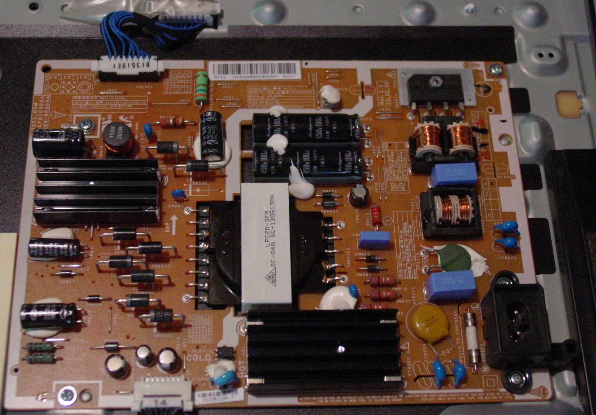

                  The board is BN44-00606A. I will start checking the voltages. Capleaker - sorry, I should have stated what the back-light was doing.

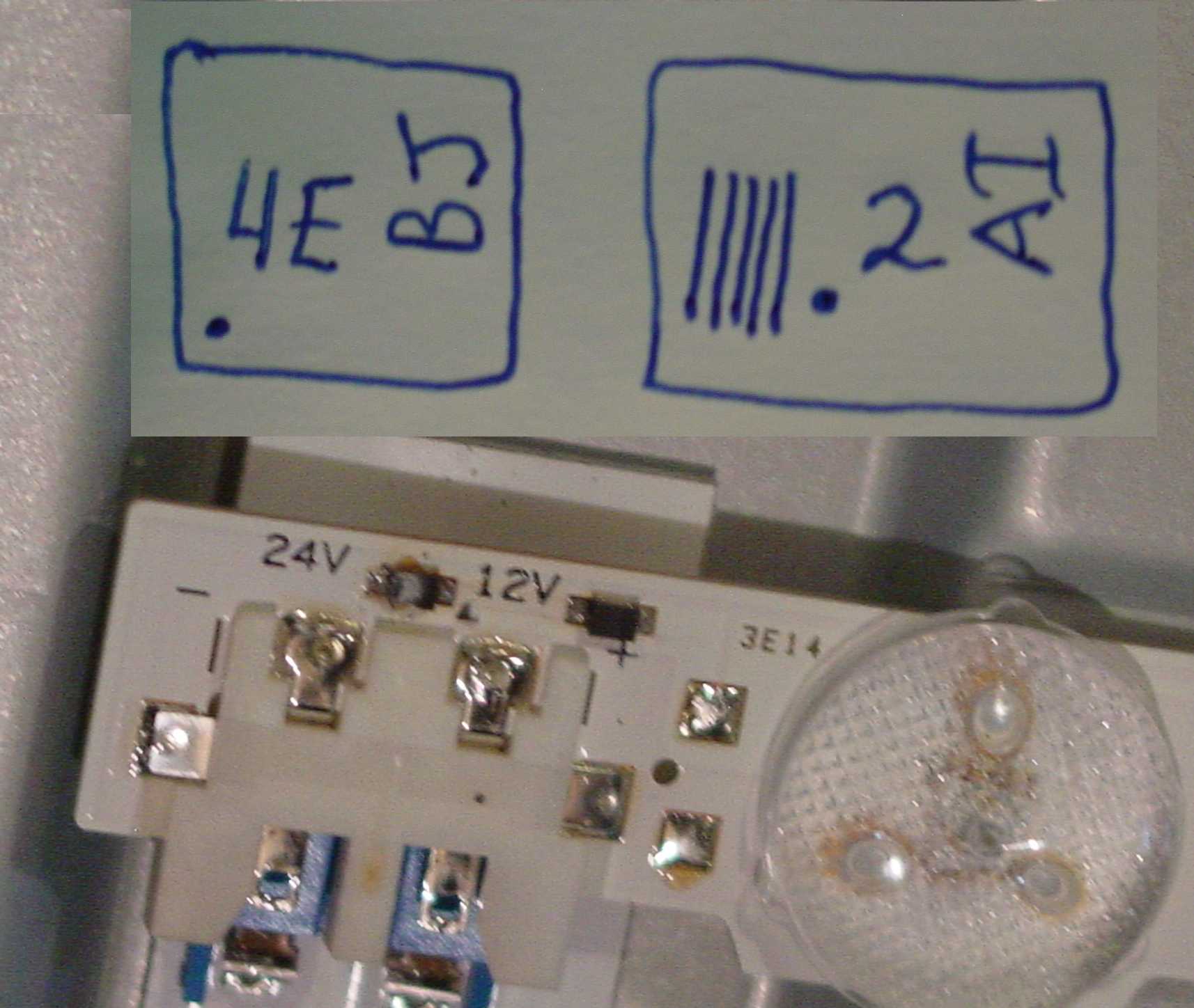

                        Bingo! I took the LCD off to expose the LED strips (fairly easy to do). Tested each LED individually and they all worked. I noticed one of the smd components looked a little strange and with a big magnifying glass, realized one was burnt nearly in two. A few of the others looked a little toasted. Can you tell me what these are? The left one is marked "4E BJ" and the right, "2 AI". Photo attached.
                          Re: Samsung UN32F6300AFXZA black screen red flashing lights
                          Does each LED strip have those two components? Are they connected in series with the LED, if they are, then they may be Diode or resistor.
                          • Davegerg
                            • Aug 2012
                            • 62

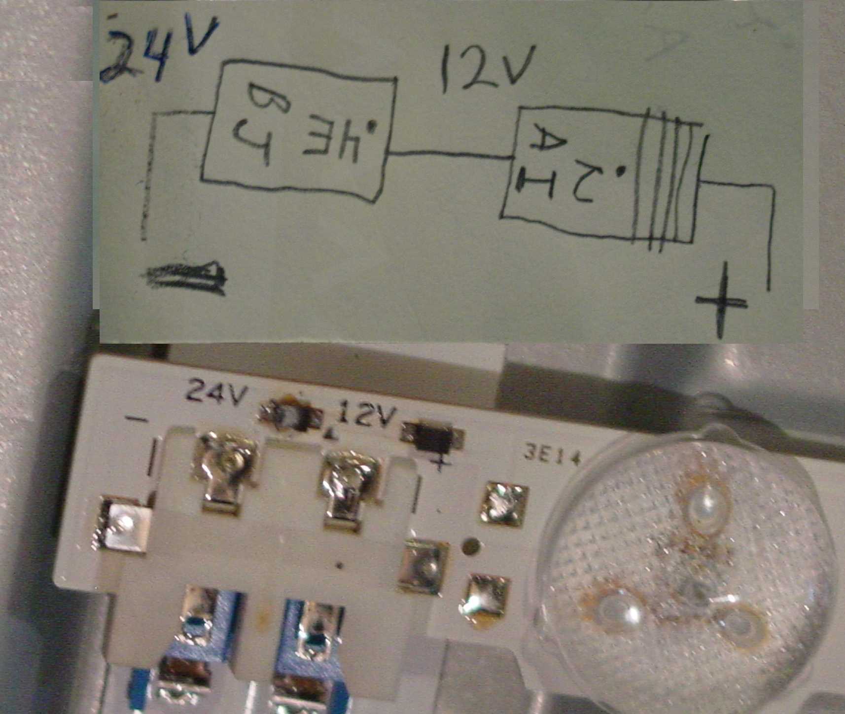

                            Yes, each of the five strips look identical. These components do appear in series. I reoriented the diagram so this is the way they appear on the strip. Note the bars on the right one - like the bar on a diode, maybe? Thanks.
                            • Davegerg
                              • Aug 2012
                              • 62
                              My updated diagram didn't get loaded. Here it is.

                                Try a resistance check across the good one and then try a diode check

                                  I've been doing some testing and gotten some odd results. Also got a 24v power supply and tested all five strips - four work and the one pictured does not. The SMDs on the four good strips test as caps in the 40-70pf range. On the bad strip, the "2 AI" chip tests as a diode! I'm going to dig up two caps and put them on the bad strip - later tonight.
                                    You need to find out how the two legs of those two devices are connected in relationship to the LEDs. The LEDs on each strip are connected in series. Then you have two contact points on each strip, one will be positive. one will be negative, so I would trace out the connection from the positive terminal to see if it is connected to the ANODE of that unknown Diode or not or if it is connected the the ANODE of the first LED.
                                    Open capacitor will not cause the LED strip not to light up, open Diode (if it is connected the LEDs in the string) can cause the LED strip not to light up.
                                    BTW, it is not a good idea to connect the power source directly to the LEDS without having current limiter.
                                    • Davegerg
                                      • Aug 2012
                                      • 62
                                      Budm, I think I read your last post way too late!
                                      Those two devices are connected just like that diagram in my photo. The neg contact point goes to "4E BJ", which is connected to "2 AI", which goes to the pos contact. So, they're not in series with the LEDs. I replaced both of those devices with caps (the smd's on the other four strips all read as caps - the fifth strip had one burned smd and the other read as a diode). Anyway, I hooked up my 24v PS and it worked. THEN, things started going south. I left the power on for about 6-8 seconds and the LEDs started flashing. I turned it off real quick and now one LED is dead. The PS I used is 24VDC and 5A. I always thought a device would just use as much amperage as it needed. I'm wrong, aren't I?
                                        "The PS I used is 24VDC and 5A. I always thought a device would just use as much amperage as it needed. I'm wrong, aren't I? " Yes.
