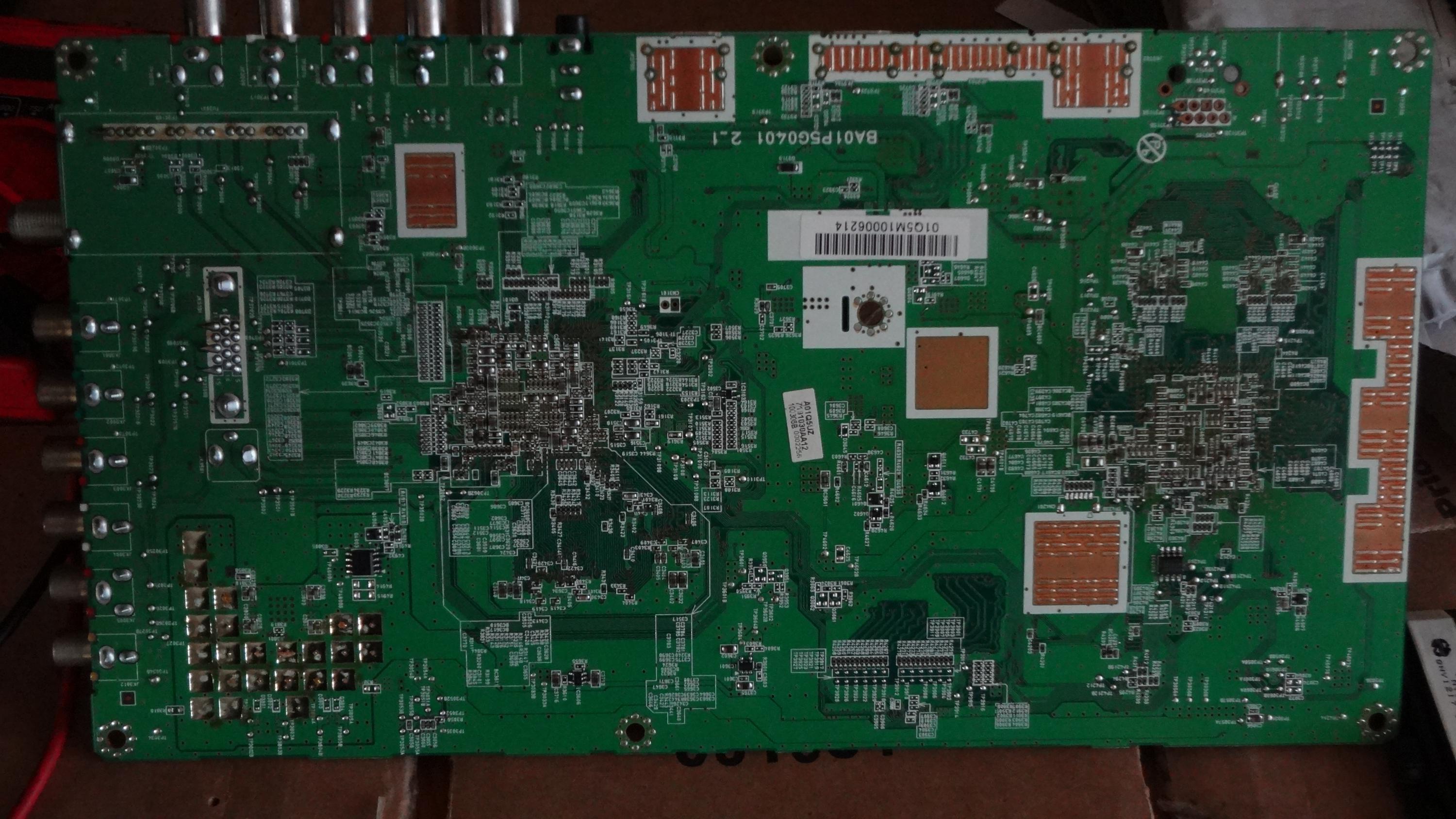

                                Here are front and back shots for the time being. As soon as the DSLR is done charging I'll get some Hi-Res pics of the front and back.

                                  Re: Philips 46pfl5505d/f7
                                  Yeah... unfortunately I can't read it. Too small
                                  On pic 1 the lower left corner, that should be the plug for the PSU. Can you make another pic of that section?
                                  Also with pin is the BLon pin on there?

                                    #77
                                    Here are some pics of the front side with DSLR camera.
                                    I think the images are being re-scaled after I upload them. The original files are 4MB and now under 1MB after uploading. Hope it doesn't affect legibility.

                                      #78
                                      Back side of main board
                                        BLsw is Pin 1 of CN3002

                                          #80
                                          Got another idea for you to test. Put the boards back into the TV everything as it supposed to be... no forcing things on the PSU. Heat up the main board with a hair dryer. Don't overheat it though... then turn on the tv. See what it does.
                                          If you didn't get any results, try cooling specific regions the main board (can of duster air upside down) and see if you can find something that way.
                                          I partially traced the BLon pin, but I lost it... (reminds me I should get a bigger screen here).
