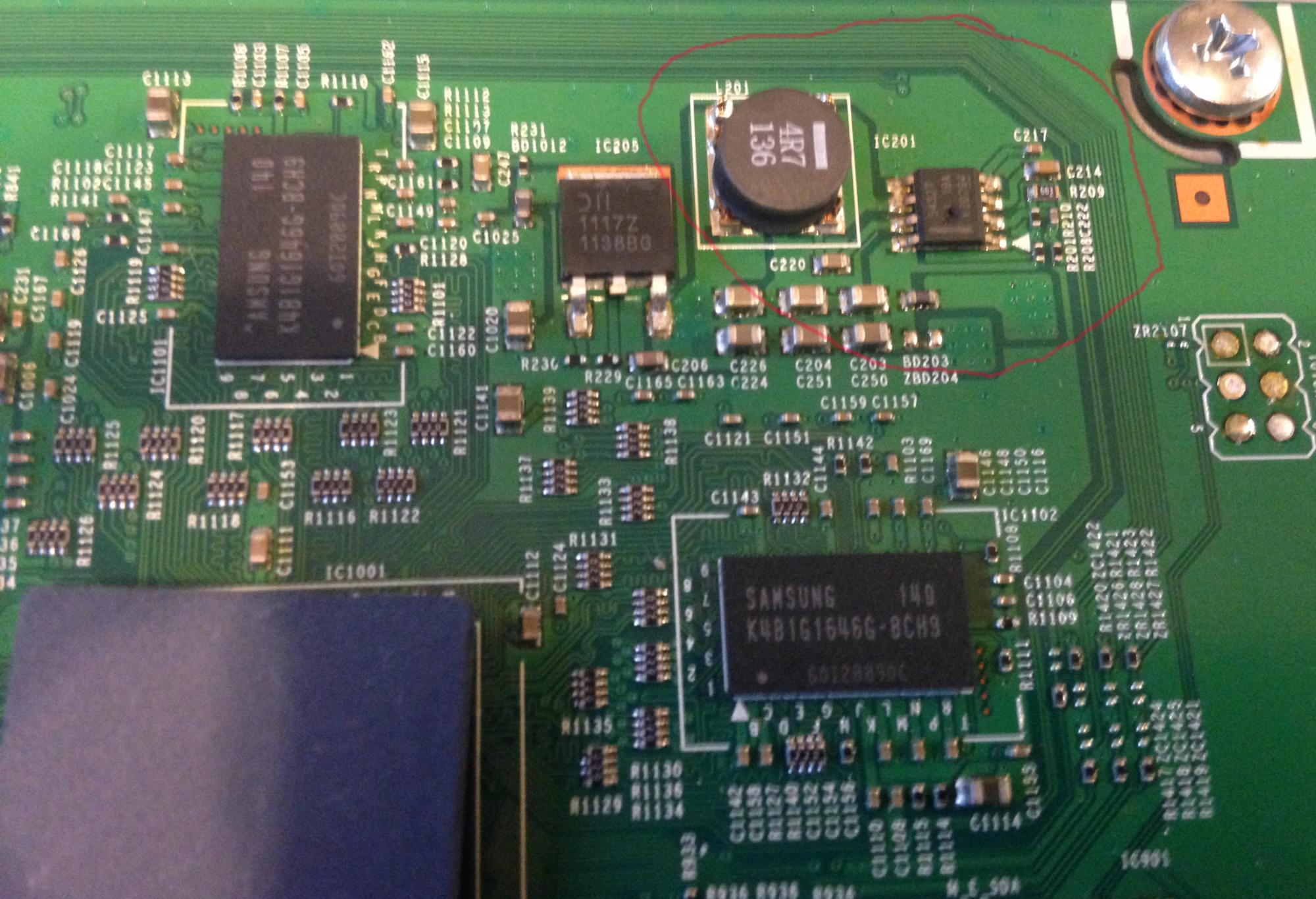

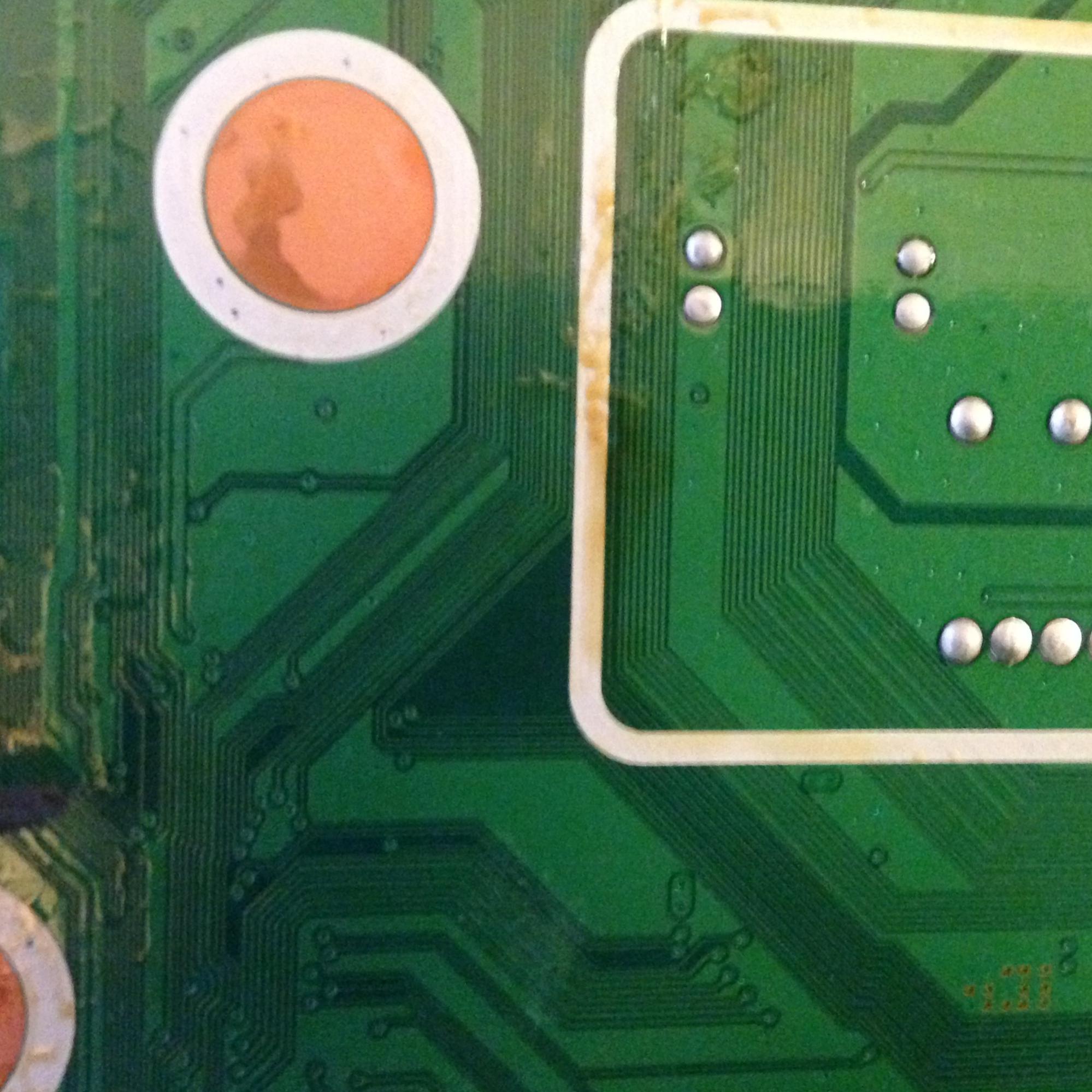

                          Re: Samsung LN37D567F9HXZA wont power on red flashing light
                          Well I think I found part of the issue ic201 has a hole in it.
                          there is also some discolouration on the back of the main board.
                          down by the ant plug may or may not be related. so it at least needs a main board or some skill to repair anyone having issue should take pictures then zoom it in that is how I found this. shopjimmy doesnt have the board in stock and it goes back to the fact that this is a hotel tv. So even fixed there is the whole trying to get it to work as a normal tv. any advice I am all ears.

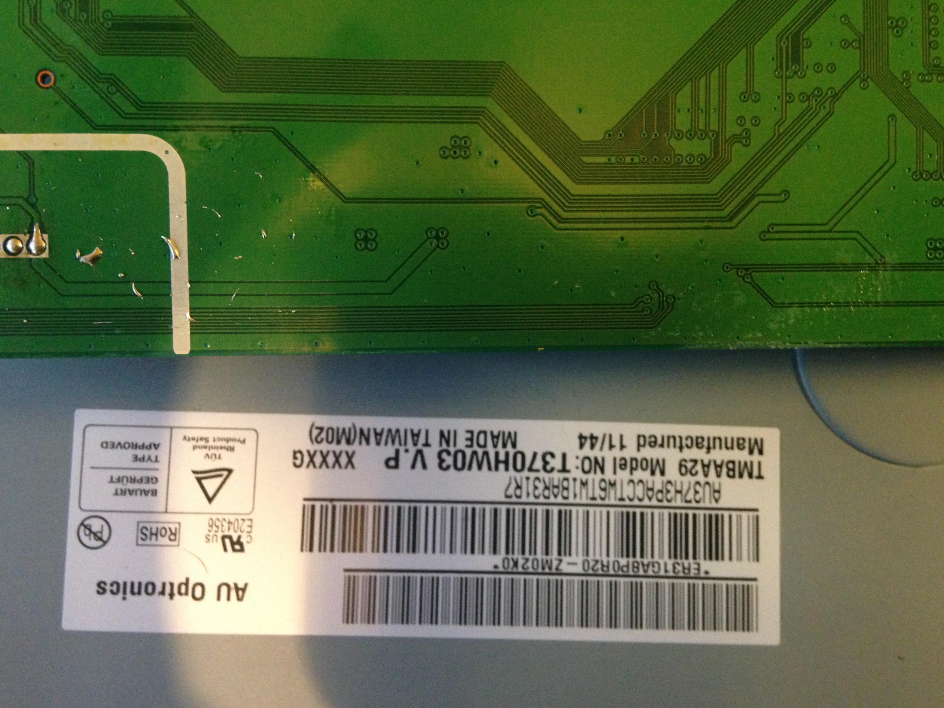

                            here is the back of the board.
                            the lcd panel is T370HW03 V.P
                            will have to see what can be used for a main - t-con - power supply
                              That is switching power supply IC, the output of that circuit feeds the input of the Adjustable LVDO IC205 (1117 series). So the IC may have just failed or the load is shorted so it took out the IC.
                                  Well at this point you will need to get the P/N as printed on top of that IC to get the data sheet and the pin out so you can do some resistance testing and also need to locate the new IC.
                                  • crushkittykitty
                                    • Sep 2015
                                    • 41
                                    • usa
                                    54327
                                    TI 19A
                                    P2D264
                                    is ic201 on this board
                                    I take it we are going to try and fix. going to pull everything off the power supply and test it again .
                                    Do these reprogram themselves or is it going to have to be programmed?

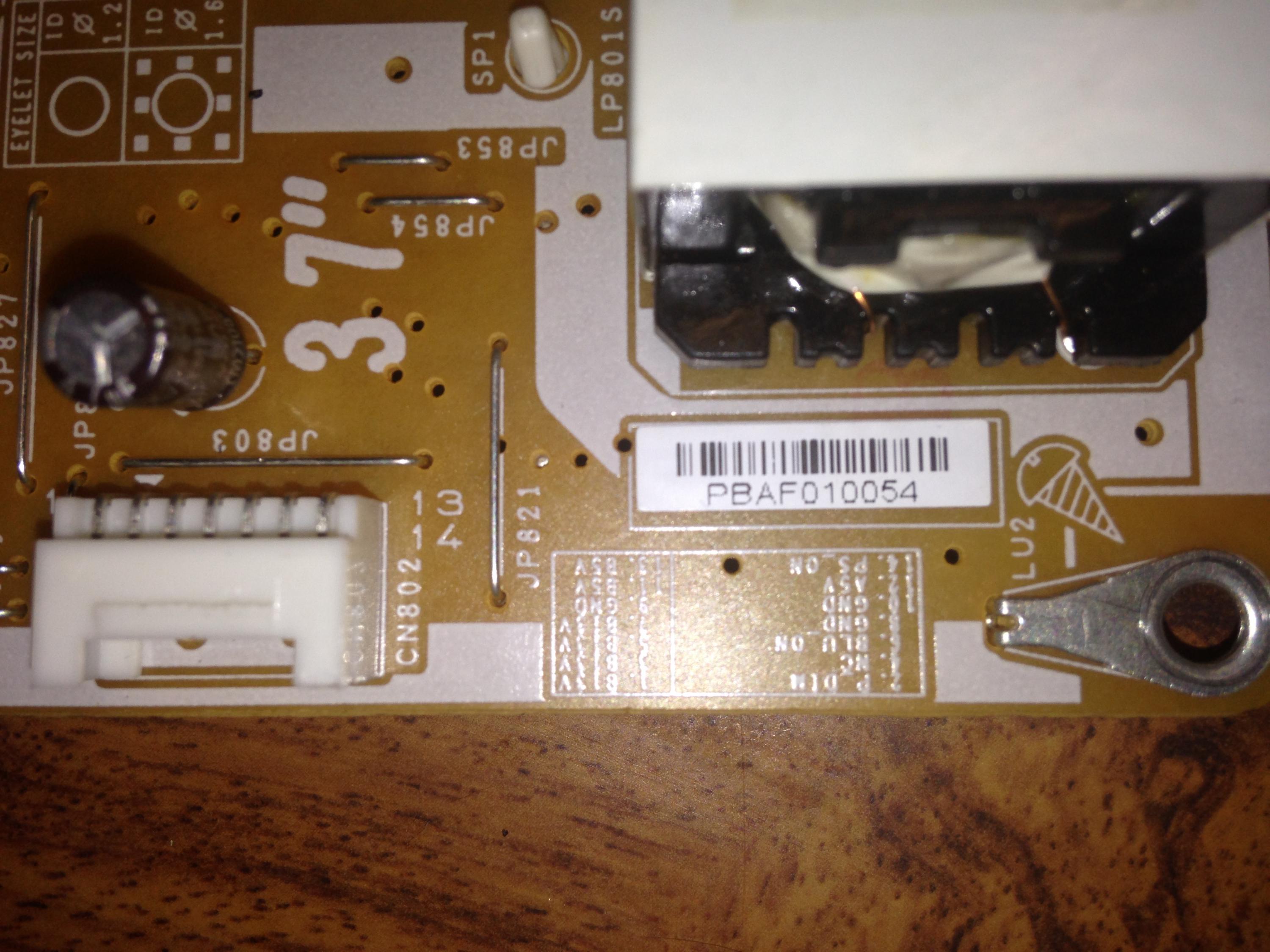

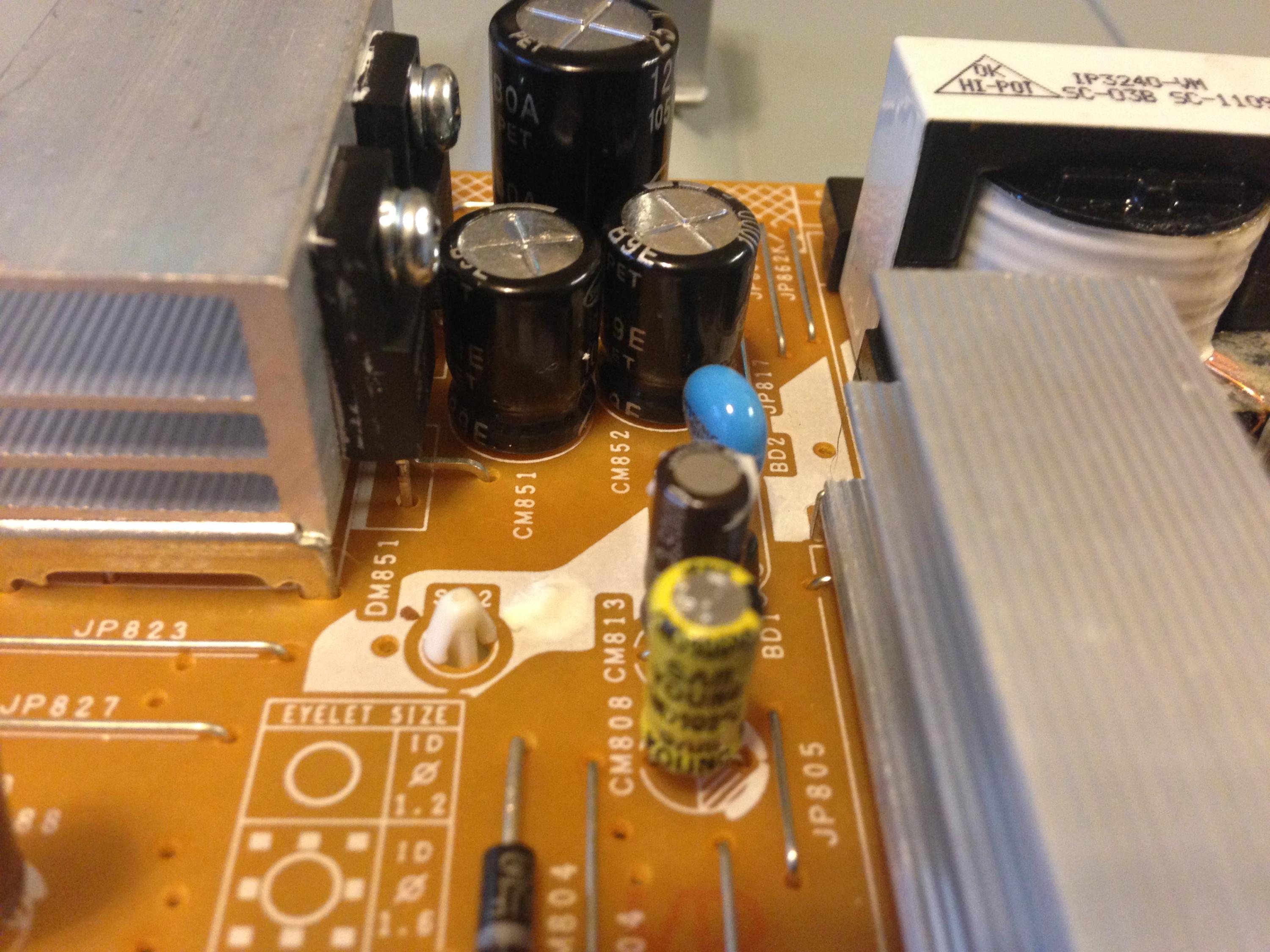

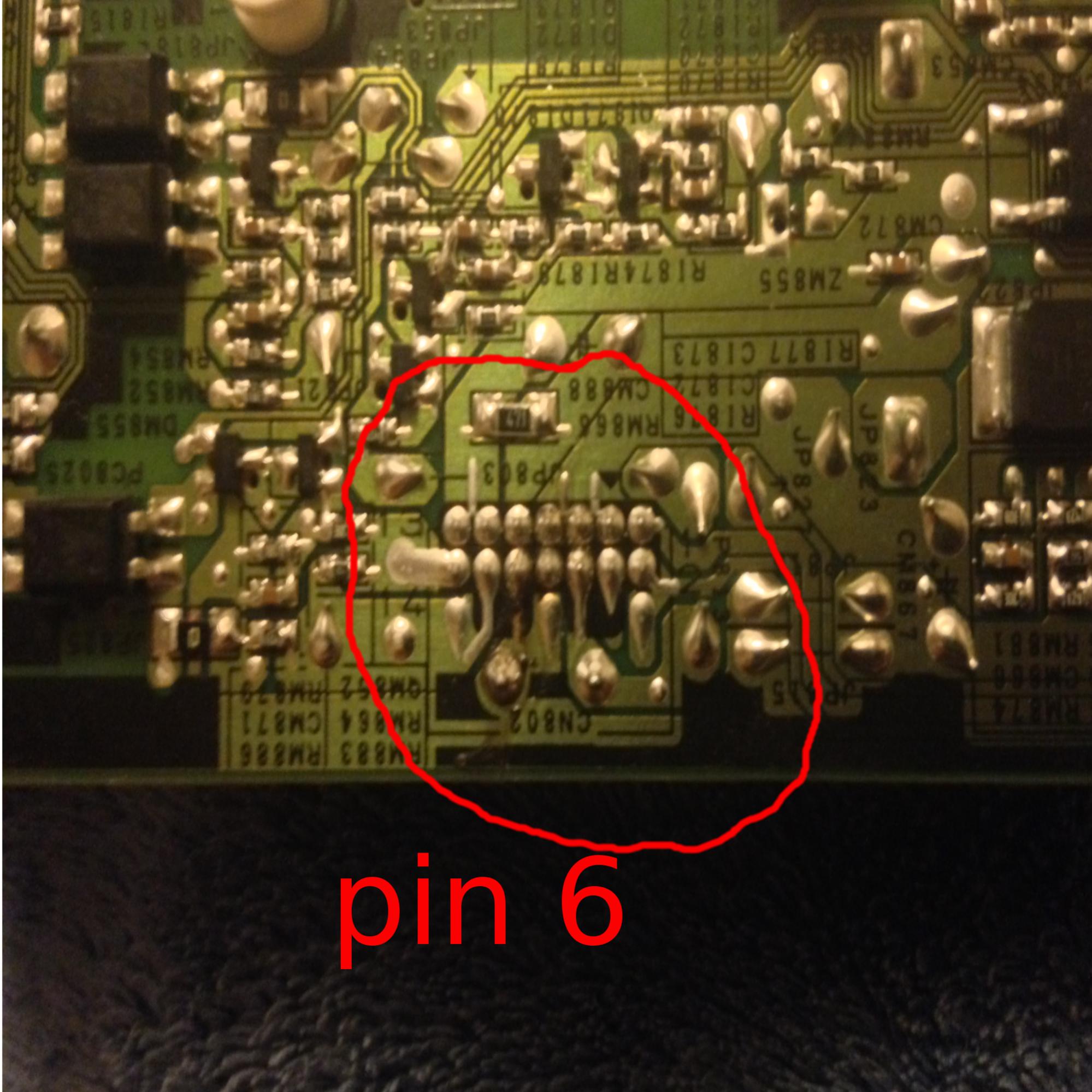

                                      pin 6 on the power supply looks like has a bad joint or has been hot witch is blue_on
                                      power board with main disconnected (turns on back lights) measured from end of cable. also measured from board.
                                      1. 12.33
                                      2. 4.3
                                      3. 12.33
                                      4. 0 board .63
                                      5. 12.32
                                      6. 7.10 back light flashes
                                      7. 12.32
                                      8. 0
                                      9. 0
                                      10. 0
                                      11. 5.11
                                      12 5.11
                                      13 5.11
                                      14 3.03 back light goes off
                                      all volts are steady,
                                        going threw the pictures i came across this one since I have not touched this with a soldering iron I think the main was fixed before.
