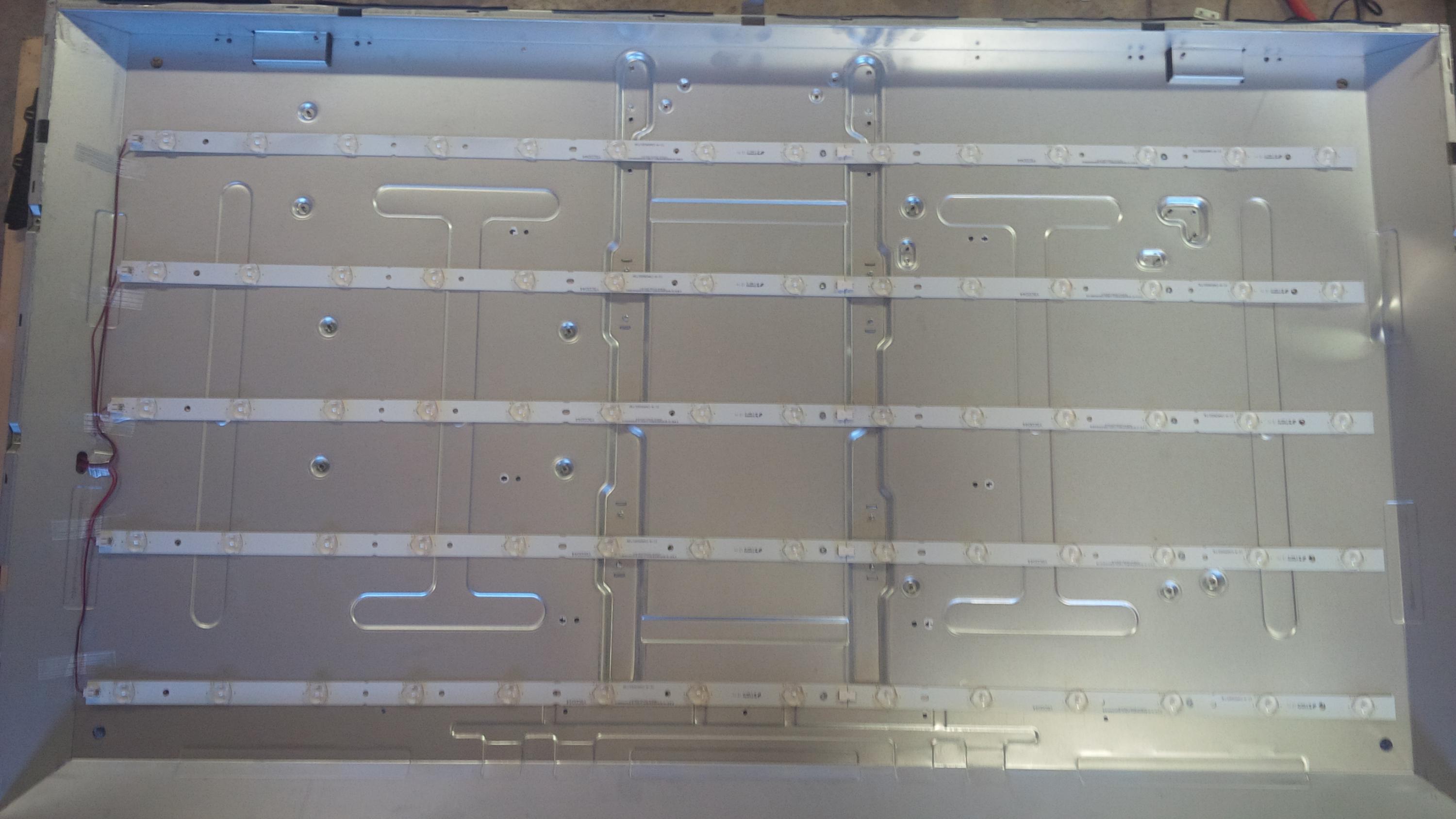

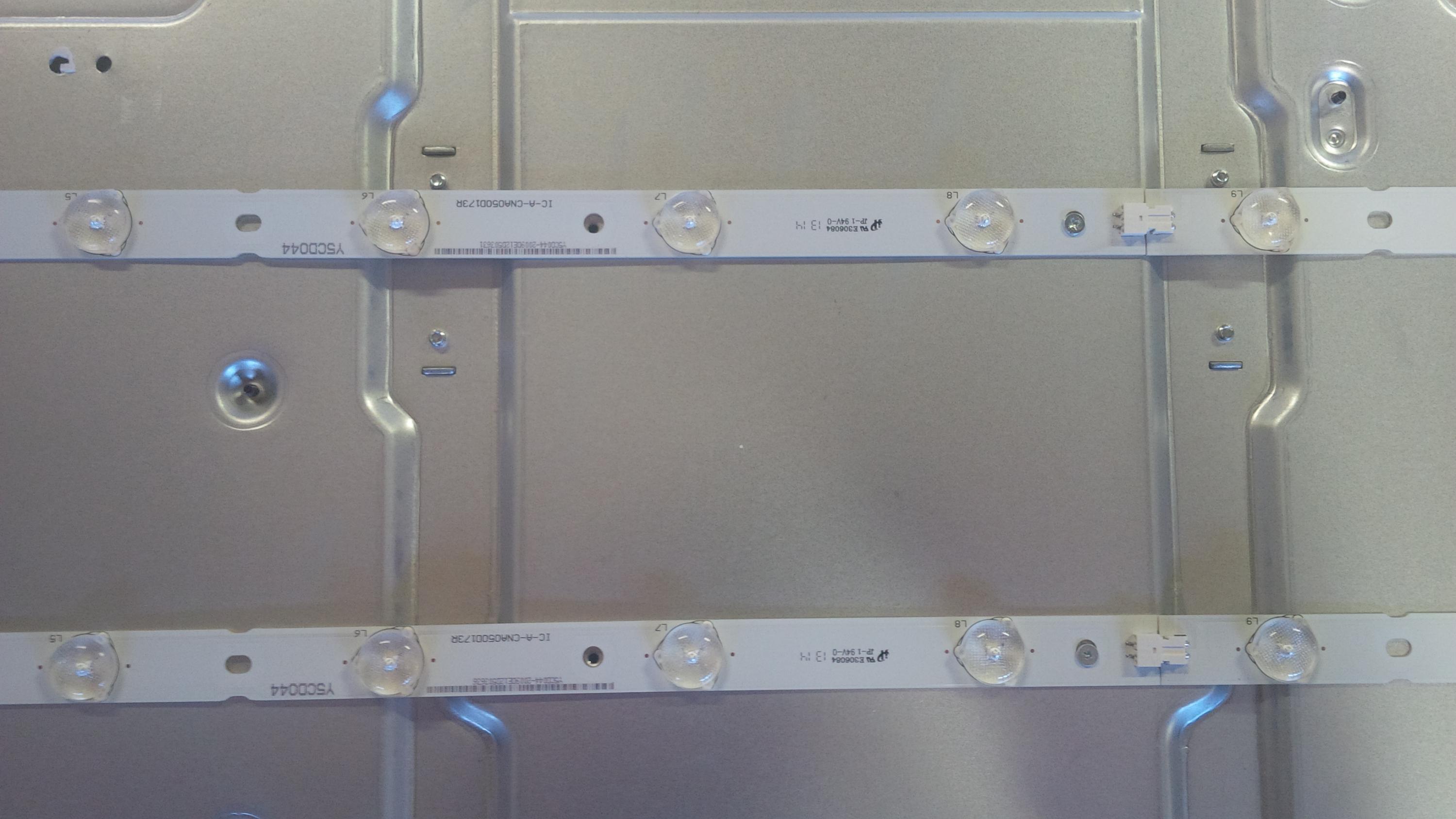

                                    Hi dpcookson, would you be able to post a couple of pics of the screen LED's seeing as you have yours already in bits. Does this TV have edge or backlight LED's? Would appreciate it as I haven't dismantled mine that far yet - only gone as far as the PCB's.
                                    • dpcookson
                                      • Sep 2015
                                      • 11
                                      #38
                                      Re: rca rlded5078a-d
                                      It is full backlight, there are 5 strips of 14 LEDs.
                                      note: The TV is "upside-down" in the pics
                                      • CapLeaker
                                        Leaking Member
                                        • Dec 2014
                                        • 8326
                                        #39
                                        Originally posted by dpcookson
                                        Okay, measured the LED connector during power cycling and got -394V (why is this negative?) but it dropped out quickly like you guys said it might.
                                        If this is a sign of a bad LED or more how do I check them? I tried setting my DMM to diode to test a few random ones but didn't seem to get anything.
                                        That depends on where you had your GND lead from your DMM connected to during the measurement.
                                        You can check every diode with your DMM set in diode mode and look for an open or dead short.
